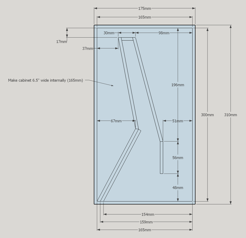

I don’t use Sketchup but I would imagine there is a way to pull dimensions. Lacking that, just go with the PDF plans that are published. If your wood thickness is different, maintain internal dimensions. +/-3mm is good enough. Don’t worry it is pretty forgiving.Sketch up experts,
I can navigate around the views that jhofland posted in the sketchup file. One question: is there a dimensions window that can be opened, or do I take the dimensions from the published pdf for the jhofland design.
Thanks,
MM

Thanks for the reply X. I thought that since the S-Up file was from jhofland, he might chime in. PDF measurements will work great.
MM
MM
