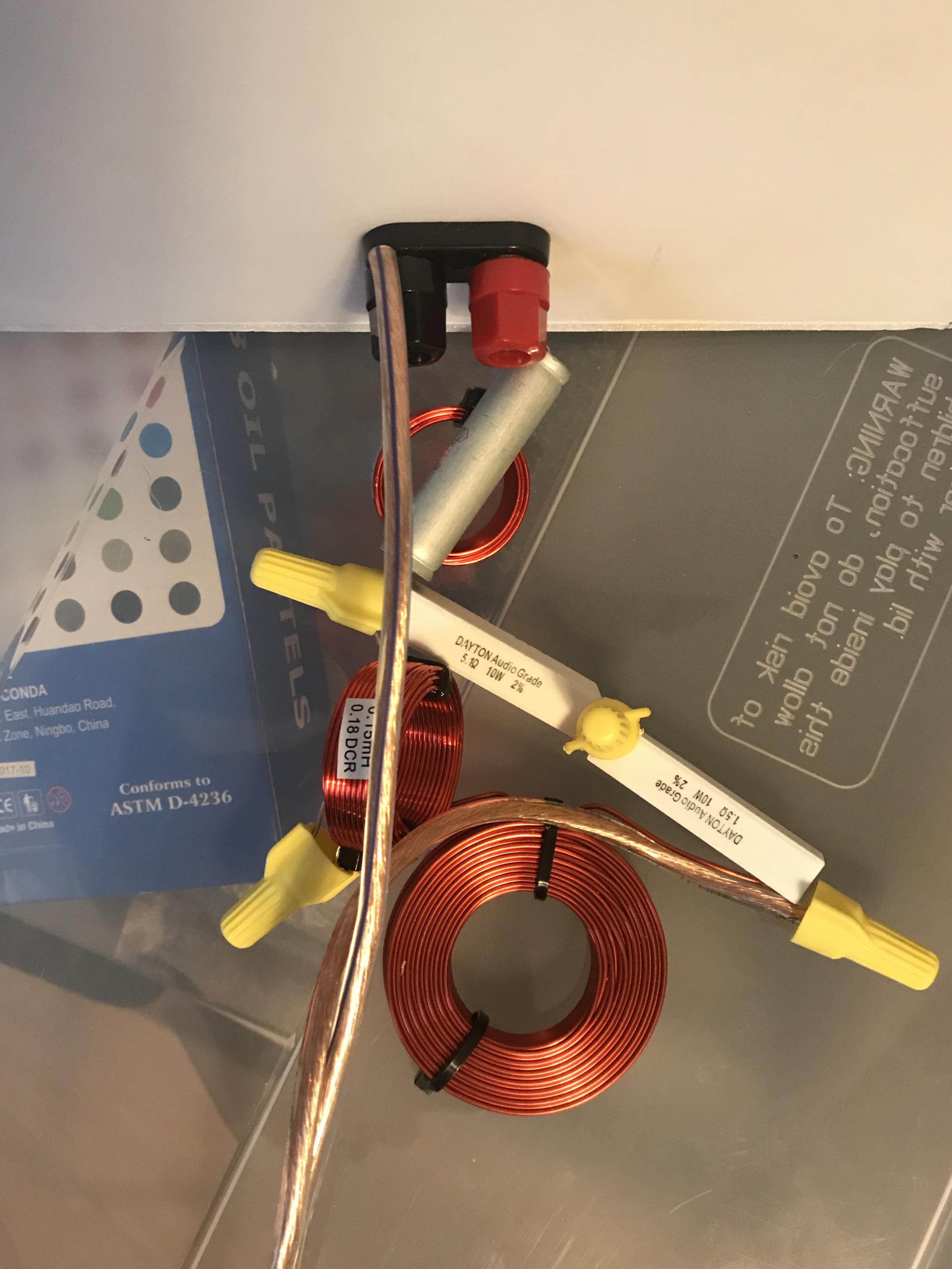

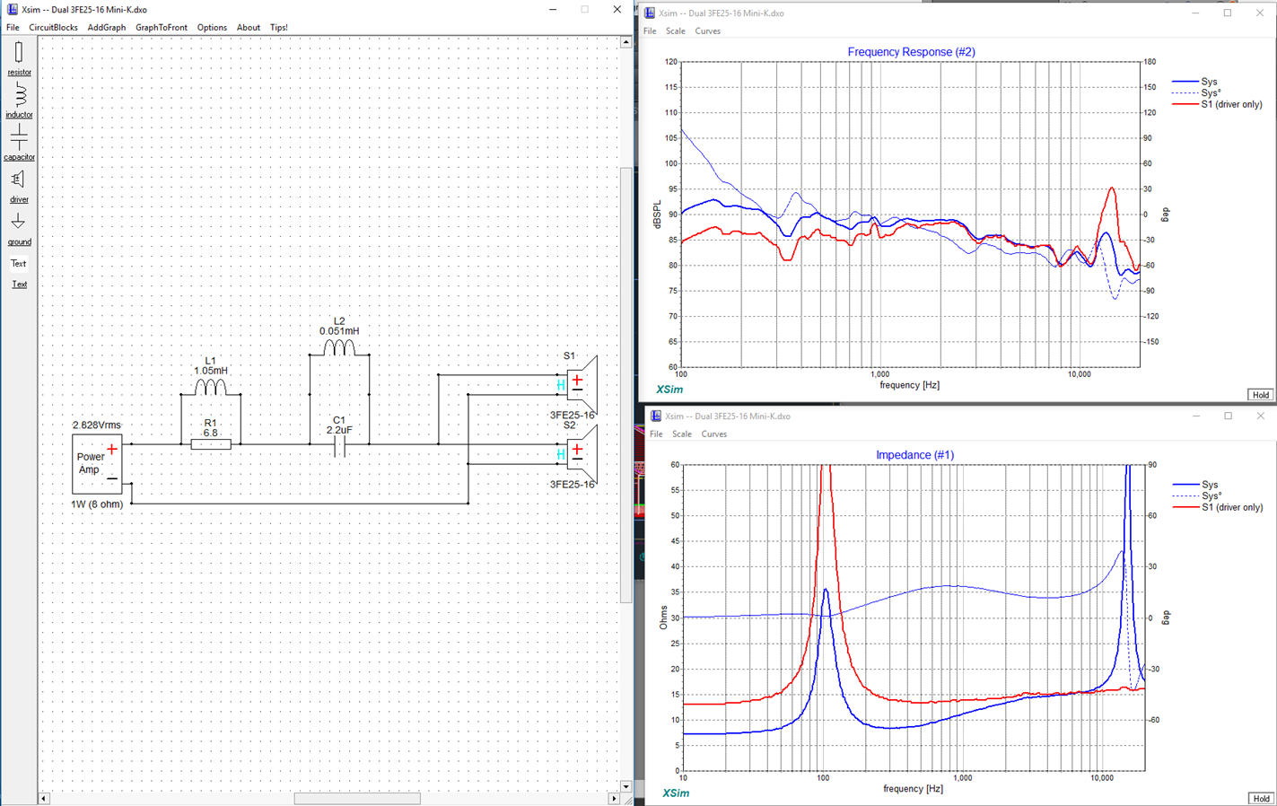

Hey X. I did add some bracing during my initial glueup of the boxes. I’m sure that helped some. What seems to help more is my experiment with BSC and a small notch filter to ever so slightly knock down the highs. Here’s my XSim showing a single driver in Red and the dual 3fe25’s in the Blue trace. And then I put it into real components. The sound is fantastic. The foam core sound has diminished from what I can hear. I think it may have been accentuated by the FR imbalance before BSC. My only question is regarding the impedance shown in XSim after my adjustments. Should I be concerned about the huge spike in the high frequency impedance or does this just make the amp work a little less? Also, is there an associated phase shift?
That looks great Jwjarch! You can flatten the impedance peak with a cap and resistor in series and this is then strapped across the driver +/- . Try 2.2uF and 10R and go from there. There is a formula for calculating the exact frequency and that might be good to look up.
Are any of the curves from measurements or just factory data?
Thanks for the tip X. The data is just factory at this point. I haven’t learned how to use my UMIK yet. I’m interested in measuring these speakers to see what they look like. One of these days...
