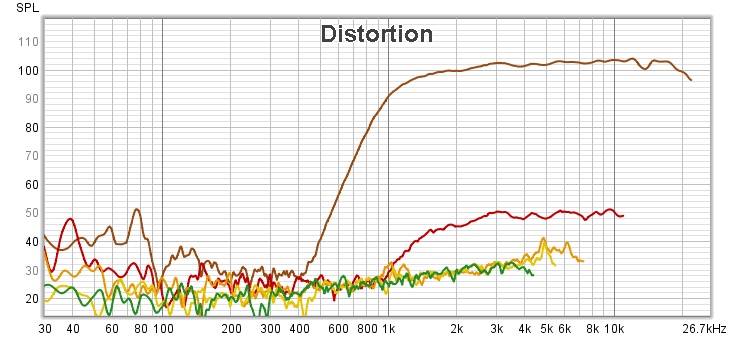

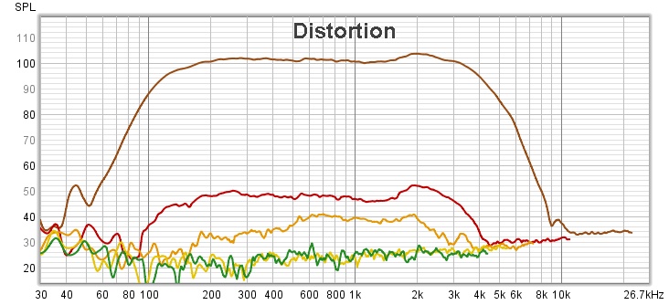

That was crazy!! I was mesmerized the entire time and I kept turning it up louder and louder. That was probably the loudest I've ever played my system. The speakers kept their composure the entire time. That's the thing I'm noticing most about this speaker with the new baffle(And high density felt), is that it sounds very different from other speakers I've heard when played loud. Utter transparency even at the highest levels. Weird experience. Very counterintuitive. The tweeter being mechanically isolated from the mid-woofer and the baffle being mechanically isolated from the cabinet(And itself) probably has a lot to do with what's going on. Obviously the quality of the drivers have something to do with it too, but I've heard them before and they never sounded like this. I'm also pretty sure that the high density felt is killing much of the internal acoustic noise too, so that's not reflecting back and messing up the mids

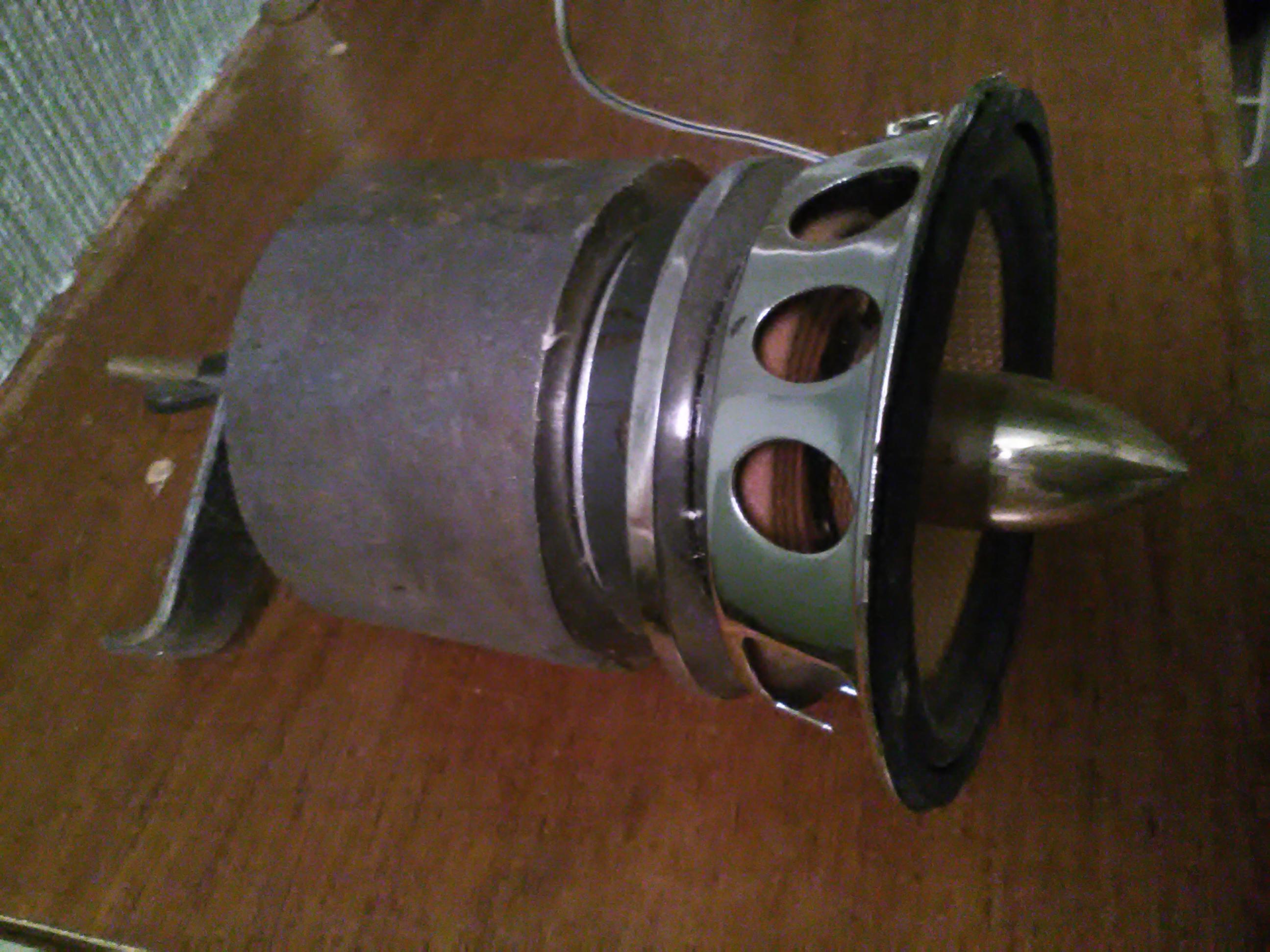

Ideally the magnet should be bolted to a weight ( a lump of cast iron in the above image ) and then the whole assembly suspended by tension springs, with something like a foam ring betwixt driver and enclosure. I think if the chassis were to be bolted to a very ridged and heavy front baffle it ( the chassis ) would act like a spring between the magnet and baffle causing a resonance; I did notice a resonance on a pressed steel chassis that was audibly reduced by adding red babybel cheese wax to the gap between magnet and suspension.

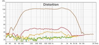

- Midrange experiment with Auto sound panel deadener and high density acoustic felt..
