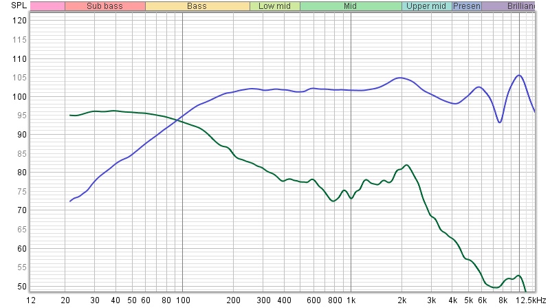

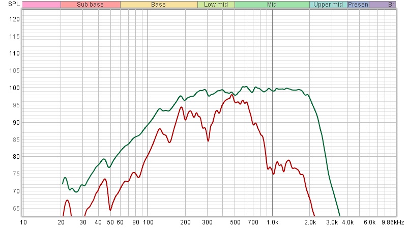

Size comparison for scale..
This is the absorption response, 10cm thick of the current, high density felt I'm using, with no added airspace between the mic and the driver, vs nothing.
As you can see, it's either resonating at certain frequencies, or it's completely transparent at certain frequencies. Either way, it's totally unacceptable. The null at 300hz, and another at 150hz makes me think it's a resonance problem
The above test doesn't show exactly what's going on in the cabinet, but it does show that the product is crap, and I shouldn't have believed the absorption coefficient graph that came with it🙁

The test was performed with 10cm of material in front of the speaker, which is inside the speaker also. The first few posts on this thread explains what was done with the material on the inside.

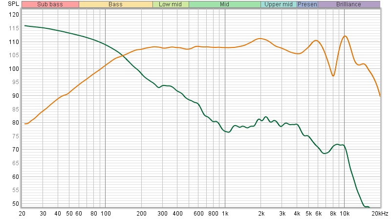

My scientific curiosity finally got the best of me. I put so much work into this that I had to see exactly what was going on inside the cabinet, so I drilled a hole in the bottom(mic barrel diameter) and stuck the mic in. The news is very good! No resonances at all, with a smooth downward trend through the midrange. Exactly what I was hoping! Driver amplitude remained the same for both measurements.
It's actually kind of cool to have mic access to the inside of the cabinet. Since it was drilled on the bottom, there's no cosmetic sacrifice.
There was a small amount of air leakage from the hole(tiny port, which could effect the low end of the measurement), so the next measurement will be with the mic sealed in.
Orange - Direct driver response
Green - Response from inside the cabinet
The response I'm getting does corespond very well to their published coifficiency curve. It is a little off because of how I'm using it.

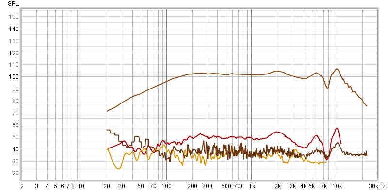

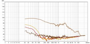

Here's an interesting measurement. Internal(Sealed in mic) Fundamental, HD and noise floor..
Also at the same amplitude, but outside, on axis..

I did some calculations, and sure enough, internally there is..
a peak at 2.1 khz corresponding exactly to the internal width.
a peak at 1.2khz corresponding to exactly the internal height.
It also looks like below 800hz(Below the wavelengths of the internal dimensions) the internal cabinet pressure starts increasing more and more.
That's where the air volume becomes pure compliance, so pressure builds but sound can't escape, I think, can someone explain it?
