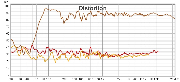

My current speaker cabinets produce a significant amount of distortion when measuring above 100db. Very audible vibrations. For the best possible experience, shouldn't the system be able to play cleanly up to the maximum peaks? Have you tried measuring your speakers at the peak volume level they will play back?
90 db average at 50" with the following distortion..

I have more than 500 watts on tap for each stereo channel, but the icepower amps are the weak link. Each mid and tweet is getting 25 watts. That's more than enough for the efficient tweeters(92db), but the mid's are relatively inefficient(86db). The drum solo track I played the other night handled dynamic peaks of over (Most likely)100db with total clarity.
