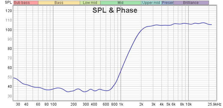

Midrange experiment with Auto sound panel deadener and high density acoustic felt..
Fixed the problem with the tweeters and lowered the mid back down to 200hz(by far the best FR measurements at 50"), so now it's running from 200hz to 2khz(Again). the dip at 200hz is ceiling bounce. I'll mop everything else up with a little eq.
I have addressed a number of things at once with this design, and it will be very difficult to differentiate exactly what is being attributed to what. But what I'm hearing is ethereal(God, I hate subjective descriptions). There is something completely different going on here, and I've heard a lot of extremely expensive systems at Southern California audio shows going back to the early 90's. There is absolute total transparency, and this is with using inexpensive electronics. I Imagine that the baffle design has the most to do with it, with the high density felt interior keeping the internal acoustic reflections to an absolute minimum(obviously helps). The amount of labor involved was crazy. Total cost for materials, around $350. There are so many variables that need to be understood and controlled for on top of that.
As far as the parametric EQ goes, I don't think I'll be using it.

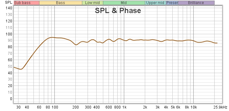

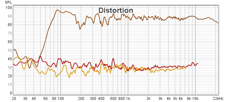

Your midrange driver has lower distortion than some pro stuff when looking at graphs from Voice Coil's Test Bench.

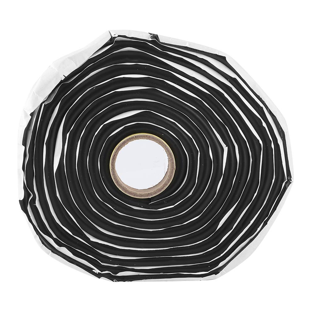

Sorry for the slight OT but if we were to modify an existing box made of 15mm chipboard for instance....and assuming I am happy to lose the inner volume. I add a layer or 2 or those sticky cld sheets like used for vehicles, then I add a thin layer of mdf. What is the best way to fix this inner layer of mdf to the cld layer.?
It doesn't work like that, Jim. The CLD meant for car doors has a thin layer of aluminium and would not help your case. You can get butyl (often sold as butyl rope) and stick that between two layers of chipboard for CLD purposes. It's pliable and easy to form a thin layer between the two surfaces.
