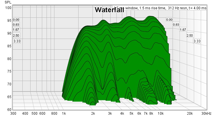

there seems to be a problem with the tweeter mounted directly on the sorbothane. Oscillations occurring starting at 2khz and up. No wonder why it sounds bad at a 2khz crossover point, it's not the tweeter, it's the sorbothane. in retrospect it makes sense in that if you take the frequency high enough, sorbothane will start to oscillate. Taking the rubber grommets off the back and tightening the bolts further will be the next step. Both tweeters are behaving identically, so I at least get a high mark for consistency🙂
