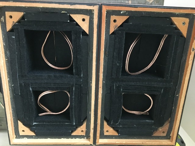

Since my box is stuffed to the brim with high density felt, a much larger amount is lost as heat, to the point that the frequencies above 90hz are less loud in the box than outside the box at the same mic distance from the driver. You can also see here that the lowest half wavelength resonance makes it's appearance at 600hz. The box depth resonance is confused by a vertical brace parallel to the baffle.

The above picture represents only one pass through the felt interior(I'm using the shortest sweep, with the mic situated toward the back). Much of what escapes through the driver membrane actually has to make two passes through the felt interior, so the bump we see peaking at 2khz is probably much lower in amplitude by the time it gets back to the driver. Another thing that's creating that peak is the mic being situated exactly between the two sidewalls. The driver cone is also situated exactly between, so it's probably a pretty good representation of what the cone sees when the sound is reflected back
