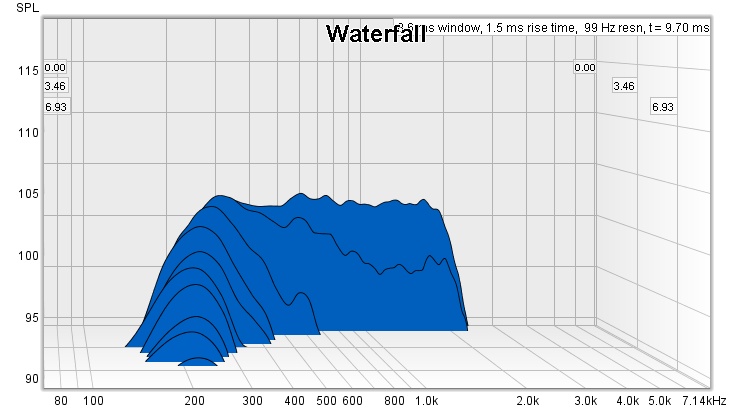

Midrange CSD, 200hz to 2khz on CLD baffle with High density felt interior. Looks more like a tweeter response than a mid.

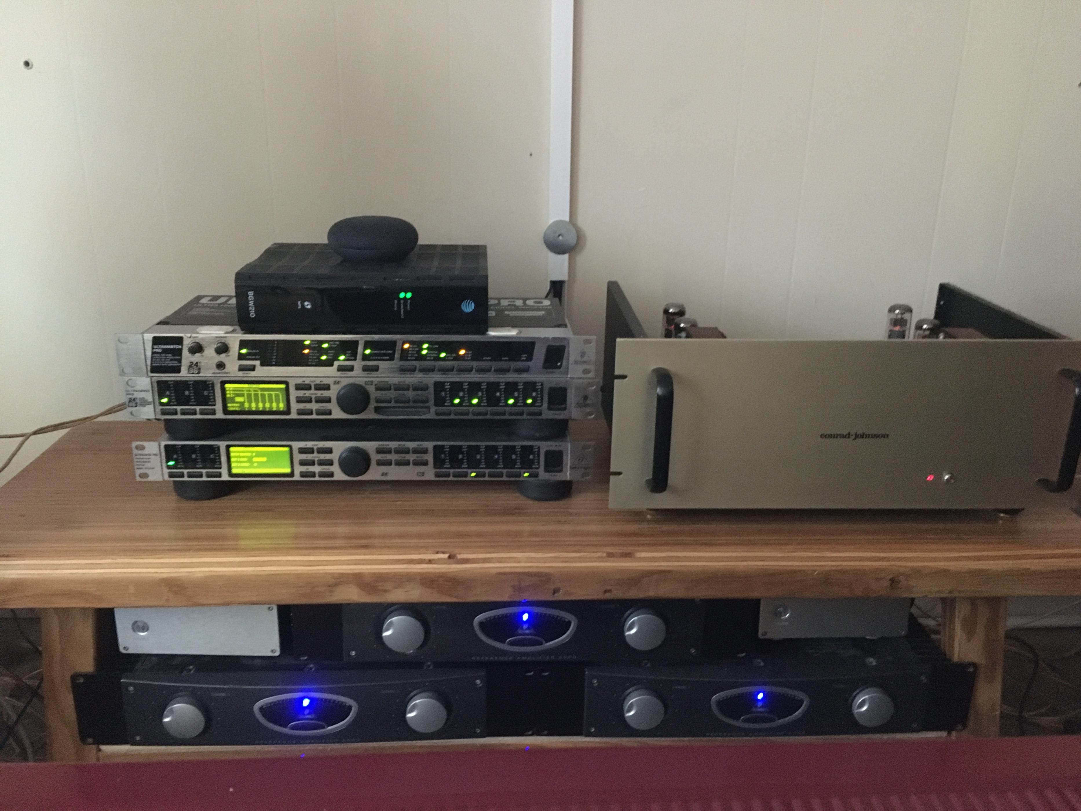

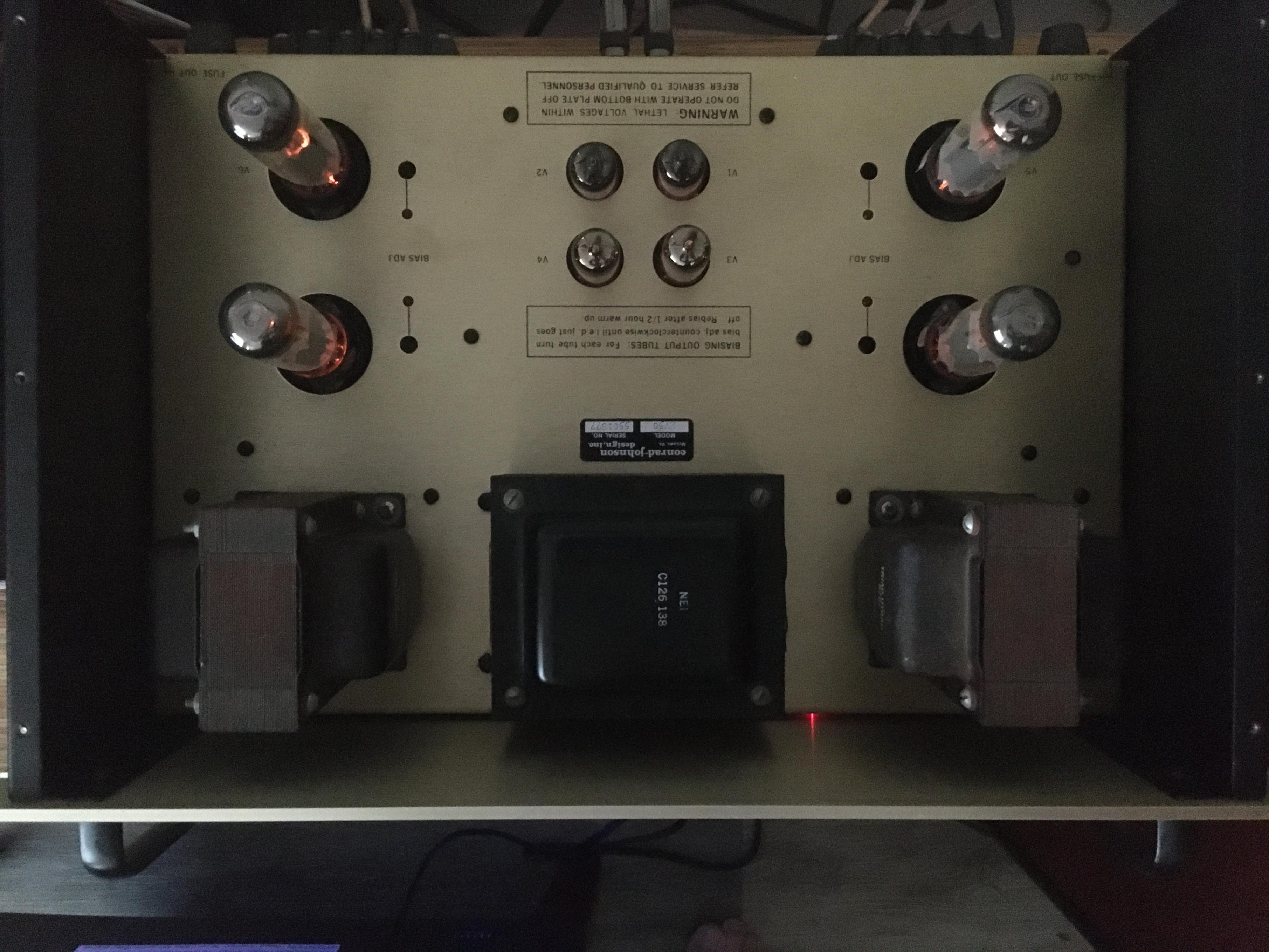

On another note, I decided to pull my 35 year old Conrad Johnson MV50 tube amp out of storage and hooked it up to my mids to see if it would still work. Not only does it work, but it works perfectly! 50 watts into 8 ohms. For the midrange, it totally smokes the ICEpower amplifier(twice the output wattage of the icepower amp)Stunning reproduction of vocals, paired with the CLD baffle/ high density felt interior midrange driver. Total eargasm!! Yippee!!🙂

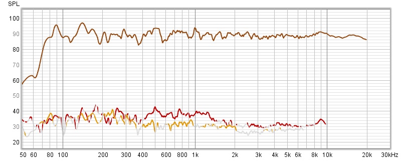

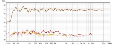

With 35 year old Conrad Johnson tube amplifier on mid's from 500 to 2khz.

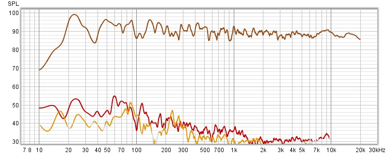

Measurements taken on midrange/tweeter axis 90db/1m, with no EQ
Taken at the same distance with a lower noise floor. Note the second order harmonic from the tube amp between 500 and 1.3khz. Still low in absolute terms, but higher than from the transistor based amps above and below that point. A good example of how a tube amplifier's 2nd order distortion is expressed through an actual loudspeaker driver..

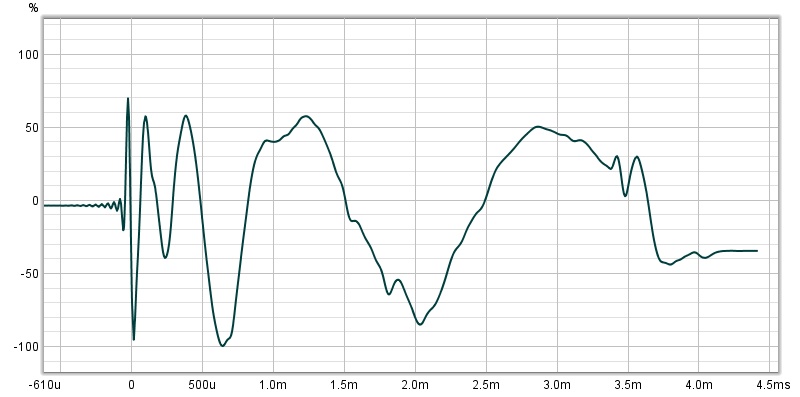

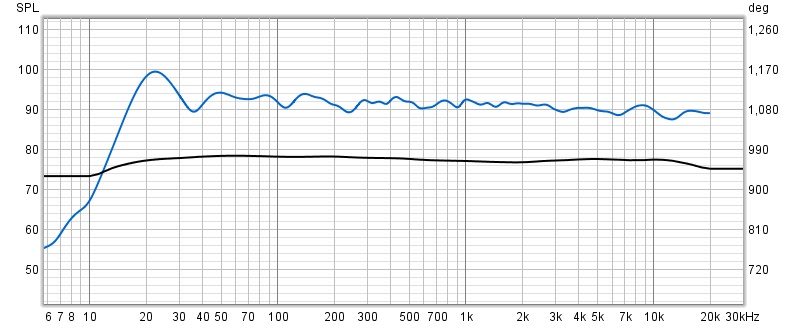

Step response of my 5 way, 8th order, active dsp based system. Gulp..

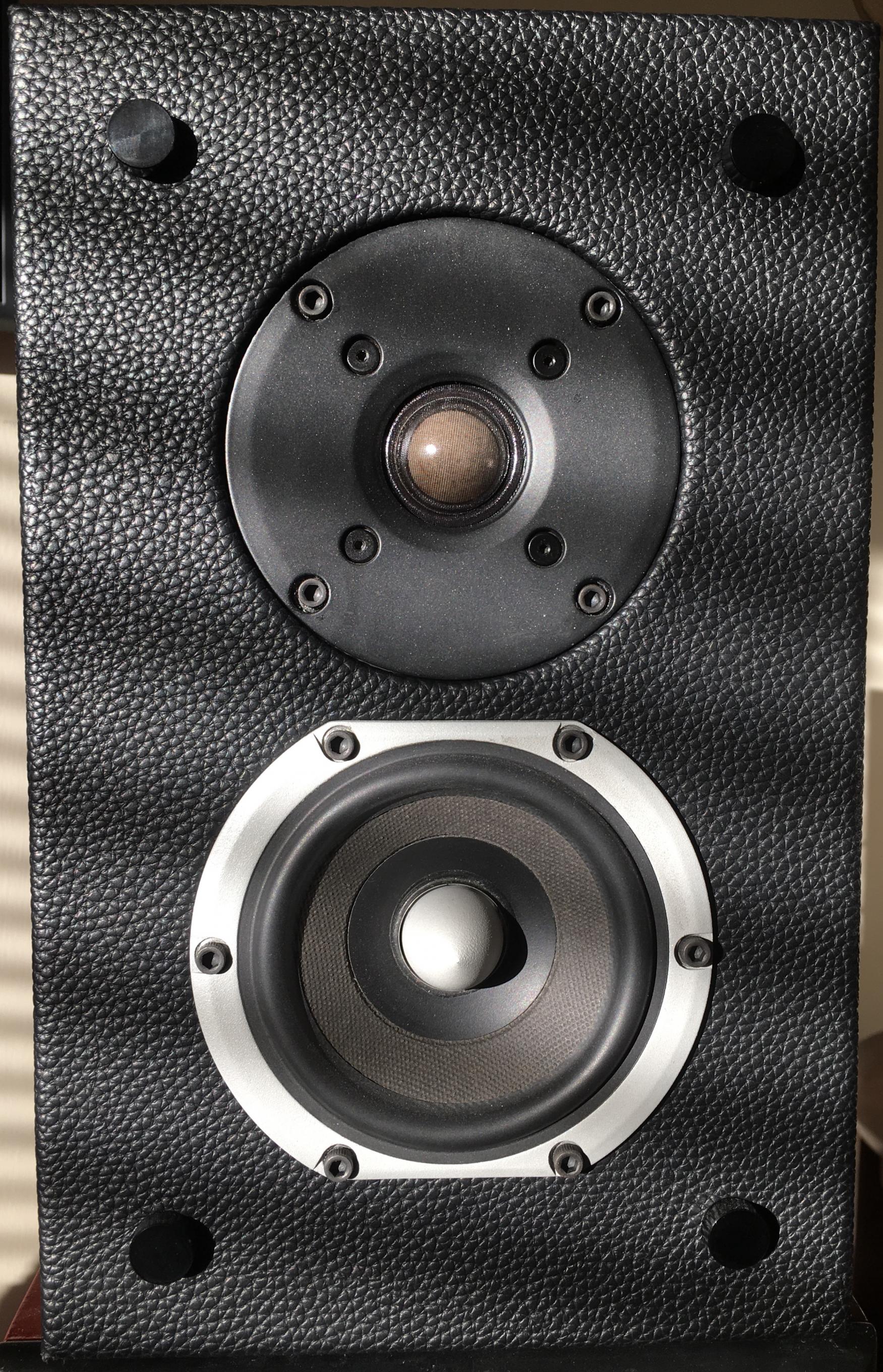

- Midrange experiment with Auto sound panel deadener and high density acoustic felt..
