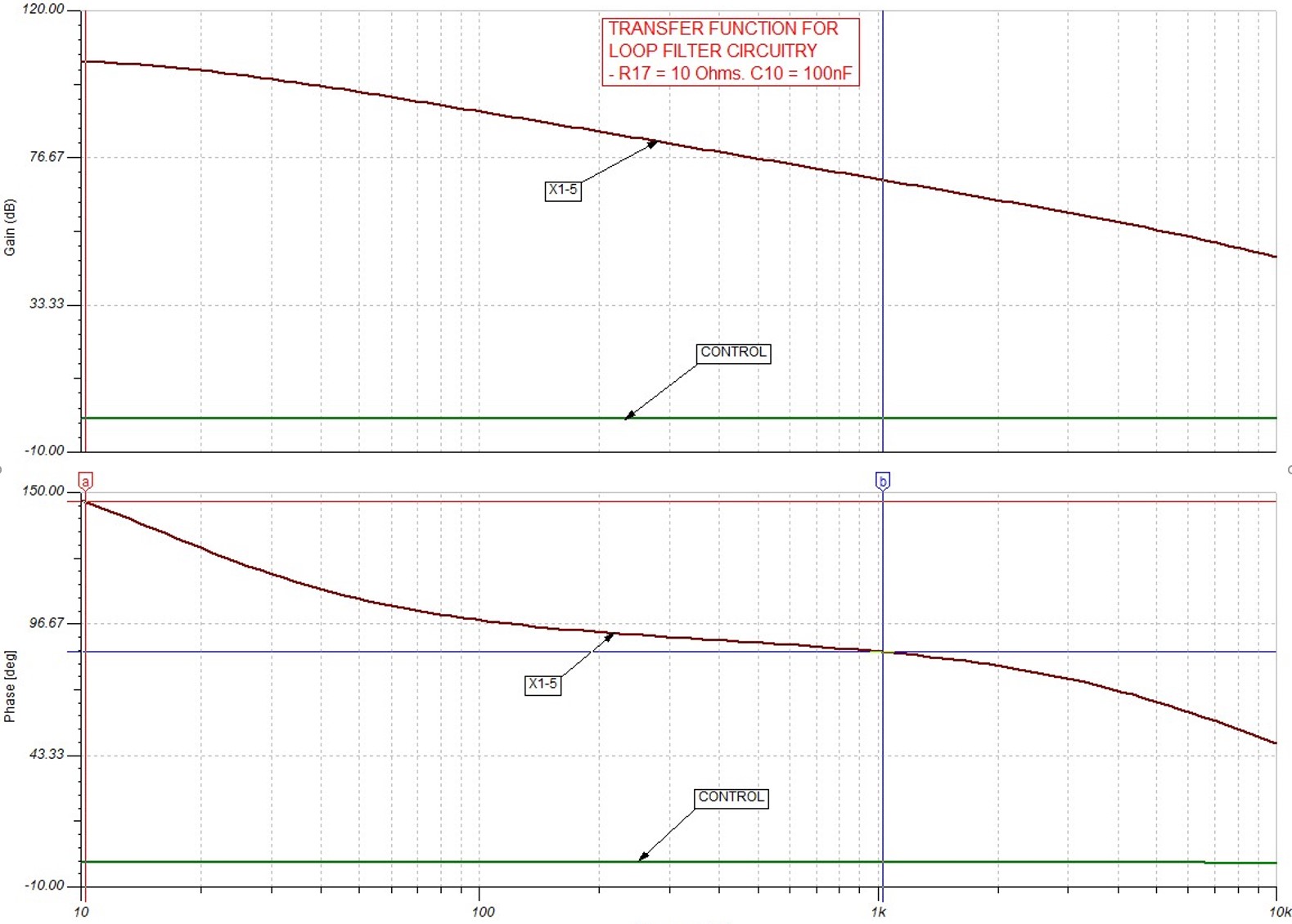

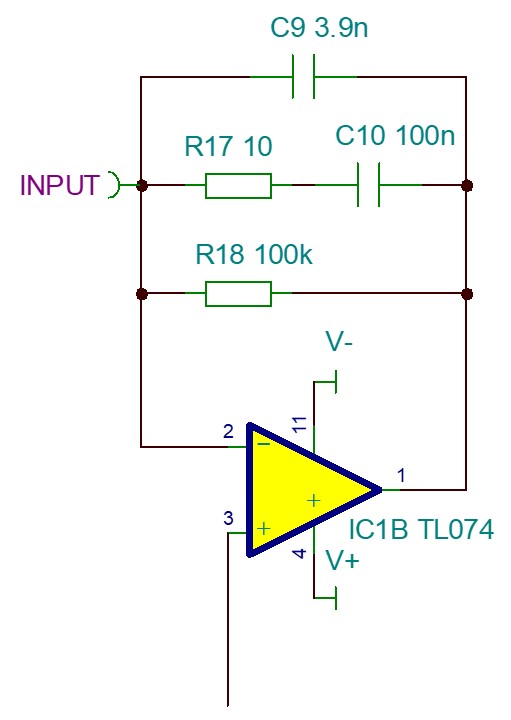

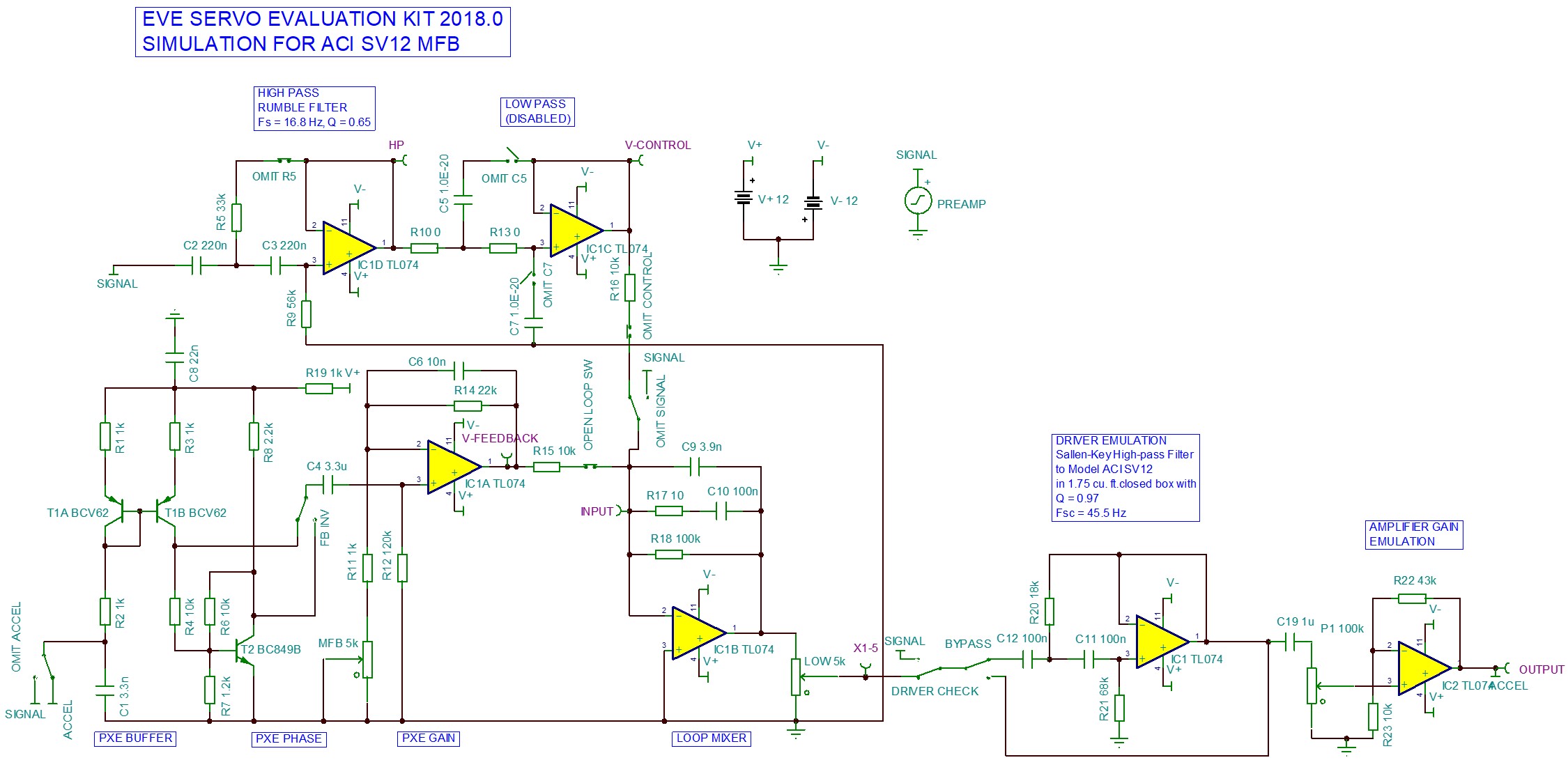

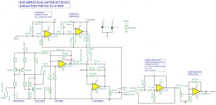

This post has been asleep for some time, but I have a question for Rscamp. In the very beginning of this thread you mention the optimization of R17 and C10, the loop shaping RC network of the EVE mixer circuit. I Have attempted to simulate that part of the EVE circuit in Vituixcad, but I seem to do something fundamentally wrong: the mixer shows a completely flat passband, and not the slight mountain/gain of post 20. Could you publish the circuit you used for that sim? Furthermore, although TINA looks nice, as Bolsert already pointed out, TINA does not display wrapped phase, making it visually somewhat more complicated for MFB loop sims.
Oops, I think I found my mistake: I did not properly connect the loop shaping network to earth. Prper connections require attention in Vcad. But I am still uncertain my sim is right, because gain vs phase looks too good to be true, so my question to Rscamp still stands..
I think this circuit (or one very similar) was used for the simulation. I have also attached the analysis of just the Loop Filter portion of the circuit.
Does this help?

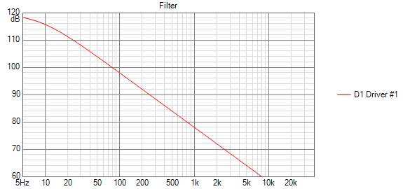

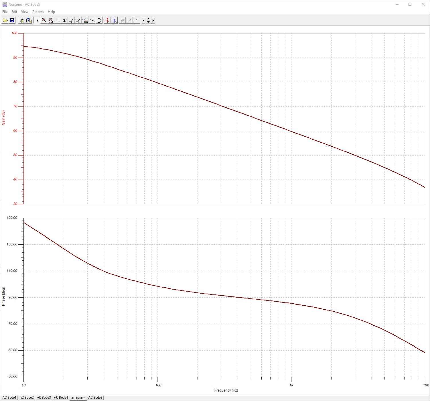

Yessss! This is what I need.
A question: @ 10 Hz the level is almost +95 dB. Is this an arbitrary level TINA default sets , or is it the result of some setting?
I have simmed the network in Vituixcad. Where I would assume the level @ 5 Hz to be around 0 dB, I get a level of + 116 dB @ 5 Hz.
I simply do not understand that high level, because the circuit -to my best of knowledge- does not amply, but functions as a low pass/leaky integrator.
This is more a question for the Vituixcad thread, I know, but was wondering whether you have an explanation for that level.In your sim is is also very high : 94.5 dB instead of 0 db.
For stability assessment sims, we need to analyze the phase margin unity gain/0 dB gain points. 80/90/100 dB levels do then not make much sense to me.

Maybe a silly question, but what does the transfer function then tell you if the level is arbitrary?
I am attempting to simulate the open loop gain of the MFB circuit in a step-by-step approach. So the first step is modelling of the sum section with its leaky integrator. The next step will be loading this section with the closed box S&K equivalent. But as long as I cannot drive the unity gain positions frequency-wise from that sim, phase assessment at unity gain is also impossible.
Do you have any suggestions?
