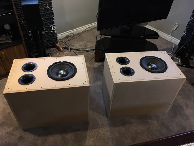

I have been using two of these vented 6.5 cu. ft. subs with my stereo/home theatre system since 2000. While they have been re-aligned since then, they are big and they are not pretty. I plan to repurpose these 'classic' drivers in a servo-feedback design or die trying. :)

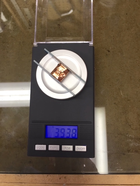

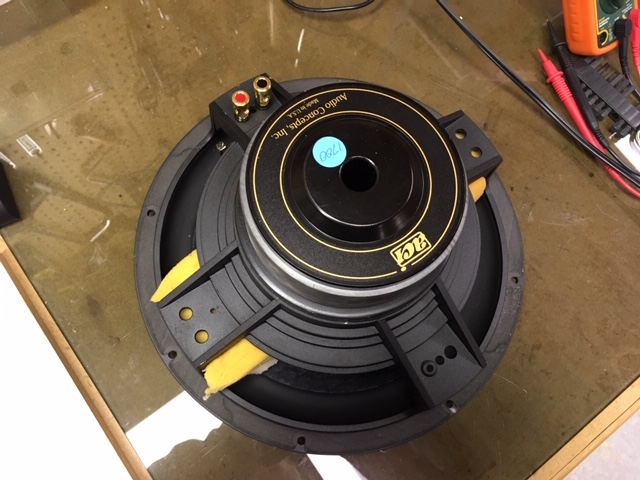

Here is the driver or perhaps, 'victim' is a better word. The StarBass V accelerometer was selected as it fits up to a 2" voice coil. Here it is on a scale to get the weight.

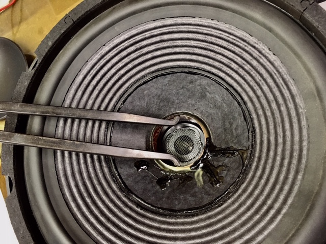

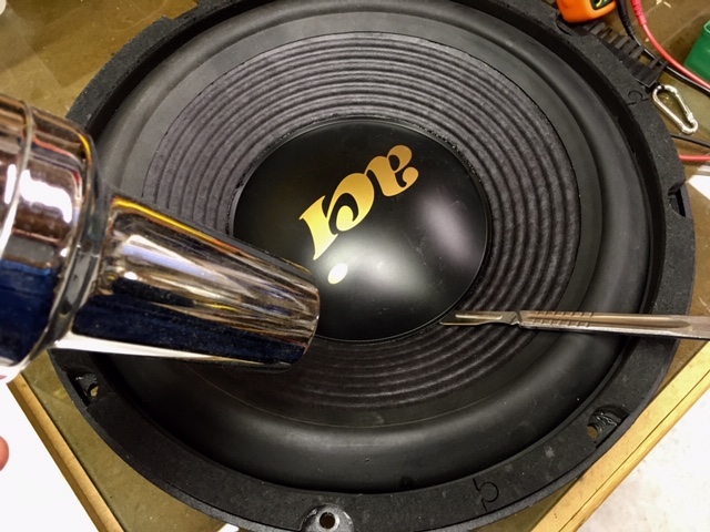

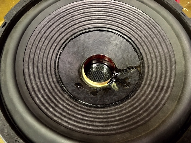

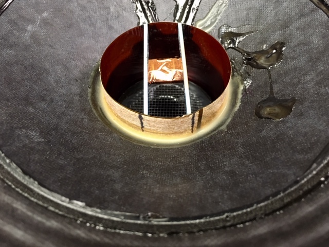

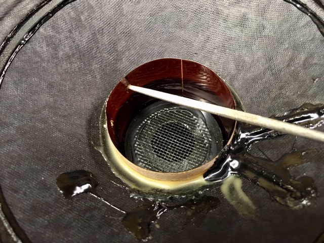

The first step in fitting the accelerometer is to remove the dust cap. Heating the bond to soften the adhesive and pulling up on the cap with a hobby knife as the speaker is rotated worked very well.

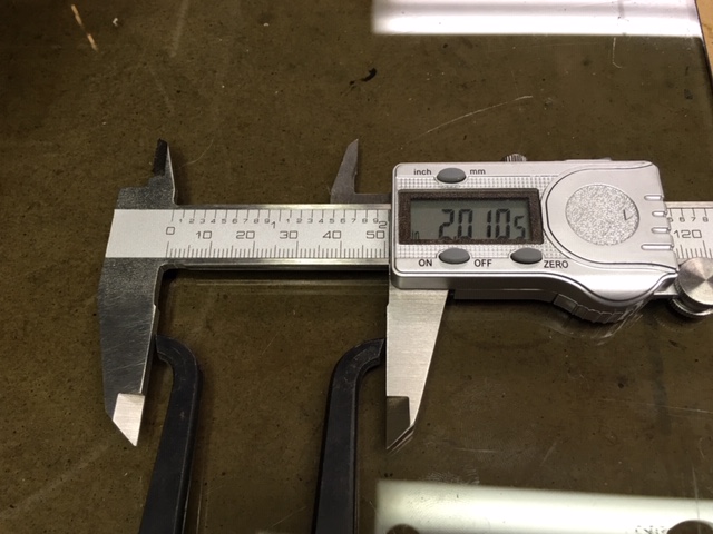

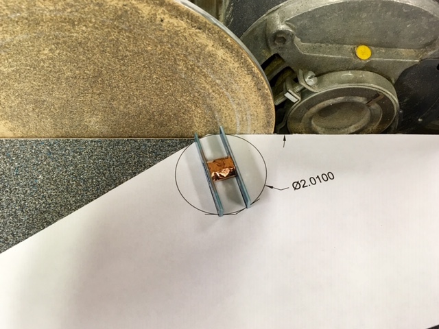

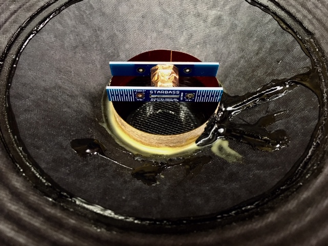

The accelerometer mounting legs need to be trimmed to fit in the voice coil former. Here the inside diameter is measured and transferred to an AutoCAD sketch so the amount of material to be removed and the optimum angle is determined. This is used as a guide to trimming on a disk sander.
The accelerometer is test fit a few times and trimming stops when it is a loose, sliding fit in the voice coil former.

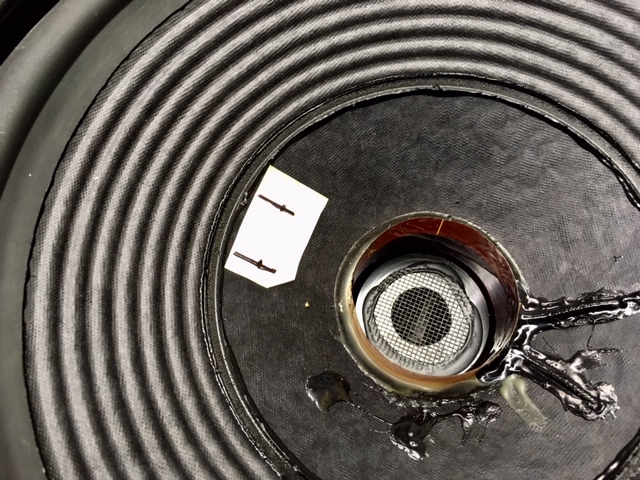

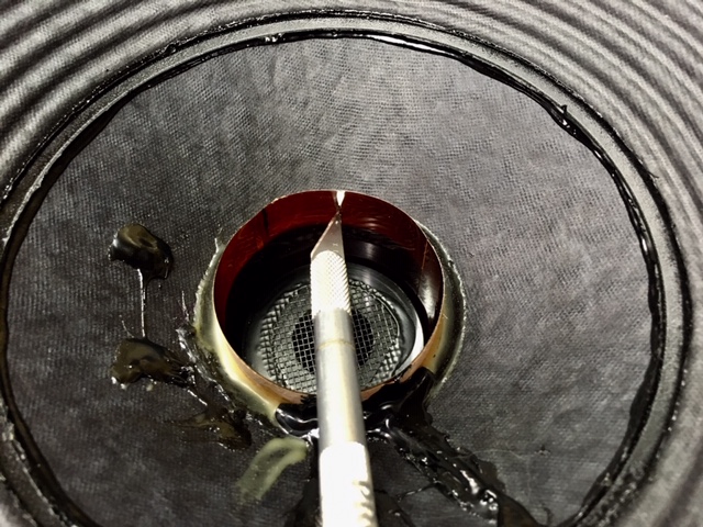

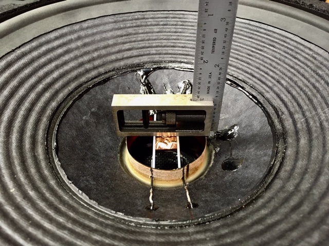

The voice coil former on this driver sits high so holes were cut for the wires for the accelerometer leads to pass through. The locations were marked, the former pierced with a hobby knife and the holes brought to their final size with a needle file.

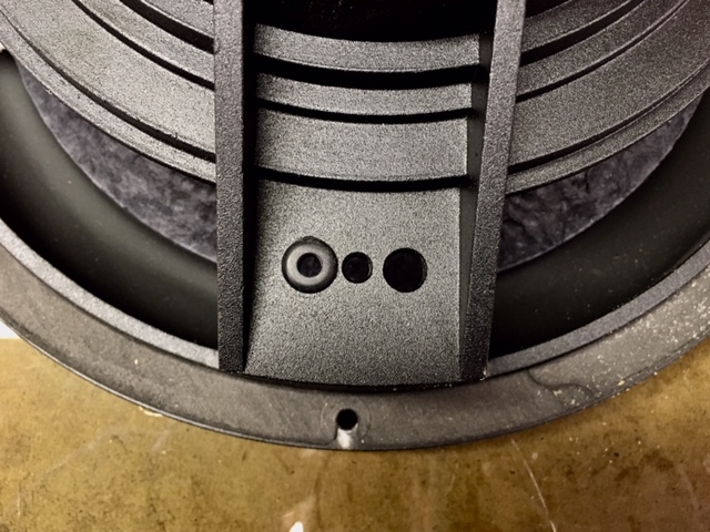

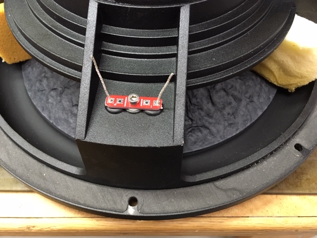

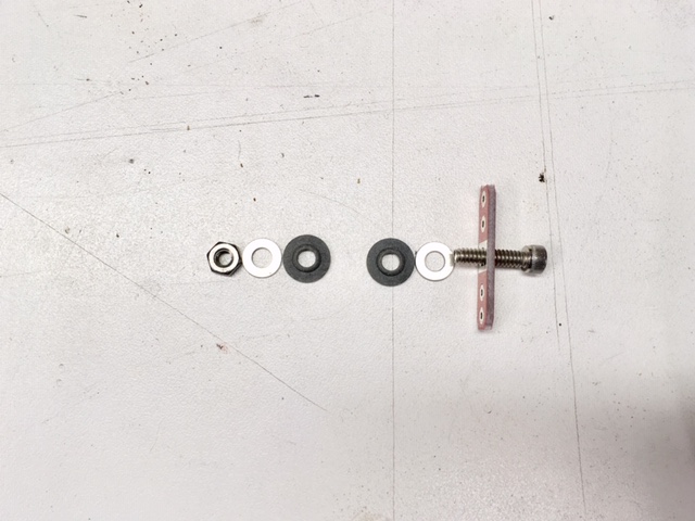

There is a suitable mounting location for the accelerometer lead termination board opposite the voice coil terminations. It is quite far from the centre so the accelerometer leads will be brought up along the outside of the cone first like the main voice coil wires. The pass-thru hole locations were marked on masking tape.
The termination mounting location already has some holes and it will be easier to mount the board on the outside rather than the inside of a cast basket arm. As luck would have it, I had just the right size grommets to insulate the holes through which the wires would pass. The hardware set shown was used to mount the termination plate. Insulated step washers isolate the board from the cast frame.

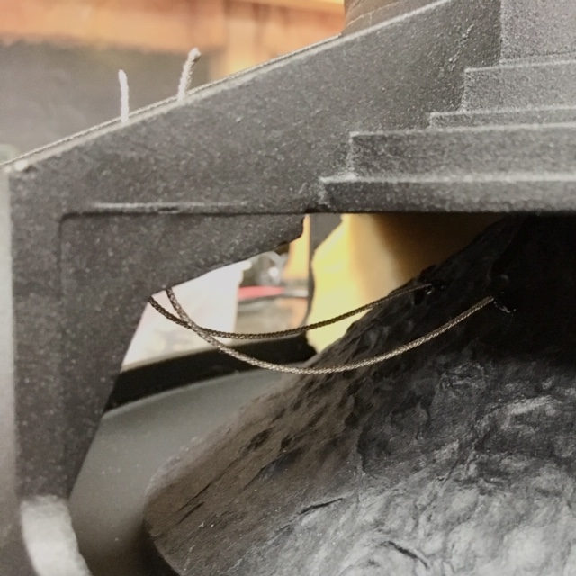

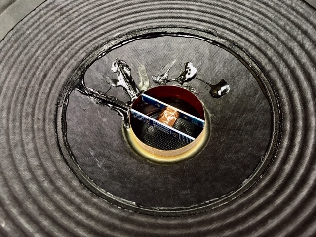

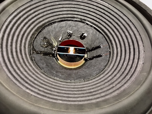

The leads are soldered to the accelerometer and passed through the voice coil former and through the holes in the cone. This cone is very think and a small drill was used in lieu of a sharp puncturing tool. The wires are coaxed to lay flat on the cone and the accelerometer squared up prior to gluing in place with MG Chemicals "Speaker Service Cement". The cement is used to secure the accelerometer leads to the cone surface to match the voice coil leads.
The leads are glued on the underside much like the voice coil leads on the other side and the wires pulled through the termination board until wire strain with maximum excursion is kept low but without too much slack.
This completes the accelerometer installation. Next the development board...

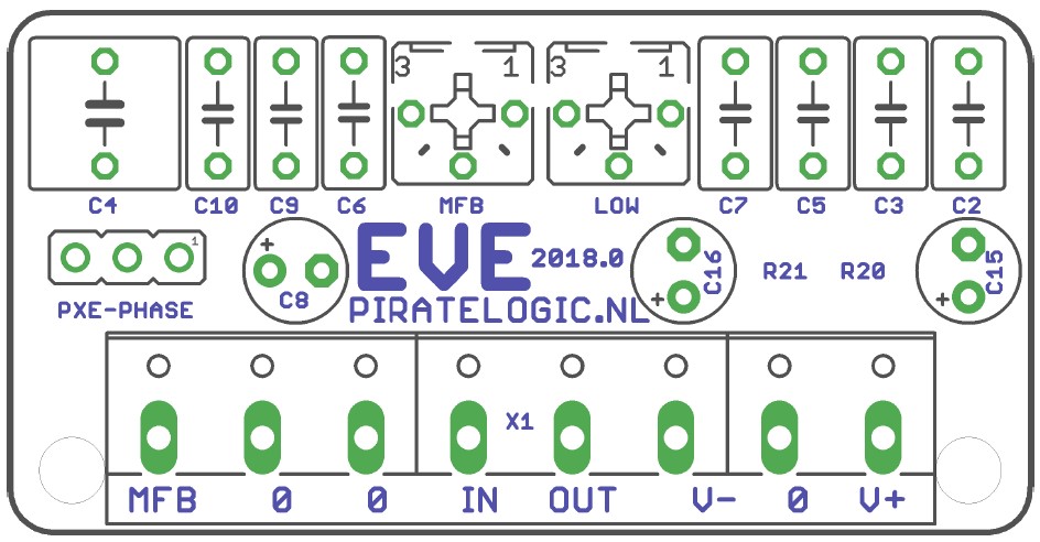

To go with the accelerometer, PirateLogic sells the EVE servo evaluation kit. This is a small PCB with a mix of analog surface mount and through-hole components that sums the signal from a preamplifier and from a conditioned feedback signal from the accelerometer sensing voice coil motion and sends this to the amplifier. Some of the passive components need to be selected based on the characteristics of the driver to increase the amount of feedback correction that can be applied before instability occurs.

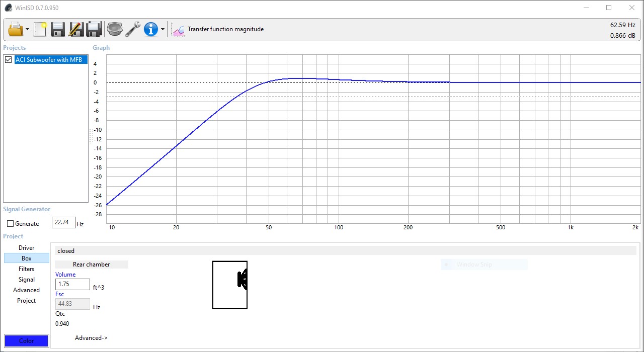

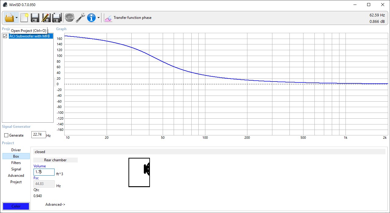

What volume should the used for the closed box when using MFB? A small box pushing the Q above 1 can be used since the response should be smoothed and extended downward by applying feedback. But smaller enclosures will require the amplifier to work harder to develop more current to produce larger forces on the voice coil at lower frequencies to maintain sound pressure level. Another consideration is a bit of a bump in frequency response as produced by a higher Q system can be beneficial if it increases the amount of feedback in a region where harmonics are likely to occur.
The original specifications for the ACI SV12 driver are shown below. This data was used in WinISD to model the predicted LF response of the driver. As a compromise and to make the enclosures compact enough for the intended purpose as a base for a stereo pair of existing two-way speakers, a volume of 1.75 cu ft was selected producing a Q of 0.94.

Nice work. One thing: the litz wires seem to be a bit short, which might cause excessive bending and cause them to fail.
Thanks. Frankly I'm not sure if the braided "tinsel" wires should be longer or shorter. The wires run up to the top of the frame casting so are probably an inch (2.5 cm) longer than can be seen in the photo. I had them longer at first but it appeared they might "slap" against the back of the cone. There does appear to be very little localized strain along the wires when the cone is pushed to it's mechanical limits. Oh and I almost forgot. Because I used some foam to space the cone outward for access to the backside, the wires are actually in position for full outward extension in the photo.
Sound like it will be fine. :)

The EVE instruction manual
https://piratelogic.nl/data/docs/products/eve/piratelogic.eve.2018.0.manual.en.pdf?fbclid=IwAR0VDxTR8ZDYk15nCc5HKDSuGRWKk-KjgBwb-P-5cO8ZRcFafvnti1t7ZmY
walks the user through steps to configure the servo loop. Available on the board are:
  • High and Low Pass filters for crossover points
  • An accelerometer sensor High Pass filter
  • A sensor Low Pass filter
  • Loop shaping filter to primarly compensate for system phase response
I won't go over everything in the manual, but will describe key component selections made for this project.
High and Low Pass Filters:
The High and Low Pass filters were bypassed as these will be addressed by active filters or other means in the overall stereo/home theatre sound system. So to implement on the EVE board:
High Pass Filter:
• Omit R5
• Use 220k for R9
• Replace C2 and C3 with wire bridges
Low Pass Filter:
• Omit C5 and C7

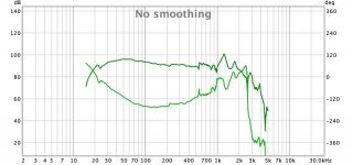

Sensor Low Pass Filter:

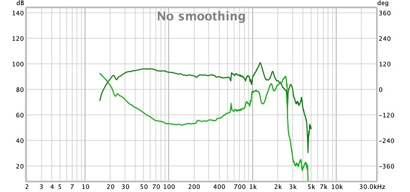

Configuring the sensor low pass filter requires more information. We need to know at what frequency the accelerometer is going to report the first phase/amplitude anomaly. We don't have a frequency plot in the ACI SV12 datasheet, so a near field measurement was taken at the centre of the driver in an existing ported system. From this, it can be seen there is a minor breakup at about 550 Hz and a major one at about 900 Hz. Using the major breakup as a guide, it is suggested the pole for the sensor low pass filter be set to two octaves below this:
Fpxe.high = 225 Hz
Sensor Lowpass Filter:
• Use 68n for C6 (cutoff frequency 234 Hz)
  • Measured Near Field Transfer Function for ACI SV12 in Vented Enclosure.jpg

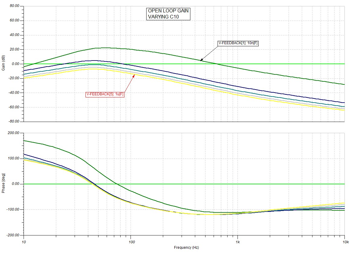

Loop Shaping Filter:
This is the tricky part with regard to optimizing the feedback factor and this optimization is left to the user. I won't know the quality of my assumptions and analysis until the circuit is built and tested, but the next posts outline the process I am using to select components for this part of the circuit.

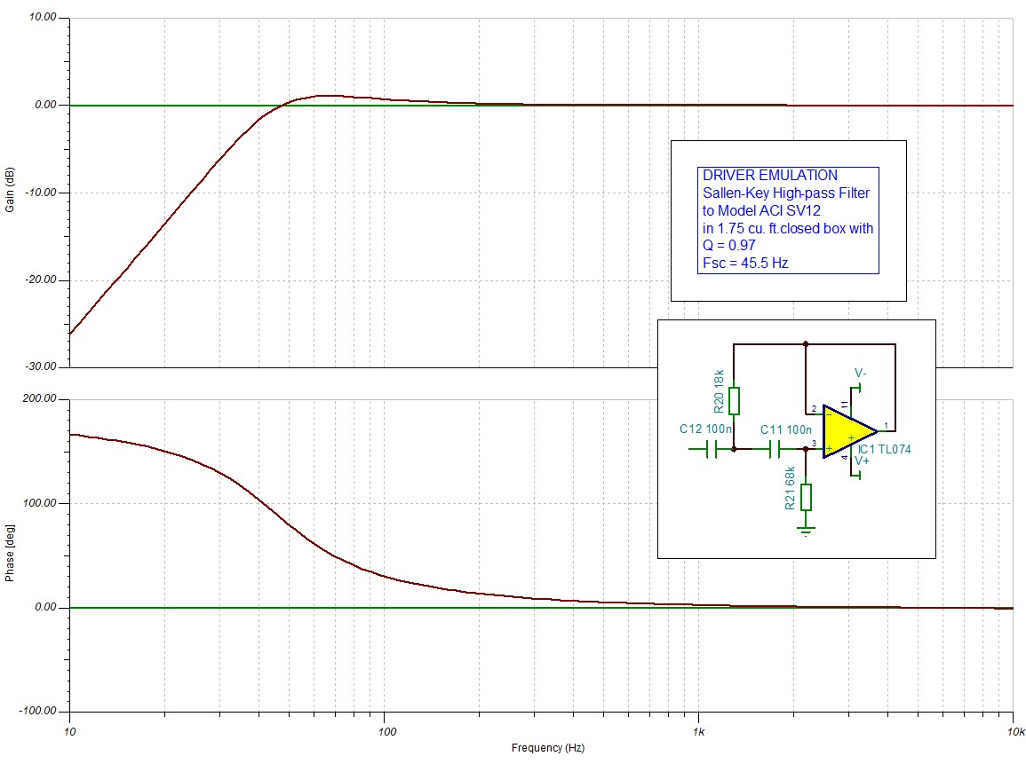

The EVE circuit is modelled in TINA. The following filter models the response of the driver and is added to the output of the Loop Mixer. The Loop Mixer combines the Loop Filter and Adder (summing circuit) functions.

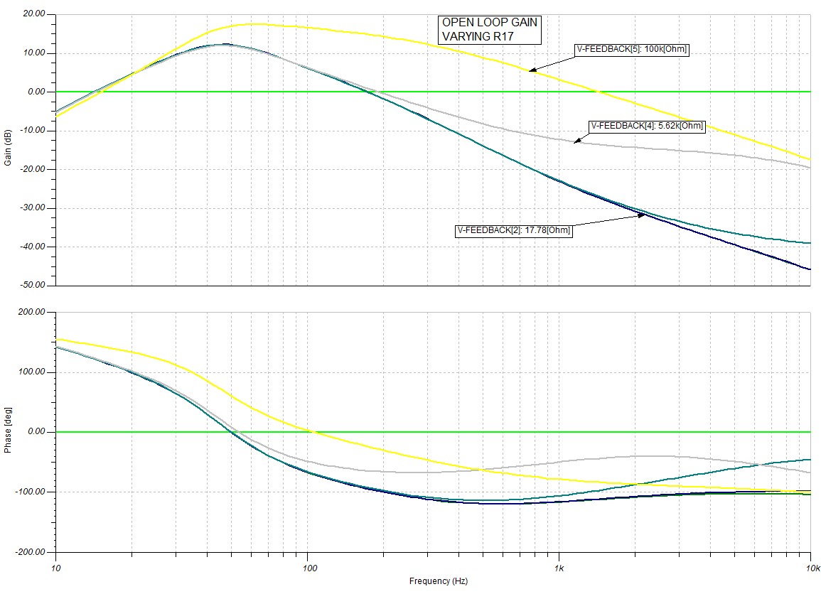

Using the TINA model, AC Analysis was used to generate Open Loop accelerometer feedback responses with varying values of loop filter components C10 and R17 at the output of the PXE GAIN circuitry. These are shown below. Not shown are companion analyses where components selected in the previous steps were varied to see their impact on the open loop response.
From these analyses, these values of the loop filter were "guestimated" as the best compromise for phase and amplitude response to provide good attenuation at higher frequencies and a reasonable phase match to the driver system.
• Use 100n for C10
• Use 10 for R17
