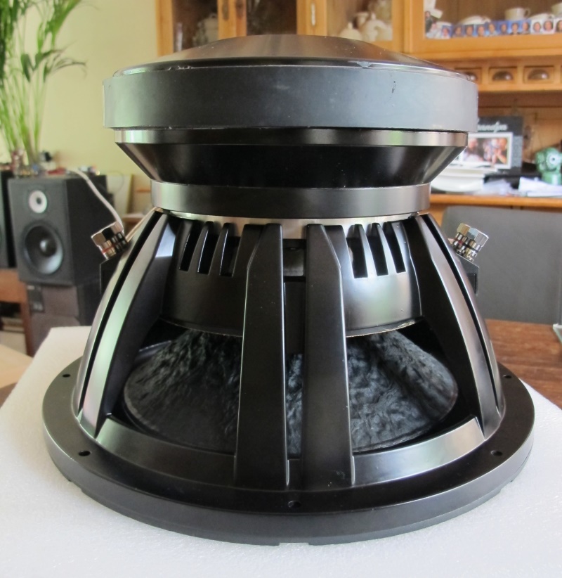

If the MFB was good enough a bass driver would not need a flat Bl(x) curve which would mean you could have massive excursion without large motor structures. At the moment you can get drivers that can do 40 mm one way xmax. But they are very expensive mainly because of the massive motor needed. The motor could use much less material.
This driver has 90dB sensitivity and a large enough motor to work in a 104L box Q=.707 sealed:
HST-18 mkIII 18″ Subwoofer – Stereo Integrity
In its non xmax limited regime its capable of 123dB/1m with 2000W (assuming no power compression). However its a very expensive driver due to the huge motor.

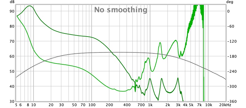

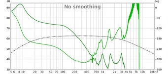

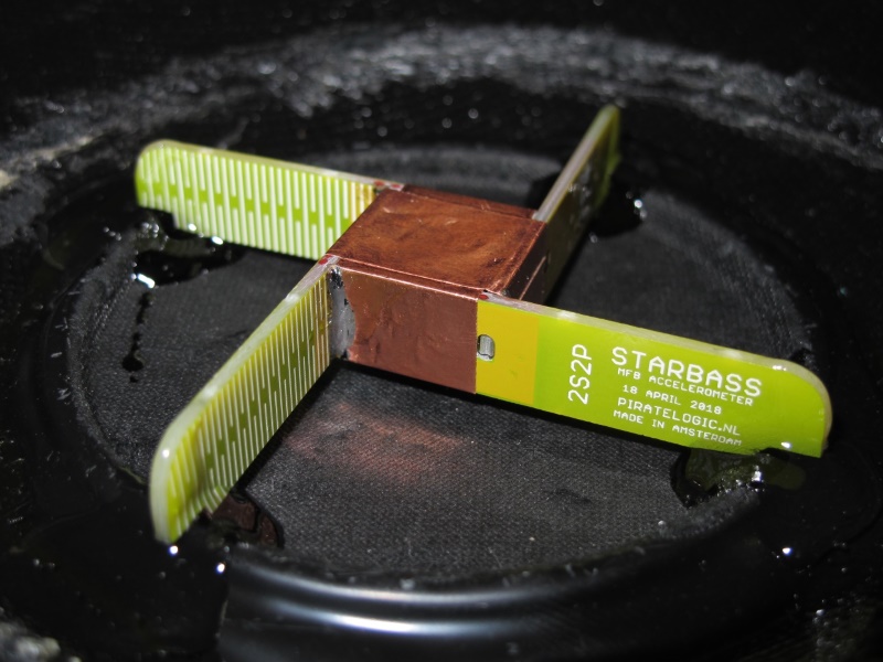

I was sidetracked for a couple of days. But I think we now have some success!

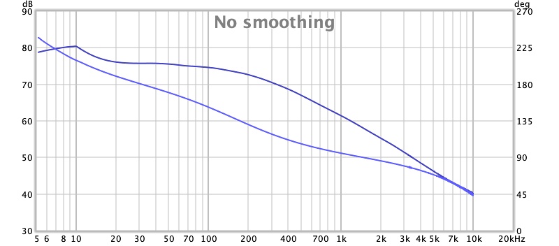

The first image from REW shows the transfer function for the EVE circuit from preamp in to preamp out and the other shows the transfer function for the accelerometer at preamp out when the speaker is fed the signal without going through the EVE circuit.
The speaker was "open baffle" at this point so I couldn't really do the feedback adjustment setup with pink noise recommended in the EVE manual. The response was already pretty flat as measured by a microphone open baffle.
It didn't go perfectly smoothly. I initially had positive feedback and blew a couple of fuses due to oscillation. DEFINITELY USE FUSES. Use smaller values so the oscillation isn't so scary. The feedback seems to be working now by virtue of a significant drop in the system resonance frequency with a corresponding high Q. This is due to the increase in "apparent effective mass". The free-air resonance of the driver is normally around 17 Hz. Note the very small signal level producing large excursions at 8.5 Hz in the video.
Obviously this setup is far from optimal given the driver is not in the enclosure volume the circuit was "optimized" for. The term "optimized" applies loosely at this point. :)
There is a bit of 60 Hz hum being picked up by the accelerometer that I need to deal with. I'm not sure where it is coming from at the moment.

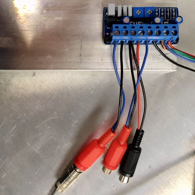

The EVE board could do with some test points. In particular, it would be very helpful to have a header in the next version of the EVE servo evaluation board to allow opening and closing the accelerometer feedback loop with a jumper. This would also allow the feedback signal to be easily probed.
Good points which will be included for the next EVE version together with a balanced out to allow easy hookup to UCD amps and an option to add current feedback using this chip.
Your leads to the accelerometer are placed widely and not twisted for several inches between the installation point and the tinsel lead exit, enough distance to pick up a bit of 60 Hz hum.
Minimizing the length of any pick up wire that is not twisted pair ("hum-bucking") between the accelerometer and electronics will reduce hum.
60 Hz is ubiquitous, but nearby mains or power supply transformers can be a particular problem for sensitive transducers, as well as the orientation of the transducer wires to those transformer fields. Moving PSU transformers further away, or changing the angle they sit in relation to the parallel accelerometer leads could reduce hum pick up.
Ben's suggestion to use copper braid wrapped as a ground shield would reduce high frequency (radio frequency/ dimmer hash) noise, but has little effect on low frequency (60 Hz & harmonics) hum noise. Twisted pair cancels common mode noise, allowing phone lines to be run next to AC lines for miles with out hum.

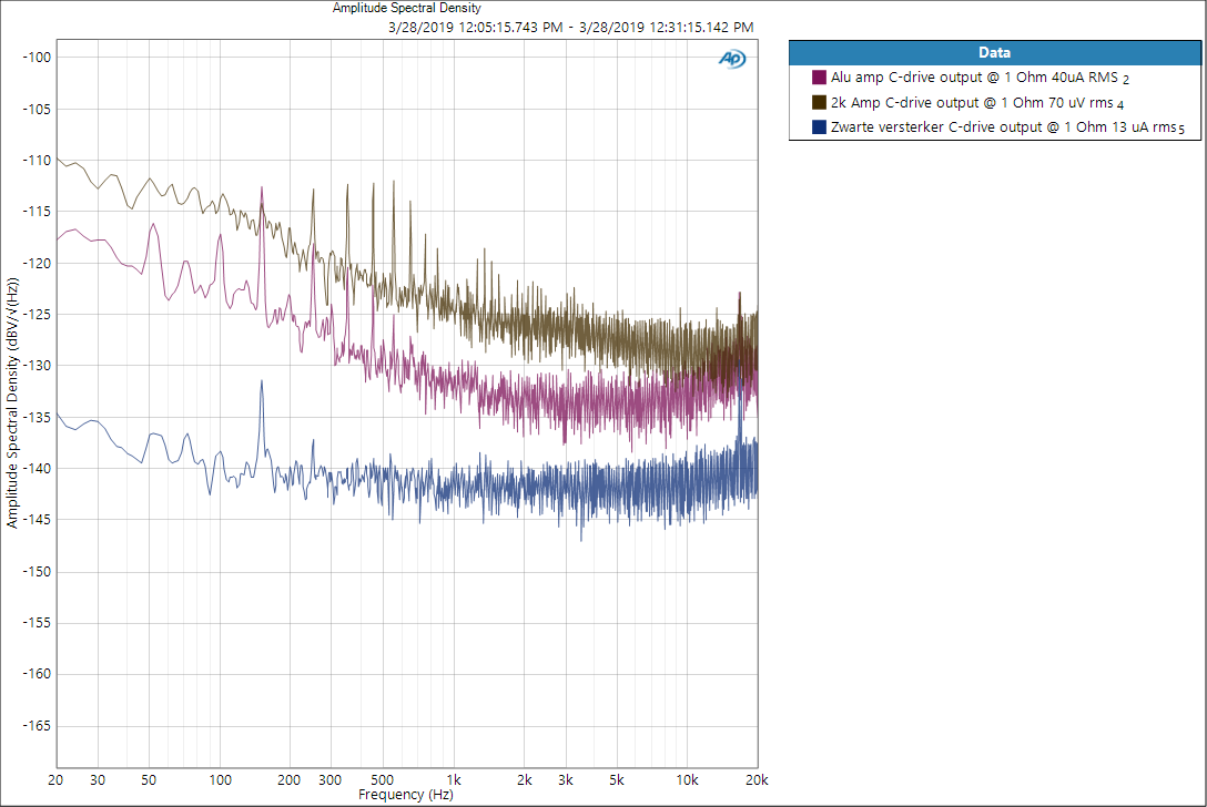

It isn't actually, but if you like noise!
Some measurements with this sensor:
LAX 100-NP | LEM
attachment.php
From top to bottom:
UCD2K ( BTL amp) Lem sensor
UCD180 BTL Lem sensor
UCD single ended current resistor 0,1R with opamp
The AKM has worse noise spec's than the LEM sensor! These Hall sensors are very noisy by nature...
And remember, with MFB the noise floor will be raised with 3-6db above the working range.

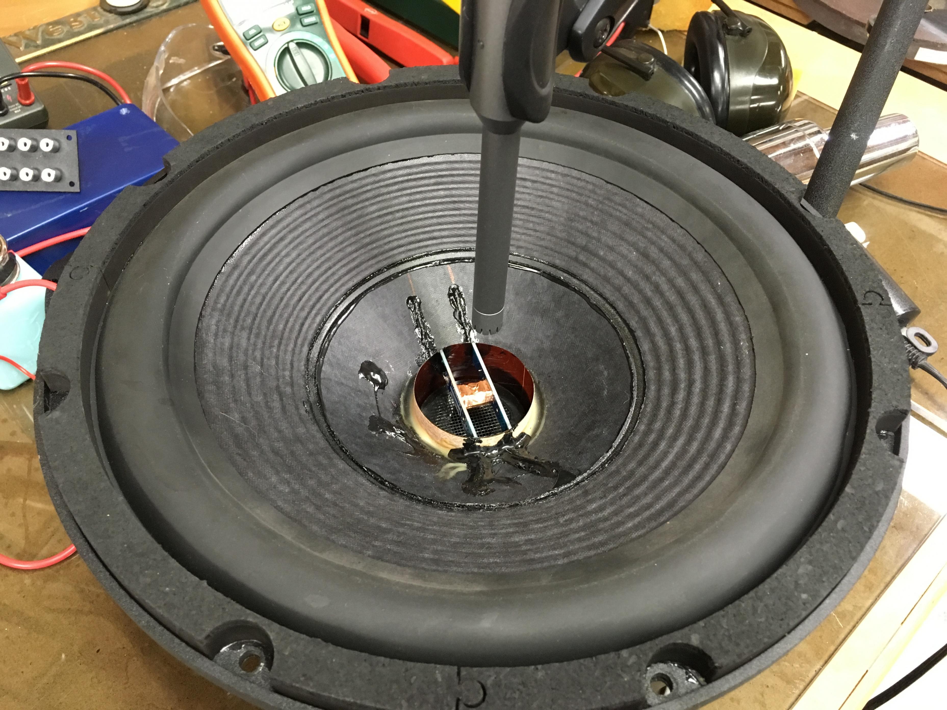

I've done a CSS SDX12 which looks promising too ...
attachment.php
attachment.php
So is the new AKM sensor THE device to use in future MFB-projects..?
I'm not convinced current drive is something worthwhile pursuing due to above mentioned thermal issues but am curious about its effect on distortion. I have not tried it yet because the tpa3116 amplifiers I'm using don't lend themselves to easy implementation due to their BTL design requiring a floating sense R while most implementations being single ended designs. The AKM employs a hall sensor offering a fully insulated sense R allowing it to be used with btl setups. It's usability in combination with MFB remains to be seen for reasons highlighted by ds23man but for use with midbass / mid channels - where adding accelerometers is critical from a mms perspective - the approach might do the trick.

Thanks Ben and Art for your input on the 60 Hz hum problem I mentioned in my previous post! Electronics is not my forte.
Not a heck of a lot I can do about that. ;).
I used the same shielded cable I was using for the old MFB system with the Philips driver. This cable starts right at the accelerometer terminals at the speaker. I do however have a second short run of untwisted wires for a flying female phono connector for convenience during testing - see picture. I did find that making a connection to mains power ground at the EVE power ground reduced hum a lot, but it didn't eliminate it.
The shielded cable is quite long (several meters) and I thought this might be an issue, but I replaced it with a very short one and it made no noticeable difference in the level of hum.
Make sure to ground the driver chassis, the StarBass connection board does so by connecting the - pole via the mounting screw. If that still gives no joy and the tinsel wires are the suspect you might want to try some mogami cable.
Aha! Thanks, Chris!
I didn't notice the grounding connection on the accelerometer connection board. I have it isolated with insulating washers at the moment so I'll correct that. This will have to wait as I am working on the enclosure now. More to follow...
