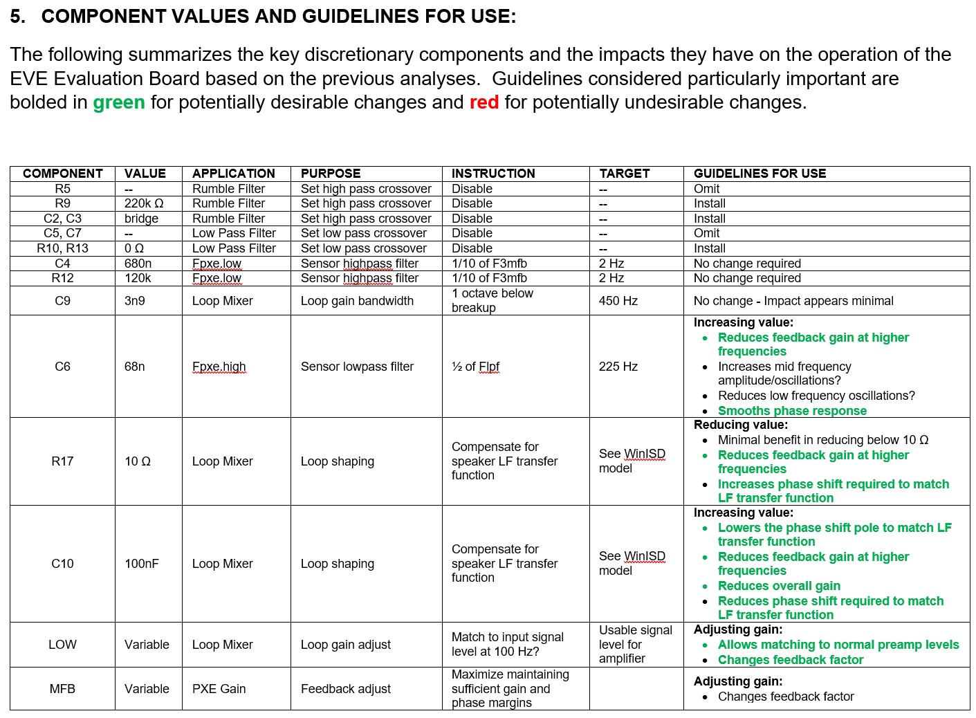

Upon review of all the analyses and trends they revealed, a table summarizing guidelines for component selection was generated.
Sound like it will be fine. 🙂

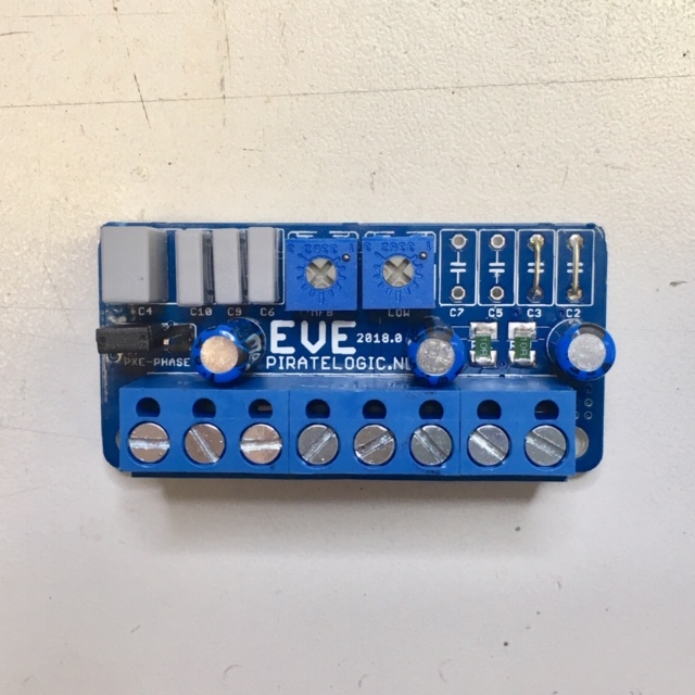

The optional components were ordered for populating the board based on the previous table. Some additional component values were purchased to allow for some tuning variability in C6, C10 and R17 later on. I also purchased an 8-position terminal block for external connections - this isn't in the parts list but is shown in a picture on Piratelogic's Facebook page.
Time to assemble the board! This is the first time I have used hot air and solder paste for SMD board assembly. After watching a few YouTube videos I purchased an inexpensive rework station and a syringe of solder paste and practiced on a sample board. After some tweaking of the nozzle size and air temperature and flowrate it seemed to work quite well and I added the surface mount components. Afterward, I did the standard through-hole parts. A top view of the completed board is shown below.

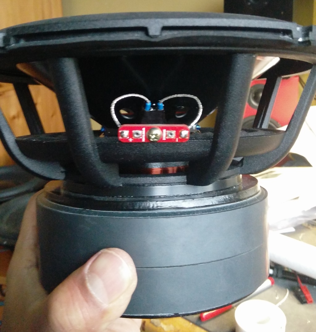

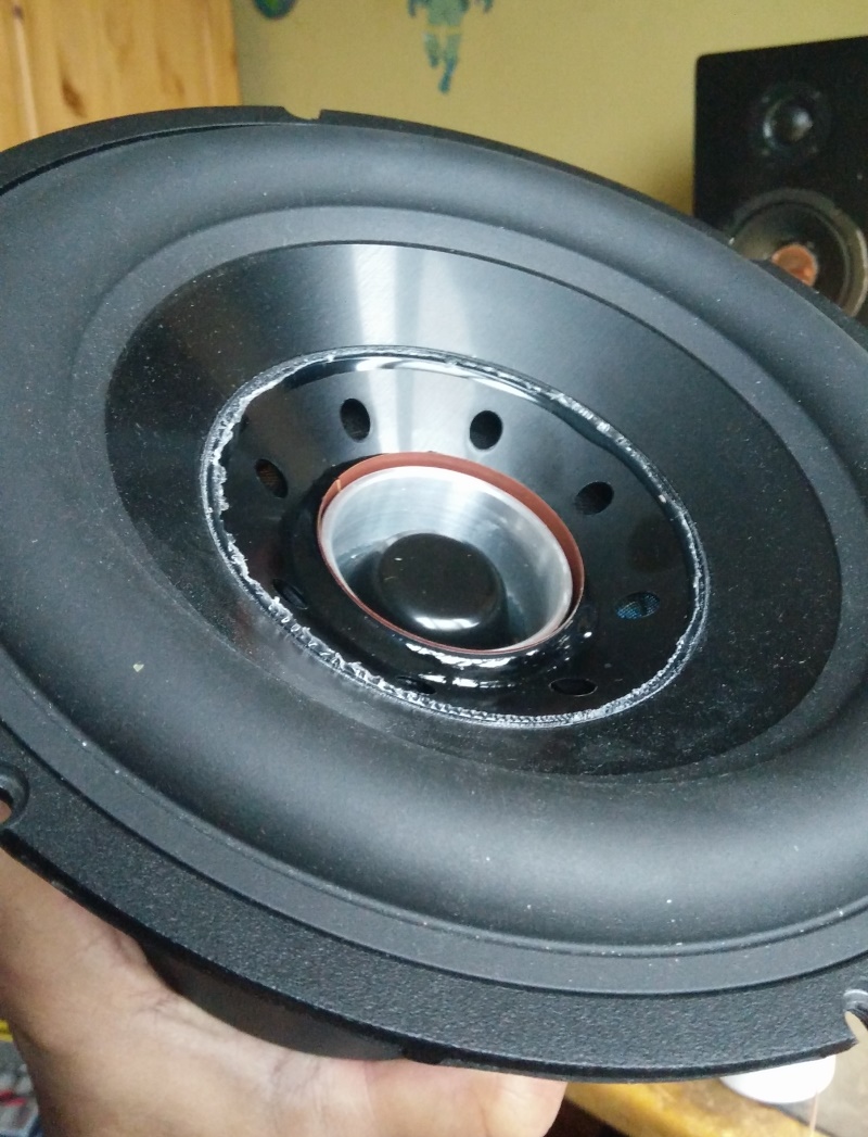

I'm close to updating the Piratelogic site with a whole bunch of new accelerometer developments such as the ClingOn which is geared towards drivers equipped with an extended polepiece that effectively disables the use of a StarBass.
For those who like to do some experimenting themselves, a limited number of V and VI prototypes is available via pb.
Hmmm. In this situation, maybe sometimes a tubular "voice coil former extender" might be an option to allow the use of a Starbass?
What is "pb" in this context?
I'm not sure what distinguishes a driver with an extended polepeice? do you mean the magnetic polepeice prevents attaching the sensor to the voice coil somehow? is this a typical construction on high xmax drivers?

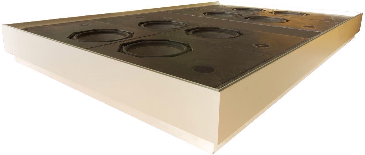

Have a look at what PS audio is doing, they are running a series of relatively small drivers in parallel to build SPL. You won't believe what daisychaining MFB drivers does to SPL until you've heard it.

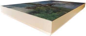

Below some images of a 15 cm deep servo painting we did a while ago sporting 8 individually corrected 7 inch drivers. It was used as a conference PA and fooled everybody inside into thinking it was just a painting. Until it started producing 30hz dubstep out of the blue :nod:
