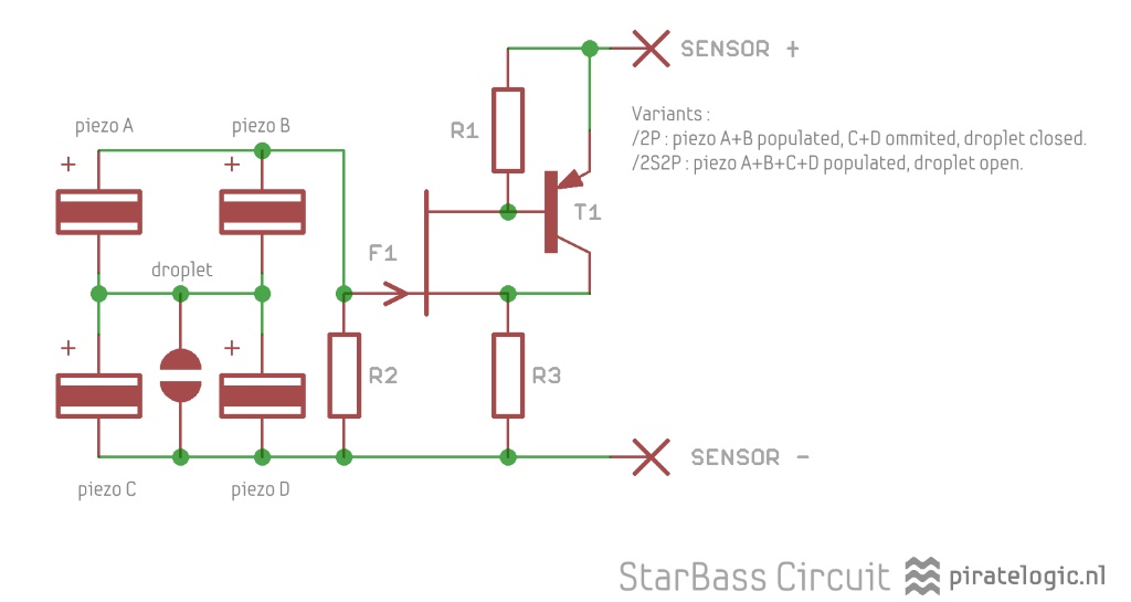

The StarBass V/2P as used by Rob follows this schematic:
attachment.php
The Murata PKGS-00LDP1-R shocksensors typically have an capacitance of 0.7nF making a total of 1.5nF for the /2P variant Rob is using. R2 is set to 39M resulting in a lower pole of 2.72Hz. The FR on page 3 of the datasheet looks disturbing with output decreasing below 20hz already but doesn't seem to effect the usage of the sensor as accelerometer sofar.
Is the circuit similar to the one Phillips had used?
Almost with the addition of T1 to linearise the sensor output.
If so, the -3dB down point might be the limiting factor. However, the EVE circuit can compensate for it using the shelving filter around IC1A. As an example, let’s say the -3dB down point of the accelerometer was 30Hz. The shelving filter can be used to compensate for this and provide flat response down to 3Hz...or whatever the user wants.
Correct, it is what Philips did with their original 532 design.

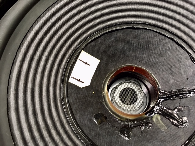

I have a couple of observations with regard to the tinsel wires that I wanted to mention at some point.
1. In my case, because the speaker was large (12"), the tinsel wires supplied were just a bit short. I actually extended them with short runs of standard wire along the outside surface of the cone where it wouldn't require flexure.
2. The tinsel wires need only be very fine to carry the signal, but perhaps they shouldn't be so fine for larger drivers. The extreme flexibility of the fine tinsel wires works against you.
Instead of having a simple predictable flexure with excursions, at some frequencies I would be willing to bet the very fine wire starts to vibrate in more complex modes. I didn't use a strobotac to observe what is actually happening, but it seems highly likely the extreme flexibility over a longer run will result in more problems with the tinsel wires hitting the back of the cone and breaking at fixing points.
If the unsupported run for the accelerometer connection is similar to the run for the very heavy voice coil wires on a large drivers, I think this needs to be addressed by using tinsel wires for the accelerometer that are more similar in gauge to the voice coil wires.
Because I had the above concerns, I shortened the unsupported run by not penetrating the cone for the tinsel wires until nearly 3 inches radius from the centre on the ACI SV12 driver.

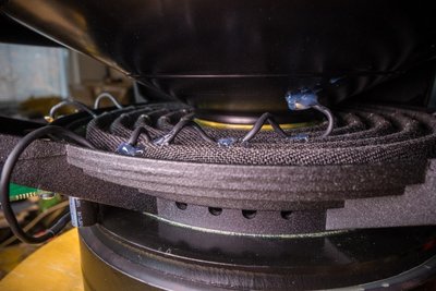

Here's how Rob@mfblabs is fixing his ultraflex mogami connection wires :

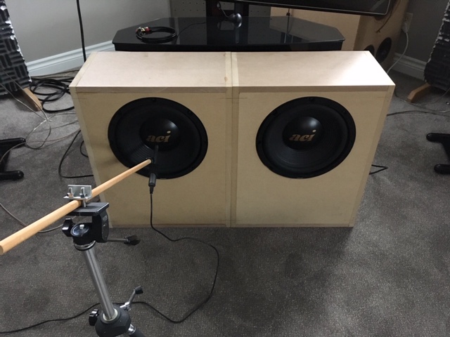

I put together the second subwoofer. Things went a lot quicker with the second one!
The first picture shows the two channels sitting on the floor. The measurement microphone can be seen positioned for near field measurement of the left channel.

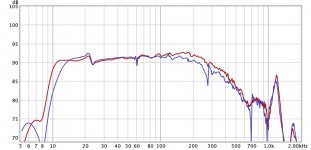

The high-pass (Rumble) filter was enabled on the EVE board to help address the resonant peak at 11 Hz. The table contained in piratelogic.eve.2018.0.manual.en.pdf has high pole frequencies starting at 21 Hz and a Q of 0.5. Instead of this, I used an online calculator and available components to produce an Fs of 16.8 Hz and Q of 0.65.
The second picture compares the left and right channel measurements with similar feedback settings. Red is right and blue is left. The right enclosure has ample damping material. The left enclosure has none. The room is known to have a first modal at around 22 Hz.
Note the relative absence of the 11 Hz resonant peak that appears in previous posts. This is interesting because it cannot be fully explained by the addition of the relatively gentle high-pass filter. Maybe this was largely due to the measurement setup previously used in the workshop?
Can you show a FR for both without MFB ? I wouldn't be surprised to see the red one dramatically worsen - mfb has a tendency to eat away both driver as enclosure resonances - and to some extend even room modes.
Good question, appears the peak wasn't caused by anything within the control loop then ... ?

It is working pretty well! I'll do another measurement when I get a chance. I'm pretty sure the resonance at about 280 Hz will be addressed by damping material. You can also see it in Post #67 where no damping material was used and it disappears in subsequent measurements after the damping material is added.
That's the way it appears. Maybe 11 Hz input excited the natural frequency of the portable workbench the speaker was sitting on. Or something like that...
