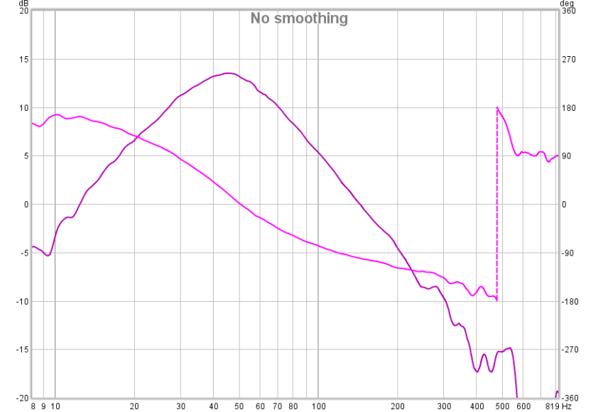

I am out and don't have access to respond to your post properly right now, but IIRC this was A/B where A was the response without feedback and B was the response with feedback.
Hopefully attached pic will clarify. To get the open-loop response that is needed to evaluate phase margins you need to measure the response around the whole signal path encompassed by mixer, filters, amp, woofer, accel, preamp-filters, and back to mixer. You can break the loop at any point to make this measurement.

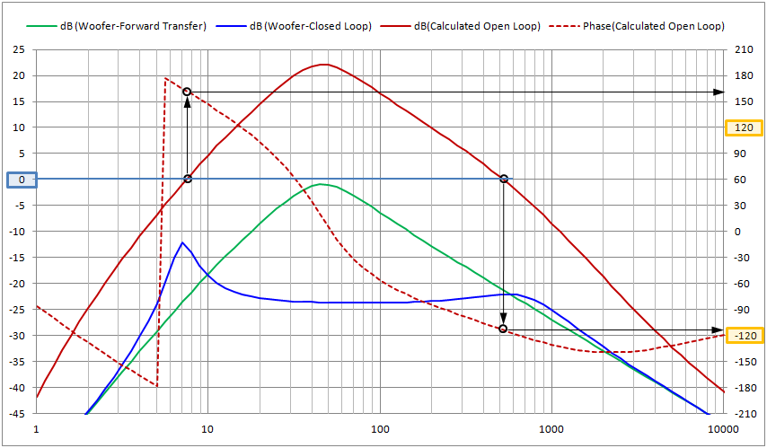

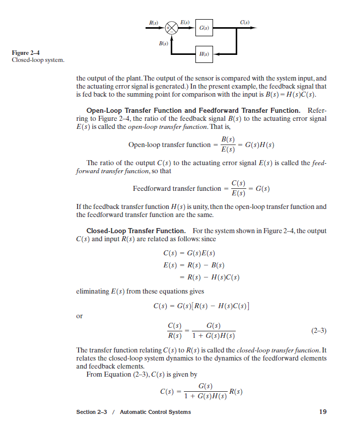

Attachment #1: Here is an summary and definitions of the terms used when discussing feedback control systems. The open-loop transfer function is what we need to measure to optimize phase margins. In amplifier design it is often called loop gain. What most people people call the open loop response (ie no feedback used) is usually called the feed-forward transfer function or simply the forward transfer function. Back in college days I used to use the acronyms OLTF, CLTF, and FFTF.
As mentioned in Post #120, the easiest way to measure the OLTF with the EVE setup is to input a signal to the power amplifier and measure the response coming out of terminal X1-5. Alternatively, if you measure the CLTF and FFTF as you did back in Post #92 you can calculate the OLTF.
OLTF = (FFTF-CLTF)/CLTF
Attachment #2: Using your TINA-TI example, I exported the FFTF and CLTF responses to Excel and plotted them along with the calculated OLTF. Also shown is how to determine the phase margins be locating the point where the OLTF gain crosses 0dB and finding the phase at that point. Generally you would like to keep it within +/-120degrees or better to avoid response peaking and marginal stability. It is also desirable for the response slope to be first order(+/-6dB/oct) when it crosses 0dB to guarantee stability. In this case, you can see we have only about 20deg phase margin at LF (180deg - 160deg)
Attachment #3: I used REW to perform the same calculations with your data from Post #92.
I can provide some step-by-step screen shots of how to do this if needed...just let me know.
