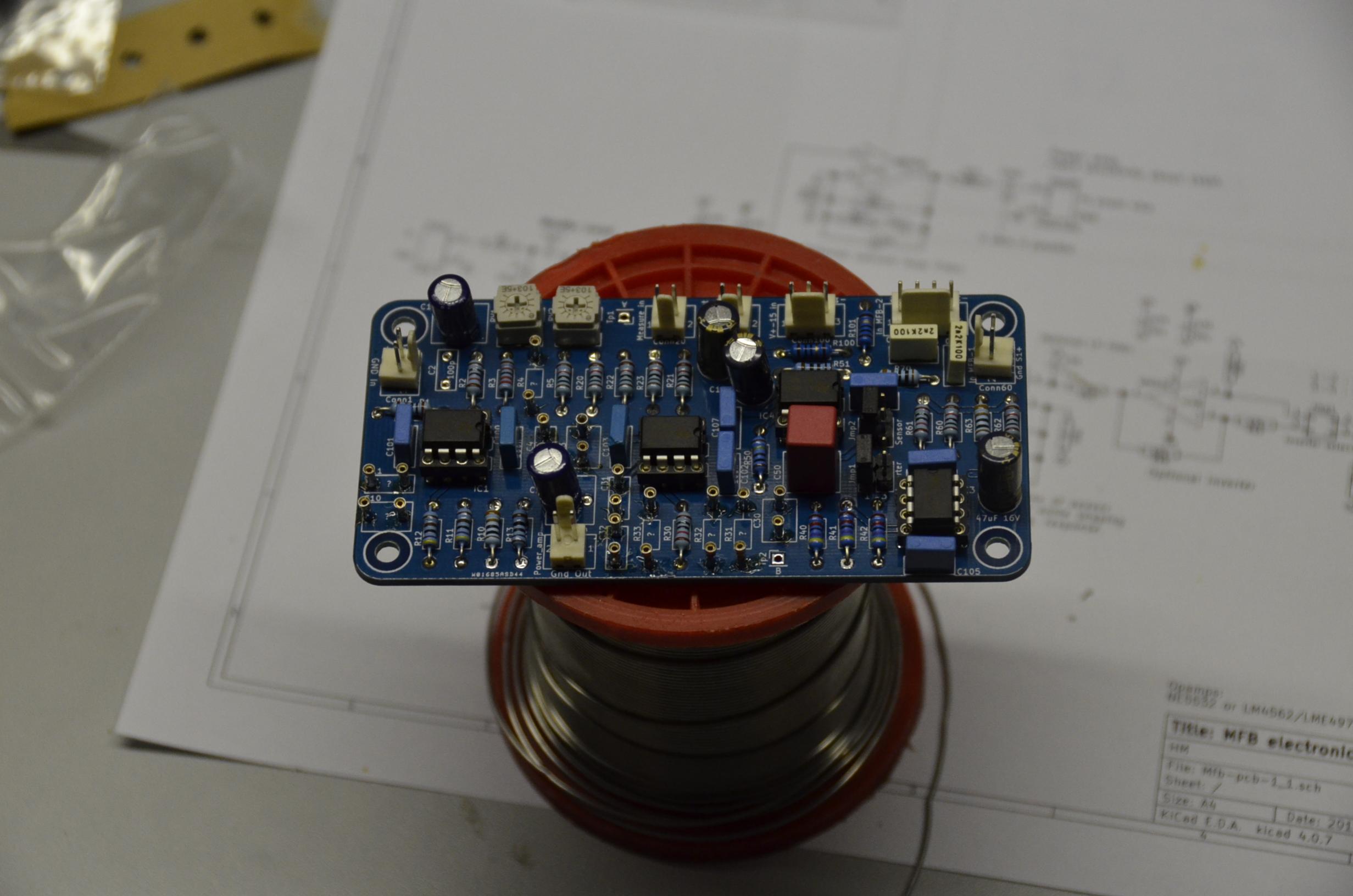

Thanks. But i am being lazy because the whole circuit isn't more complicated than a typical e-crossover. Piece of cake, if you also have a DSP for inevitable final in-situ EQ (attention rscamp)....Mr. bentoronto. Please report to mfblabs...
I got stuck last year trying to wire-up an R&D circuit that permitted going from an accelerometer input to a bridge velocity input with a single DPDT switch. It can be done.

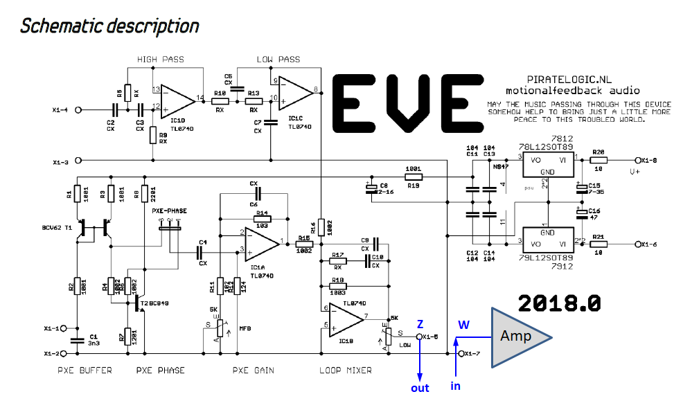

Good question which I'm getting more often these days, to answer it I'm preparing some extra about content, stay tuned.What does being a pirate mean in the Netherlands? In Canada, piracy is an act of robbery. 🙂.

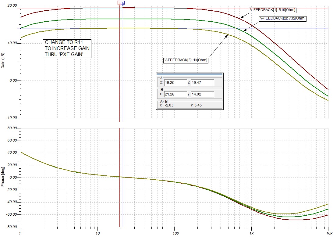

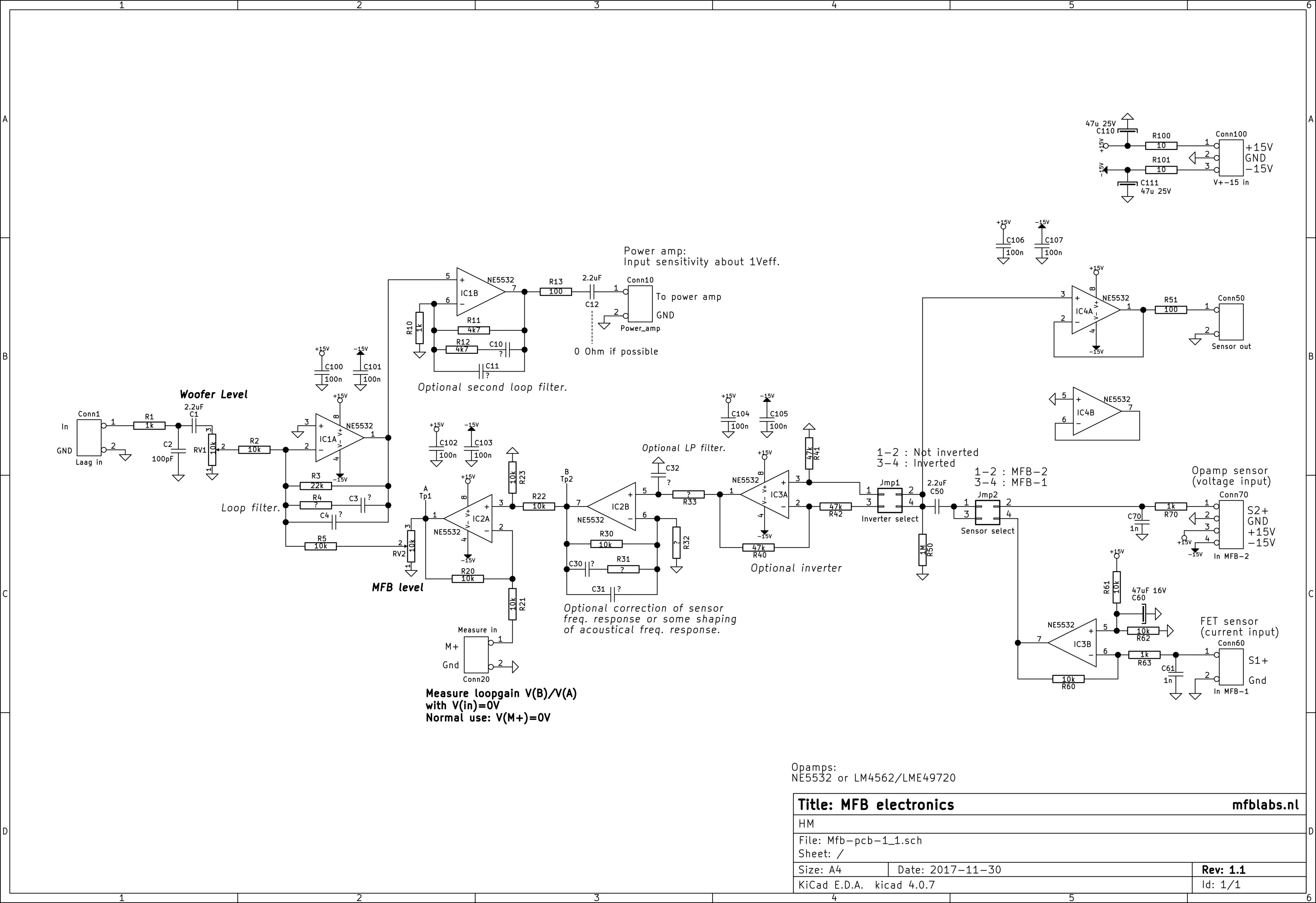

Thanks. I think I'll adjust R14 and C6 to achieve the increase in gain for the feedback. This way, I don't think the MFB pot will get more sensitive to adjustment.

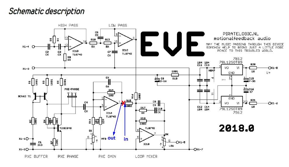

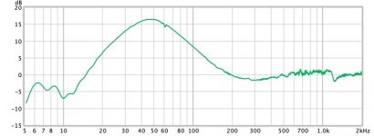

I share your view that a means for measuring open-loop response is needed to optimize the stability-vs-gain for maximum distortion reduction.

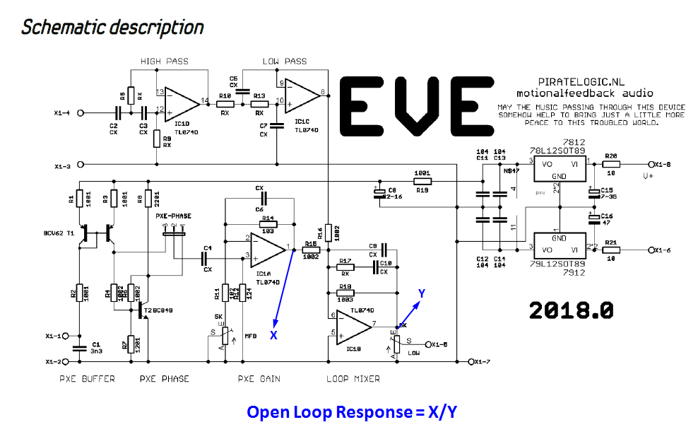

Attachment #1: Shows the ideal way to do this, breaking the loop at the red X. Input signal into R15 and measure the open-loop response at the output of opamp IC1A. With thru hole parts you would just lift one end of R15 to run the test. However, with surface mount parts this may be easier said than done.
Attachment #2: Since you are using REW, you can calculate the open-loop response based on two closed-loop measurements at points X and Y. Then use REW math functions to divide X by Y to get the open-loop response. If possible, use the second channel as a loop back timing reference to ensure the phase of the two signals share a common time reference. Commercial motional feedback woofer available sort of

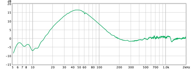

Concerning the 13Hz Anomaly:
Pretty much all electret or condenser microphones contain a similar anomaly, but usually it is well below 10Hz. I believe it is related to the small air leak used for equalization of pressure inside the capsule with the changing ambient pressure and temperature. An open-loop response would confirm that it is not originating with the woofer or MFB electronics. Alternatively, you could measure another woofer in another box and see if the anomaly follows the microphone not the woofer.
Concerning LF stability:
Anything you can do to avoid phase advance at low frequencies will improve phase margin and stability. Not having an open-loop measurement yet, you don’t know what your phase margin is, but I would guess it to be < 30deg based on the amount of peaking in the response. Lowering your sensor HP filter will help(0.1Hz would be good). Check what the HP filter is in the input of your amplifier, you may be able to gain some phase margin by increasing the size of the input coupling capacitor. Also, as you mentioned in post#90, increasing the value of C10 will retard the phase and improve LF phase margin. With C10 = 100nF the integration turn over frequency is about 16Hz. You might consider lowering it to 7Hz by increasing to C10 220nF. This will provide incremental improvement in LF phase margin. All these sources of phase advance stack up so it is worthwhile to hit them all if you can. I posted a set of measured open and closed loop trends for a matrix of loop gain and integration turn-over frequency. It may help understand the interplay between the two. Commercial motional feedback woofer available sort of
Not included in the trends is the effect of R17 which can help keep loop gain from falling too much at higher frequencies when you increase C10.
Similarly, pushing the turn over point of any LP filters in the loop as high as possible will avoid unnecessary phase lag and improve HF phase margins…which you have already taken advantage of by changing C6. Once you get an open-loop measurement, you will be able to see for sure how high you can push it while still avoiding intrusion from cone break-up modes.

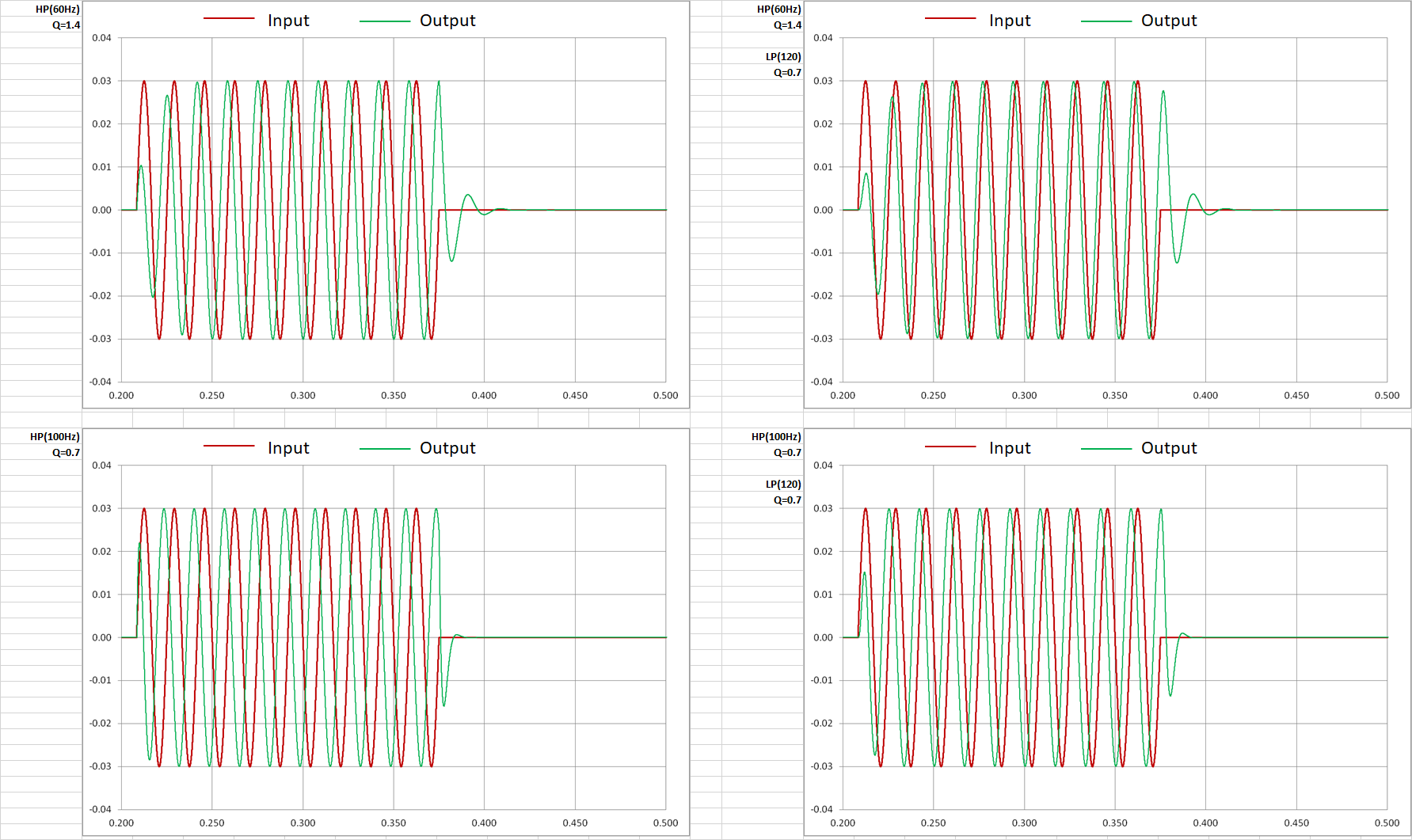

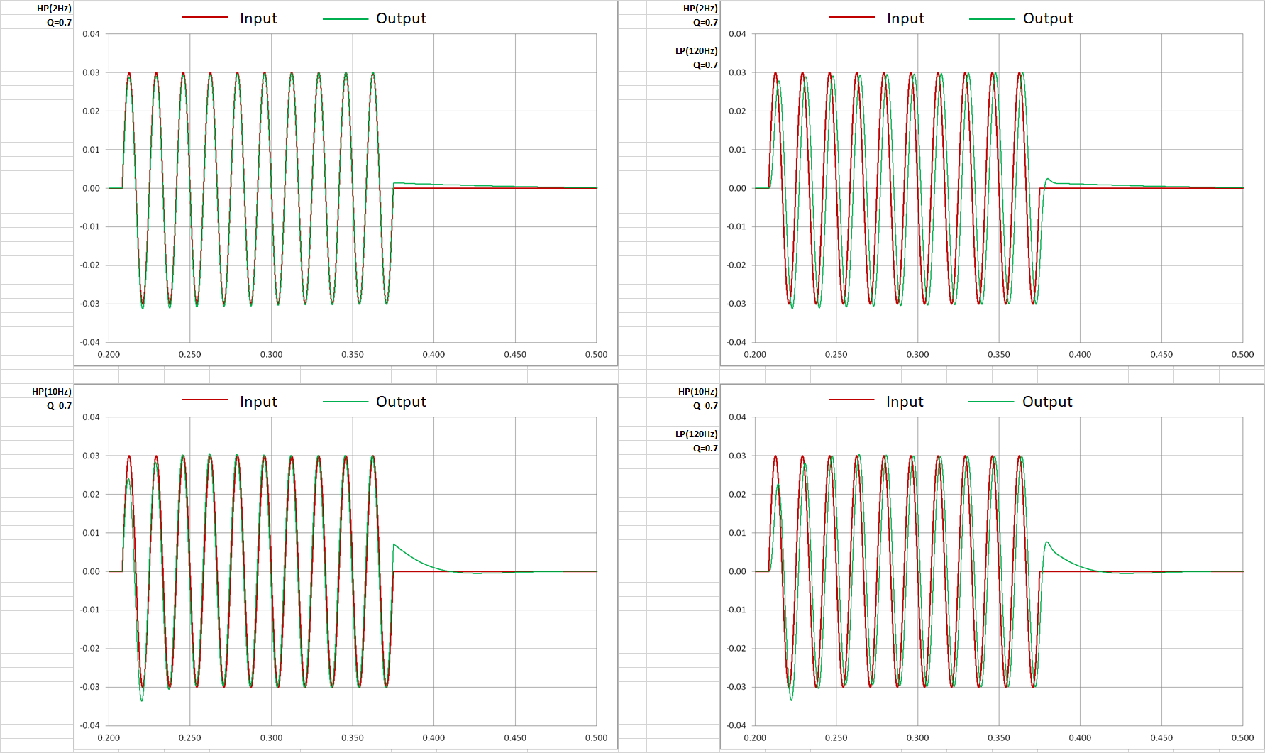

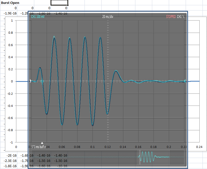

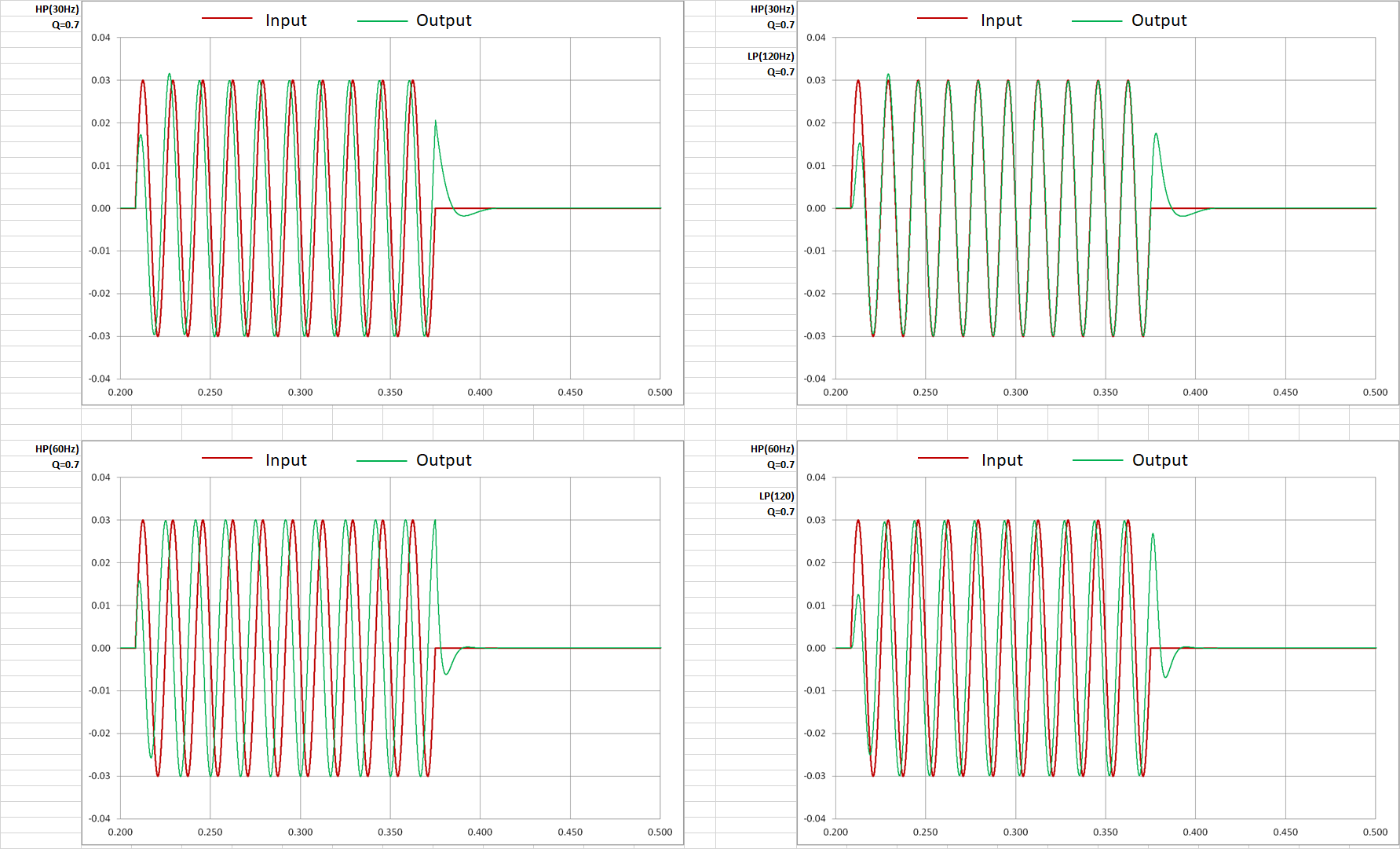

As we have discussed several times in the past, the way tone bursts look(and sound) has nothing to do with MFB taking a “firm hand” with the driver, although that is exactly the picture I had in my mind when I starting experimenting with it. Commercial motional feedback woofer available sort of…The MFB burst starts with a visibly (and probably audibly) bigger kick. That is what "fast bass" means…With MFB muscling the driver around, tone burst results can look very different according to the freq chosen.
When stable, a MFB woofer system is a minimum phase device. As such, it can be thought of as just a black box with an input and an output. Measure the impulse response, or frequency response, and you have determined how every other signal (tone burst etc) will look like when it is “processed” by the black box. However, it tells you nothing about what is in the black box. It could be a MFB system, or it might be just a DSP equalizing the response.
By way of example, I took the responses plotted in Post #92 and curved traced them. Then performed IFFT to get the impulse response. Finally, ran a 5 cycle 50Hz tone burst thru the impulse response by convolution and compared with the measured tone bursts plotted in Post #94 (see Attachments #1 & #2). Not a perfect match, but amazingly close considering the curve tracing and required LF extrapolation/interpolation of the response data. If rscamp had posted the impulse response file in *.wav format, it would have matched perfectly. In fact once you have the impulse response, you can calculate the burst response for any frequency much quicker and easier than measuring...well, if you have access to convolution software.
Indeed, the "super fast" beginning and end of a LF tone burst contains HF information. A spectrogram display(frequency content vs time) of a burst illustrates this nicely…I have one somewhere but can’t locate it at the moment. When a woofer includes a LP filter, you will see a rate limit to the slope of the burst onset dictated by the LP filter frequency. I managed to locate a set of trend plots I made some years ago showing 10 cycle 60 Hz burst for a range of LP and HP filter settings.Not exactly clear to me why a sub (or any driver) should play nice tone bursts. The burst starts with a super fast acceleration and ends with a super fast abrupt stop.
Attachment #3: LP(2Hz), LP(2Hz) + HP(120Hz), LP(10Hz), LP(10Hz) + HP(120Hz)
- notice how the slope of the burst onset is limited by the LP filter
Attachment #4: LP(30Hz), LP(30Hz) + HP(120Hz), LP(60Hz), LP(60Hz) + HP(120Hz)
- notice the LP filter advancing the phase, and the HP filter retarding the phase
Attachment #5: LP(60Hz, Q=1.4), LP(60Hz, Q=1.4) + HP(120Hz), LP(100Hz), LP(100Hz) + HP(120Hz)
- notice the underdamped LP 60Hz filter makes the burst amplitude take longer to build and die away

I have been observing the anomaly under all conditions - different amplifier, different measuring distance, open loop, closed loop, etc. I too thought the microphone was the culprit but didn't know why. The UMIK-1 specs only claim performance down to 20 Hz so a few days ago I searched for information on using this microphone below 20 Hz. I didn't find anything very useful so I did a very simple experiment. Without feedback below Fs, the amplitude of the driver motion should become a constant (compliance-dependent region). I closely observed the speaker amplitude as I manually swept the frequency downward and I saw this constant amplitude with no anomaly in motion around 13 Hz. So by this observation I ruled out a problem with the speaker in my own mind. Now your information fills in the gap. Thanks!
There is a lot to think about in your comments about LF stability so I'll digest that some more and then comment in another post.

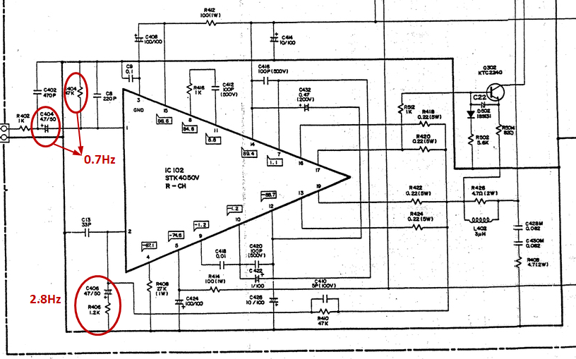

Being a closed box system, the speaker has 180 deg. phase advance as it passes down through Fs. Is it not desirable for the loop filter to mimic this to keep these from getting too far out of phase? The EVE circuitry certainly has this characteristic. When "optimizing" the loop filter in TINA, I looked for a similar phase advance for the loop filter relative to the speaker in combination with good attenuation at higher frequencies to avoid oscillation at higher frequencies due to a resonant condition in the accelerometer mount or whatever ugliness might be up there.
Yes. Modelling with TINA and quickly trying a slightly larger value for C4 seems to confirm this. I ordered a much larger cap to try out. I'm guessing from what I have seen so far it might be worth another couple of dB of feedback gain.
It would have taken me a very long time to even think of this! 🙂
I did try a larger value of C10 (150 nF) and didn't see any improvement in the LF resonance. Modelling in TINA also shows only a very slight difference in LF phase response by going to 220n. Am I missing something?
The amplifier is in this post.
Update:
C6 and R14 interact so for a near identical transfer function with more gain through "PXE GAIN" I increased R14 from 10k to 22k and reduced C6 from 22n to 10n. Feedback gain increased enough to provide sufficient adjustment with the MFB pot with no observed detrimental effects.

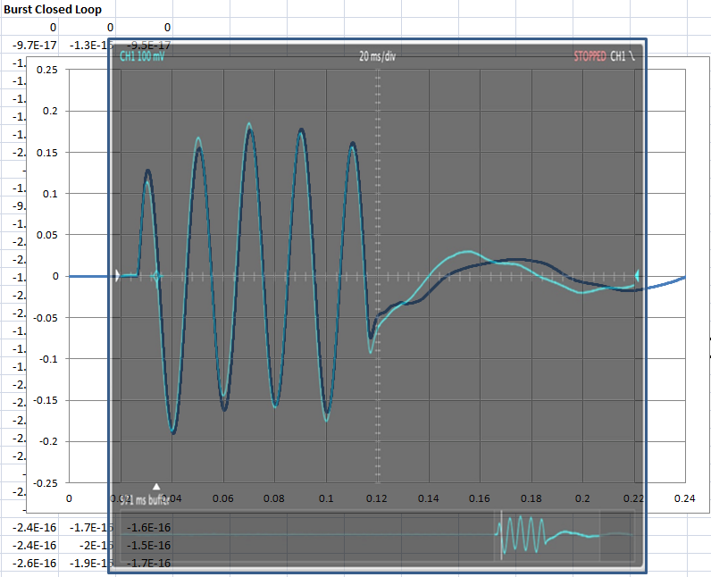

As we have discussed several times in the past, the way tone bursts look(and sound) has nothing to do with MFB taking a “firm hand” with the driver, although that is exactly the picture I had in my mind when I starting experimenting with it....
When stable, a MFB woofer system is a minimum phase device. As such, it can be thought of as just a black box with an input and an output. Measure the impulse response, or frequency response, and you have determined how every other signal (tone burst etc) will look like when it is “processed” by the black box. However, it tells you nothing about what is in the black box. It could be a MFB system, or it might be just a DSP equalizing the response....
Great to have input from Bolserst. As Alexander Pope said of Newton, 'Nature and Nature's laws lay hid in night:God said, Let Newton be! and all was light.'
Doggerel aside, let us say MFB can be considered "nothing but" a black box with a perfect speaker and band filtering. Aside from inconceivably sophisticated fixin', how else to make a perfect speaker?
Granted, one can conjure up tone bursts resembling the MFB which meet my tired-eye-ball standard using filters. But MFB seems the coherent way to do it and else besides.

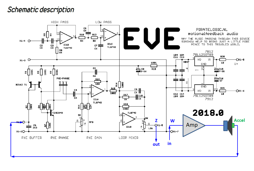

It just dawned on me that you don’t have to break the loop at the traditional feedback point to measure the open loop response. You can break the loop anywhere along the path and get the same results. In your case, you pretty much have one built in at the interface between the EVE board and your power amp. Be sure to calibrate your soundcard with loop back test so that a gain of 1x will show up as 0dB in the open-loop plot. Getting set up for measuring… I thought of soldering some 30 AWG wire to a flying 2-pos header to get access at the output of IC1A as you suggest. But I kinda petered out on this when I started to have some success.
When observing the accelerometer response, wouldn't the result at X1-5 be coloured by the Loop Mixer response? And if the feedback loop is broken, no acceleration signal will be seen at X1-5 at all. But again, maybe I'm missing something...

Can you clarify what measured signals you are using, and what math you performed on them?…The plot I was thinking of doing is now done! See the image below. I like this because it shows feedback factor vs frequency.
Hopefully attached pic will clarify. To get the open-loop response that is needed to evaluate phase margins you need to measure the response around the whole signal path encompassed by mixer, filters, amp, woofer, accel, preamp-filters, and back to mixer. You can break the loop at any point to make this measurement.When observing the accelerometer response, wouldn't the result at X1-5 be coloured by the Loop Mixer response? And if the feedback loop is broken, no acceleration signal will be seen at X1-5 at all. But again, maybe I'm missing something...
I'm not aware of a way to import measurements into SPICE type circuit software, but it may be possible. What I do is measure from the power-amp input to the output of the accelerometer preamp. I import that into Excel where the closed loop response can be calculated for any combination of feedback filter, forward path filter, and gain. Once you figure out how to use Excel's intrinsic complex number capability, calculations like that are actually fairly simple.This makes me think that the next logical step is to somehow take a representation of the actual transfer function of the feedback and put that into the circuit analysis software to find the actual gain and phase margins. Is that possible?
