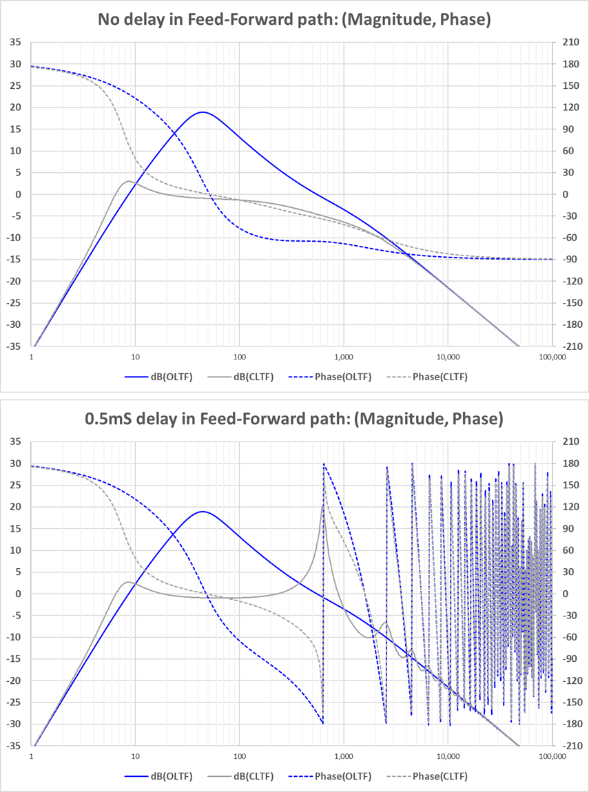

…Phase sure is an issue with speakers that have resonances within their bandpass. But if we are aiming only for 20-200 Hz*, the phase margin stays within about 90-degrees. Funny stuff outside that band is tolerable or manageable, so long as there's no oscillation…
That is the trick of MFB stability. You have to attend to the phase well outside the bandwidth of interest if you intend to use more than a few dB of loop gain to combat distortion.

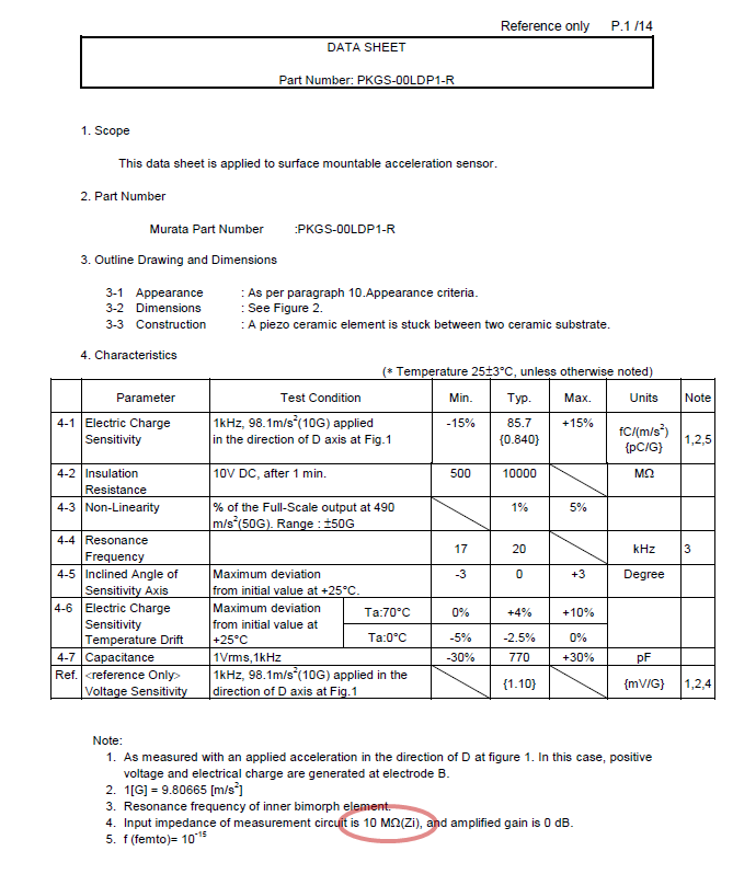

The Murata PKGS-00LDP1-R shocksensors typically have an capacitance of 0.7nF making a total of 1.5nF for the /2P variant Rob is using. R2 is set to 39M resulting in a lower pole of 2.72Hz. The FR on page 3 of the datasheet looks disturbing with output decreasing below 20hz already but doesn't seem to effect the usage of the sensor as accelerometer sofar.
Most likely the measurement setup used had a lower input impedance than 39M, and of course a single sensor instead of two which would raise the roll-off frequency by an octave. I see mention on their website of a 10M input impedance being used, but it was not specifically associated with the plot in the other data sheet.
https://www.murata.com/en-us/products/productdata/8797617029150/00LDP1-E.pdf

When you are asking about current feedback, I am assuming that it is related to converting the inuke into a current source as detailed in the RMS whitepaper? If so, I don’t think it would be a good candidate because it lacks the recommended first order roll-off at HF that the Hypex modules inherently have.
…Note the relative absence of the 11 Hz resonant peak that appears in previous posts. This is interesting because it cannot be fully explained by the addition of the relatively gentle high-pass filter. Maybe this was largely due to the measurement setup previously used in the workshop?
That is interesting, especially since the large peak was suggesting extremely small phase margin which didn’t seem to match up with the gain or filters you were using. That was one of the reasons I had asked chriscam about the LF capability of the sensor.

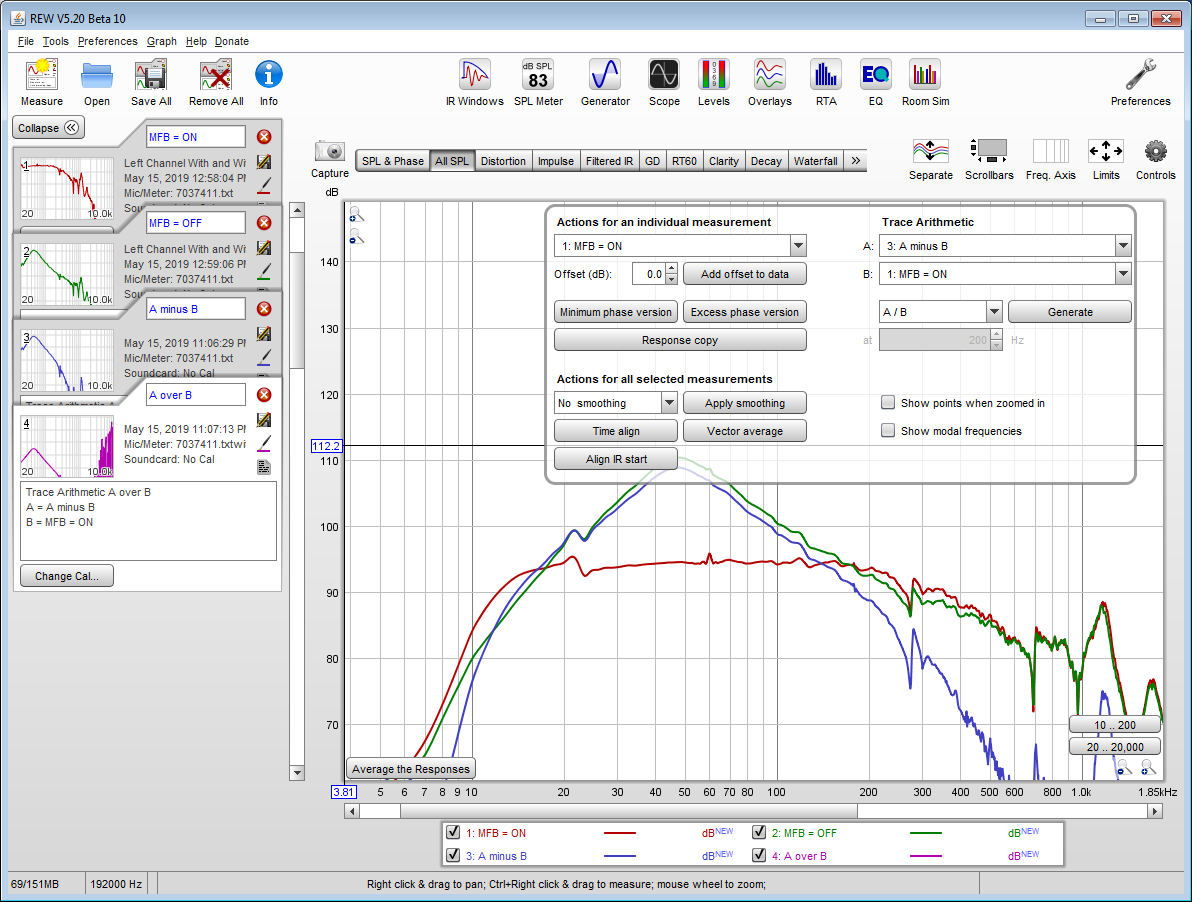

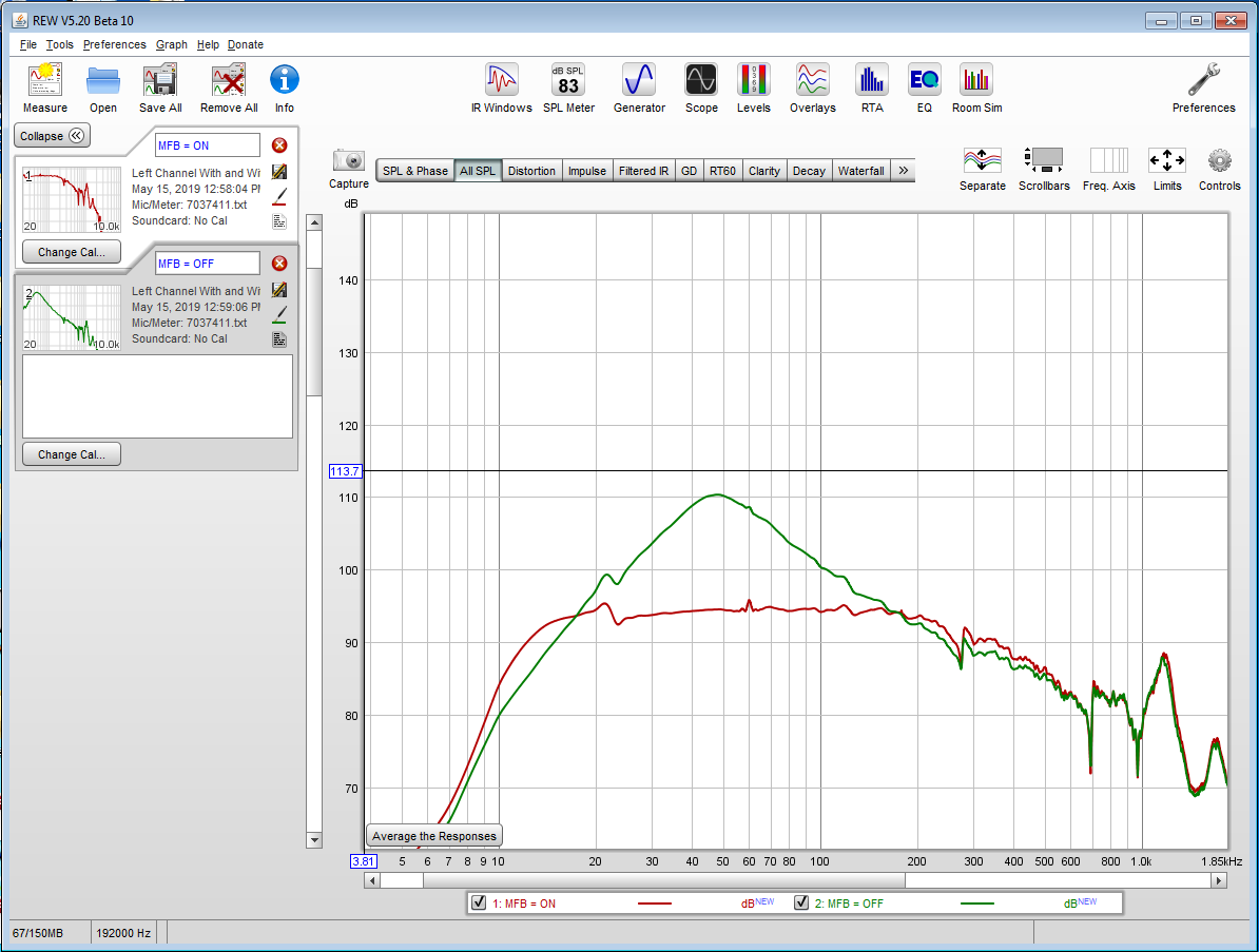

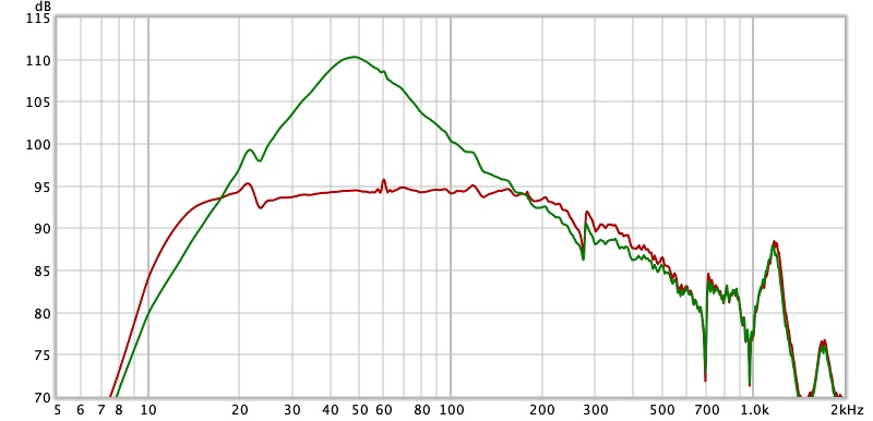

I'm having a busy week, but I did a quick grab for the left (no damping material) channel. I included an image below but the REW file was too large to post here. PM me an email address and I can provide a shareable link to the REW file.
Thanks for the REW file.

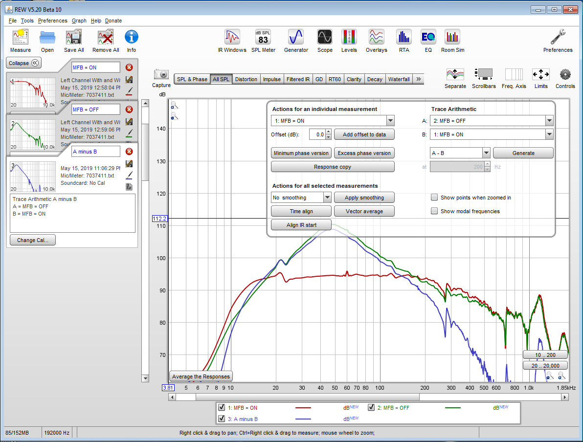

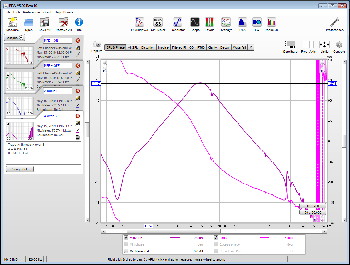

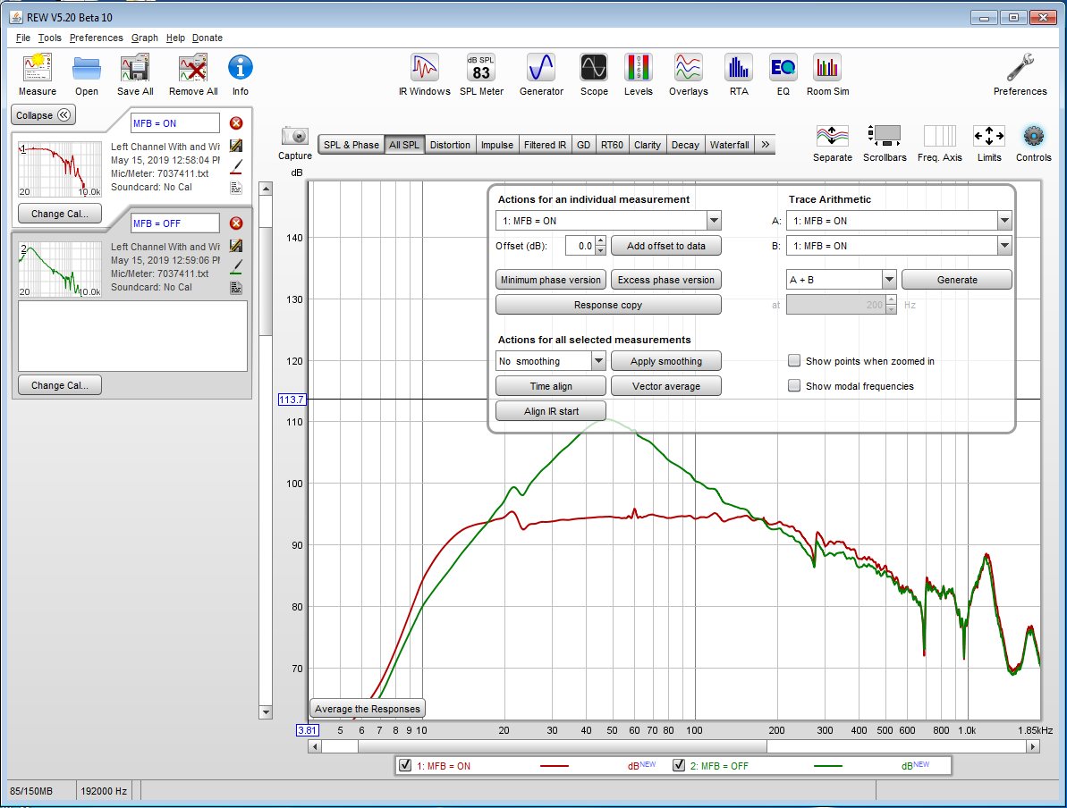

Here are the steps to calculate the OLTF which is needed to determine phase margin.
Step 1: Label the two measurements appropriately and then click on the [All SPL] tab.
Step 2: Click the "Controls" icon to bring up the dialog box to perform arithmatic
Step 3: Load the "MFB=OFF" measurement into slot A, the "MFB=ON" into slot B, select the arithmetic operation "A-B" and then click the [Generate] button
Step 4: Load the "A minus B" result you just generated into slot A, change the arithmetic operation to "A/B" and then click the [Generate] button
Step 5: Switch to the [SPL & Phase] tab, select the Final result generated in Step 4 and adjust the scales appropriately to be able to comfortably view and identify the phase at zero dB crossing with the cursors.
Looks like you could increase loop gain about 5dB and still have an acceptable 30deg phase margin. I will take a look this weekend to see if there is any minor changes in filter components that would improve this phase margin further.
