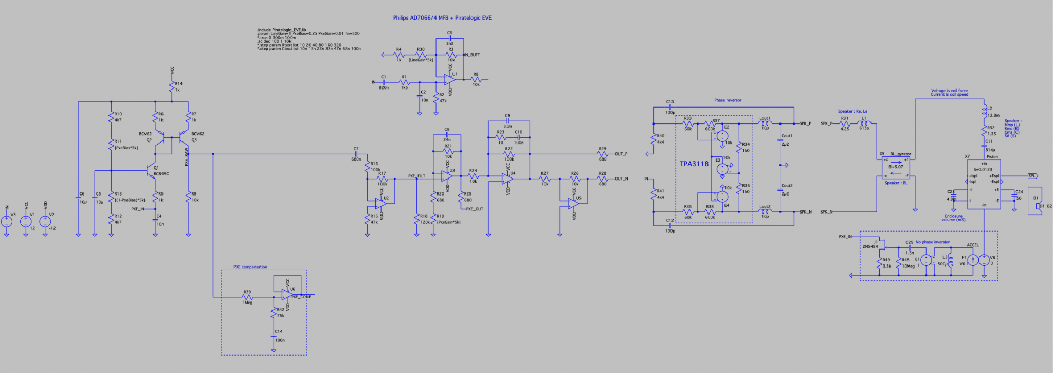

Dear all, I prefer to continue on that old topic instead of create a new one because I think it could be a source for some others MFB beginners like me.
I'm trying to simulate a MFB system based on old Philips AD7066/4 MFB driver and Piratelogic EVE board from chriscam.
I've started with the impressive work from steph_tsf (whose seems not longer available on this forum) to simulate the driver and enclosure. I've added a simplified model of a class D amplifier I wanted to use (TPA3118 from a diyaudio thread). I've modelled the latest EVE board electrical schematic with LTSpice.
This thread is an amazing source, especially bolserst posts about phase margin evaluation.

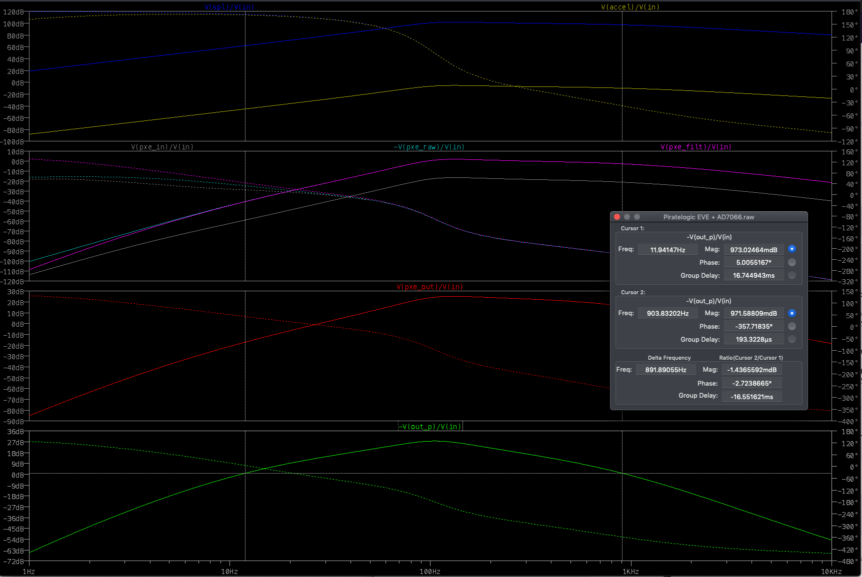

Please see the attached files. What is disturbing me is the evaluation of open loop transfer function. From the input signal (at the entry of TPA3118), voltage and current into the speaker are quite in phase (not so much delayed), then the acceleration of the membrane and so the SPL are also coherent (for a speaker), but then after PXE sensor and the others electrical filters, the phase is shifting (delayed ?).
At the end the OLTF presents a phase close to 180º at 1Hz, but -364º at 1kHz ! If I wrapped the phase, it's worst ! It doesn't follow at all the figures from the post #147 from bolserst.
I'm not use to evaluate feedback loop and phase margin, is somebody can help and explain what is going wrong or I've missed ?

Without having a proper 2 channel measurement of the in-box accelerometer including its phase you cannot accurately sim the loop. The processsor in its most crude form is basically a leaky integrator aka a lowpass or a shelf with a very low corner frequency. That integrator or shelf is necessary to reduce the phase angle at the frequencies around and below Fbox with 90 degrees. Post 148 by Bolserst sums it more or less all up.
  • Thank You
Reactions: chriscam
Many thanks for your help. I've already extensively red EVE documentation and try to understand 22RH541 documentation but my knowledges are limited on feedback systems.
I guess that my point (I can not understand) is more at high frequency. The circuit called PXE compensator in my simulation is, I think, able to lower the F3 from PXE and increase the low frequency phase margin if I plug it between PXE_RAW and C7=680nF, isn't it ?
Why I exceed by far the -180º in the upper frequency range, contrary to the post #147 and #148 ? If I understand well, an integrator will have -90ª shift at high frequency which would be worst and a shelf will have no impact at high frequency.
Sorry for my beginner questions, maybe I miss a basic knowledge of feedback. Can it be possible to have a feedback shifting more than -360ª the complete signal and in this case, the integrator is there to put the low frequency in the range of <(-360+180º) ?
To be honest: I do not understand that PXE section It looks like a low pass to cut of the piezo output, possibly to kill a resonance of the accelerometer, but as such it negatively impacts phase where you do not want that to happen. The whole problem of the loopshaping is that improving phase margin in the low end tends to impact the phase margin the high end...
