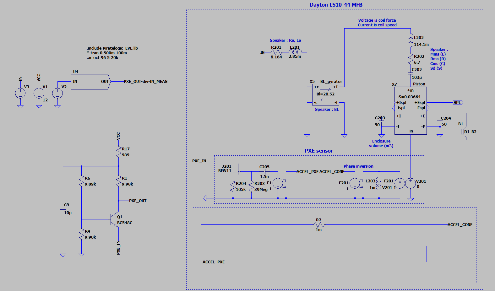

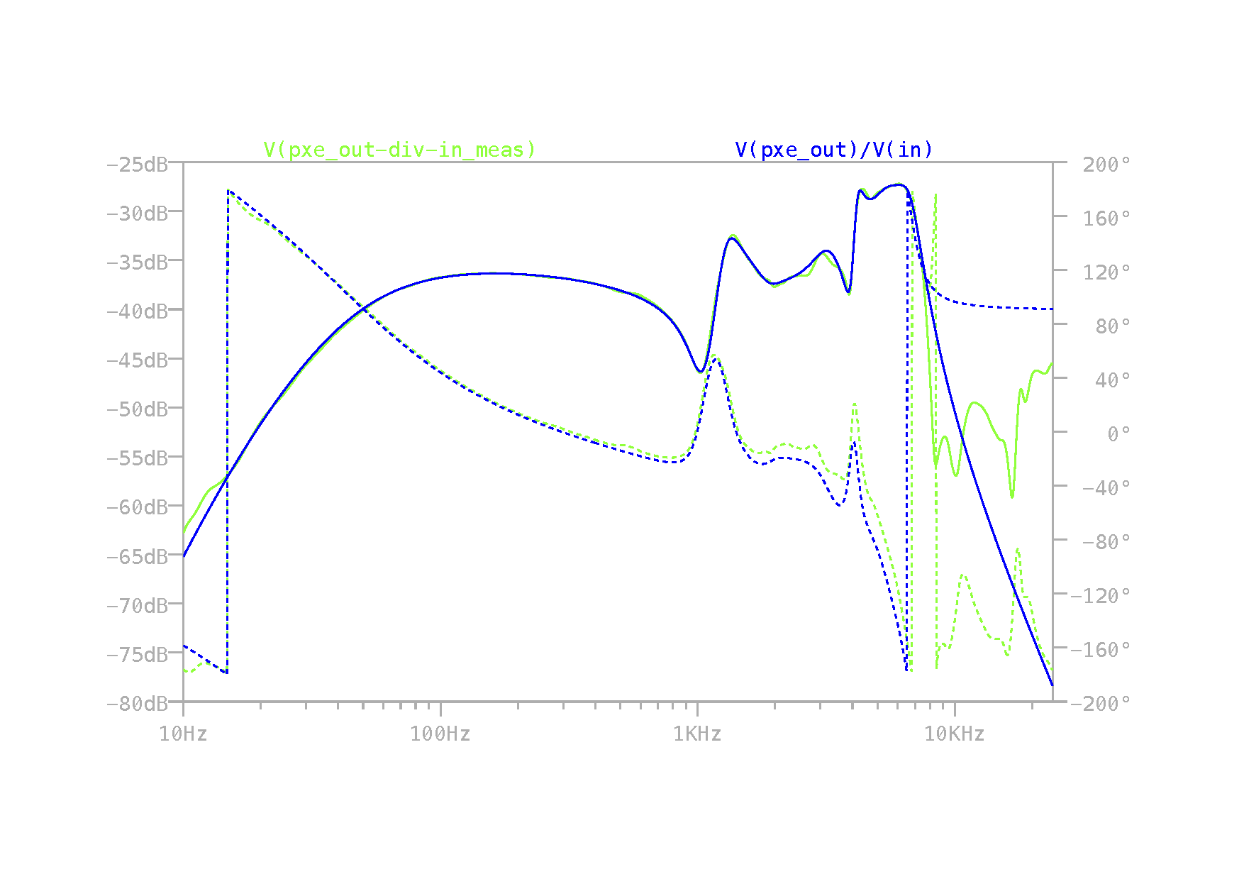

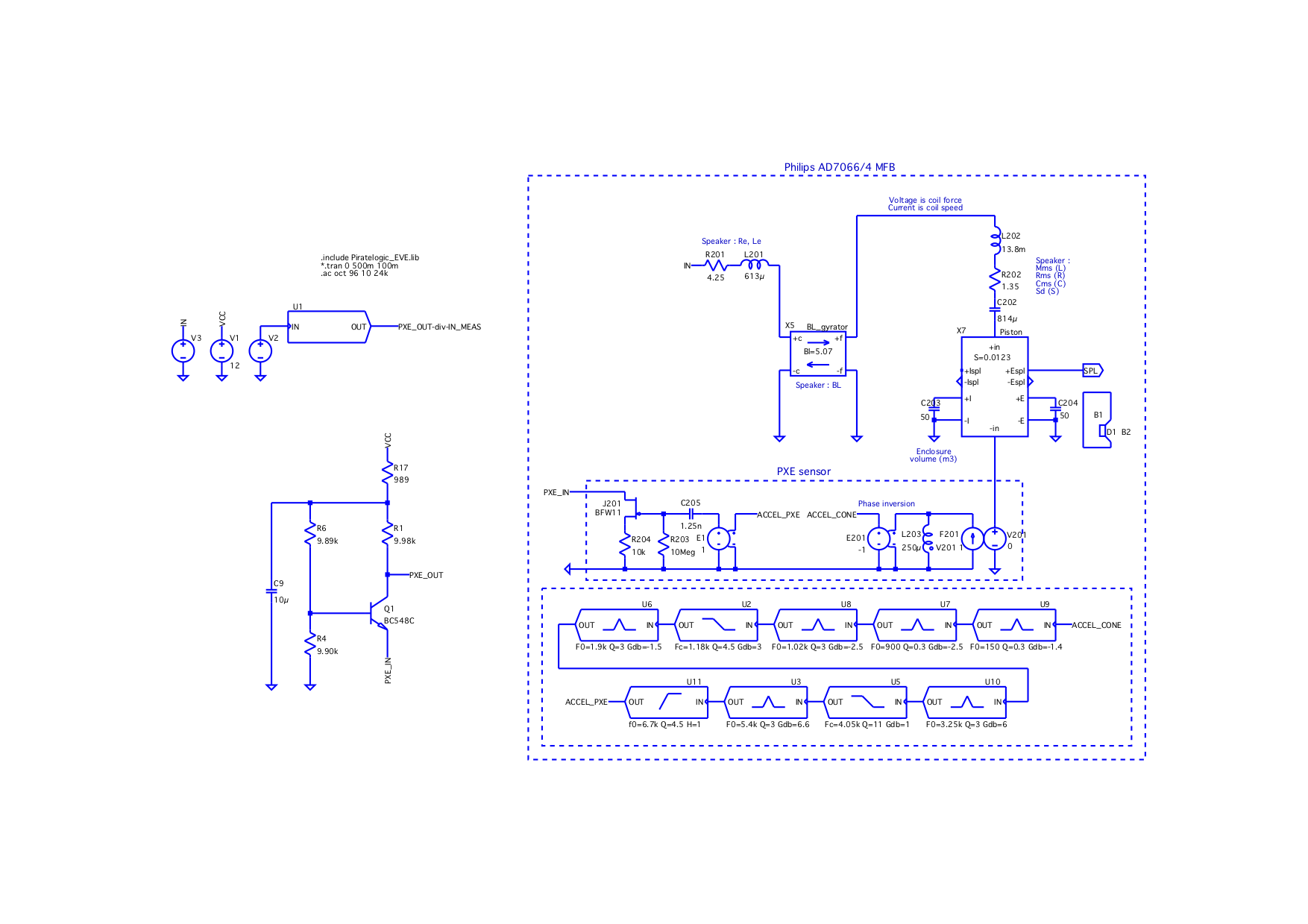

Dear all, I've made a good progress on LTSpice model fitting over real measurements.
In attachement you will find the LTSpice schematic corresponding to the AD7066 speaker model with PXE sensor and the same polarization stage as used during measurement. You will also find the two curves together, the one from the measurement and the one simulated.
As you can see, the fitting is quite perfect up to 7kHz (far far enough) on gain and phase. To obtain that I've inserted some 2nd order filters between the cone acceleration signal and the PXE sensor acceleration input to simulate the influence of cone breakup over PXE sensor.
So now I have a very accurate model of the speaker response seen by the PXE sensor to simulate the complete behaviour with the EVE board, amplifier and feedback loop. The model is behaving as the real speaker (from motion and PXE signal point of view) so we can play with the enclosure volume we want and the feedback loop parameters we want.
The SPL response output of the model is still based on pure pistonic cone motion without breakup but it is not that I want to simulate accurately. For that the real measurements within the enclosure will be better !
To my best of knowledge, you are the first one to fully model piezo (or cone for that matter) breakup modes in LtSpice (I believe that is what you work with) in MFB context. In just a few weeks times you have already surpassed most of us in simming the loop. This is nothing short of spectacular. It is great a pity Stephtsf never got this far, here om DIYA at least.

Yes I know VituixCAD which is a powerfull tool ! I use it during acoustic tuning sessions.
From the current purpose LTSpice model is best to mix acoutic and electronic signals for the tuning of EVE board.

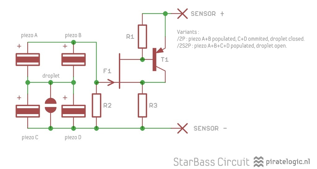

It should be really interesting if Chriscam could give the electrical model of Starbass sensors (parasitic capacity of PXE element, polarization resistors and JFET model). I've bought 3 of them (ClingOn) and I will equipped at least my two SEAS L26ROY. I will do the same process with them.

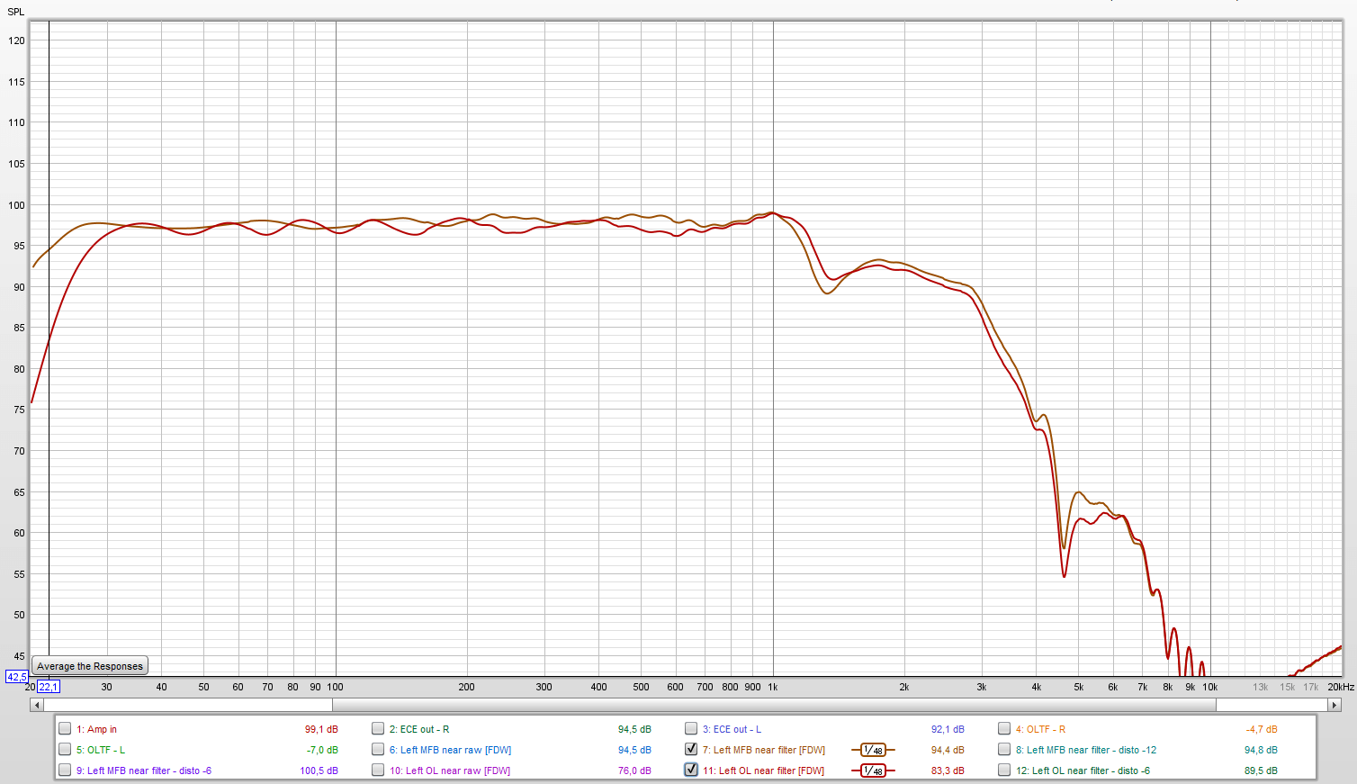

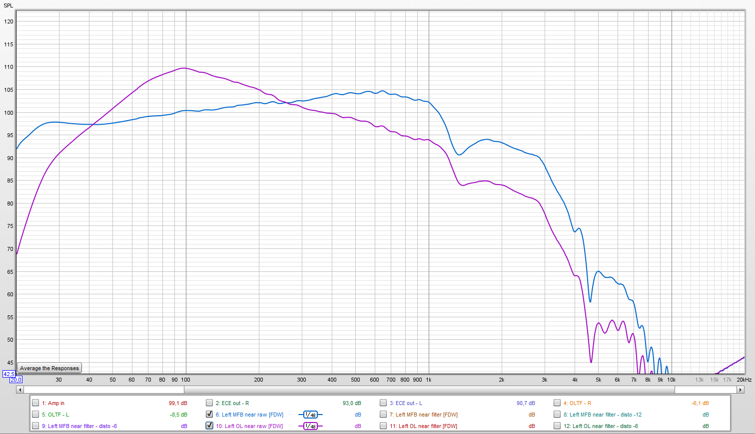

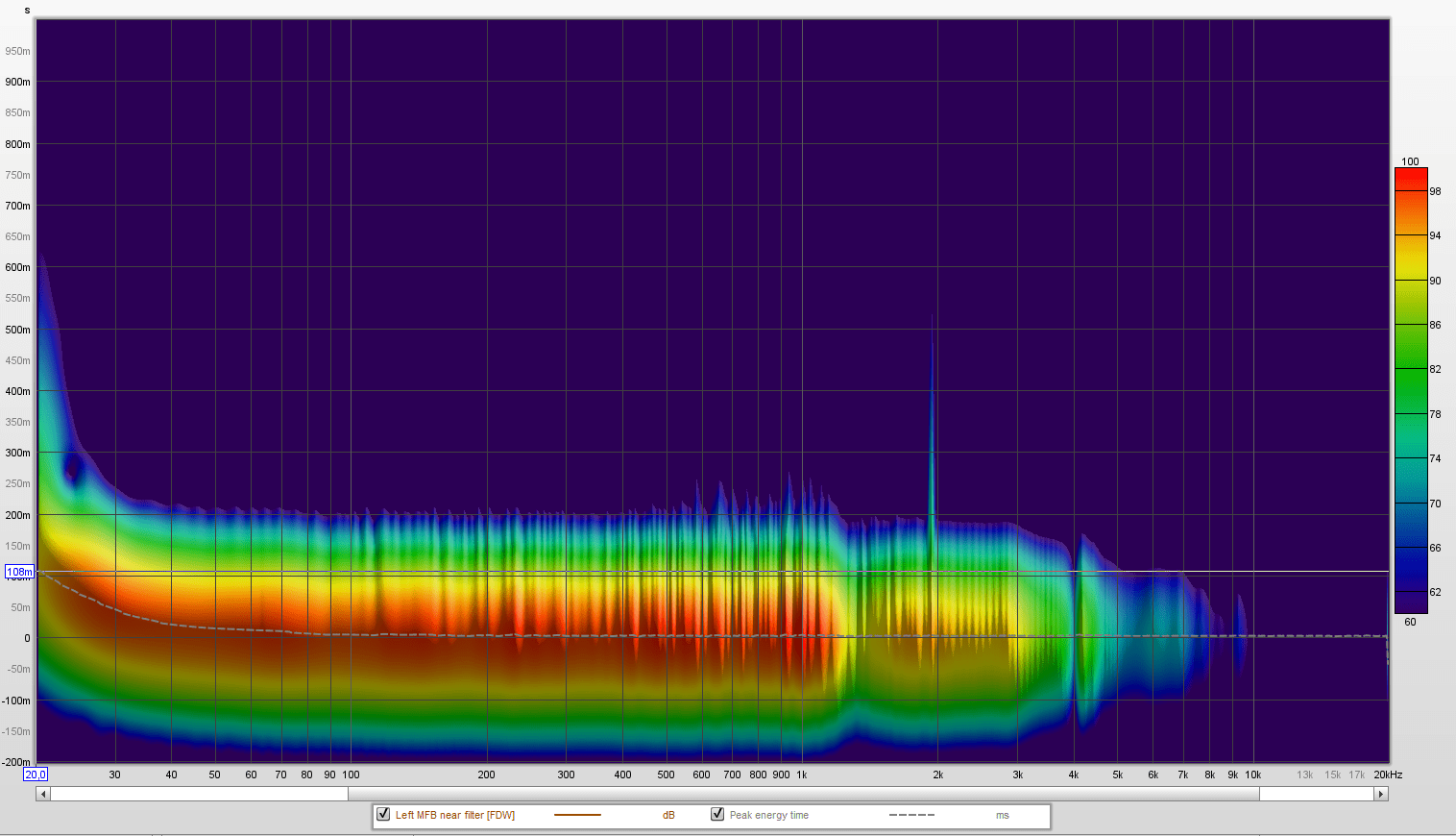

Dear all, I've finally finished the sound bar for my son including the Philips AD7066 ! It was a nightmare to obtain something working in closed loop and I have reduced the feedback gain to 10dB maximum to keep the system stable.
10dB is quite bad but it still give some interesting results regarding distortion measurement. The listening is impressive (for the size), the speaker follows every bass notes easily (but we have to take care about excursion).

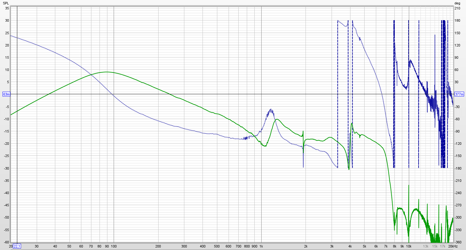

- Philips EVE - 10dB - OLTF.png : give the Opened Loop Transfer Function of both speakers in the system. You can see they are not behaving exactly the same.
- Philips EVE - 10dB - Left OLTF + phase.png : the detail of left Philips including the phase
- Philips EVE - OL-MFB comparison without filter.png : In blue the SPL of the Philips in closed loop, in violet in opened loop
- Philips EVE - OL-MFB comparison with filter.png : In brown the SPL in closed loop with a DSP correction to have it flat, in red in opened loop with a DSP correction to reach the same target (the correction is fare more agressive for sure)

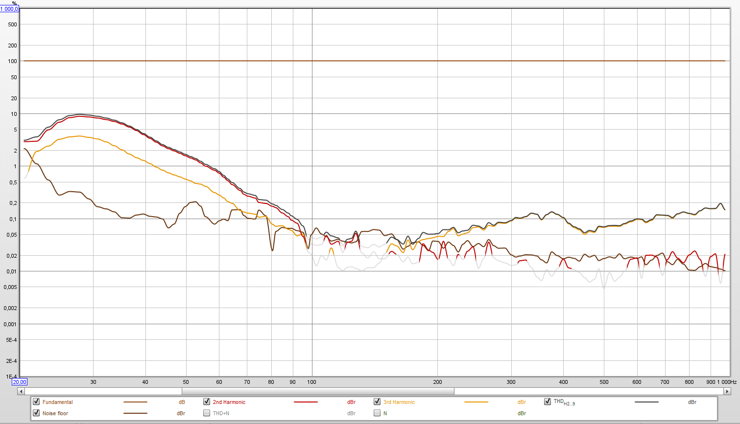

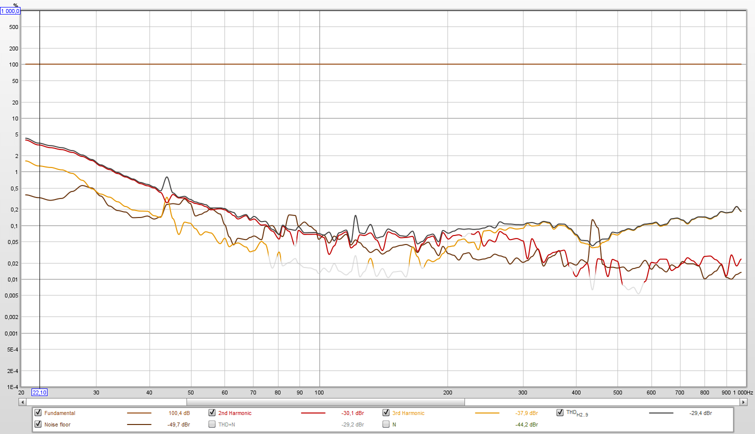

- Philips EVE - MFB with filter -6dB distortion.png : the distortion figure in closed loop with the flat target
- Philips EVE - OL with filter -6dB distortion.png : the distortion figure in opened loop with the flat target. Notice the difference 10% at 30Hz vs 1.5% for the closed loop ! The most important reduction is on 3rd harmonic, in the meantime the 2nd stay the same or little bit above (warmer ?).
- Philips EVE - MFB with filter spectrogram.png and Philips EVE - OL with filter spectrogram.png : not relevant ? But the group delay of closed loop seems smoother ?
Wonderful measurements. Thanks for a convincing demonstration of MFB benefits.
An interesting plot is the electric drive into the drivers with and without the feedback. When the feedback is active, the driver signal is funny looking and distorted BECAUSE it is trying to correct the driver.
Sadly, the most wonderful benefit of MFB (more than FR or even low bass distortion improvement) is how great the transient attack sounds. Wish I knew how to demonstrate that benefit (other than by obvious hearing tests).

That's something I've been pondering, too. I'd like to do some two-tone IMD measurements, that might be a cool way to show the MFB effect working. Maybe two tones between 50 and 150 hz or something in that range could work.Sadly, the most wonderful benefit of MFB (more than FR or even low bass distortion improvement) is how great the transient attack sounds. Wish I knew how to demonstrate that benefit (other than by obvious hearing tests).

Hello Wankel 4486,
Good work!
I do, however, not fully understand what the pictures show. Closed loop is clear.
I struggle a bit with the overlay and the single Open Loop picture in green: should not these pictures, that is the purple and the green curve be identical? I see an extra pole @30Hz, where the curve should be straight. What is going on?
Also I am a bit intrigued about the max 10dB NFB: by looking at the phase, it seems you have some 5 dB extra feedbeck headroom,before you reach +145 degrees at unity gain. Can anyone ( Bolsert?) shed some light on this?
Good work!
Yes the green and purple sould be the same but I've measured OLTF electrically and in open loop (for sure) so no DSP filter, while the purple was done with the microphone preparing the setup for distortion comparison with closed loop. I've put in sub high pass filter in Butterworth 48dB/oct at (or near I don't remember) 30Hz to protect the speaker. That's why there is a pole visible (also in distortion for open loop. For closed loop I think the feedback compensates a little bit).
I don't understand neither why I can't put the gain higher because it seems having a lot of phase margin. When I wanted to go higher the cone began to oscillate dangerously peak to peak or worst going to make a high frequency noise. I think the high frequency noise is linked to 2kHz accident which is maybe sharper than the figure in reality (rew smoothing ?).

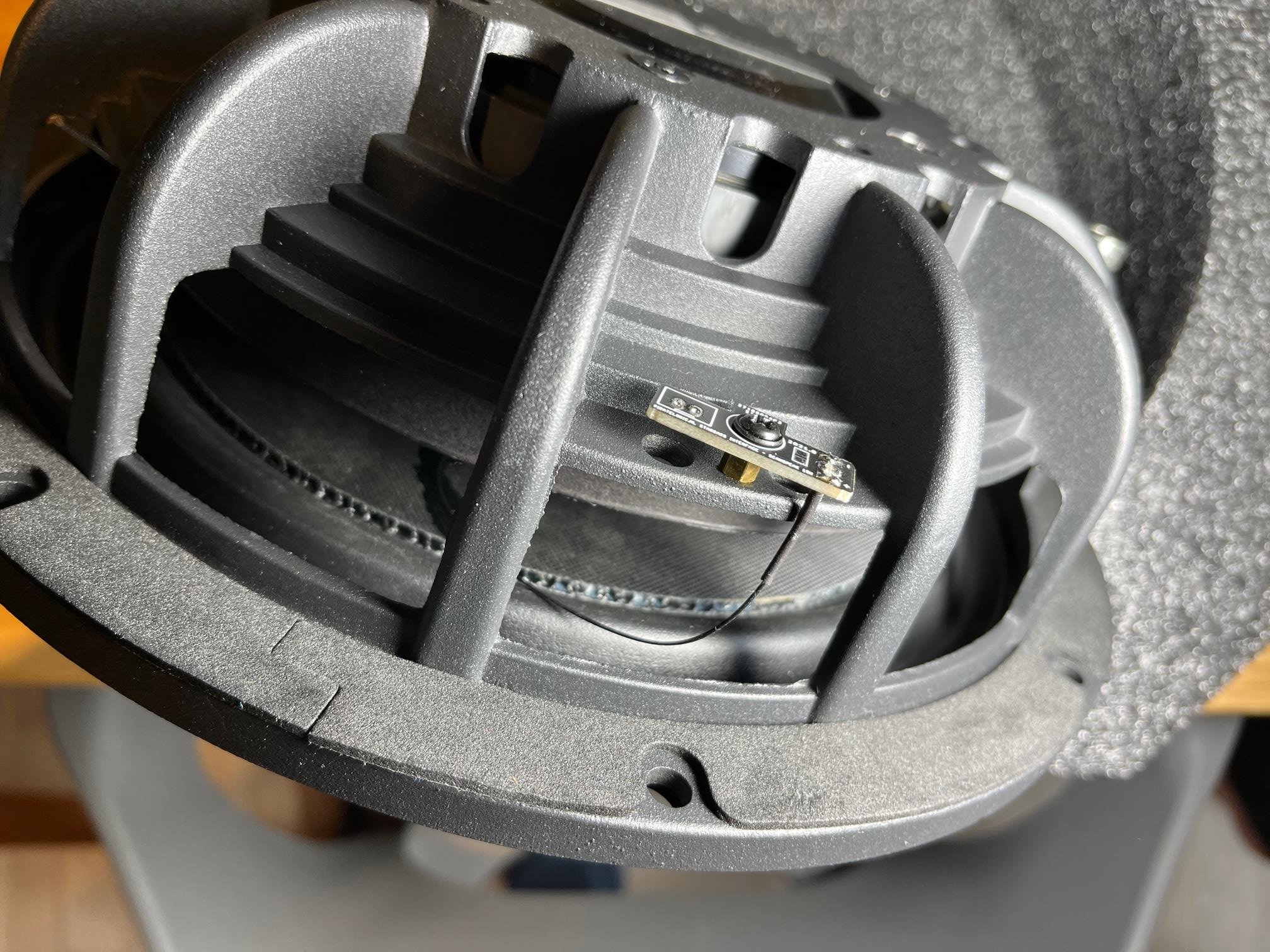

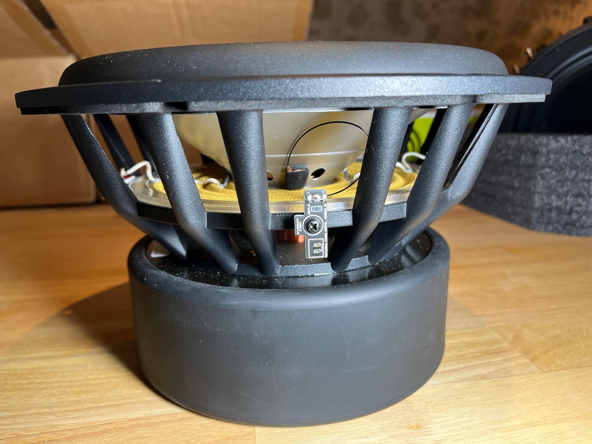

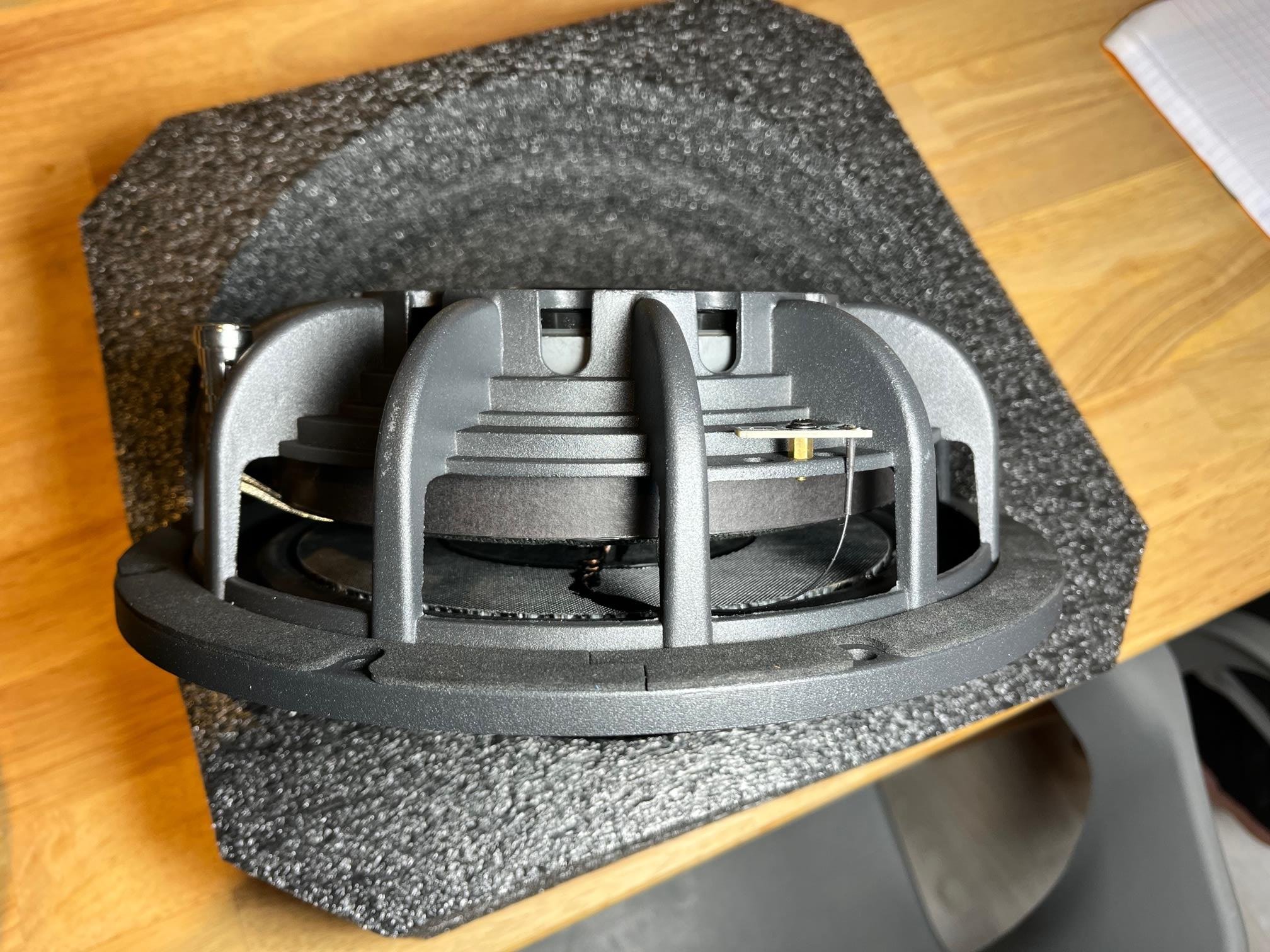

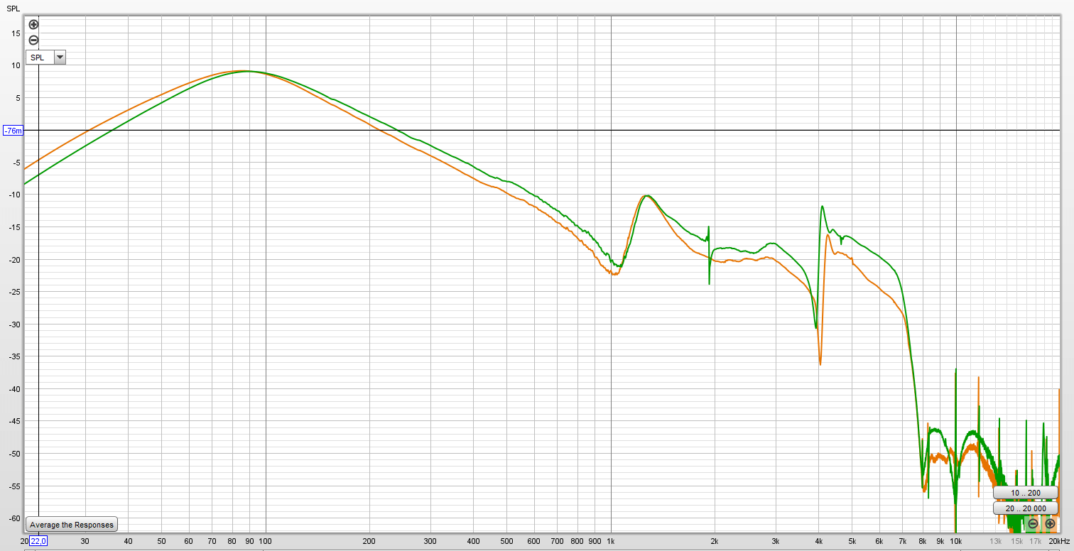

Dear all,

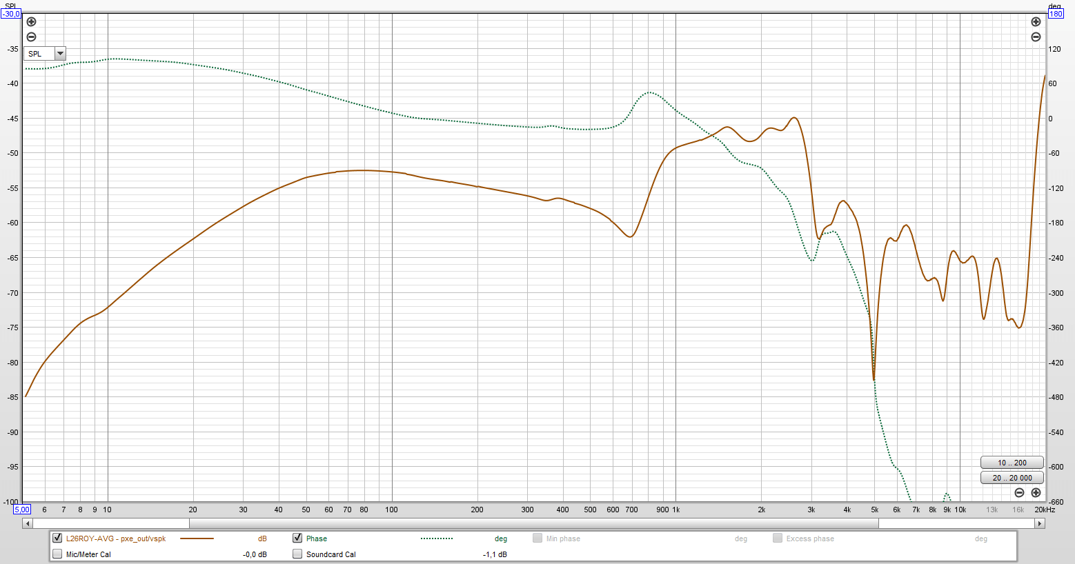

I've equipped one Dayton Audio LS10-44 and two SEAS L26ROY with Piratelogic ClingOn 45° sensors.
I've performed some basic measurements (as previously with Philips AD7066 MFB) in free conditions in order to sim the sensor response with LTSpice. I've used this basic stage applied to sensor output.
See the PXE_OUT/Vspeaker sensor response I've obtained for both Dayton LS10-44 and SEAS L26ROY. The ClingOn seems very promising in term of phase margin (compared to Philips AD7066) !

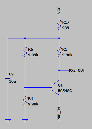

Chris, I would like to sim the sensor with the speaker response in order to anticipate the EVE parameters following this schematic.
In order to have the good sensor behavior before applying parametric filters between ACCEL_CONE and ACCEL_PXE, could you please give us, following your Starbass schematic below, the values of R1 and R3 (R2=39Meg right ?) and give the reference of F1 JFET and T1 bipolar ? I've understood that ClingOn is equipped by two Murata sensors in parallel meaning 1.5nF of output capacitor.
Then we have a LTSpice model to quickly established response of the sensor depending of the speaker bby just free air measurement, playing with sensor gain (L203 inductance value), sim the cone breakup effect, by adding some parametric filters. After the speaker + sensor model can be modified with the enclosure volume and EVE board can be added to anticipate loop behavior.

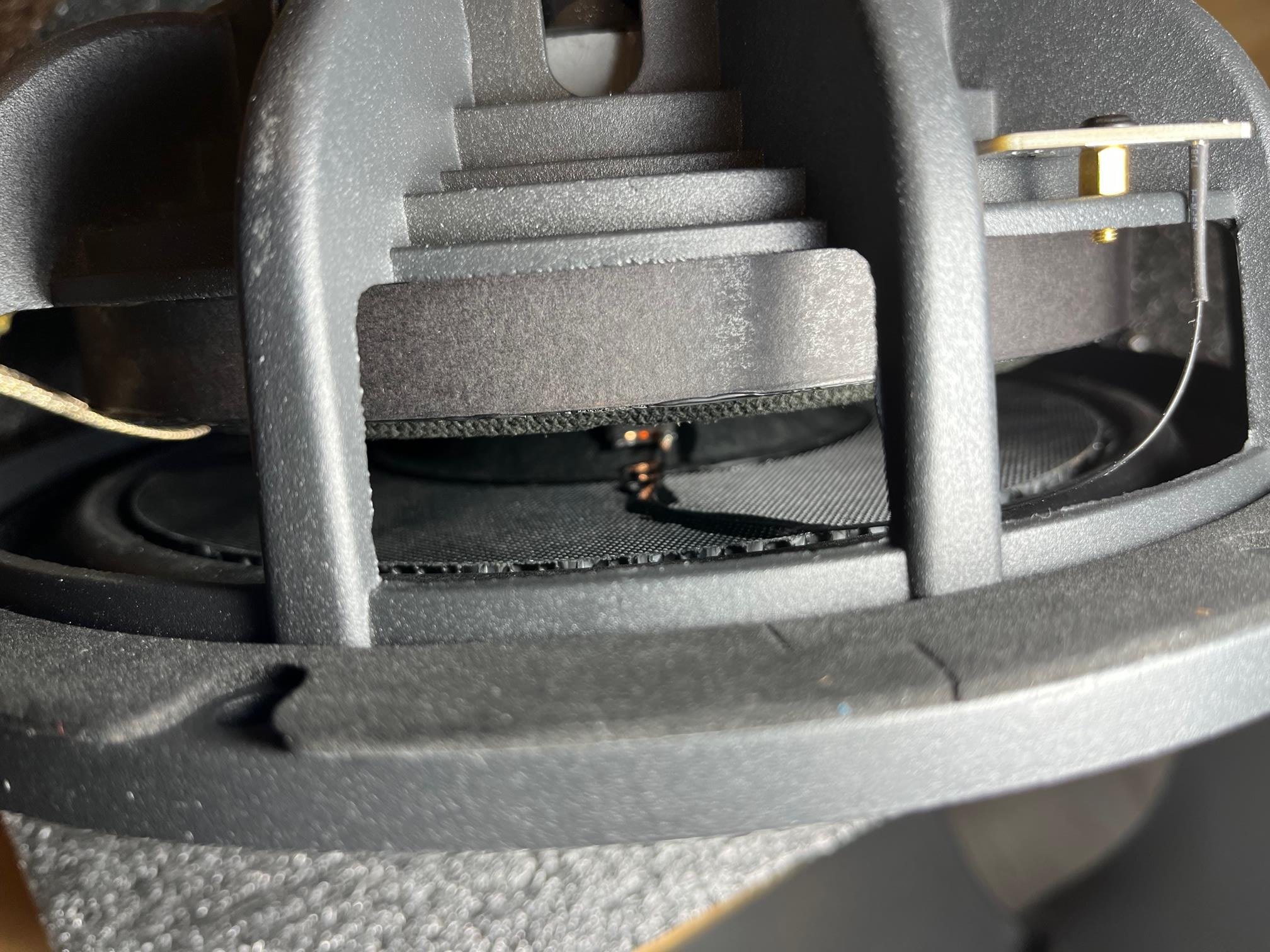

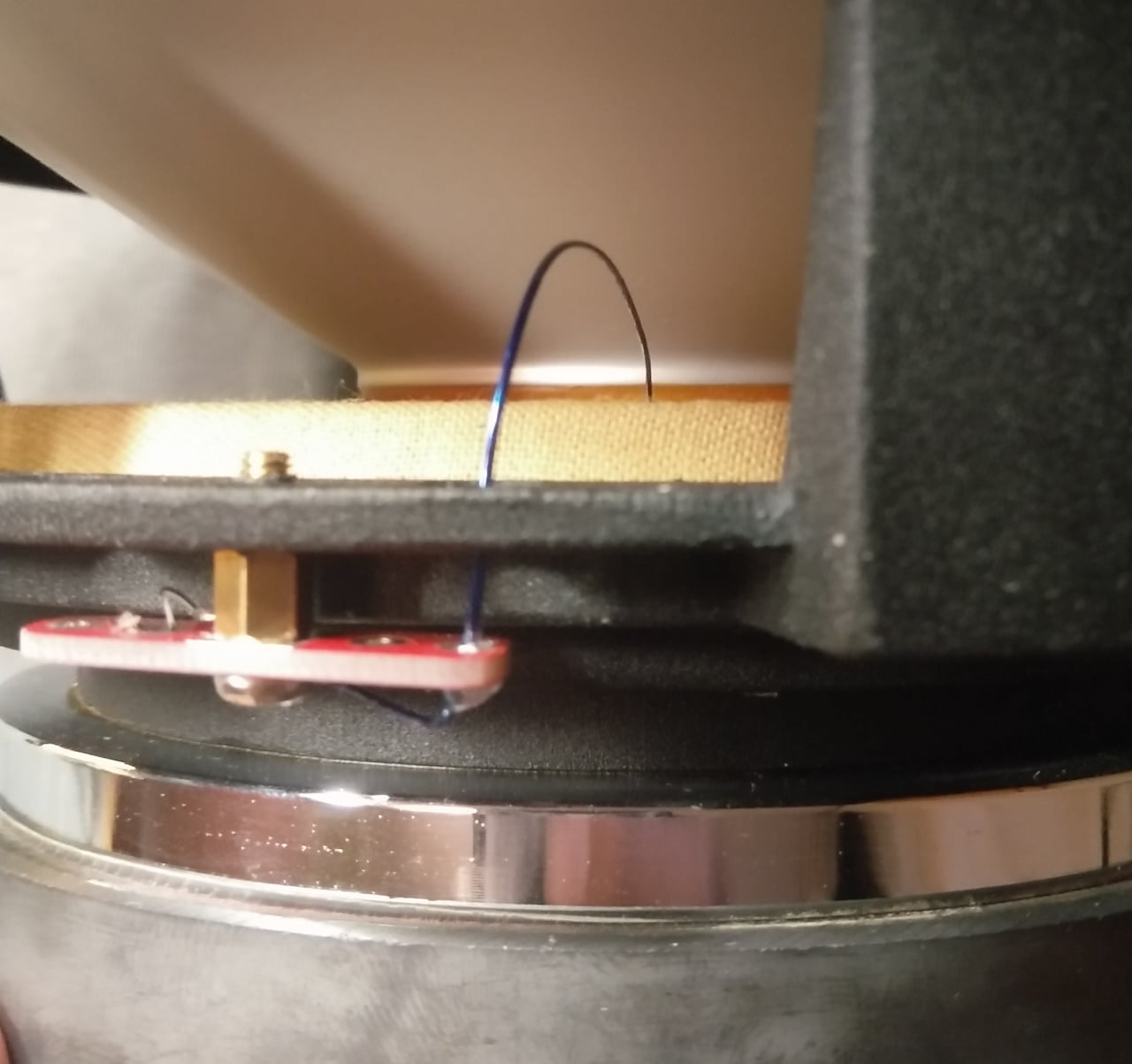

I follow Chris recommandations for ClingOn installation. The Chris schematic let the wire outing from the sensor along the cone and that all. I hope it will be fine...Be aware of the cable routing between sensor and interface board...
Cable shall be fixated to the spider.
Yes these measurement are free air.Are these measurements Free Air? The phase @LF almost looks to be good to be in-box...
What is strange is that the phase @LF is lower in my measurements than expected with simulation when I take the capacitance of Murata sensor and the resistors values from what I know with ClingOn. Both SEAS speakers are exactly the same, Dayton and SEAS sims fits quite well with measurements if I adjust some sensor parameters with exactly the same values !
So even my measurements are biased with the same trend or the ClingOn components values are not these I know.

To be honest: I do not understand that PXE section It looks like a low pass to cut of the piezo output, possibly to kill a resonance of the accelerometer, but as such it negatively impacts phase where you do not want that to happen. The whole problem of the loopshaping is that improving phase margin in the low end tends to impact the phase margin the high end...
Remember this EVE design dates back 3 years already and I've learned a lot since then to cut short : it was an attempt to increase loop-gain by low passing the pxe signal in a 2 way design. I found that you can only do that so much until it starts affecting the FR because the pxe lpf is causing a rise in amplitude due to missing negative feedback pxe signal above lpf.

Chriscam, could you please provide information to update the PXE sensor section according to Starbass sensors ? I think we need, parasitic capacitance of sensor, polarization resistance values, JFET model and global sensitivity in mV/G for at least one or two frequencies ?
R1=100K, R2=39M, R3=10K, F1= BF4416 T1=BC860C PXE = PKGS-00LDP1-R
Correct, the coaxial cable should be mounted like below to minimize excursion stress,
