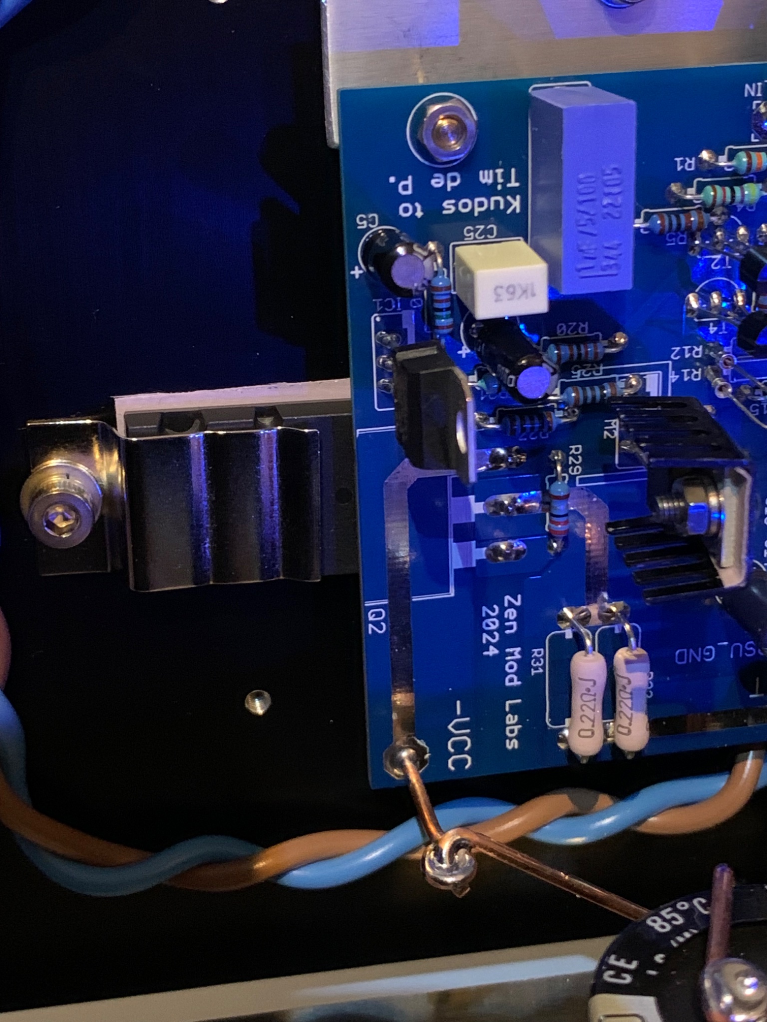

Got them up and running yesterday evening, slowly with variac ramp up, with the chicken bias resistors. Sounded very fine. Promising. Gave them some runtime flipped ON all night.
Switched today to the 1,85A Babelfish bias instead of the 0,7A Chicken bias.
All i can say is that this is a sweet sounding amp. A friendly, collected and smooth yet extremely clean sound. Never hard and cold. The bass is very, very muscular, strong and fat. Never in a bass bosted way, flappy way. No, just CLEARLY present, authoritative and dynamic.
This is in closest comparison with the EL34 SE amp i had playing in the system just before these MF A1 Babelfishes got warmed up for real. Heatsink settles on 40C @ 1,85A. 🙂
The only clear downside with the power transistor spring steel clips that i now can see, is that i can no longer see and check out the really beautiful transistors. So good thing that i already got them on nude photos in this very thread. 🙂🙂🙂

btw. no really need for isolators in between M's and their heatsinks
quite contrary, no isolator and blob of goop
Okey, thats good to know. 😐
I used customised Keratherm pads. I never continuity tested the metallic backside of the transistor to the pins, since you included 4 Mica insulation pads with the kit. So i just assumed that insulation was needed.

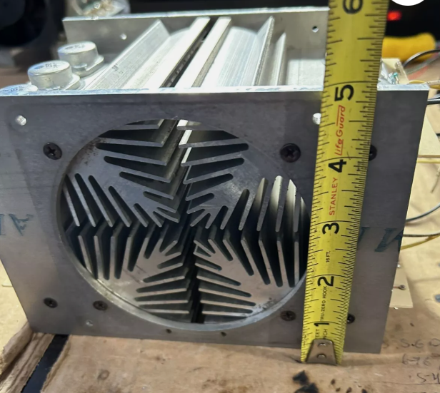

Do you think one or two of these contraptions, with an attached fan, would manage the heat? The A1 looked different so I should try something different from the 5U chassis...

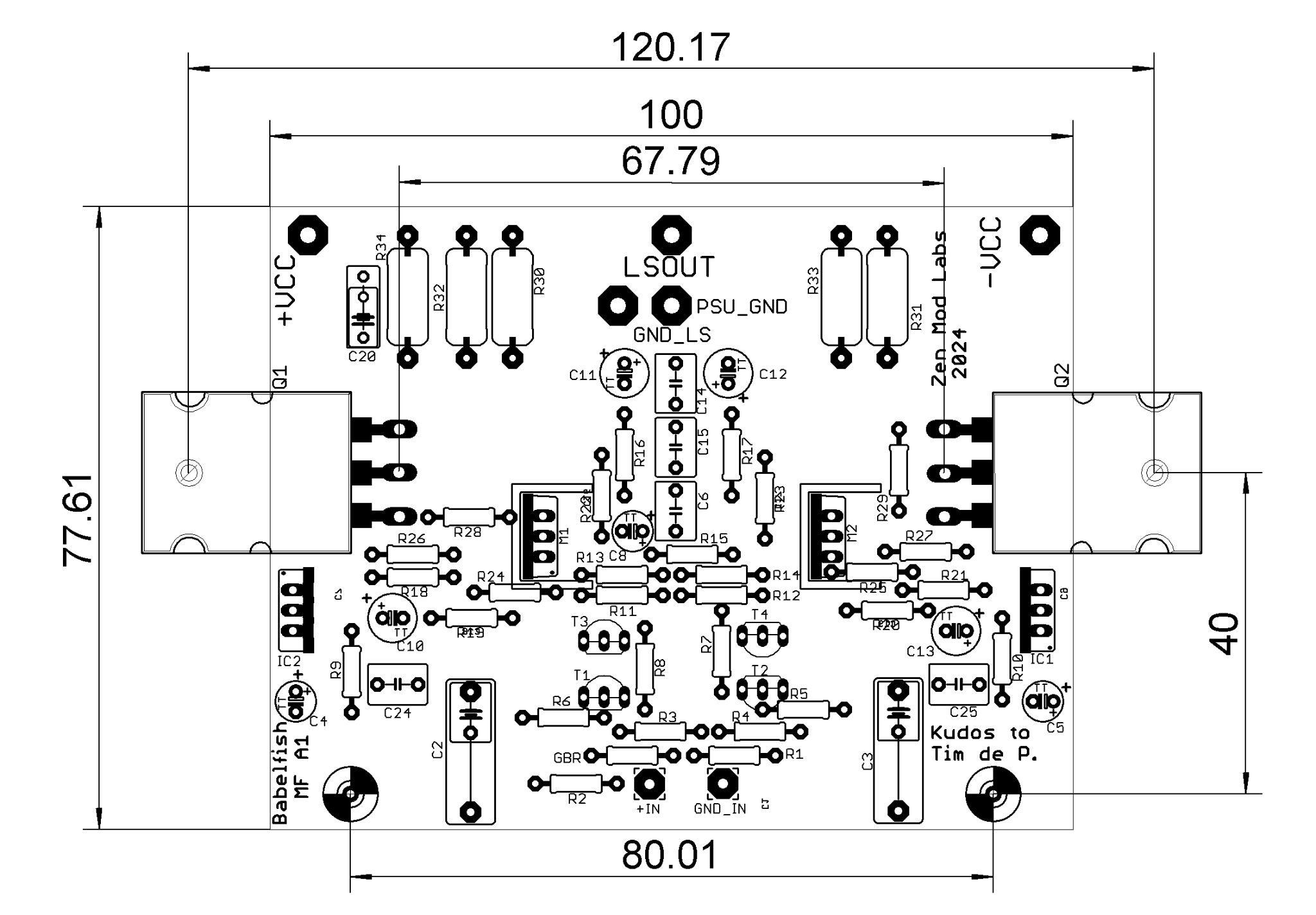

that one thing would keep stereo Krell KSA 50 cold enough, with proper modern 12V fan, so why not puny Babelfish A1, stereo
some care with transistors ,mounting but easy enough
one pcb per side ( as is now), no bent transistor pins and - who knows - maybe you got proper raster
if not, short additional wire studs for transistor pins and all good
see attached, 68mm is magic number, pins to pins
I have few of those hsinks, shorter and longer
now I'm curious - will measure distance between bars today, just for fun
Cool. I have been thinking of heat dissipation (xa252...) and want to build something with active cooling for the next amp. The MF A1 seems like a good candidate for a slightly differently packaged amp😊
that hsink on picture, it can cool helluva........ with price of increased fan noise; more heat, more noise
there is no other way than testing, to find does heatsink under test is passing, having intended temp at intended dissipation and still bearable fan noise
that last factor (noise) being subjective, so no prediction from anyone else

😍 Those are beautifully milled heatsink and massive! 4 pieces for one BA1?No, it's not DanDagostino factory tour...A1 CNC-ed heatsinks...milled from one block of Alu, 400x200x30 mm.
Hope PS will be finished next week. CLC, 4x22mF (Mundorf M-Lytic AG), 300VA transformer per channel
Was listening to proto version on T-bed, still have Zen's original A1 from his early beginnings (mentioned here)
The rest of the chassis will not be finished very fast but...I want to make it unique in appearance...IMHO a very special amp
Will you be kind enough to share with us the fruit of your labour? The Iq that you used and the temperature with these massive heatsinks.
Does the heat spread evenly to the whole heatsink?
