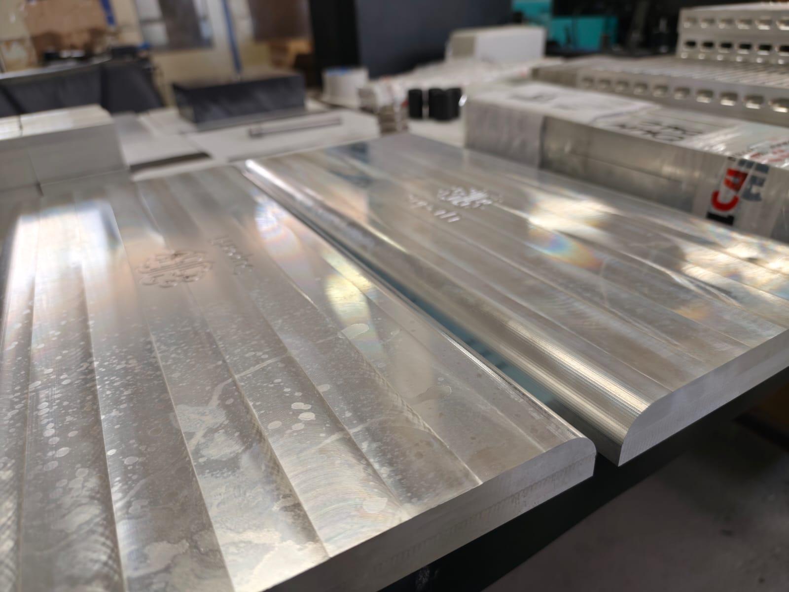

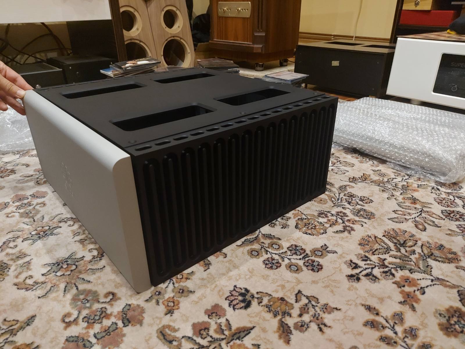

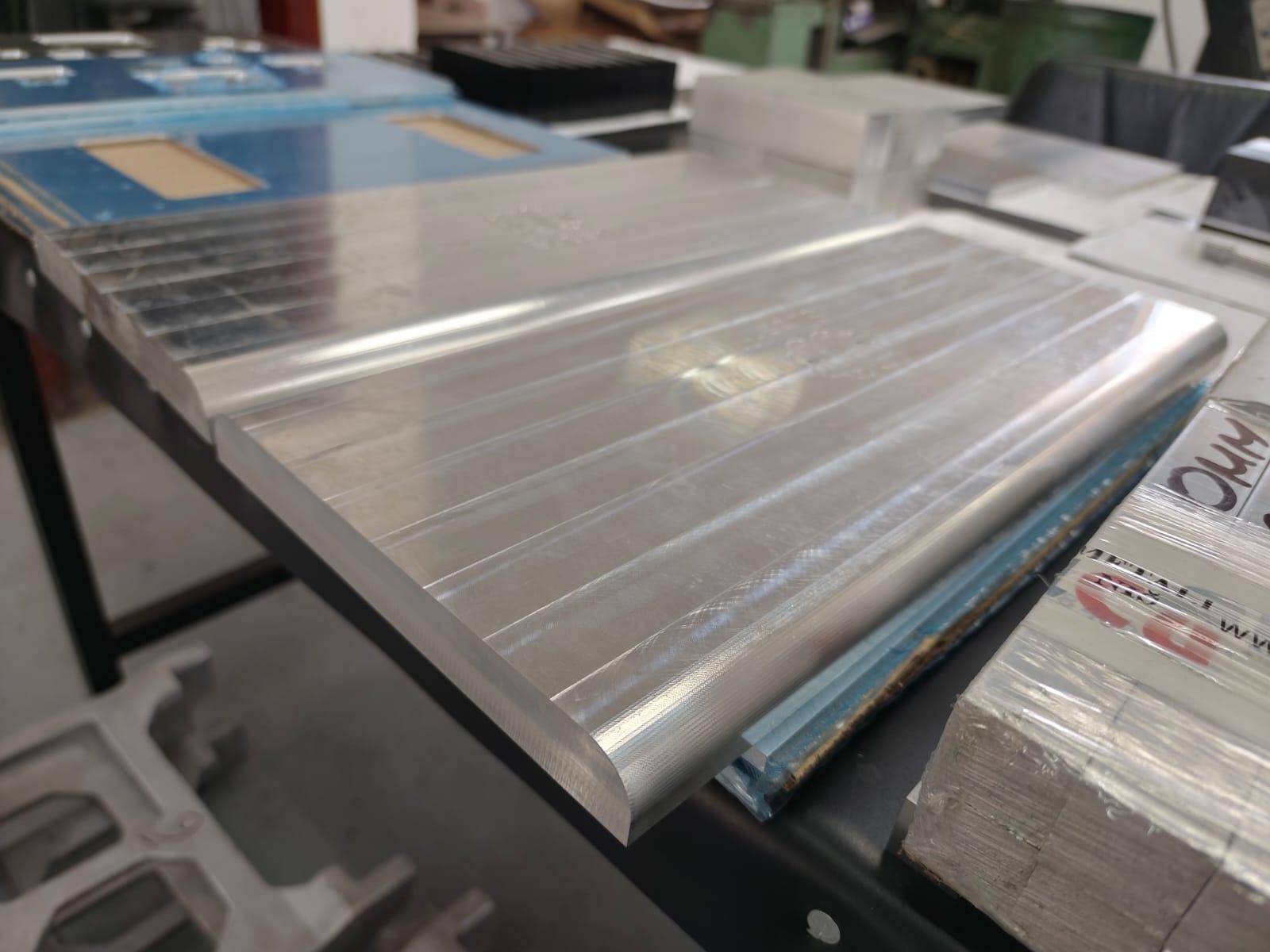

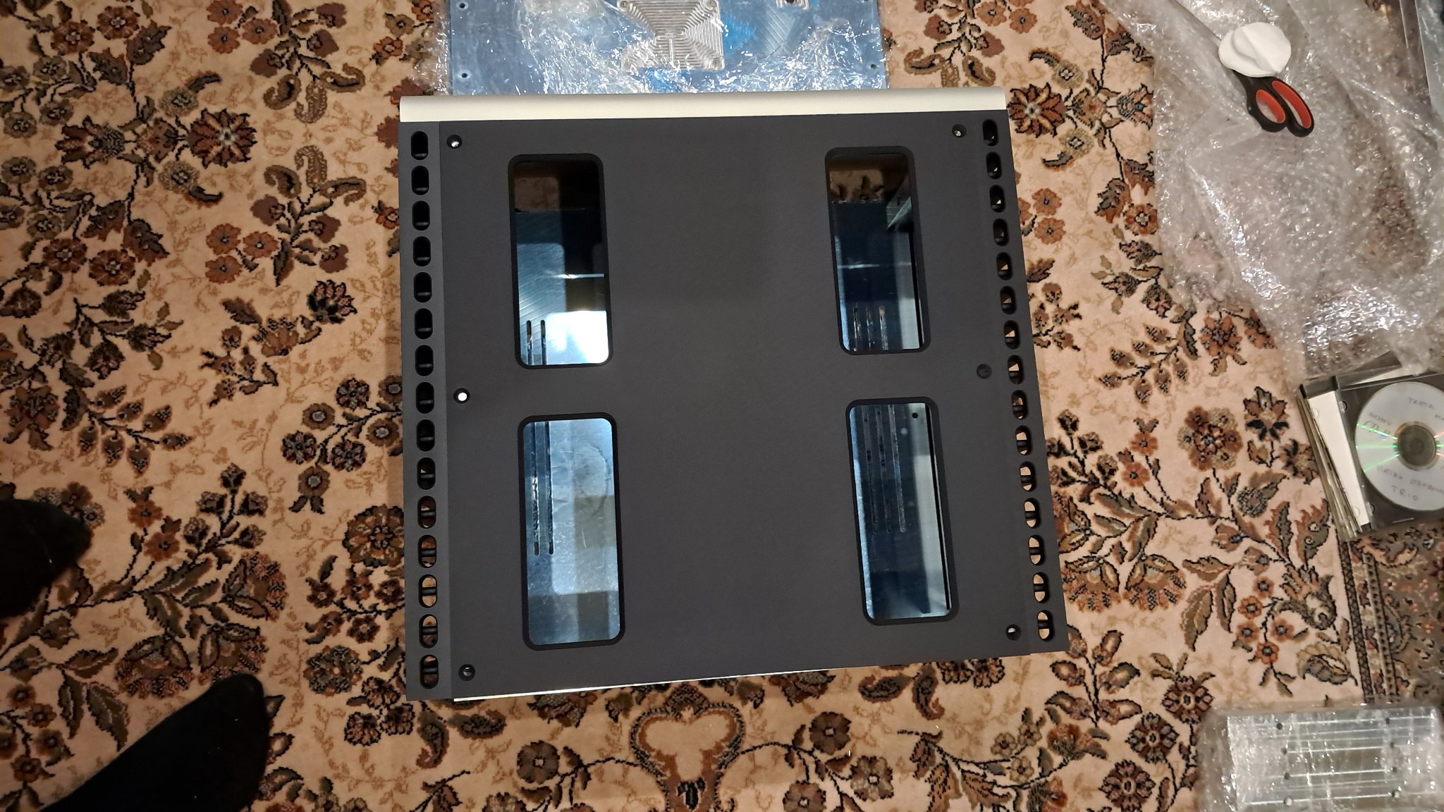

Well, yesterday I collect parts from ball blasting and anodizing. Another reminder how difficult is to get perfect surface/finish. Company who did this is also doing the same job for Karan Acoustics...They are amazing! Amount of efforts I'm putting into this project is quite significant. Of course, without Zen support it will not be possible (first and foremost, i still have his primordial A1 and I was also able to evaluate new amp.
Can't wait to finish it!

Still think that powder coating is much better option; cheaper and more durable. To anodize aluminum, alloy has to be the right one. Then, surface has to be somehow machined (few different options available). But properly done, anodizing is just more...posh or exotic. Satin glow is simply nicer. That's all... Choice is all ours...but again, there's nothing wrong with the powder coating (PC). If I didn't have entrance to this company, I will be very happy with PC...
Of course, anodizing is only for heatsinks and optional for the front plate. You don't want to powder coat your precious heatsinks 😉 Wondering is there any scientific work how much efficiency of heatsink is reduced after PC?
Another important point: inner surface of heatsinks were not blasted. We want polished surface to increase contact area with transistor.
Now, I have to determine how much this heatsink can dissipate power. Dimensions are 400x200x30 mm per channel.
