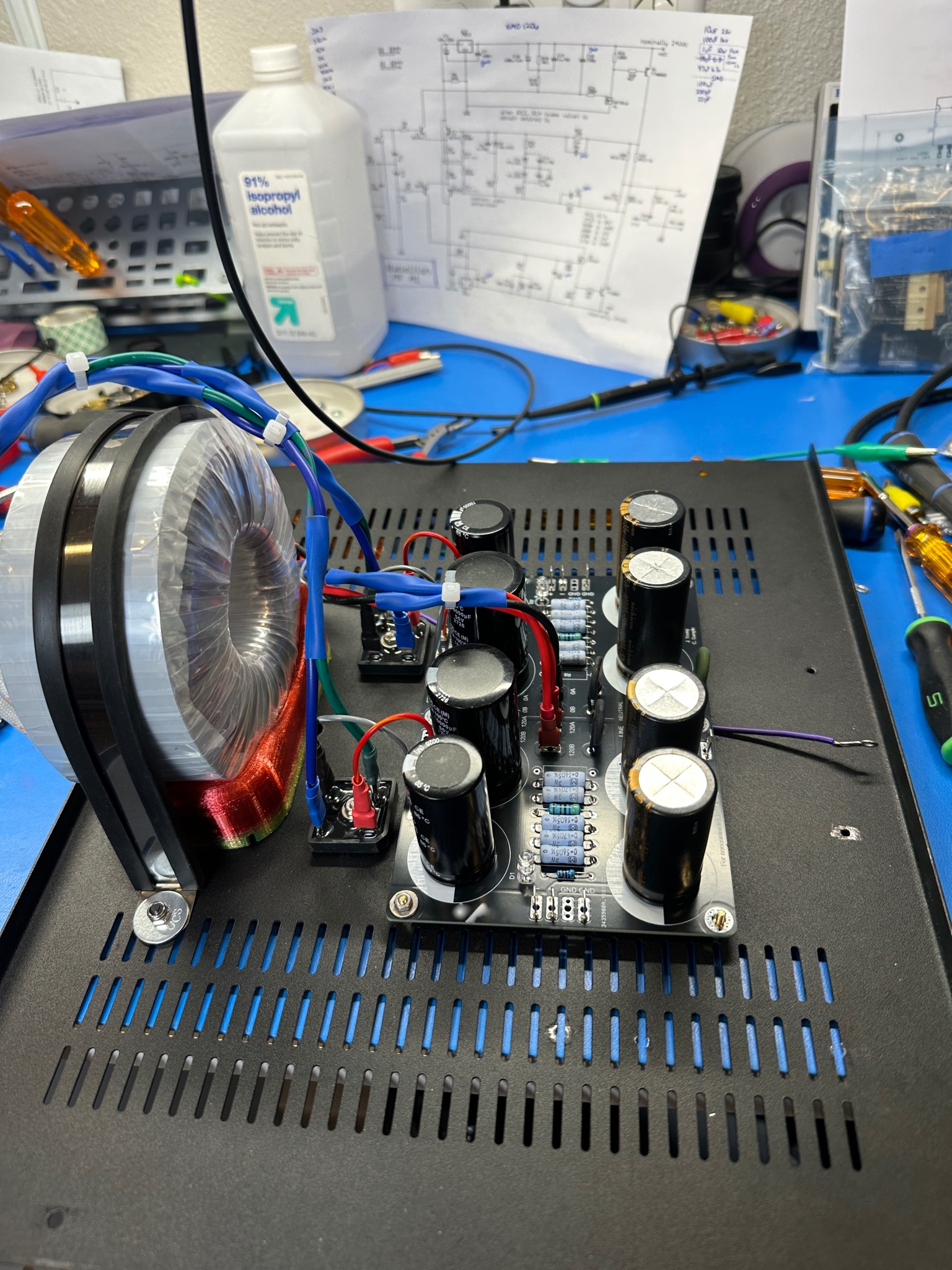

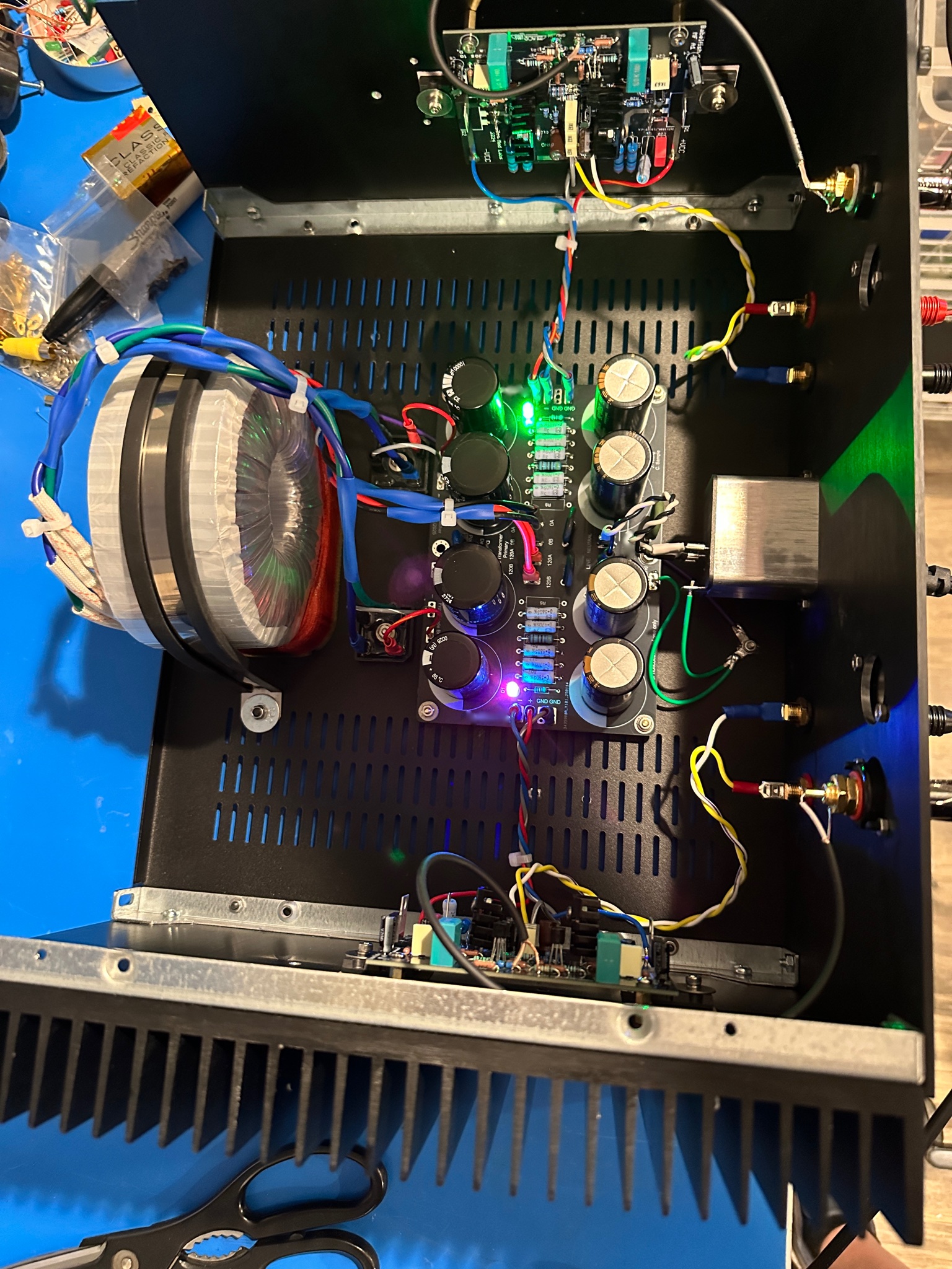

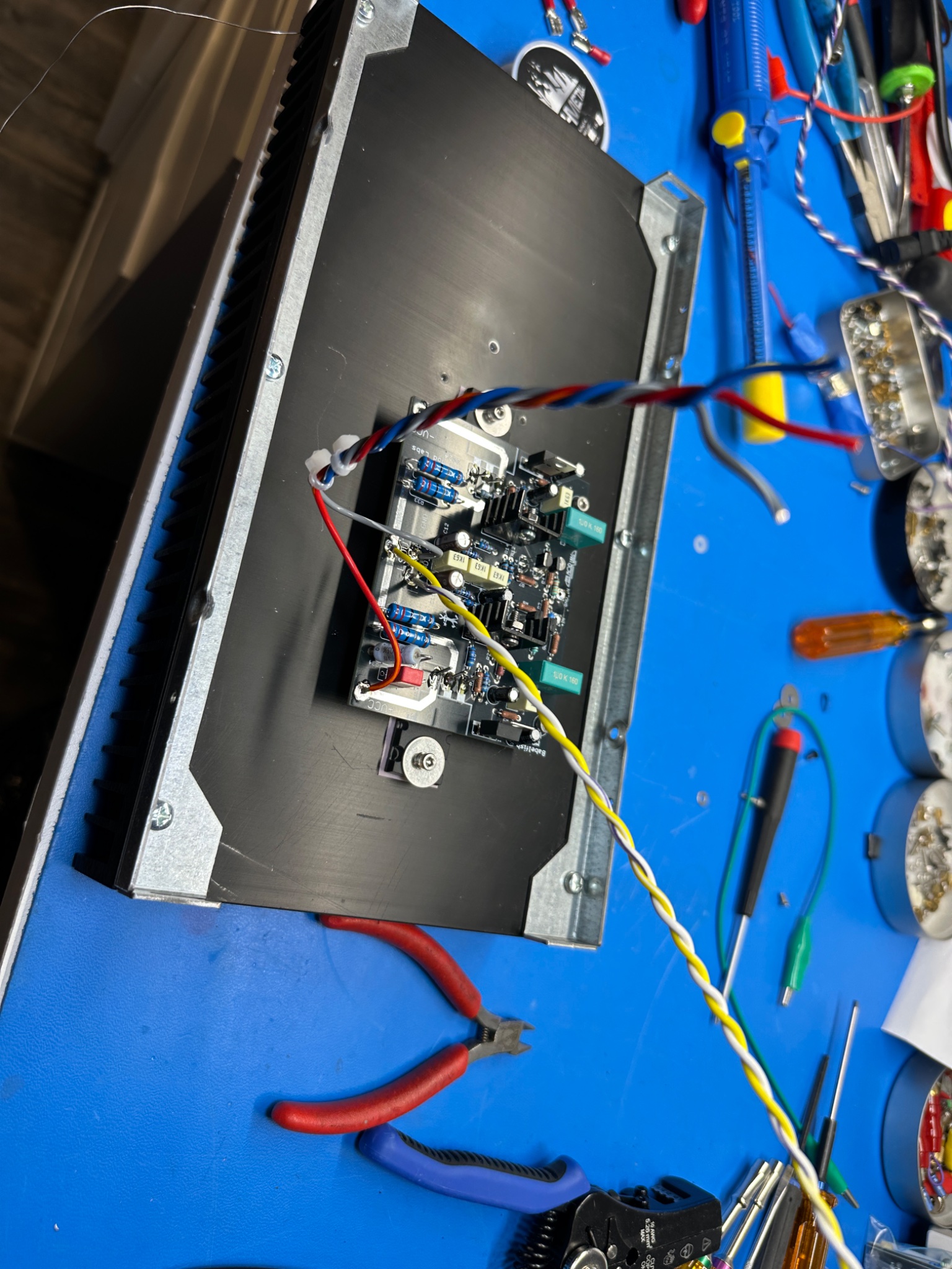

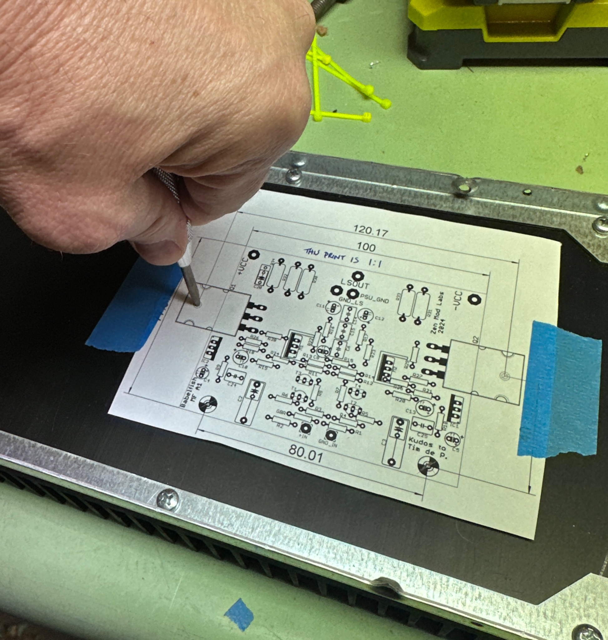

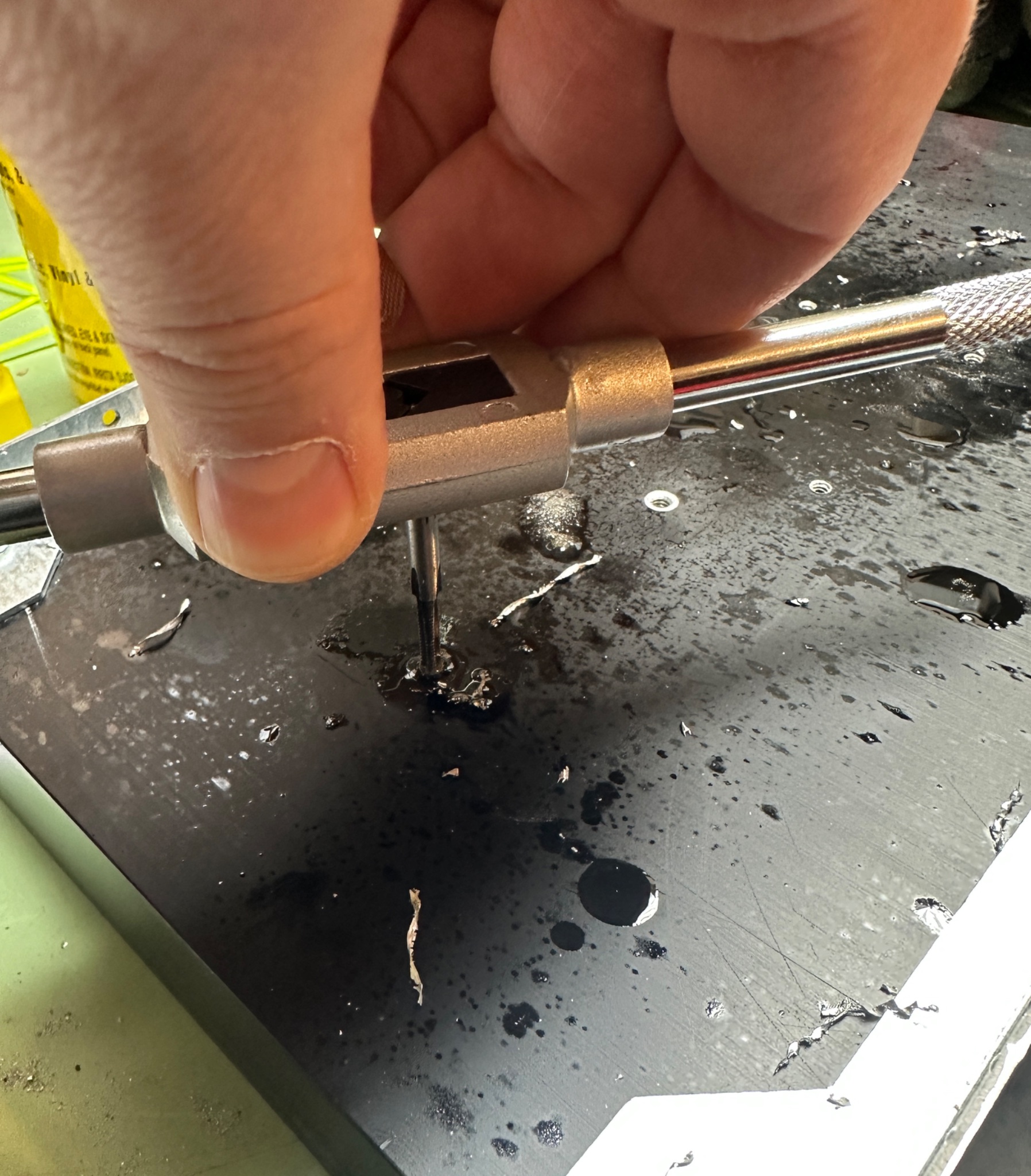

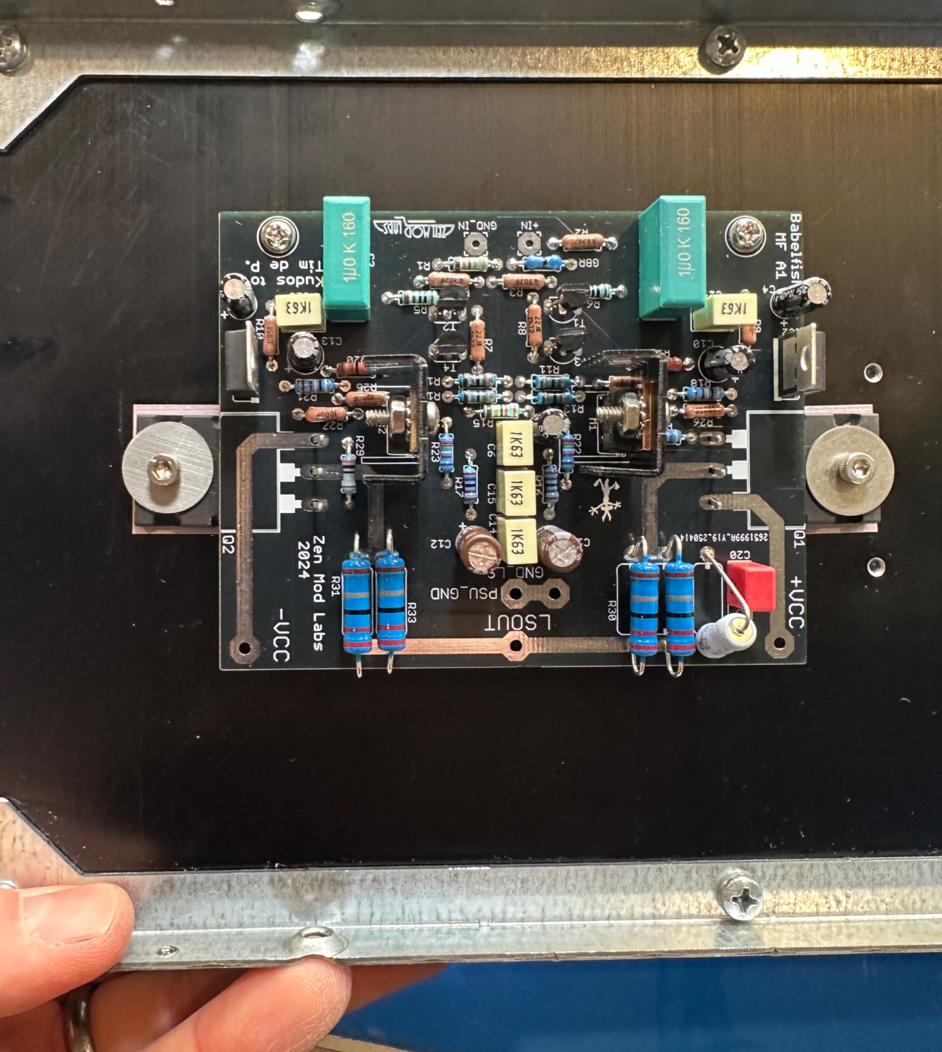

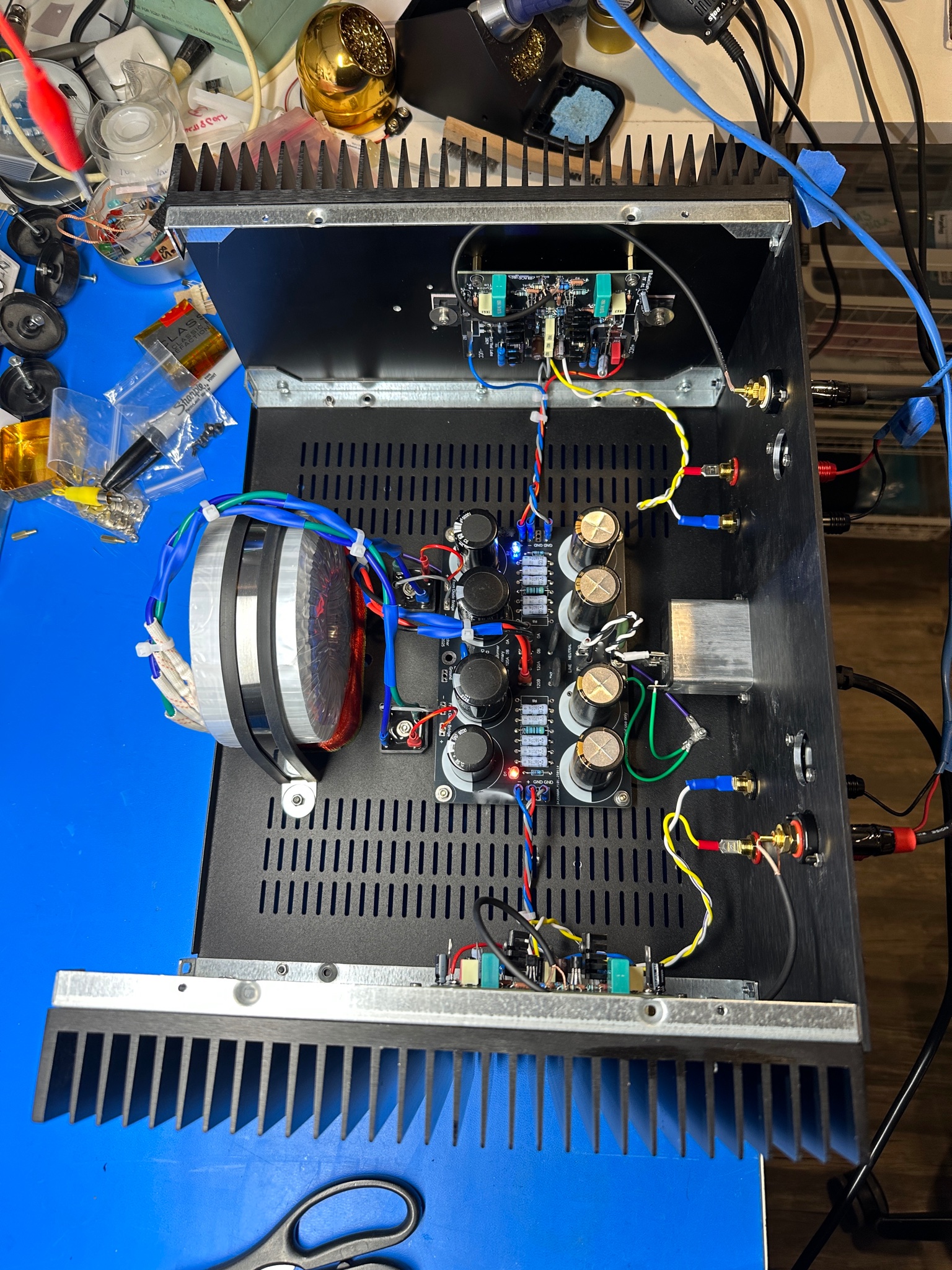

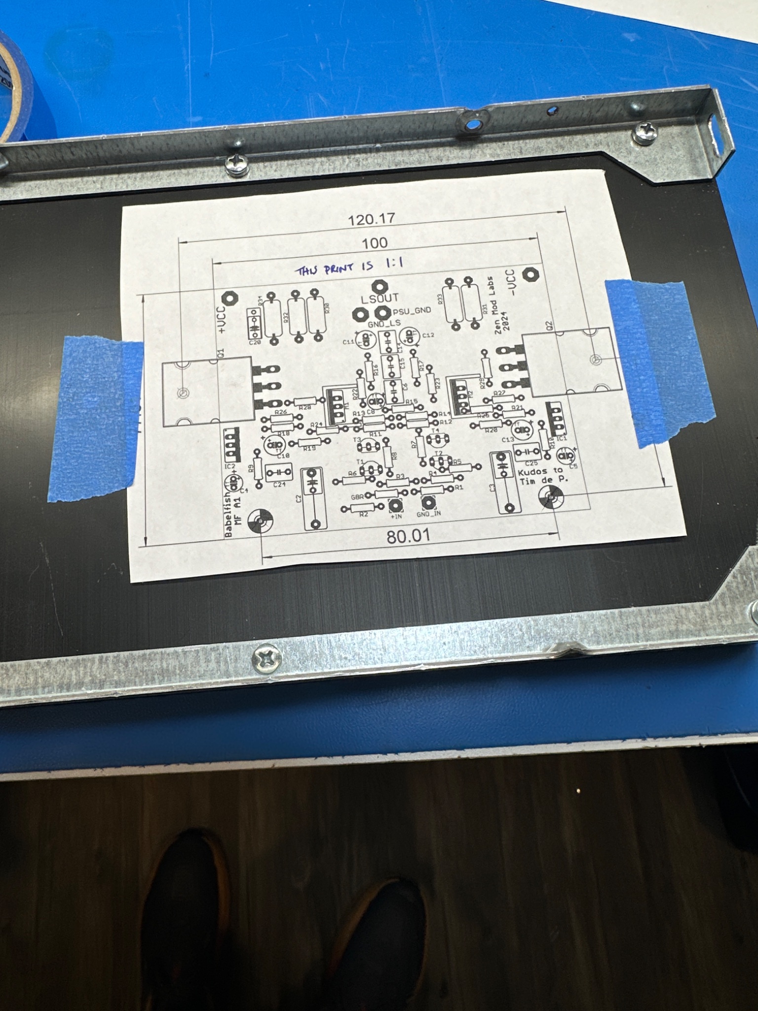

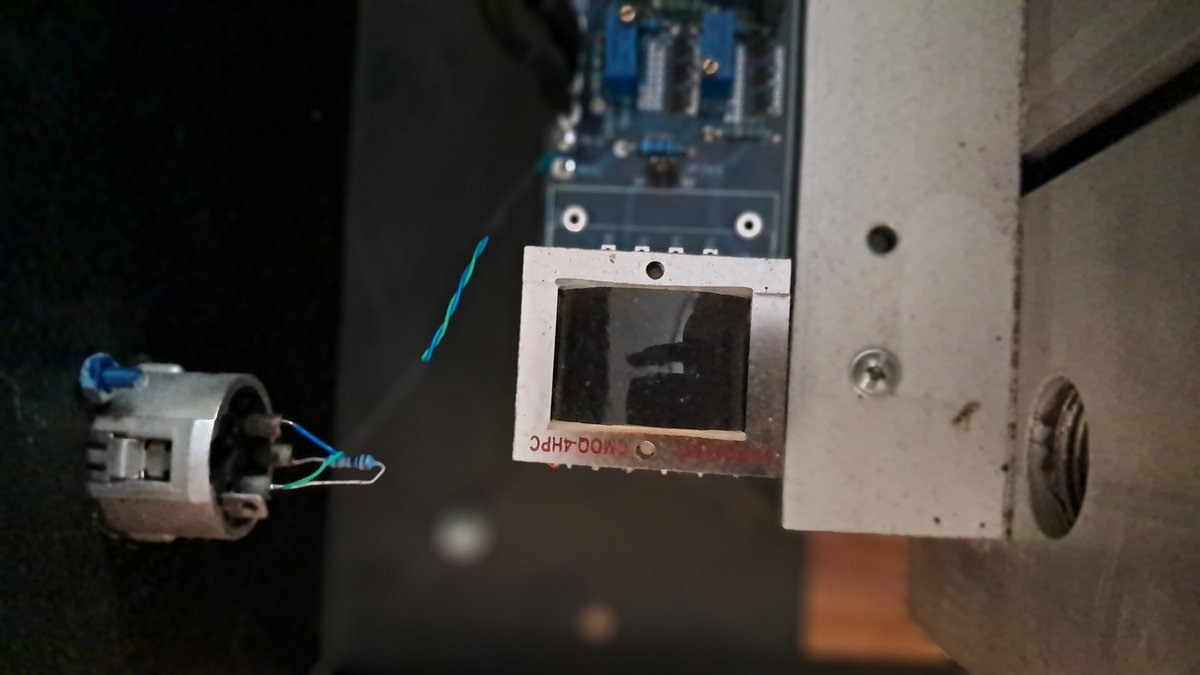

Not as much progress as hoping, but some is good. Found out too late that the tap I was using is the wrong thread, (0.6) so needed to chase the holes with a hard steel screw and ‘bend’ them to 0.5 . Went out to buy a new tap, three stores, nobody has smaller than M4. Ugh. Will have to wait for order from Bezos’ bookstore.

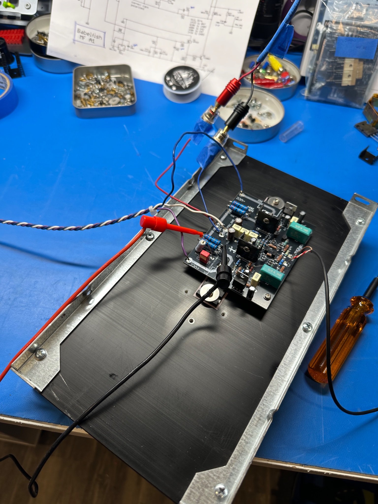

Will get out the bench PSU and fire this channel up.
It works! 😃😃😃
1A5 bias, less than 20mV offset. Very, very nice.
