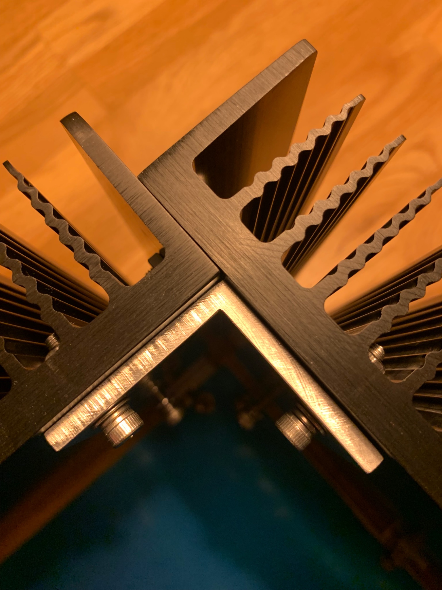

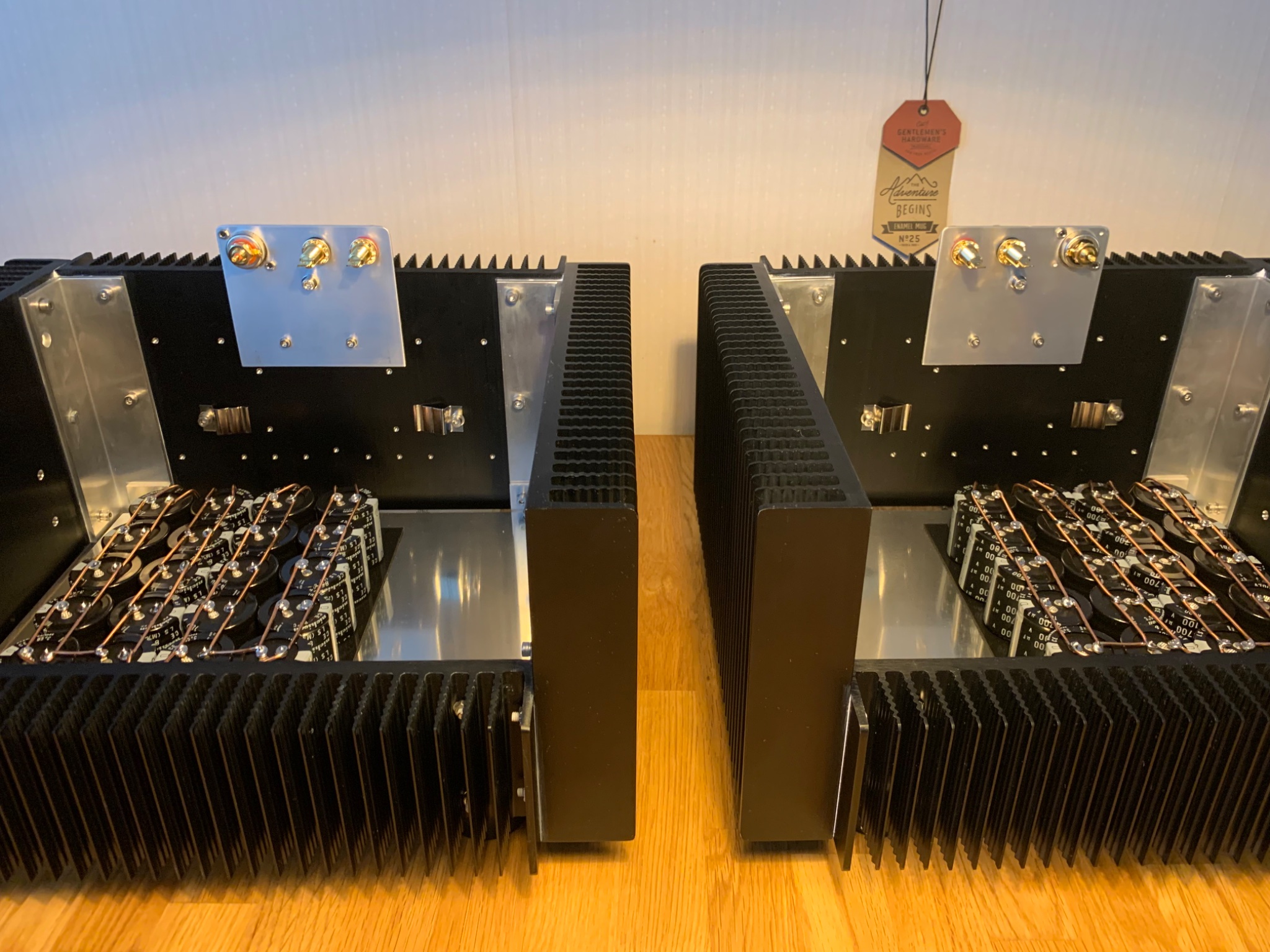

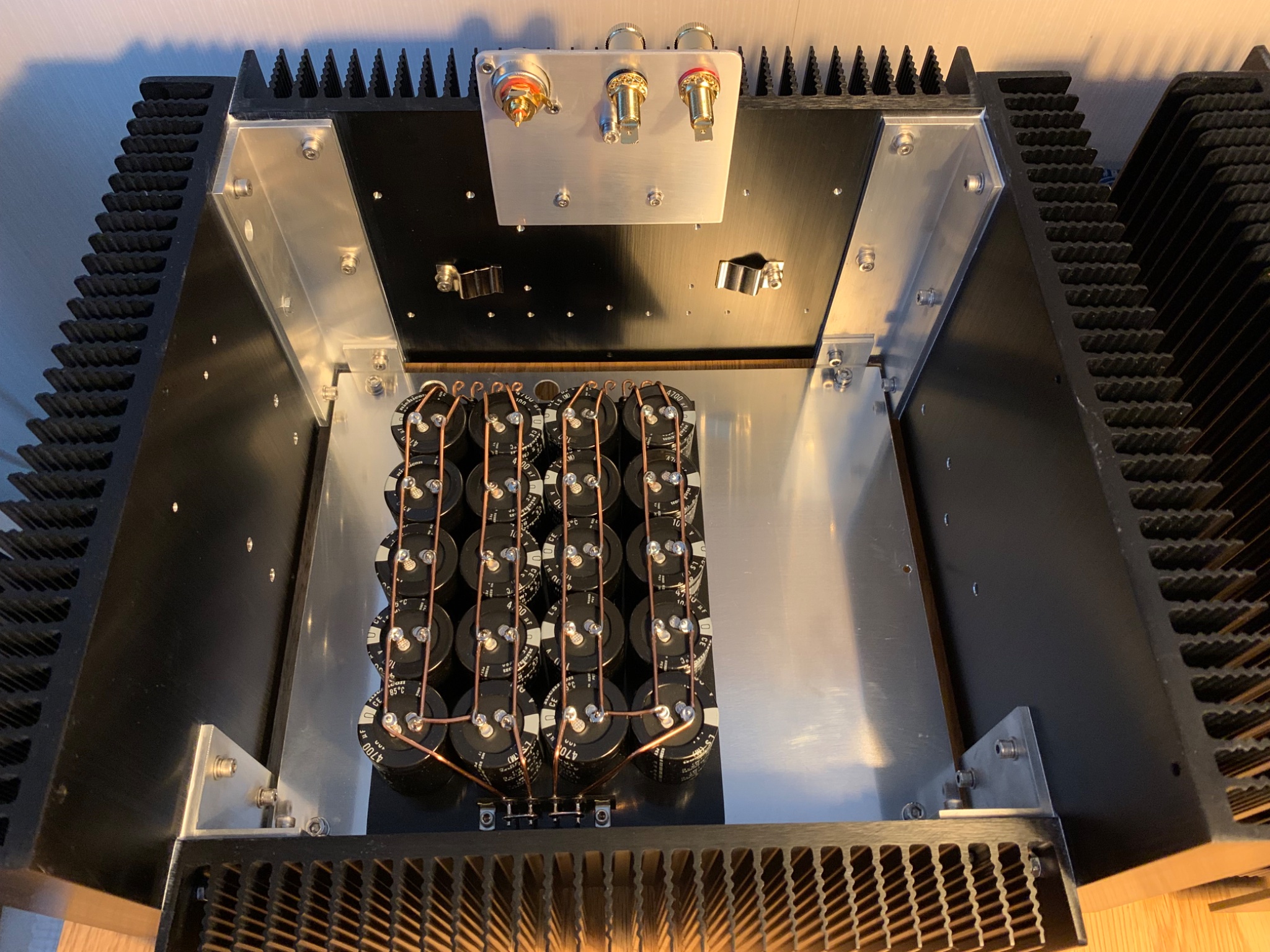

The amplifiers are drilled, tapped, pre-assembled and almost ready (the metalwork). And I need to take them apart and apply heatsink compound at all of the joints.

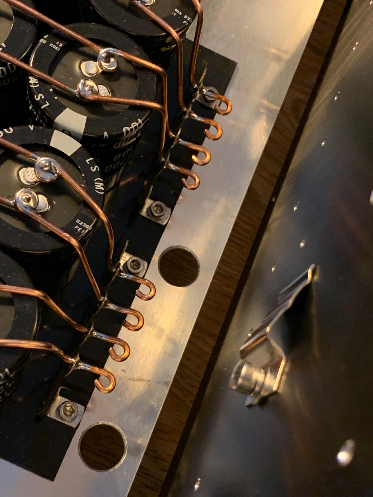

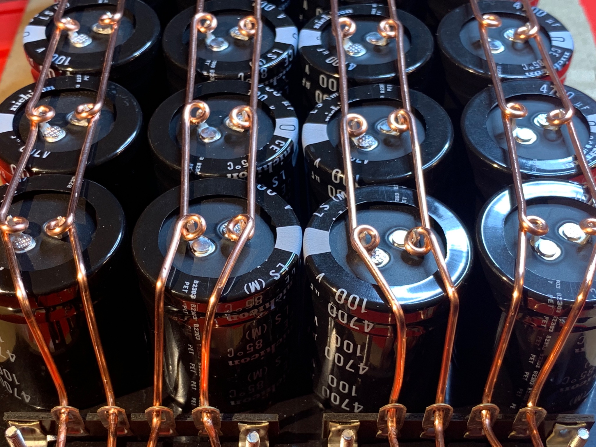

The local cap banks for each of the amps are built and almost ready, solderwork remains. They are made to be fairly easily and solidly configured as dual rail or a single rail setup.

Cap pack build. No solder yet.
Heatsink heat transfer incomplete. No heatsink compound yet.

One cooling channel, almost ready. Thermal compound applied between all connecting surfaces.
Two almost ready multi purpose cooling units. Also pre drilled and ready for the LSB and SB Tokin SITs!
Configurable dual/single rail local cap pack. And the spring steel clip for the power transistor, Babelfish MF A1.

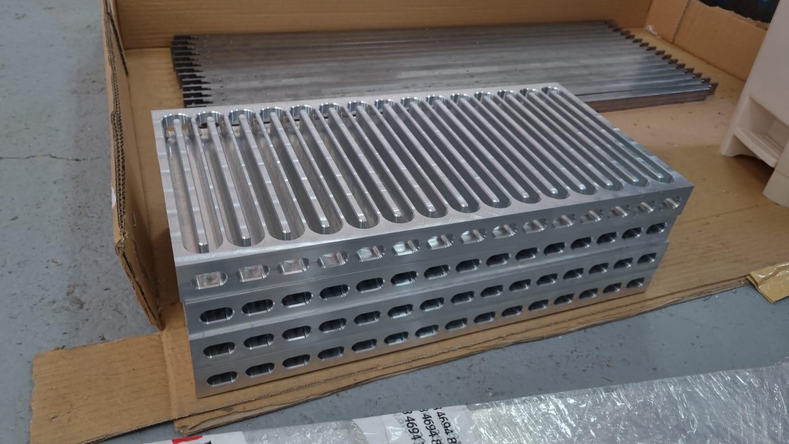

No, it's not DanDagostino factory tour...A1 CNC-ed heatsinks...milled from one block of Alu, 400x200x30 mm.
Hope PS will be finished next week. CLC, 4x22mF (Mundorf M-Lytic AG), 300VA transformer per channel
Was listening to proto version on T-bed, still have Zen's original A1 from his early beginnings (mentioned here)
The rest of the chassis will not be finished very fast but...I want to make it unique in appearance...IMHO a very special amp
