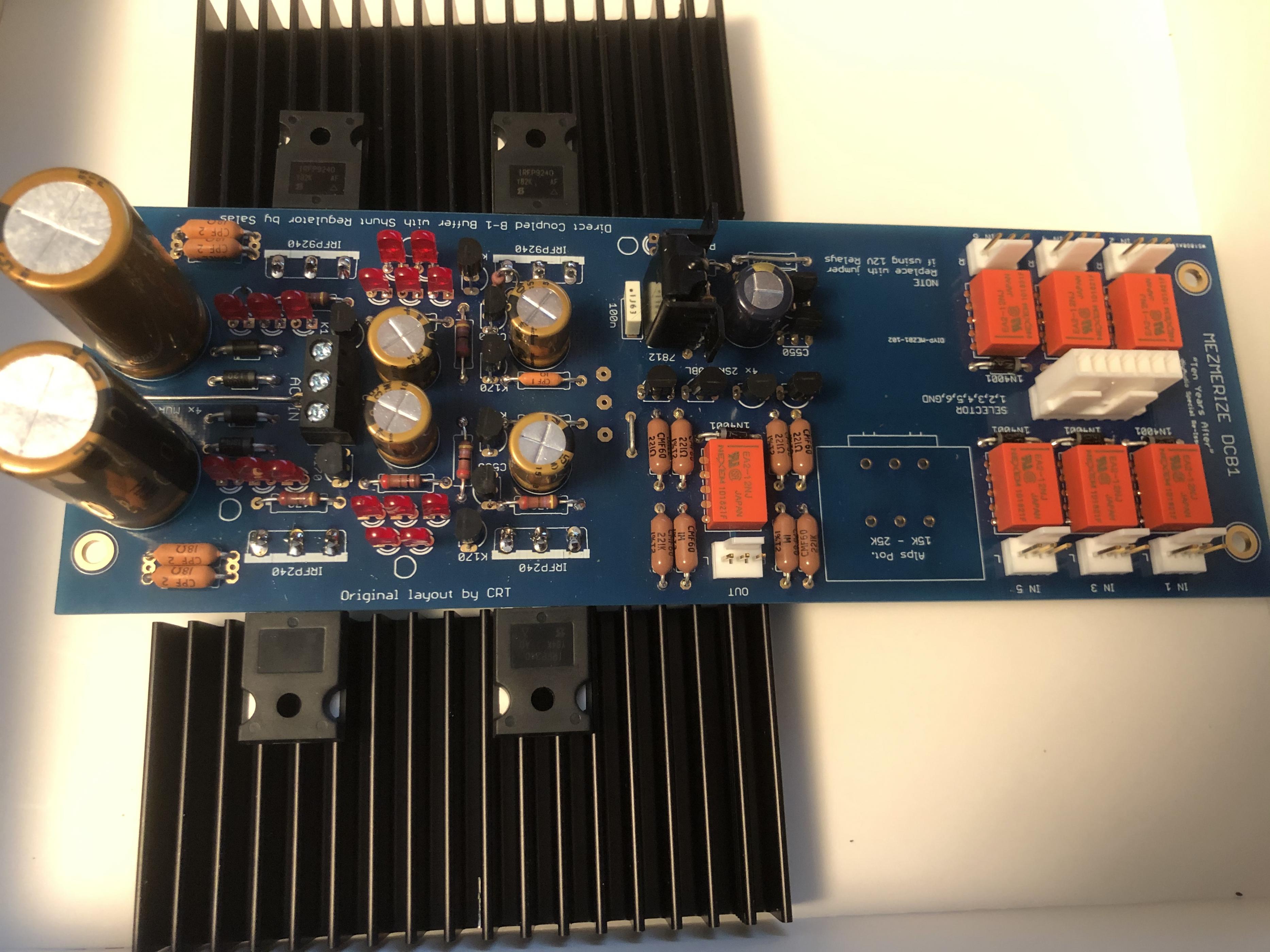

Unfortunately I started this project about a year ago. Going back over everything I noticed the 220K, 220R and 1M resistors are supposed to be super quality parts. You will notice in the pictures that I have Vishay Dale resistors. Will these be ok or should I swap them out for something else?

I am planning on using the Alps 20k motorized pot. Good enough? Is there something you would recommend instead?

Thanks for the heads up. Been reading about the Tkd. Definitely sounds like a couple of steps above the alps. If I use the 20k then no need to change any resistor values etc?

Salas,No need to change any resistor values.

So what are the best options for additional power requirements within the same chassis to power a motorized volume control, latching relays etc? It seems to me that any kind of the little ebay power supplies would be far too noisy to put in the same chassis. Am I just better off getting another Mez board and using the power supply section of that with a smaller transformer? I looked at the super regulator and linear audio silent switcher on the diyaudio store and those do not accept mains voltage.

A pot motor's PSU/driver is not critical as long as it won't have a microcontroller that stays on all the time. Same for any IR remote and/or display circuitry PSU. Just give them their own transformer and don't associate them with Mez's signal ground if possible.
Mezmerize's input selection relays are already powered by an onboard LM7812.
