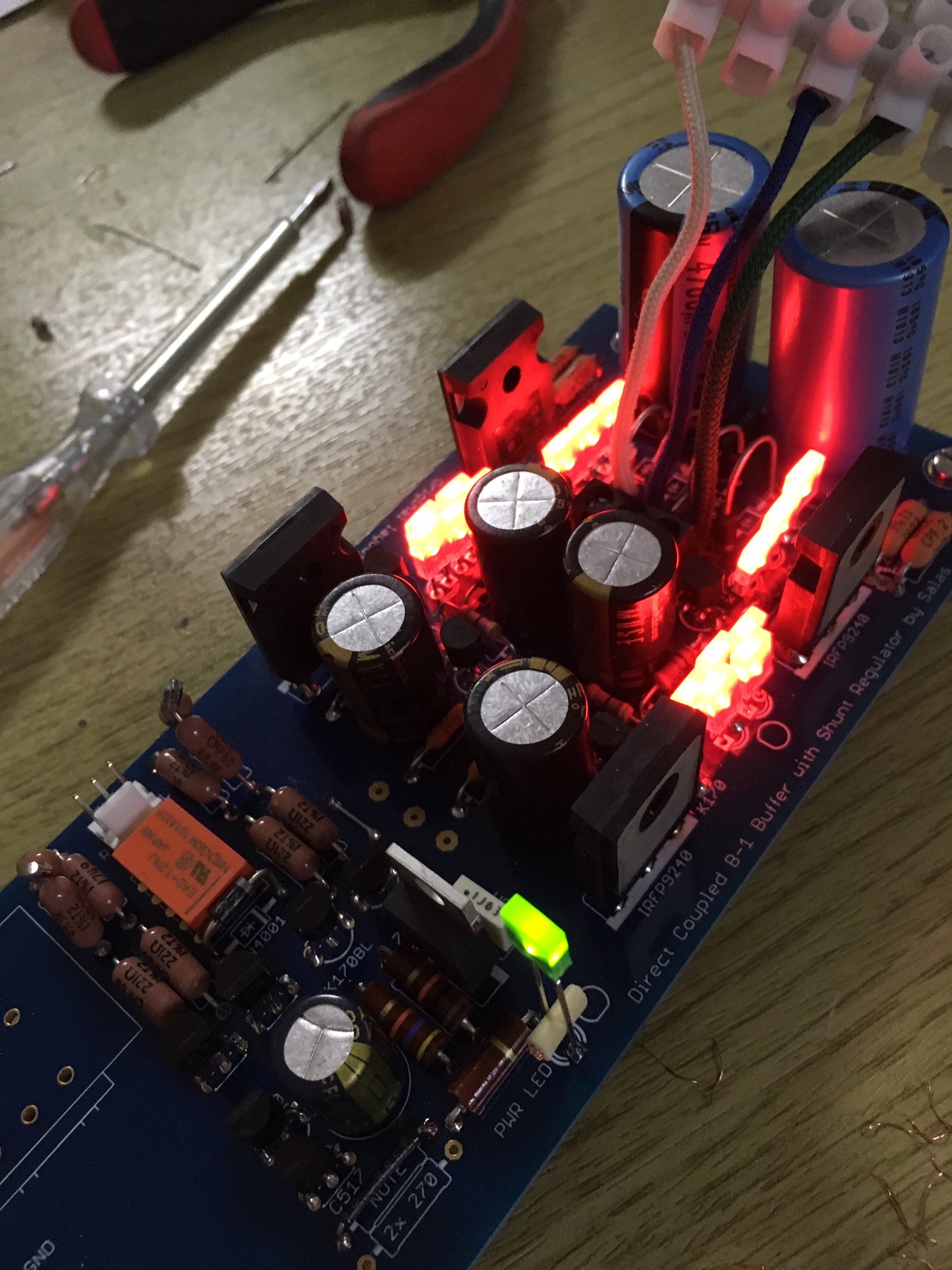

I'm through with the greater part of solder-job. I love it!
Next will be plugging the led's (want to try to match them in circuit, just for fun + learning), and my great challenge: hooking up the toroid.

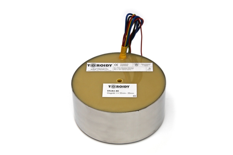

I've a toroid ts50va, just like the BOM suggested. Now, before I blow up anything, how do I connect it correctly?
Pri: 230V blue-blue: is clear.
0: green-yellow: earth out?
sec: 2 x 15 V red-red / orange-orange: uhm ...

We need a link to your transformer's datasheet to answer about wiring by colors. Most probably its red 15, red+orange common, orange 15. Green/yellow probably a screen that goes to mains earth.
Thank you Salas
It the toroidy TSAS0050 supreme audio,
Nominal power 50VA
Input voltage 230V
Output voltage 15V
Didn't find much more on it, but I'd say your information ... songs good to me. I trust you know better than me how to connect a tranny 😀
david
They should had a datasheet with diagram and wire color coding. Not just a label. Most probably its to be configured as I suspect but you could also email them to confirm. Else you should wire it as likely but measure it unloaded for correct AC voltages and confirm no tendency to overheat because the secondaries phasing must also be done correctly. Dim bulb tester is a must especially when not experienced and without a scope to see the terminals phasing.

Torrid seem to never sleep, here's the PDF they sent just a few moments ago.
(the color code is not corresponding with mine, though)
I'm confident the transformer is working very well, and will do the tests and measuring to get it right.
You are very helpful, thank you very much!
david
The datasheet refers to wire colors other than you originally described for the product in hand as you mentioned. You could mentally replace them with those on the label to make sense though.
I got a datasheet for a different transformer and first did not realize it...
Got the correct one today with still other wire color. Mentally replaced them, took a deep breathe and
HURRA!
don't test it without sinks more than briefly.
Thank you very much, Salas
I would not have come so far without your advice.
I won’t run B1 without heatsinks.
Speaking of which, is the mini-sink on the to-220 required? I don‘t seem to be able to mount it because the board is quite dense...
Thank you!
David
Its required.There are some small enough types. Maybe you can simply use a fitting raw piece of aluminum or copper instead. Or chop the sink you got a little.
