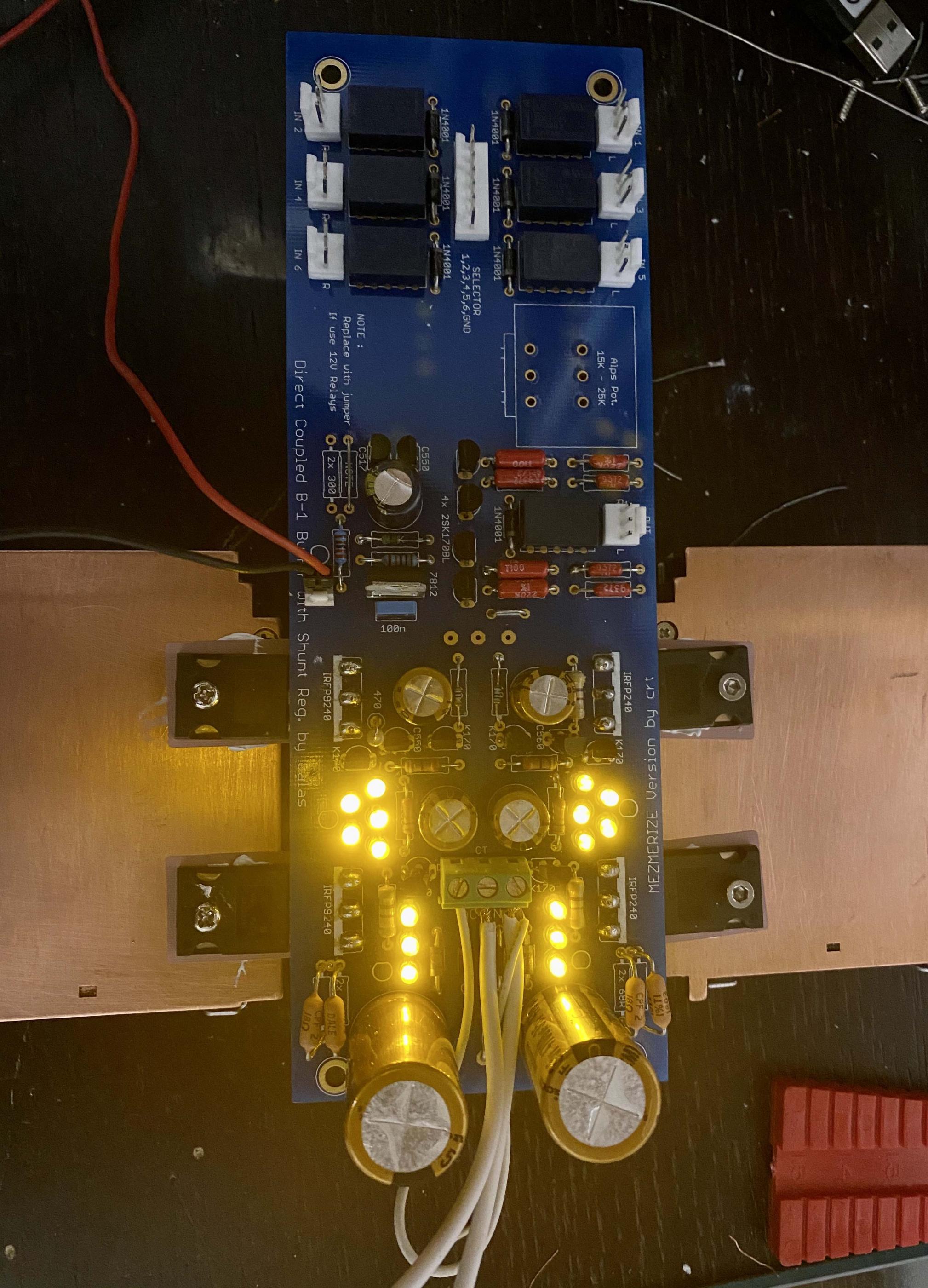

I got the heatsinks mounted (gosh was that narrow!), B1 lit up very nicely, and I measure:
-9.81 V
9.87 V
The heatsinks are warming quite differently, though: 41°C versus 30.3°C (just above the second/centermost mosfet)
What/where else can I check before connecting pot / selector?

Good morning Salas
-1.704 V on the hotter running side,
1.549 V on the cooler running side
Is that too big a diff?
must go do work, would prefer to play with B1
Voltage drops across the 2x18 Ohm resistors per side?
About 18mA diff. Piggy back a 100 Ohm normal sized resistor over one of the 18Ω set resistors on the 1.55V side. It should equalize the mA result. Now bit off due to random Vgs diff between pos neg Mosfets.

With the 100r, I now have:
left side | right side
(cooler) | (warmer)
9.88 V | -9.82V
172 mA | -177.7 mA
5 LED
9.27 V | -9.2 V
67.4 mA | -67.7 mA
3 LED
5.68 V | -5.64 V
9.3 mA | -10.5 mA
Voltage Drops (across the 2x18 Ohm)
1.43 V | -1.71 V
138 mA | -187 mA
Heatsink
≤40°C | ≤ 30°C
Are those values ok?
(I didn't pay great attention to where I put the red/black tip in the circuit. While measuring the mA, the diodes went off... I hope I didn't damage anything)
Now I'll start with the connections.
Thank you again

Hi
I've finally populated and wired up my preamp and stuck it on my test board
Here are the measurements I'm getting:
V = 10.87
V = 10.28
Measurements across the two parallel 18R's are 1.98V and 2.10V.
My measurements look fine?

The rails voltage difference is normal for a Mezmerize classic blue board (not the 2018 rev).
The constant current sources are at about 220mA (~2V/9Ω). Yellow LEDs are stronger than red so the more than average mA are correct.
To measure DC offset mV between signal and ground on each channel's output no source is needed. In case it has some offset of its own you don't want to add it.
The 15+15 Tx should not change anything much for bias voltages and currents, besides allowing more headroom and heat, but do a quick rerun over the checks. No harm.
