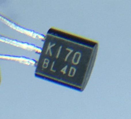

I‘ve got these jets, labeled «F170 B4D»
Are they good for the b1 ?

Where did you buy them from?
From Toshiba datasheet:
IDSS classification GR: 2.6~6.5 mA, BL: 6.0~12 mA, V: 10~20 mA
Either you made error in measuring or they are fakes.
Based on the image these should be BL grade - 6.0-12 mA
I had no Idea where to get good jets (or what to look for, found them @ Studio Electronics, Burbank CA...
They look as good ones, but I can't say more. (I'm also wondering what the BL 4D means... there seem to be other 'codes' around.)
I try to come along with this, but it‘s hard to find information about all of this.
Is this a picture you took? If yes, the external clues are right for genuine. The extra characters are IDSS class and batch code. Still do test for IDSS.
If its not a picture you took, take a macro one and post it here. There is no genuine starting with F. Starts with K for Toshiba or with LS on top left, then below it has K170 etc. for Linear Systems.

Salas,
Yes, these are mine.
Now have to find out if/what's wrong with the measurement.
Thank you for clarifying the batch code.

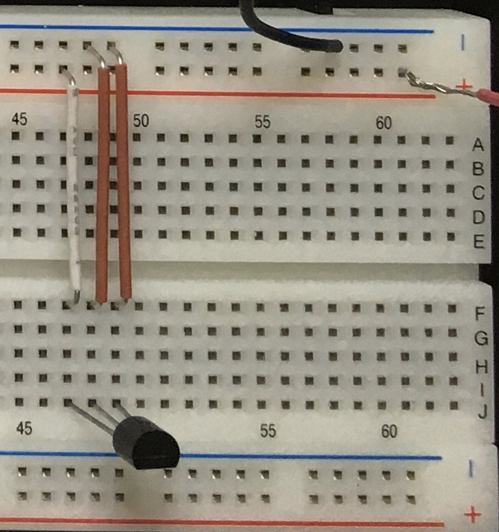

I have found out that I bungled. With or without the jfets, measurements are the same across the wires. Positive 1.96 mA / -1.18 mA. ha-ha-ha.
But I don't know yet what the mistake is. :confused:

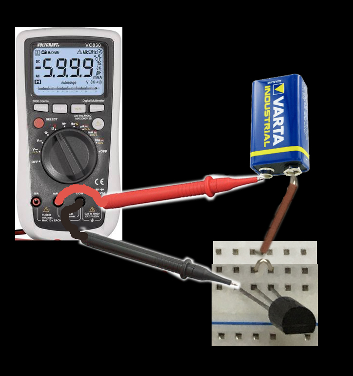

Don't use long wires. Short Fet pins 2,3 with a small jumper locally. Connect battery minus there. Set DMM to mA range, stick red probe's banana plug to the DMM's special mA input. Touch red probe to battery plus. Touch black probe to Fet's pin 1. You should see IDSS displayed.

Salsa, thank you. Sorry for bothering you and clogging up the thread.
I'm at home, "no solder"-zone :( ,but computer is ok.
So I did this simulation.
did I interpret it correctly?
thank you!

It looks OK
*Take care not to short B+ by touching wrong pins during tests because the DMM's internal mA input fuse is going to blow. And its a special safety spec expensive one. In proper meters at least.
*Before you will note down IDSS let it run for a minute to settle. Stick each Fet on paper and write the mA figure next to it for future reference if you got many pieces.
