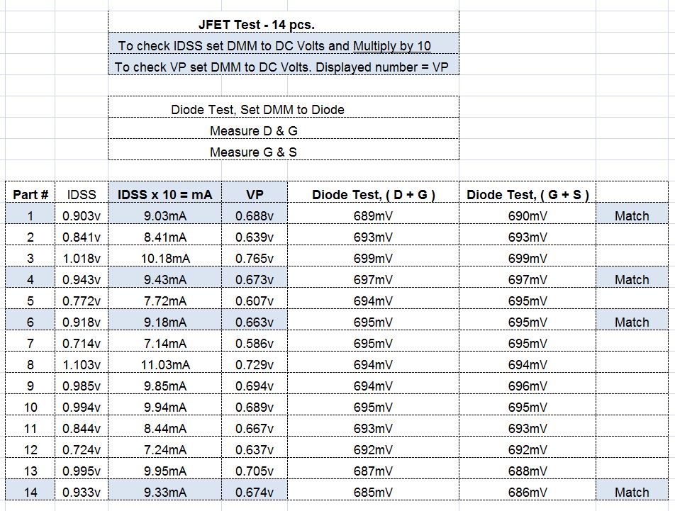

This is my first time testing JFET's. I've tested 14 pcs.
Could someone look at my number's and see if they make since.
I'm hoping #s,1,4,6,and 14 are close enough for the signal path, and the remaining are okay for the PSU.
Thanks so much for any help.
Correct. 2&11, 10&13. Because IDSS closeness within the FETS inside signal pairs is premium for achieving best offset. Yfs won't be different enough for creating significant performance discrepancy between 1-1.5mA IDSS distanced channel pairs.

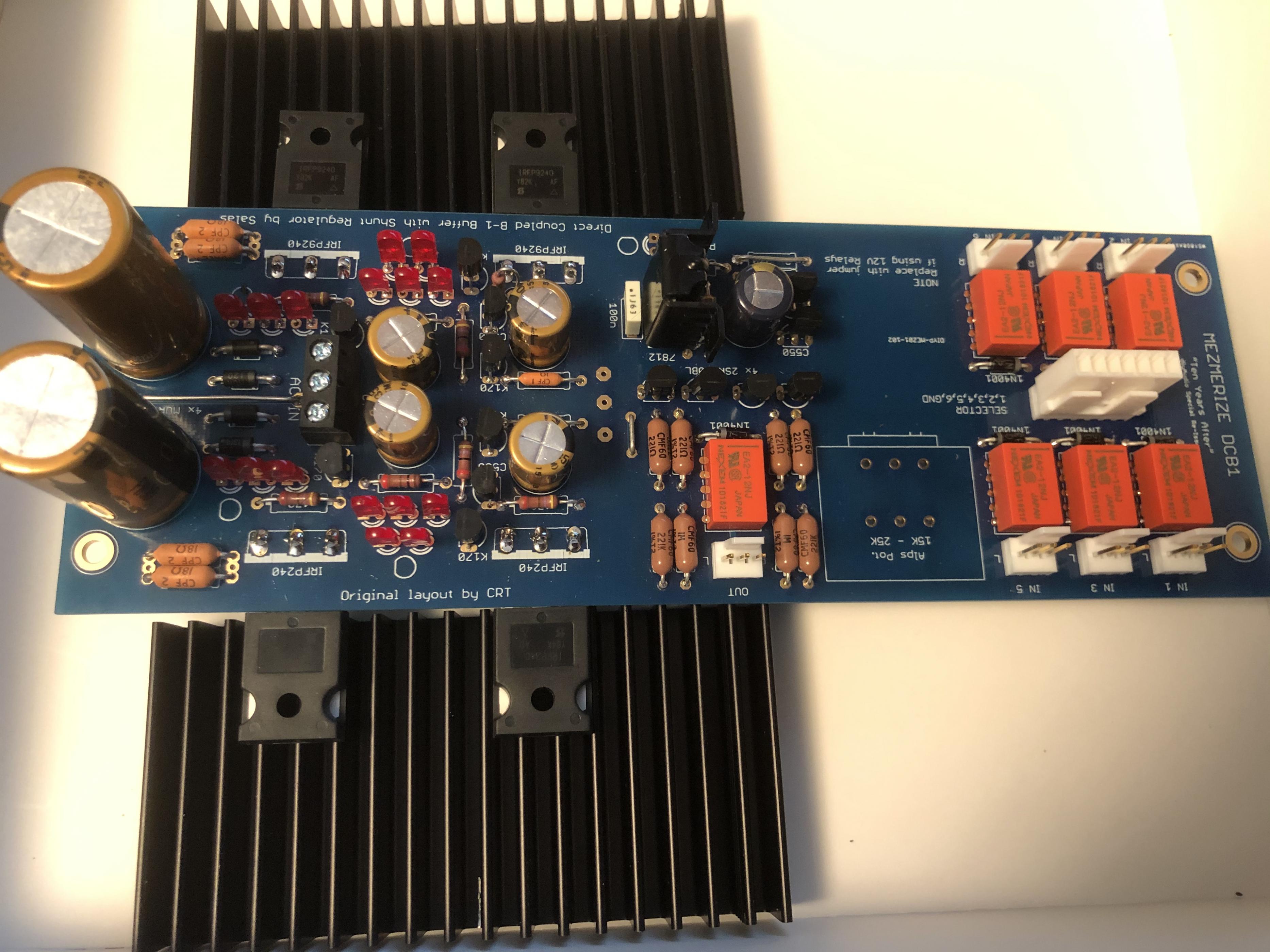

ALMOST READY TO TEST
Finally I got to spend a little time putting the board together. My plan is mill away a portion of the heat sink fins so that mosfets have a nice flat surface to get rid of the heat. I am going to ask for a case for Christmas!
A couple of questions:
Is there enough height in the Dissipante 2U (with baseplate) for the B1? I measured and it seems to be adequate but like everything else, people that have gone before me know things I have not considered.
Also the 3 unmarked pads in the middle of the board - are these just used to test the power supply portion of the board - or can they be used to power other things like a relay circuit, motorized potentiometer etc. - or am I better off adding a separate power supply for those things?
Thanks for all your many contributions to this fascinating and educational experience!
