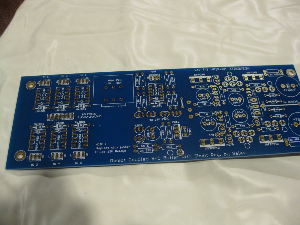

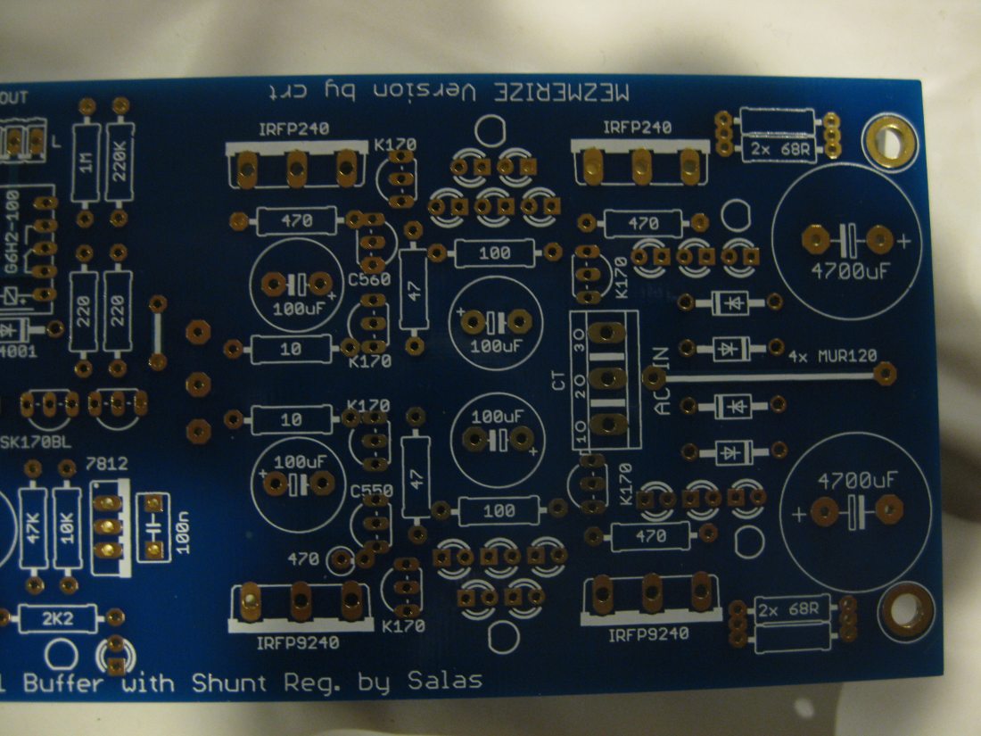

Here are a few pictures of the new Blue Mesmerize boards (Courtesy of Tea-Bag):

So, my advice for today - be careful when selecting LEDs, they want to be 1.8v, 20ma type, and 3mm.

1. Is it OK to use 2SK170GR for the unmatched J-Fets?
2. Regarding the matching of the LEDs, is it more important that the two chains are equal, or is it more important to end near 9.0V?
