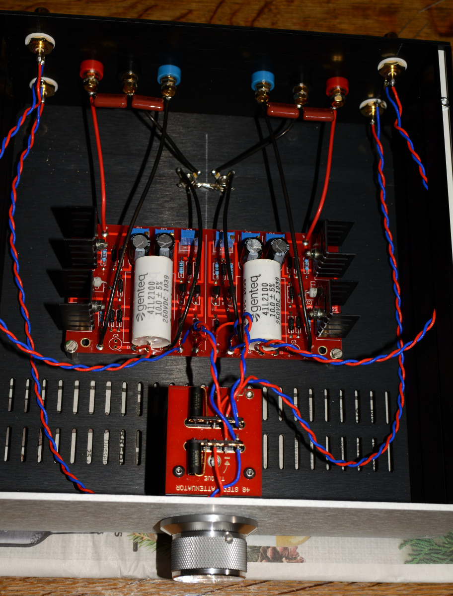

I took the easy solution and ordered a 3 mm front panel so I can mount the attenuator directly on the panel. I can see that depending on the distance to the PCB there can be a technical advantage in having a long shaft to the attenuator so wires will be as short as possible.

It plays very well. Now I just need to adjust the distortion…….I will "play" with that in the near future. Now P3 is just set to center position.
I have no hum and that is good. Noise is also low. So I guess I did something right with how the ground wires are connected etc......even with relative long twisted signal wires it works.

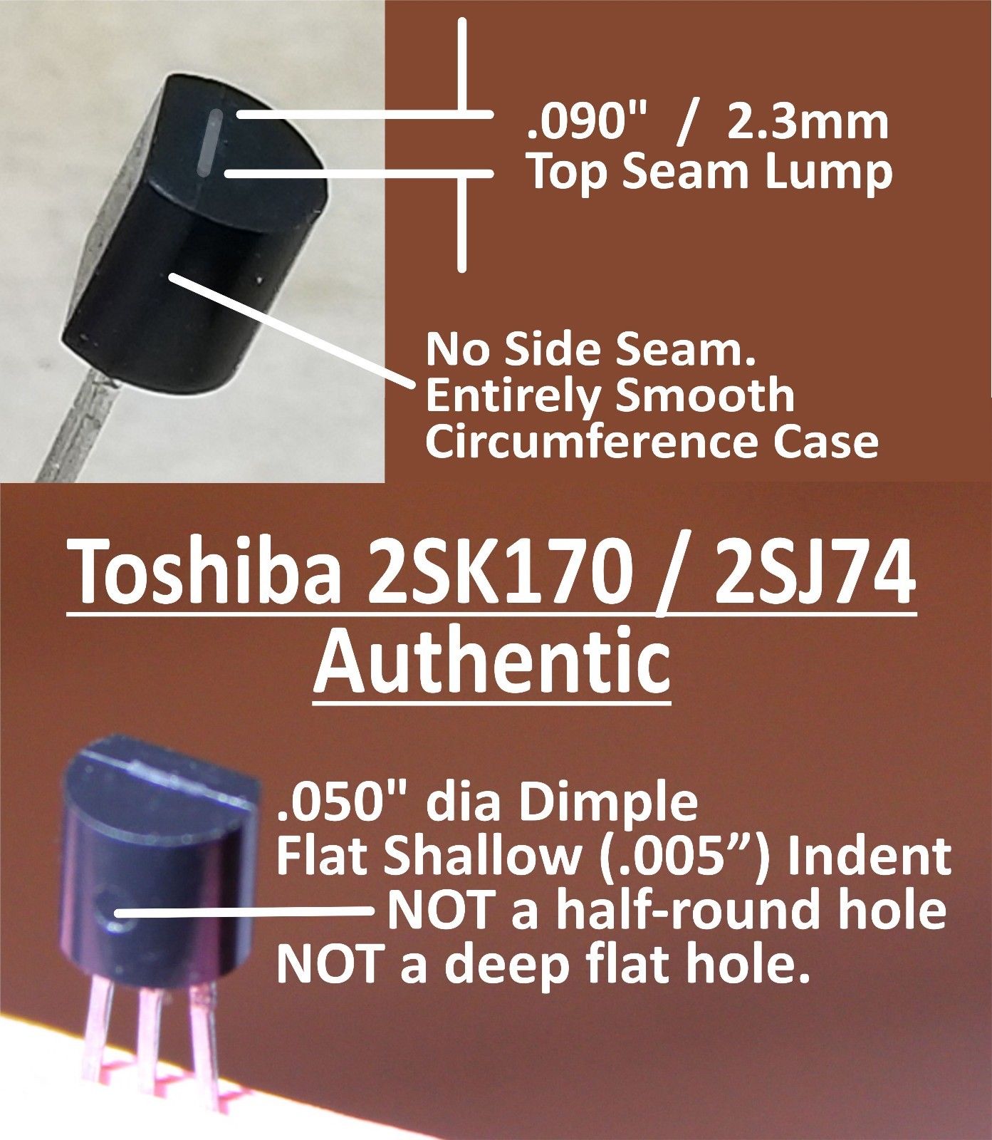

Use the BLs for the quad and the As for the PSU section. Both are good FETs it's just their different IDSS classes are better to be distributed that way in the DCB1.
For the Toshiba BLs post a close up picture of one in case you suspect fakes. We are usually able to tell.
As for measuring IDSS see this link: Transistor matching - JFET

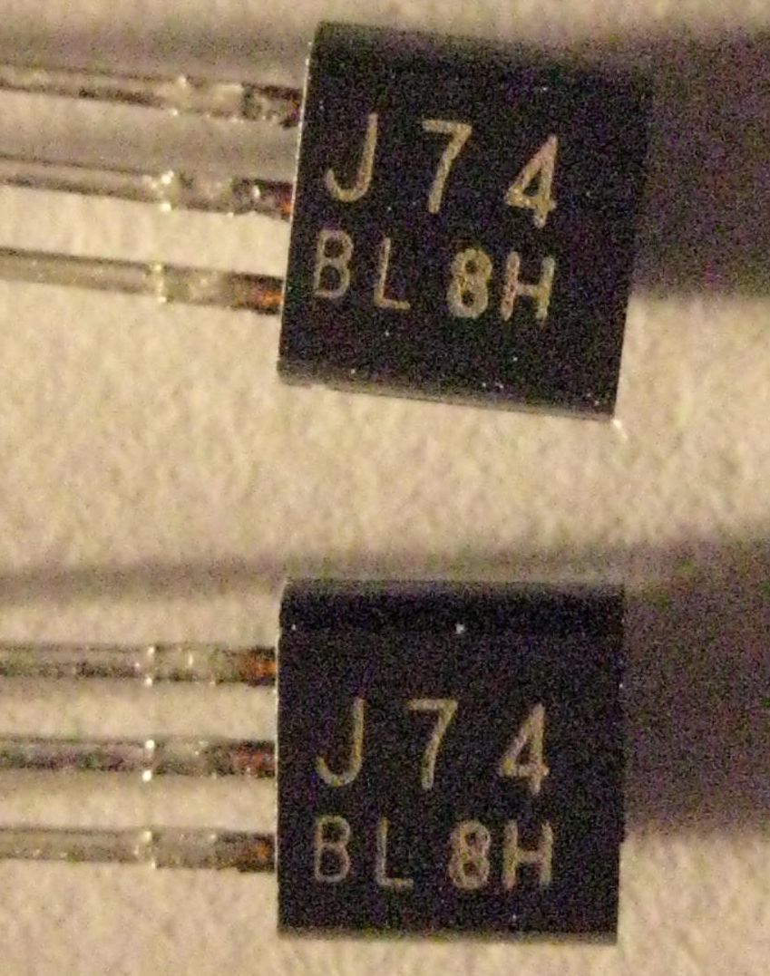

Hi salas,
Thank you for the link.
Here's a few photos of the Toshiba LSK170-BL's that I recently purchased and also a photo of LSJ74-BL's that I purchased at the same time.
Some of them have a visible line over top of the number 8 and some don't or either they faded over time.
What is the meaning of the line?
Do they look like real Toshiba's?
Thanks.
Thanks.
The print, the head shape, and the legs, look legit. If they will also show IDSS within the limits of BL category as stated in their Toshiba datasheets, they should be trustworthy.
