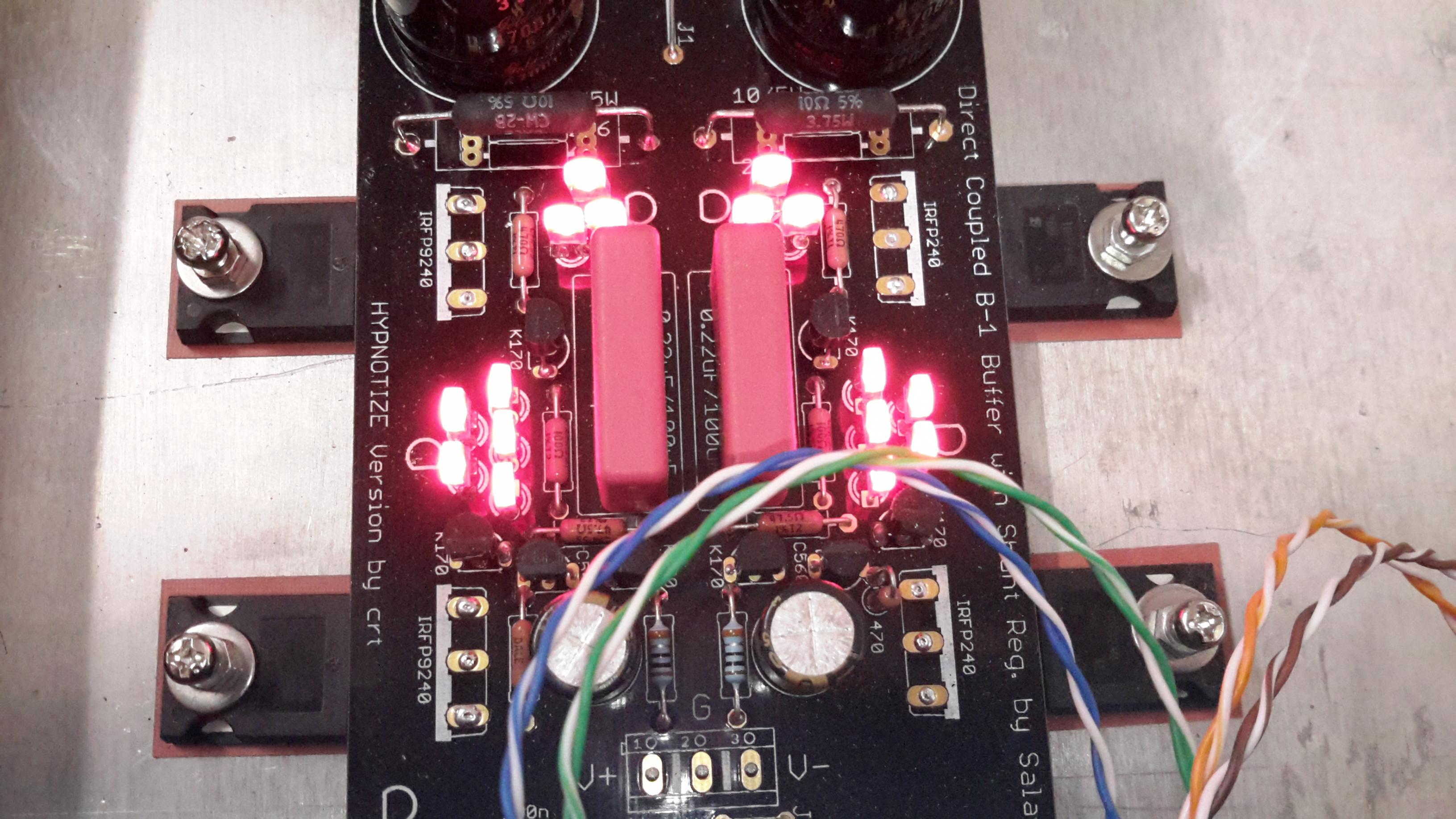

Just looking at heatsinks for my DCB1 build, going to hotrod with 10r bias resistors. I've got a case the same as I used for my ACAs, each heatsink is 245x85 finned, is one enough for all 4 driver's or should I use both heatsinks? If I was to use both I'd probably need to attach the drivers with short lengths of wire, not directly to the PCB, shouldn't be an issue should it?
One's more than enough for their dissipation when set with 10R.

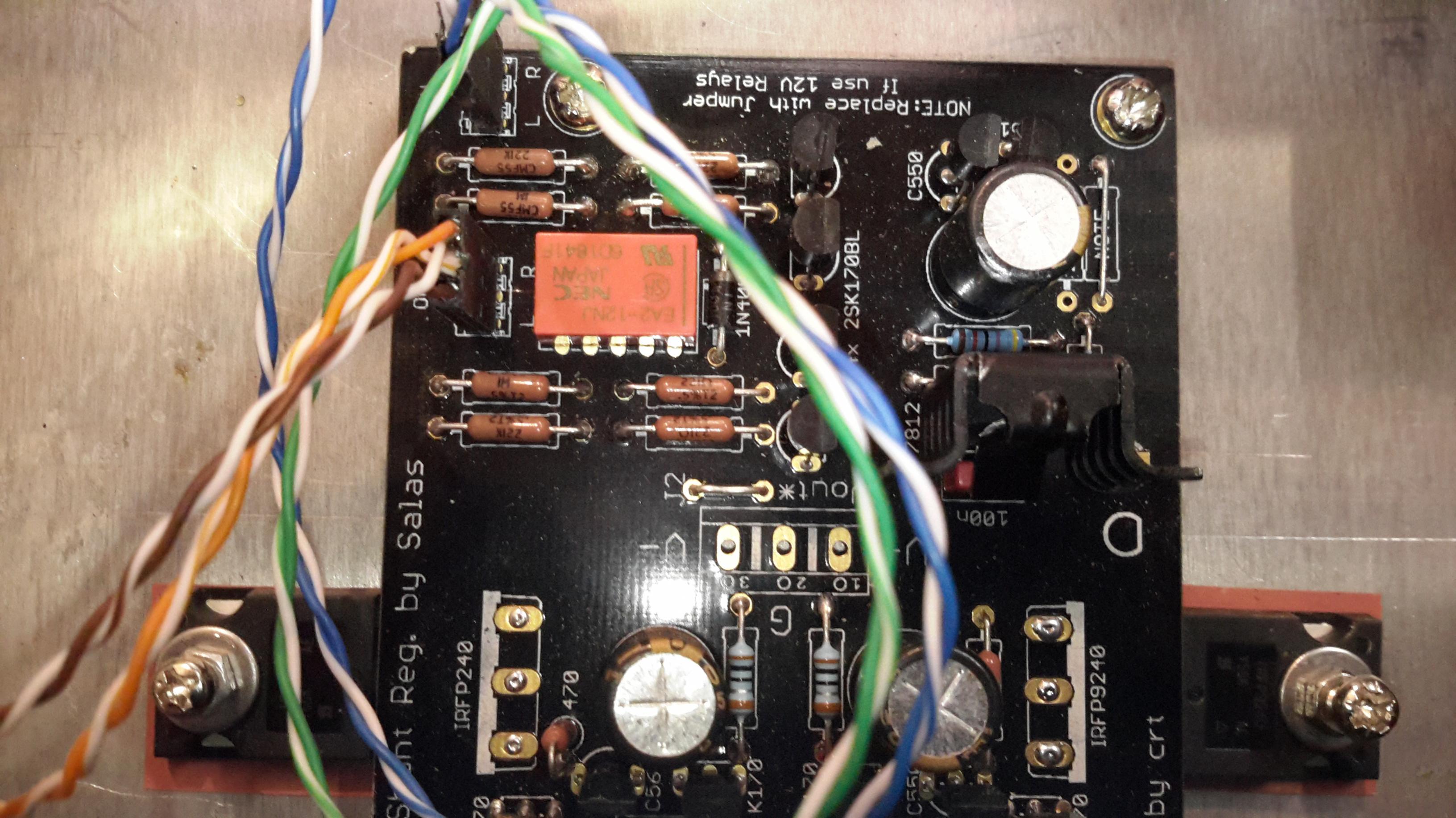

All good at power up, voltage is a bit low, 9.88 & 9.87 . I used the 12v taps on my transformer, should I change to the 15v? Also have plenty of heatsink area so should I change the bias resistor to 5r while I have the soldering iron on?
Sounds good, nice and quiet - just listening now to see what it's bringing to the system.
OK, 16.6v on the ps caps.1.8 & 1.7v across the 10r bias resistors. Everything seems OK and sounds good apart from the voltage check point being low.
Any idea's?

9.88 & 9.87 are not low rails in dcb1 practice and 16.6vdc rectified from 12v taps indicates strong mains so all is well. 15v taps would give more heat to the input Mosfet due to higher dc drop across but less Ciss capacitance. Try those taps also since you got the sinking but keep them in use only if you find the result bit more open in the treble. Else its just a waste in heat that it will be felt after you push the mA to high hot-rod.
