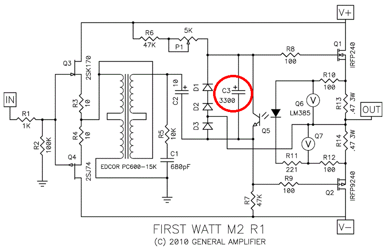

Take a moment to analyze why Nelson Pass might choose C3 = 3.3 millifarads in the optical feedback autobias circuit of his M2 amplifier. If you read his comments in the M2 thread, he fully expects people to run ultra low impedance loads while playing LOUD, so the output stage exits class A and operates class B some of the time.
The worst case pessimistic assumption is that the transformer presents an impedance of ZERO ohms to the bottom plate of C3. Then the time constant of the top plate is (47K x 3.3mF) = 155 seconds. Why did he do that? Why am I mentioning it here?

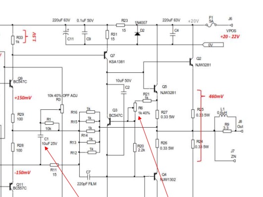

Here's how I do it. Q3 is the bias regulator which directly measures the current across the two emitter degen resistors. On a 1.4A standing current, the bias variability cold to hot is c. 40mA.

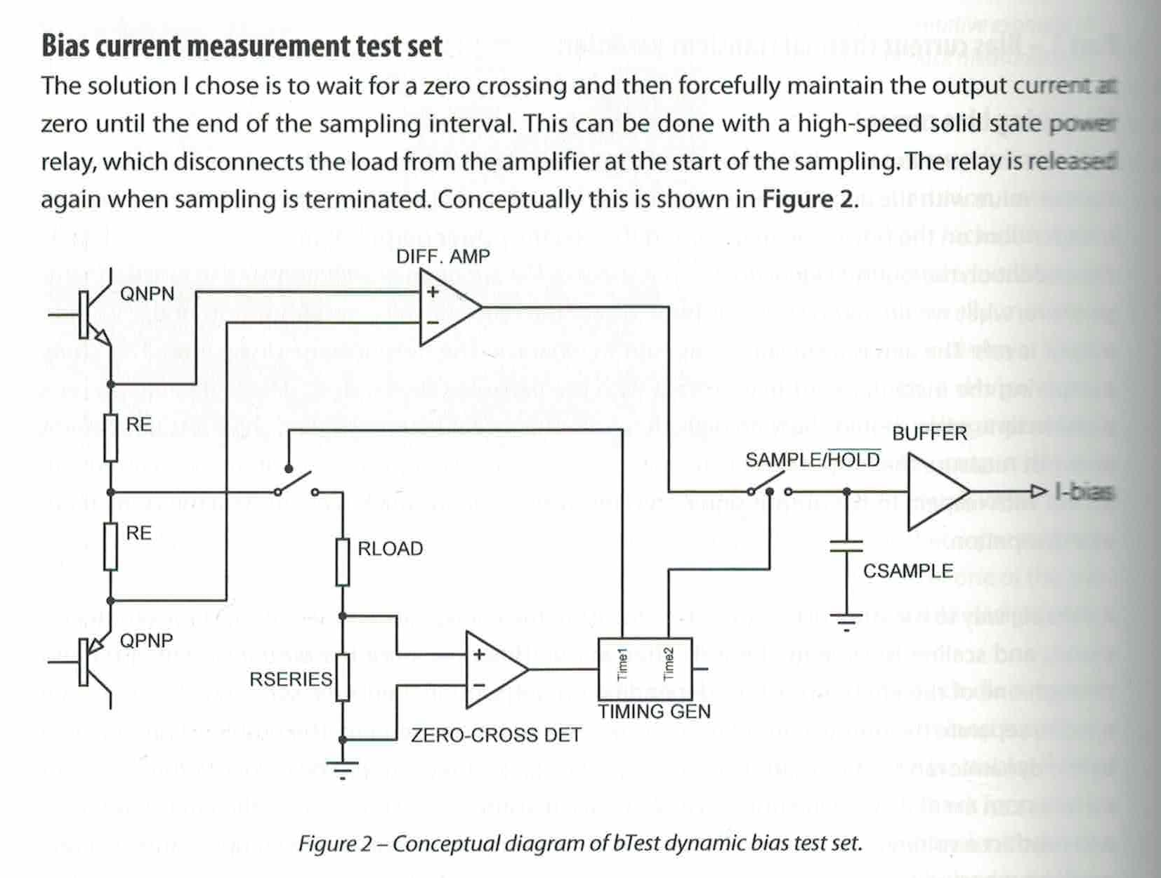

Jan Didden wrote an article about bias stability in conventional amplifiers in Linear Audio volume 9. I don't remember by heart how he measured it, and I have no access to LA volume 9 at the moment.
If you just want to make a trimmer-free amplifier with controlled bias current, you can use the trick ...
Thanks, found the 'Jan Didden' article. This is way more complicated then I would have thought 🙂 but I need to study it further, one problem is that the Zero-crossing-detector and S&H need to be extremely fast, I am almost sure that such a device will not operate at 10kHz. Maybe Jan will be so friendly to report on that (here).
The goal is not just to build a trimmer free amplifier, if possible (a simple measurement method/device) then (as stated before) one of the purposed could/would be to do this. My main goal is just to measure, and when this is possible (and implemented) I will have a look at application possibilities.

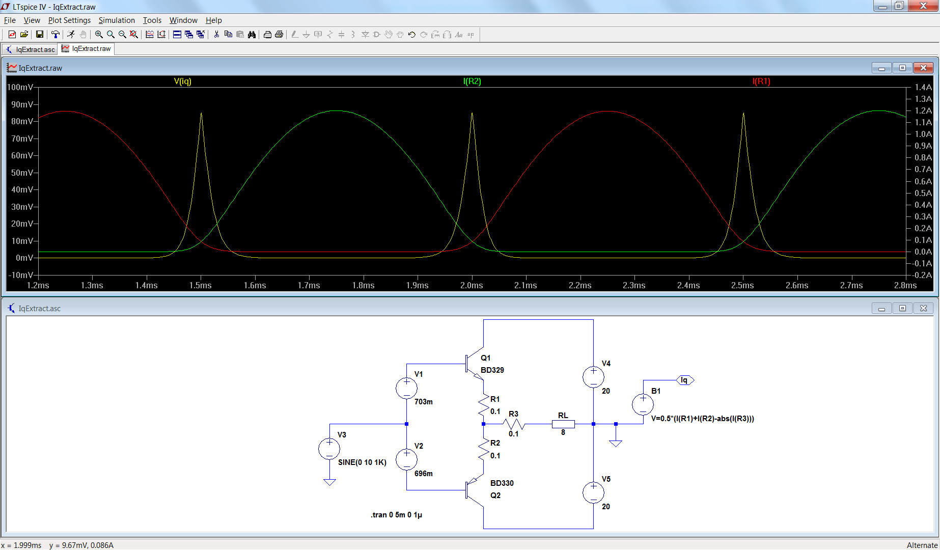

It is simply a matter of applying Kirchhoff's current law: the output node has three converging currents: current from the positive device, the negative device and the output.
The sum of Ip and In contains the output current, of course, but also twice the instantaneous quiescent current (the "shoot-through" component common to both).
This means that all you have to do is a sum, and a subtraction of the output current's absolute value (because of the rectifying effect of the class B OP).
See example below: the extraction circuitry should preferably be referenced to the output node, as all the voltages representative of the currents are also referenced there: if you try to translate these small voltages to the ground or the rails, any inaccuracy will ruin the process (the operations need to be accurate, since a big bad subtraction is involved)
  • IqExtract.asc
    IqExtract.asc
Thanks Bonsai, an averaged measurement will function for bias regulation of an amplifier, it will nut function as a bias measurement (with any precision). One possibility of an real time method/device, as I am looking for, would be to measure and verify the bias method you are using.
The method you are using needs further study, although it is not useful as an accurate measurement method, it is interesting as an amplifier regulation method.

It is simply a matter of applying Kirchhoff's current law ...
Thanks Elvee, Yes and no, the current that I want to measure is the one flowing at the moment that the currents in R1 and R2 are equal, this is true for the exact moment 1.5ms, 2ms, 2.5ms ... (in your simulation). It seems that the best (but complicated) idea (until now) has been using a zero-crossing-detector and S&H, I'm really hoping that Jan Didden will comment on that one.
If it is/was possible to just make an application of Kirchhoff's law, then it should be possible to create a/some formula in that simulation witch would calculate the bias from the given (in the simulation) currents and voltages (try it 🙂).

Measuring the current at zero (voltage) crossing is fine with a resistive load.With speakers zero voltage is no garanty for zero load current.
Mona
There is no advantage in identifying zero voltage crossing.
It has to be zero current crossing to exclude output CURRENT from the currents passing through the emitter resistors.
You just need to add a peak detector downstream of the extracted signal.
The advantage over a sample-hold is that it does not need the critical synchronization to the exact instant of the zero crossing
