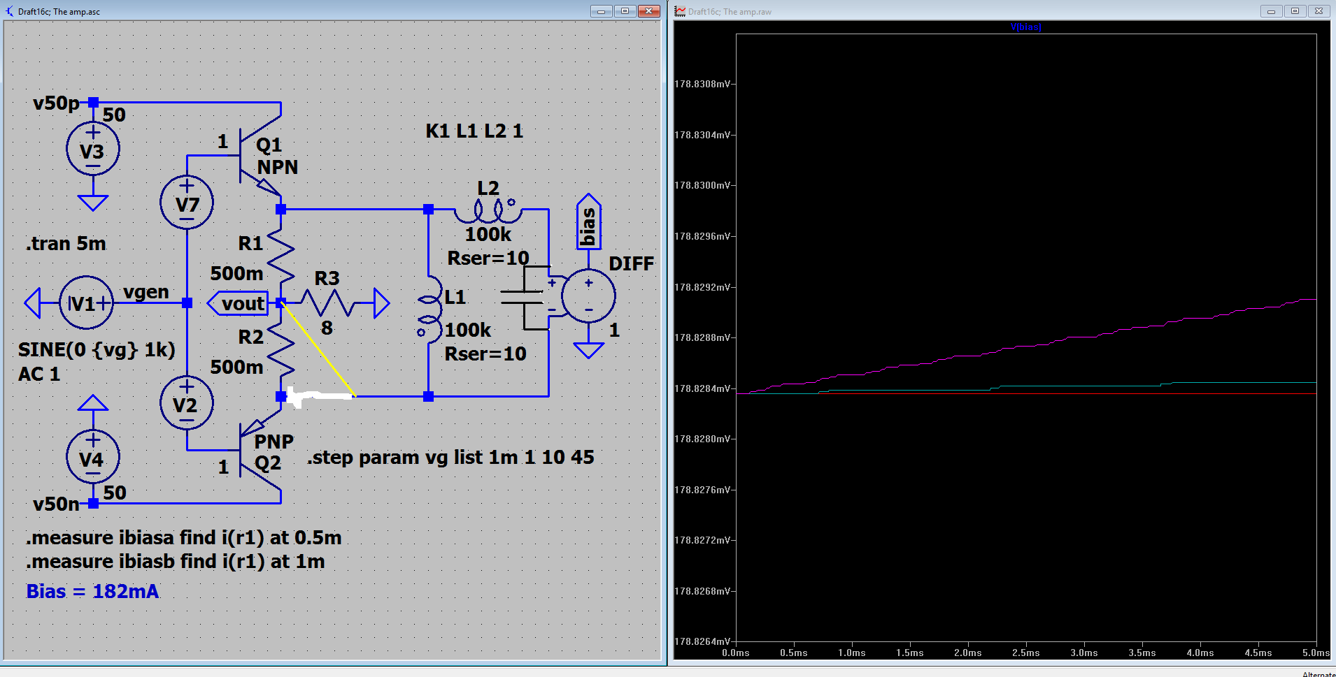

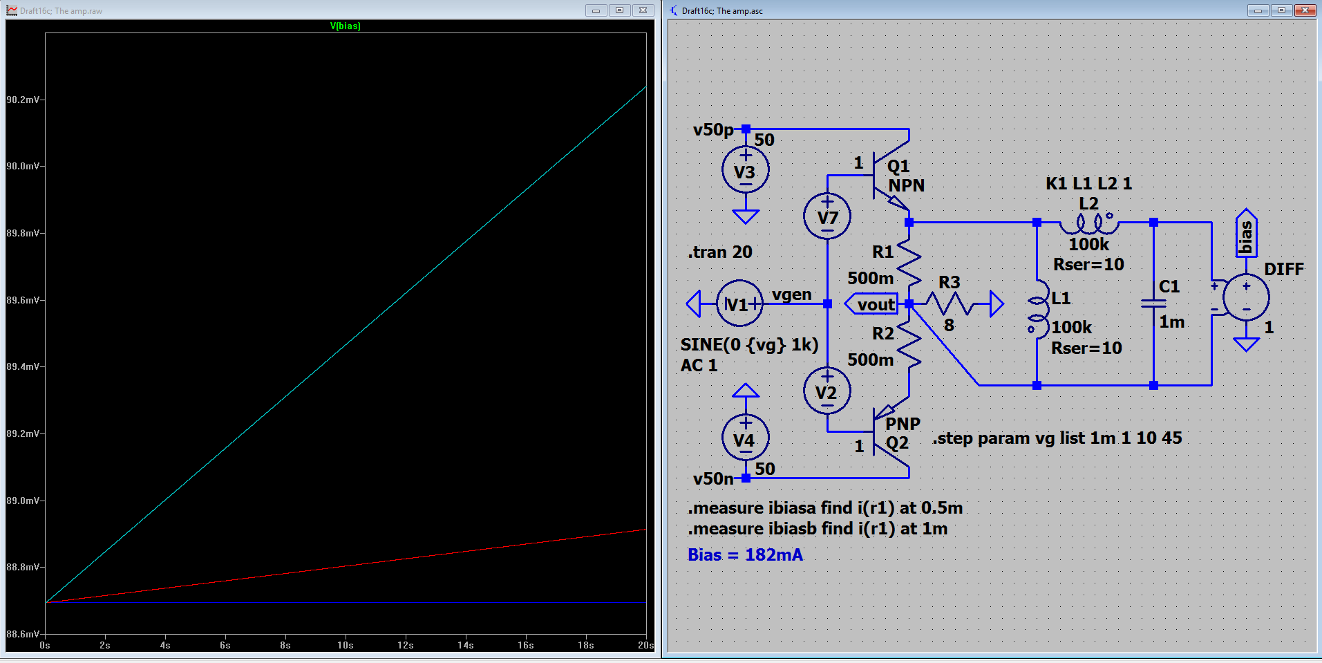

Measure DC-bias in a operating class AB (or A) amplifier
This is my tentative. Perhaps still better would be to locate in the collectors, because there the AC component is much lower. An one of the nets in each out BJT's.
Why don't you just regulate it directly? Measure the voltage across the emitter degen resistors and control the OPS bias that way. If you set your values up correctly, you can decide the point at which the OPS transitions to class AB. See the sx-Amplifier, Nelson Pass also for example.
This gets complicated because the bias current is DC but its constantly changing ( from thermal effects) so it's not really DC. The trick would be to seperate the LF audio from the bias. Don't know the bias time constant, it will be different for different amps. So the filter may need to be fairly steep.
@Bonsai, Regulate directly? But then you need to measure firstly. You can regulate an amplifier on the basis of the average voltage across the ballast resistors (and or including the Vbe(s) of Vgs(s) of devices used) but that is not the same as measuring the bias current (or voltage across the ballast resistors). My question is not how to regulate a amplifier, yes I do know how to do that, and yes I did read Self, Cordell, the papers published by Nelson Pass and many more.
The question is, is there a known/published/patented or otherwise method to measure bias in an operating amplifier? Please point me to some solution(s) to measure the amplifier DC bias, or tell me that there is no method (still I think that Jan Didden once mentioned that he worked on a thing like that).
@Bonsai, this is not about regulate, it is about measure. Have you ever seen an amplifier that measures beta to do this, and how invasive is that, would it influence the audio [quality] produces? And could I build an external (hookable) measurement device to measure the bias?
Please help me find references to documented methods or tell me that it is not possible, I really would like to know that (the one or the other).

Frans, sorry the bring Krell up again, but there is possibly a valuable idea there. Instead of measuring the bias through the outputs, it is measured at the pre-driver stage which always runs in class A. It is trivial to approximate the output bias from this measurement.
analog_sa, No need to be sorry 🙂 Yes I can see that and it can/may be used to regulate the amplifier, but it can not be used to get a absolute value (and absolute value would make it possible to remove all trimmers from the amplifier design) also it can not be used to create an non intrusive measurement device.
Can you point to a schematic that I can use to studie this further?
@east electronics, First I would like to build such a measuring device, second it would enable to build a timmer-free amplifier, and last but not least, I just want to know 🙂
The measuring device is important (to me) I do want to study amplifier bias stability under different (realistic) operating conditions. For this I would like to be able to monitor in real-time (among others) the bias behavior, set against frequency, output power, load condition(s), temperature etc.
If the measuring apparatus is simple, say up to 5 opamps a few resistors and capacitors, then one could use it to create a trimmer-free amplifier, it could even be integrated into one chip.
