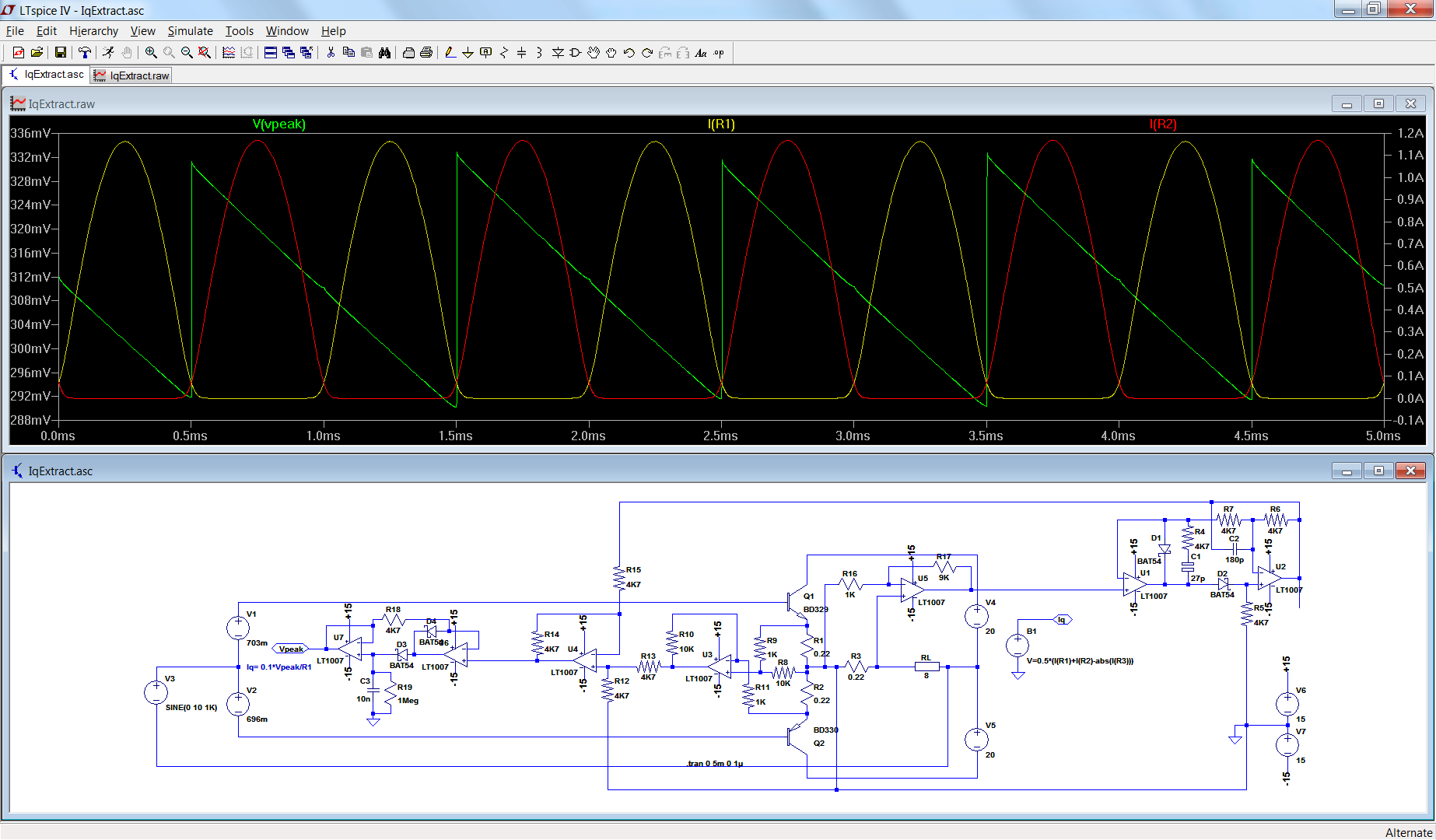

Sure, and I can even do it with "real" components, not just arbitrary spice functions.Can you show that in your simulation?
It is a plain-vanilla circuit, with every function block detailed explicitly, in a simplistic, scholar way. If you did it for real, you would use some clever tricks and end-up with half the opamps count, but at least, in this form it is easily understandable.
I have placed the ground at the output node, for convenience reasons, and the processing is carried out with a gain of 10, for a question of dynamic range.
Note that the circuit is not perfect: small offsets and disymmetries cause one of the recovered peaks to be slightly smaller than the other, but I'm sure you can perfect it 😀

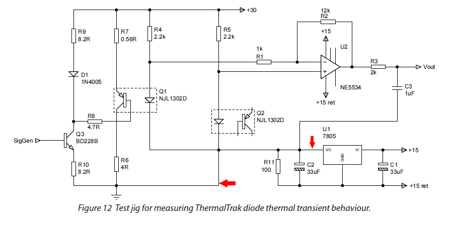

Jan Didden's Figure 12

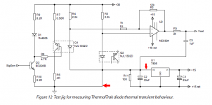

The part with red arrows (below) seems unusual; the output of a 7805 voltage regulator IC is connected to ground.
Does this mean there are two completely independent power supplies? One supply is (+30V, GND) and the other supply is a floating 15V? The 7805 regulator clamps the floating 15V supply nodes to (+10V , -5V) ?
The opamp requires a negative supply so it can reproduce the bottom half of the signal waveform, and this arrangement ensures the opamp VCC (+10V) and VEE (-5V) pins are isolated from the high current, high power yuck-noise that Q1 injects onto +30V and GND. And then C3 injects all that noise straight back into the output. Golly.

Sure, and I can even do it with "real" components, not just arbitrary spice functions...
Not bad at all, and also not to simple 🙂 I can see what you did, using the 'peak' detector functions nicely. Thanks (for the work and all).
I saw lots of stuff there, but in a quick view. In any case, it is impossible to discriminate from the emitter current, which part is bias current, which part is load current and base currents. All them are arbitrarily added inside the device, and except you can discriminate externally two of them, I see no solution readily available for your problem.
As I said, it is a verbatim, fully explicit solution: the same "algorithm" can be implemented differently, by grouping and merging function blocks differently: for example, I would certainly not use a simple absolute value detector the way I showed, but I would extract separately the |values| of Iout-Ip and Iout-In with resistor bridges and combine them later.Not bad at all, and also not to simple 🙂 I can see what you did, using the 'peak' detector functions nicely. Thanks (for the work and all).

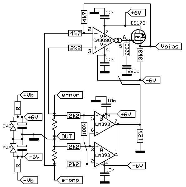

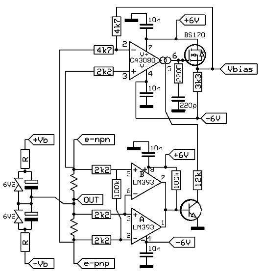

It sounds to me like you are making things complicated by wanting it all at once: a circuit that can be connected to any amplifier, that accurately measures the bias current, that doesn't cause any short gaps in the output signal and that can be used for automatically controlling bias current.
If you split the functions, it gets much simpler:
For just controlling the bias current, you can use a nonlinear network rather than something with a sample and hold or with precision peak rectifiers, like in Huijsing and Tol's op-amp, Elvee's Circlophone and my BUZ10 amplifier.
For just measuring the bias current, the short gaps of Jan's circuit will usually be irrelevant.
For just listening to a conventional amplifier, you don't need any of these circuits at all.

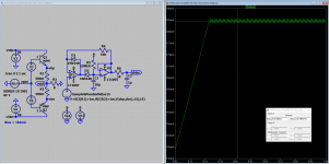

Yes and no, I just want to measure the DC bias in an operating amplifier, then (afterward) the knowledge gained can/may (as said before) be used to control amplifier bias, create a practical measuring device, ... and who knows what.

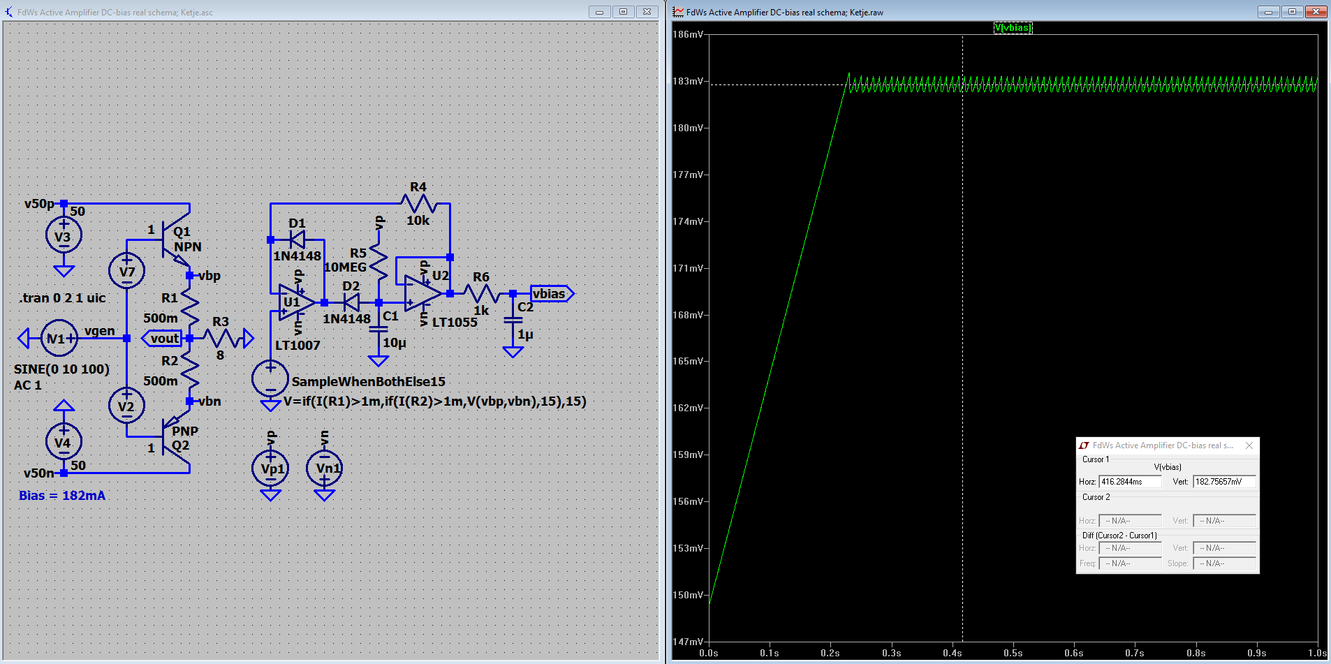

And here the simulation, looks like it will work 🙂
Yes because you simplify the circuit.I made a stupid inversion of the sample signalAnd here the simulation, looks like it will work 🙂
If i didn't made another error it should be like this.Makes it even simpler.
