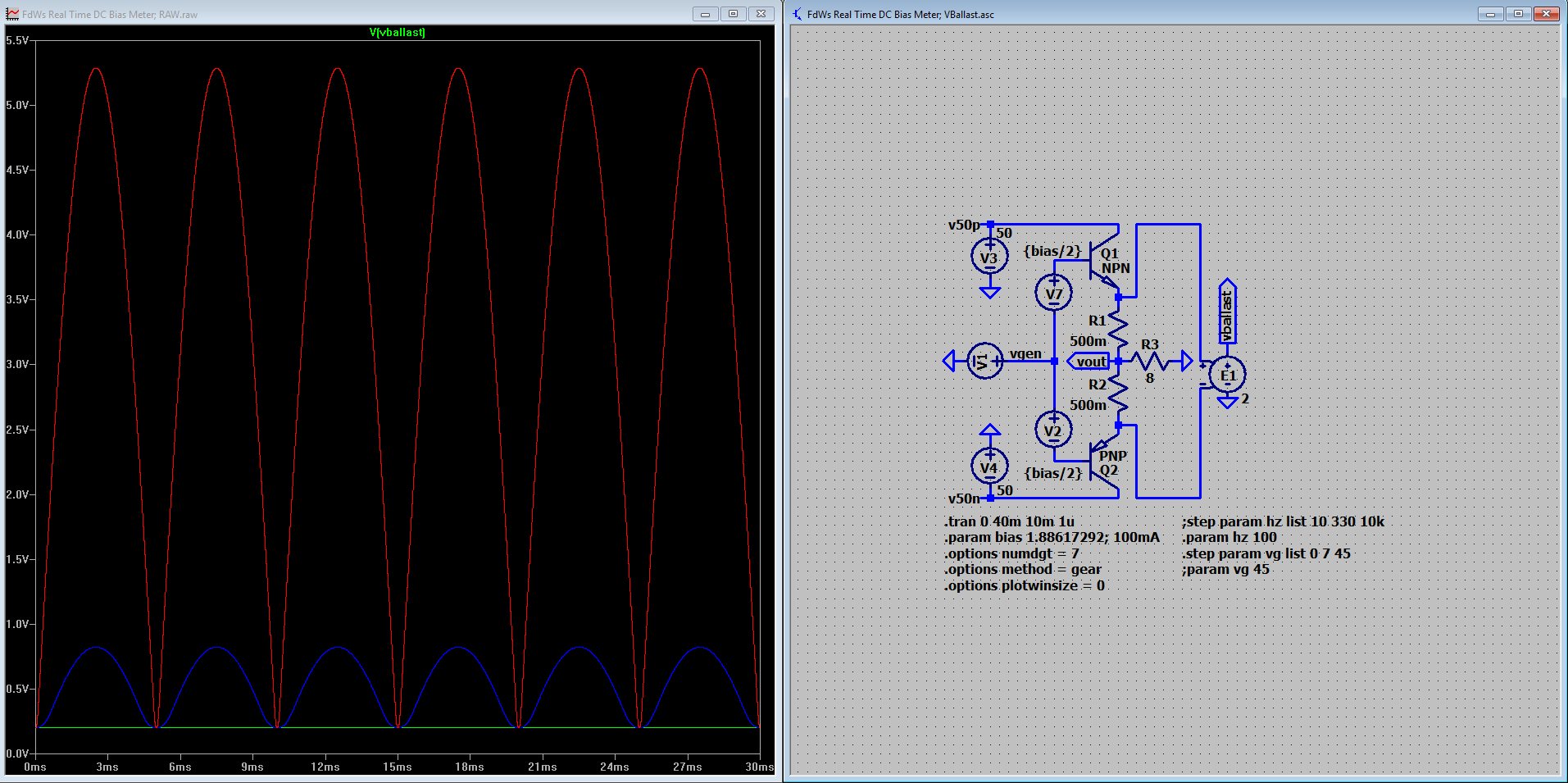

Here is one observation, it seems that the ballast resistors are in series, and for DC bias they are in series, but for 'AC-audio-currents' they are in 'anti-series'.
When the voltage across these resistors is measured this has several effects:
The audio signal is doubled in frequency
The audio signal is rectified
The bias is separated from the audio signal
The size of the voltages involved is reduced
See attached simulation and graph
  • FdWs Real Time DC Bias Meter; VBallast.asc

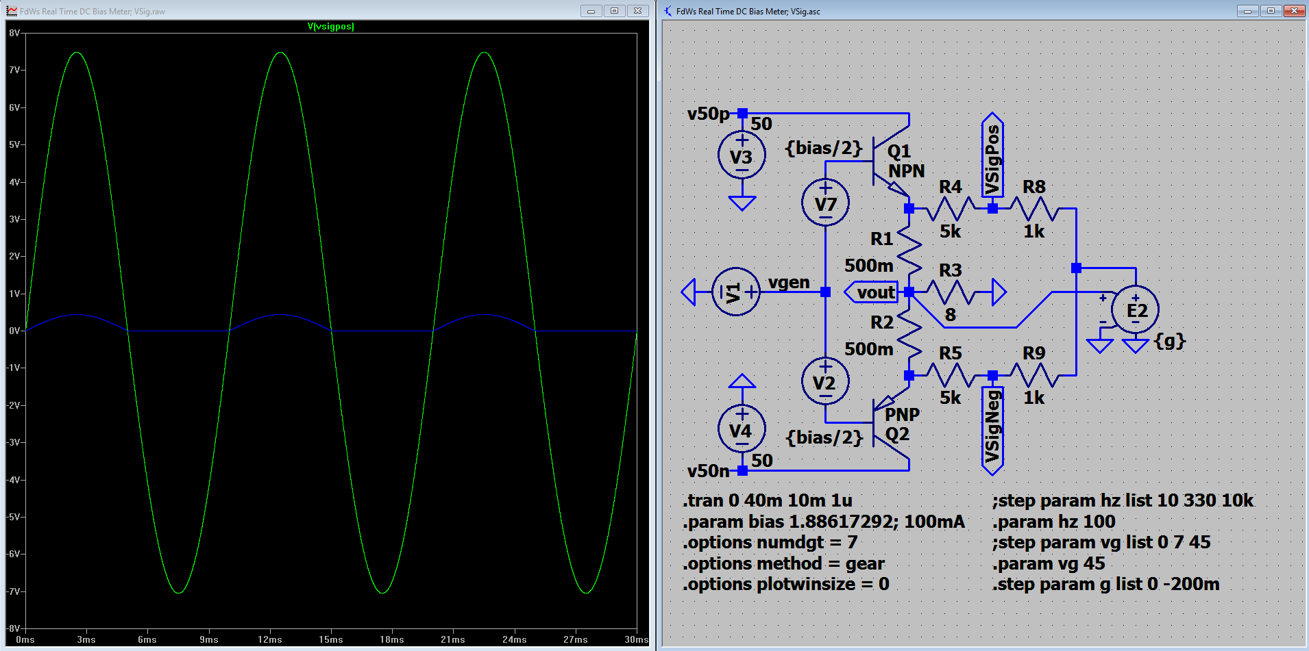

The signal generated by the amplifier under test needs to be truncated, in the previous simulation the output voltages swings from +45V to -45V, for a practical measuring device (using opamps) an voltage swing of +15V to -15V would be better. This is easy accomplished using a voltage divider at the measurement device input.
This leaves the problem of measuring precision, the smaller the difference between the input signal-to-be-measured and the signal-to-be-ignored, the easier it is to make a precise measurement.
The simulation attached here uses an inverting amplifier to subtract the amplifier output from the signal 'VSig...' to be measured, it also uses a input voltage divider to make the signal from the amplifier opamp-friendly.
The graph shows that the maximum input voltage swing changes from +-7.5V to +-500mV (the first after truncation, the second after truncation and subtraction).

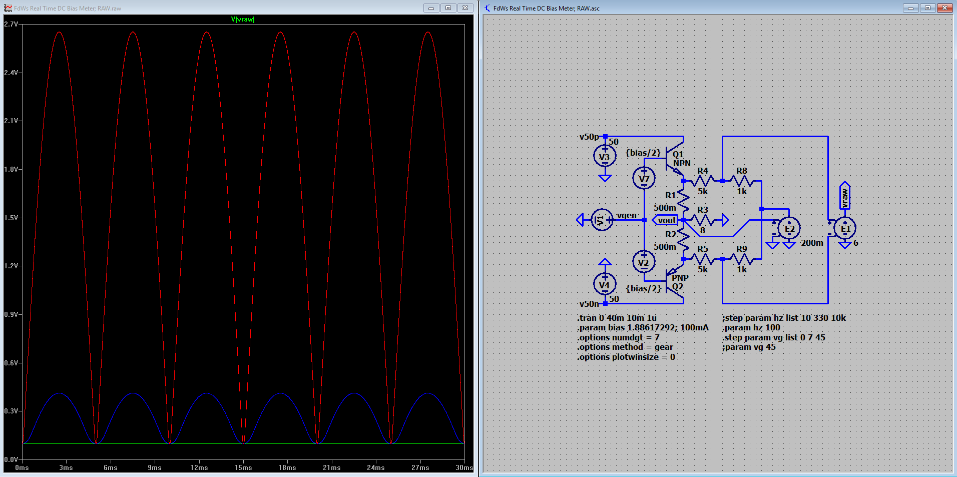

The final step, preparing the measurement source signal, is to get the difference between the VSig+ and VSig- signals, this stage can also be used to adjust the signal for the truncation that was done, so we need a bit of gain.
It is now easily seen what the effect is of the audio-signal-rectification mentioned earlier, due to this effect the audio signal is always positive, while the DC bias is also always positive, the resulting signal has the audio-signal on top of the DC-bias, it is simply a matter of detecting the lowest points in this (VRaw) signal to extract a value for DC-bias (in the simulated situation 100mA [equating 100mV across the ballast resistors])
Is to be expected if you take the inverted signal from an inverted source.
Only as long as there is current in the two resistances.If not there is no bias only audio.
Same thing as measuring the current at zero output voltage with potential problems of current/voltage phase shift.
Another problem, the bias voltage between bases and drop over emitter resistances isn't the same.There is the non-linear behavior of the b-e junction of the output transistors.

But we can agree that this is not influencing the proposed measuring method/system?
Yes, but it was stated as an observation 🙂 and it is helpful to think about it (to understand the measuring method I propose).
Only as long as there is current in the two resistances. If not there is no bias only audio.
Yes, and if there is no bias then [obviously] it will not be measured. 🙂
Yes, lets see what happens if we actually build a device.
Yes, but the Vbe voltages are not of interest for this measuring method, only the currents in the ballast resistors (equals Ie of the output devices).
Shure, but you use a fixed V2 + V7 for the bias.And that is not what you find at the emitters.
Mona
Yes? but what is the argument here? Or what do I fail to see?
I want to measure the current in the ballast resistors (where current is (V(R1)+V(R2))/(R(R1)+R(R2)), so for determining the current I assume that R(R1) and R(R2) are known), I'm not interested in Vbe's (e.g. V2 and/or V7). I do know that this is not a 'real' amplifier, it is a simple abstraction of an AB amplifier, just to be able to demonstrate/simulate the measuring method.
@Ketje, so now we are on the same page 🙂 you (or I) build your (my) 'real' amplifier, then connect the DC-bias-measurement-gadget (if ever one exists), turn on the power, turn on the music (now we can listen to music while adjusting the DC-bias), and then you use the bias-adjustment-potentiometer of that amplifier to adjust the bias.
Or we use a servo to compare the measured DC-bias and with a fixed reference, then we use the output of the servo to adjust the bias-generator. The fixed reference is independent of the Vbe's involved.
Or... maybe we can think of some other purpose for this method/device/gadget 🙂
So, you see, all problems solved (except for building the DC-bias-measurement-gadget).
