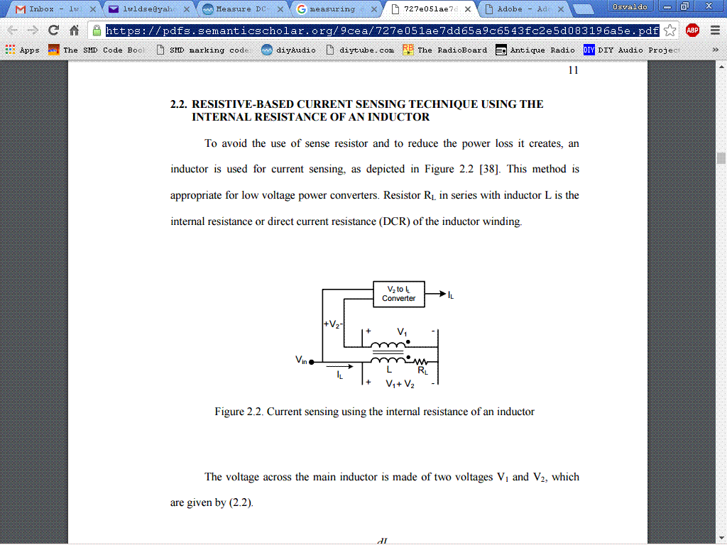

Thinking in the air, I believe that in a class A is simplest because the mean level of the signal is zero, then filtering out the AC signals will give the Dc component alone. But in class AB it is not true. I was also thinking in a double winded coil, wired substractibely...
Something like this:

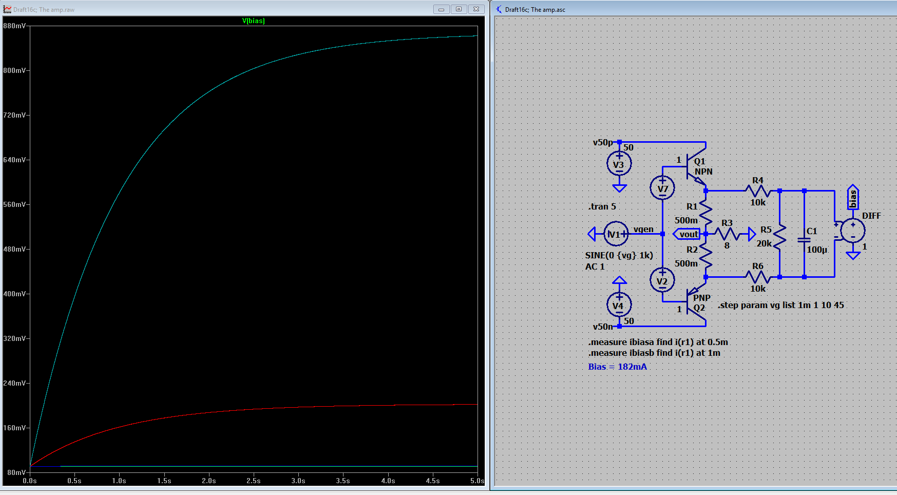

@Osvaldo, here is the filtered result for several AC output voltages(vg)
.step param vg list 1m 1 10 45
The results vary from about ... mV to near 800mV

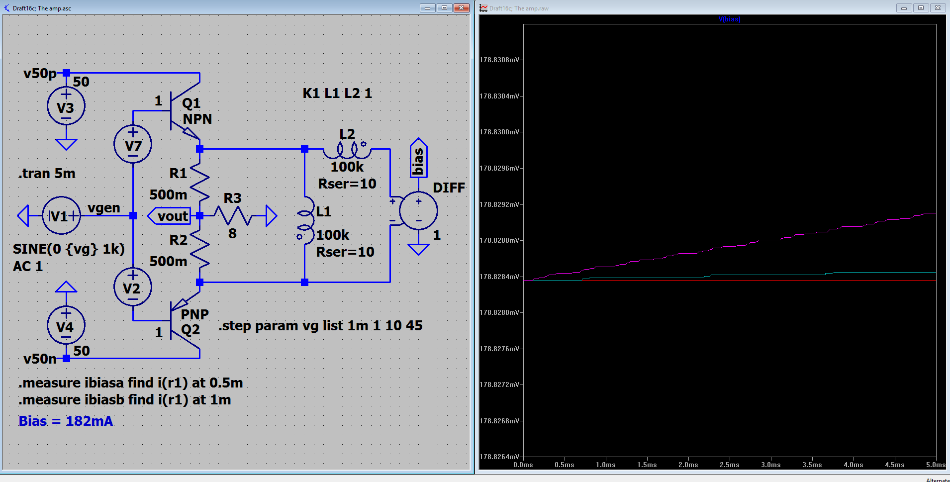

@Osvaldo, here with transformer it looks way better, but I needed to use a 100kH coil to get the shown result. I may be wrong to implement the transformer like this, any suggestions are appreciated.
The simulation shows 178mV (not 182mV) due to the fact that the 10 Ohm transformer is in parallel with the ballast resistors.
The transformer needed is also problematic, a huge bandwidth is needed, say, ...1Hz to 50kHz..., but when all fails this may be a direction to work on.
One problem is, that it will fail at low frequencies but not at DC 🙂
