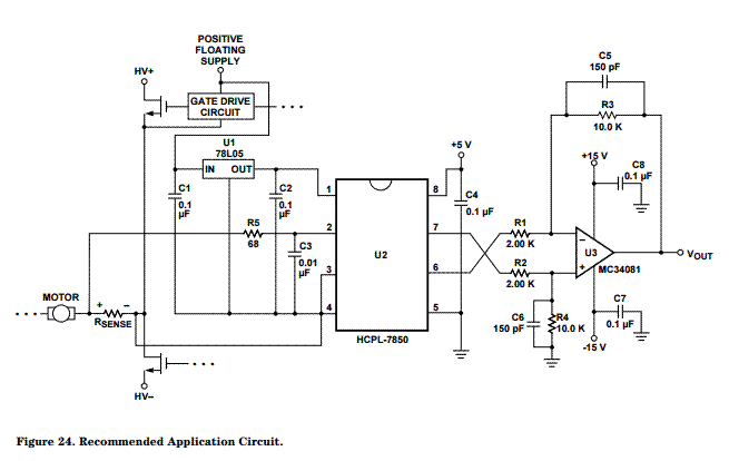

Then I don't quite understand what your question is unfortunately. The current through the source resistor drives the opto, the transistor end Has a cap across to smooth and you get a dc voltage out. You can ref that to ground or positive rail, up to you.

@Osvaldo, Post #19 shows an 'effective' simulation using a 'voltage dependent voltage source' with capacitors for insulation and a 480k resistor replacing the HP's input resistance. The result shown is what an 'ideal' HCPL7850 would show you. All other problems (like AndrewT below mentions) still exist.

Sorry, I don't see in the data sheets that any isolation cap is needed.
Only replace emitter resistor by the sensing resistor or add it in series, as in the pic below.

Respectfully, it appears that you don't let us help easily, guy‼
