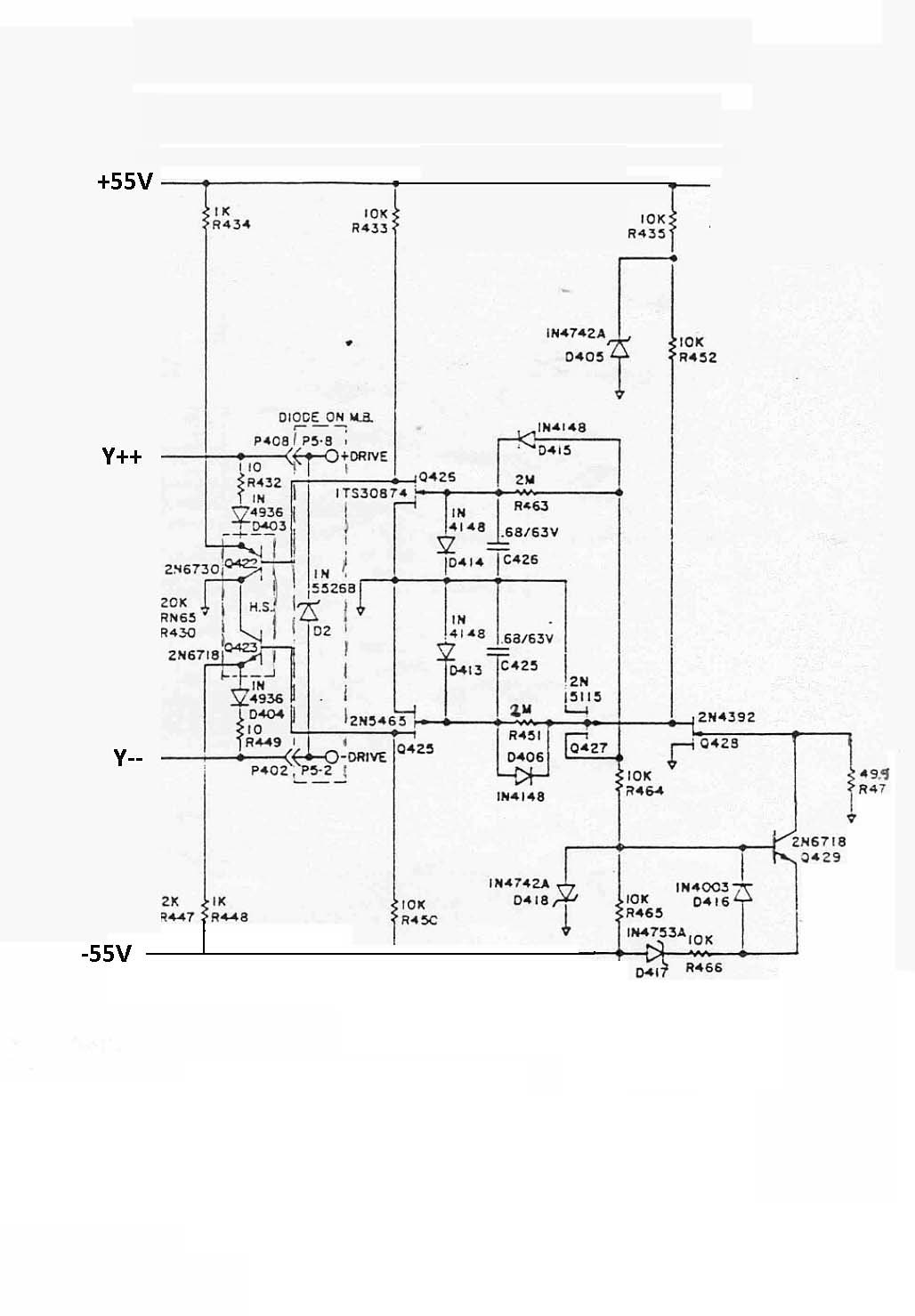

That protection circuit is on resp. the AP-3 and on the AP-5 board.Dear Hans,
Oh, I didn’t know there was a monitor on the regulated rails voltage differential.
I didn’t see that on the protection circuit. Maybe I didn’t look hard enough
Look at posting #106.
The two inputs at the left, here called resp. Y++ and Y--, are shortened by the soft start circuit preventing any current to flow in the end stage and thereby preventing a plop in the speaker at switch on and switch off.
But when broken, you have no bias either after start up.
Hans

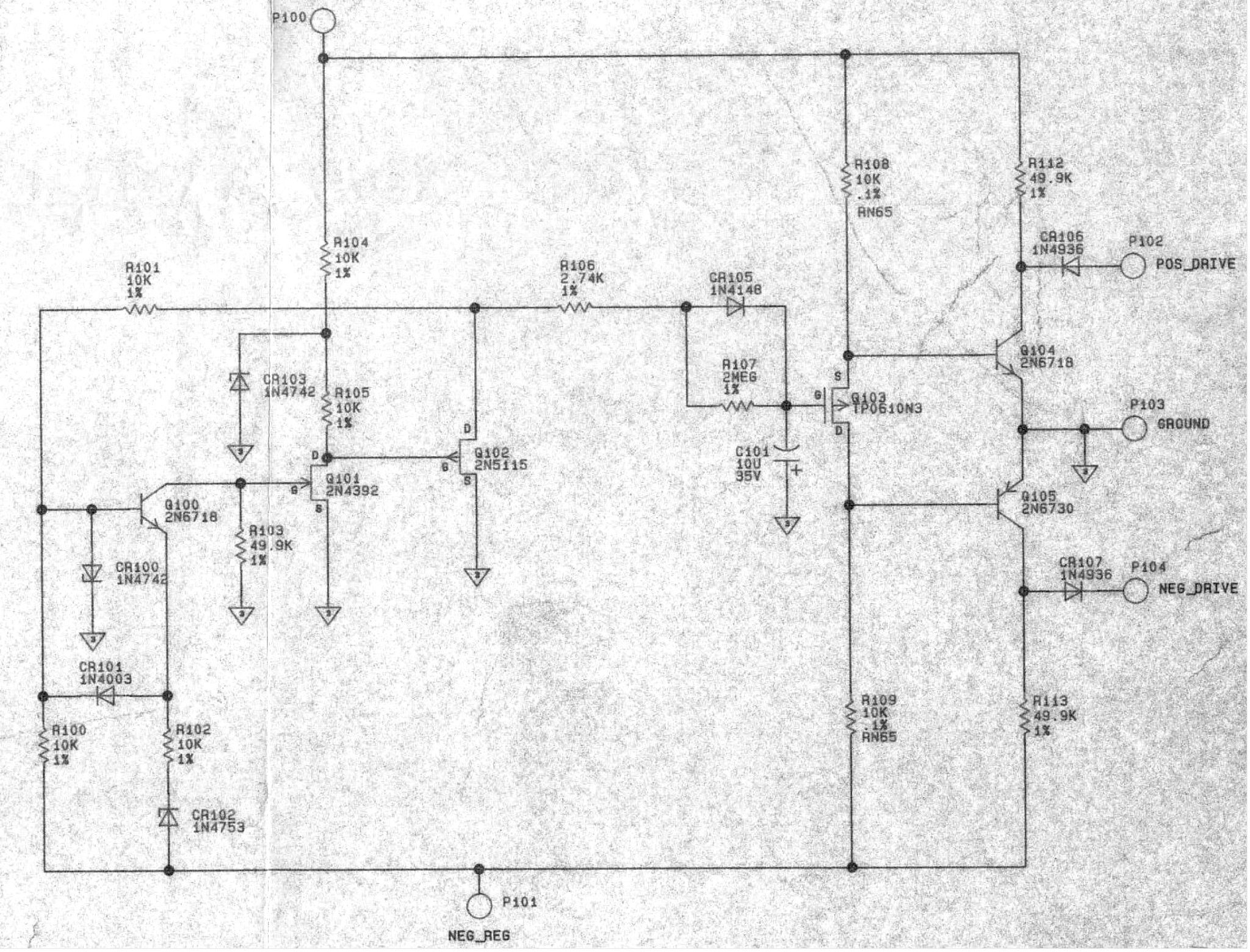

Here is the soft start circuit on the AP-5 board.Well if it did happen, I would have to study the AP5 board more in depth then and maybe found what you described or not. 😝

The next step is to disable the soft start by interupting the signal to the two diodes.So, after about 15x pot turns it got the DC offset down to 127mV. It won't go further than that, for both units is exactly the same. Wattage hasn't changed much, so I guess I have a broken soft start. 🤔 Any idea of what could cause this? What's the next step with the diodes on AP-3?
See in the image below the two diodes accentuated in red.
Take out the whole diodes or at least one leg.
Alternative you can cut one leg and replace the diodes at a later stage by a new one.
Hans
When taking out the diodes does not help to get the end stage biased, the next step will be to check a zener on the motherboard.
This zener is in parallel to the soft start circuit and serves to limit the maximum bias current.
But when short circuited it will also prevent the output stage to come into action.
Waiting for your feedback.
Hans

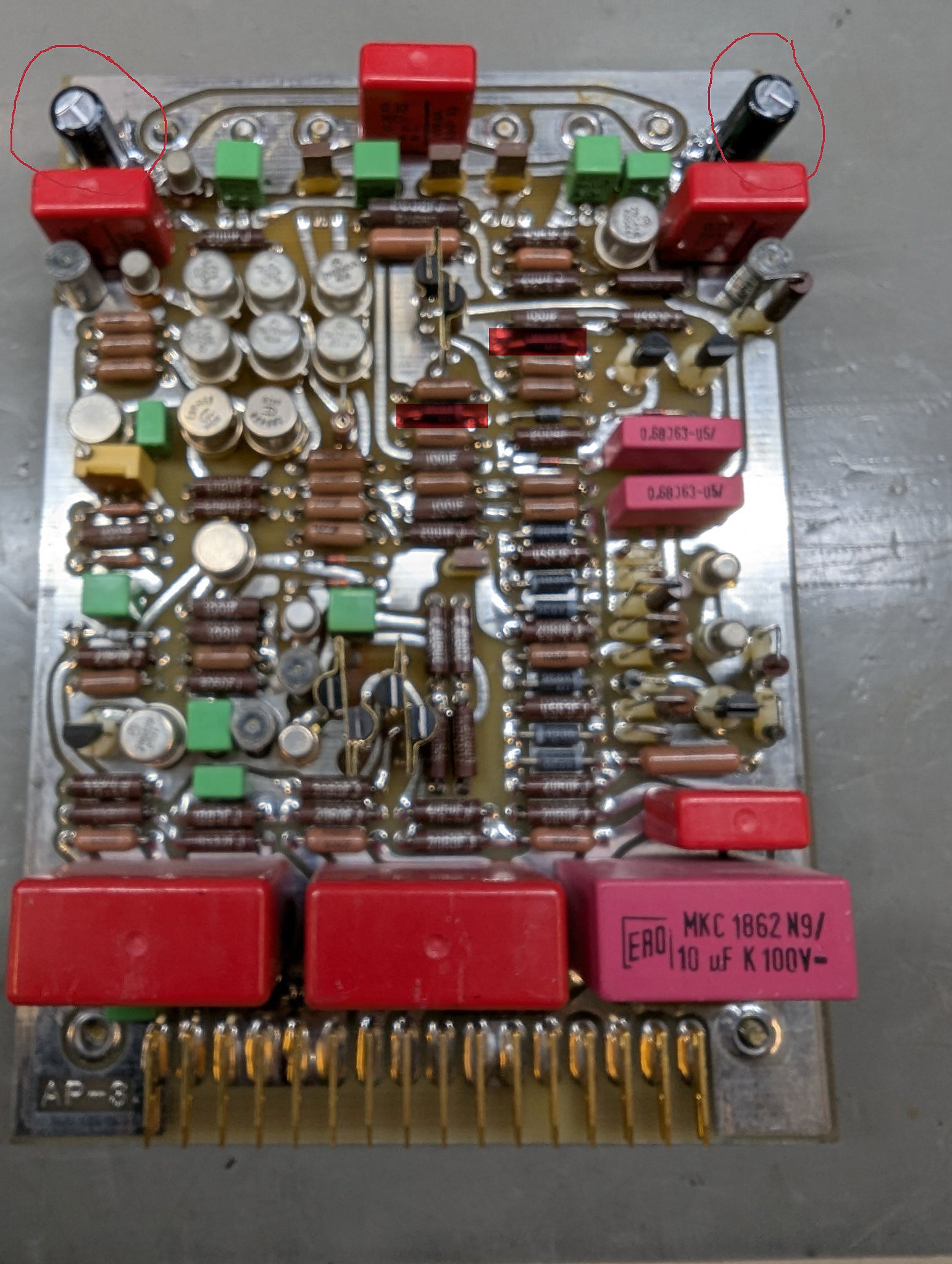

The soft start circuit on the AP-5 board in #125 is not the same as on the AP-3 board.
But in both cases, two diodes couple to the output stage as shown in #106, thereby making a short between the two points that I called Y++ and Y-- during start up and at shut down.
Mark Levinson calls these points Pos_Drive and Neg_Drive as I found out later, but at the time I did my reverse engineering I had no documentation at all and had to select my own names.
By shorting those two point to ground, the output stage is no longer biased and current through all transistors in the output stage (fitted to the 4 big heatsinks) is zero.
The two diodes on the AP-5 are called CR106 and CR107 and on the AP-3 board D403 and D404.
See first Image below.
So when lifting these diodes, the soft start function is completely disabled.

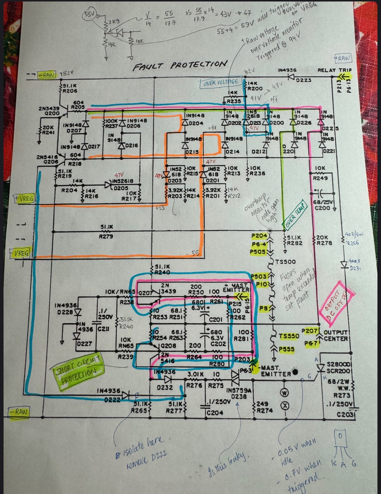

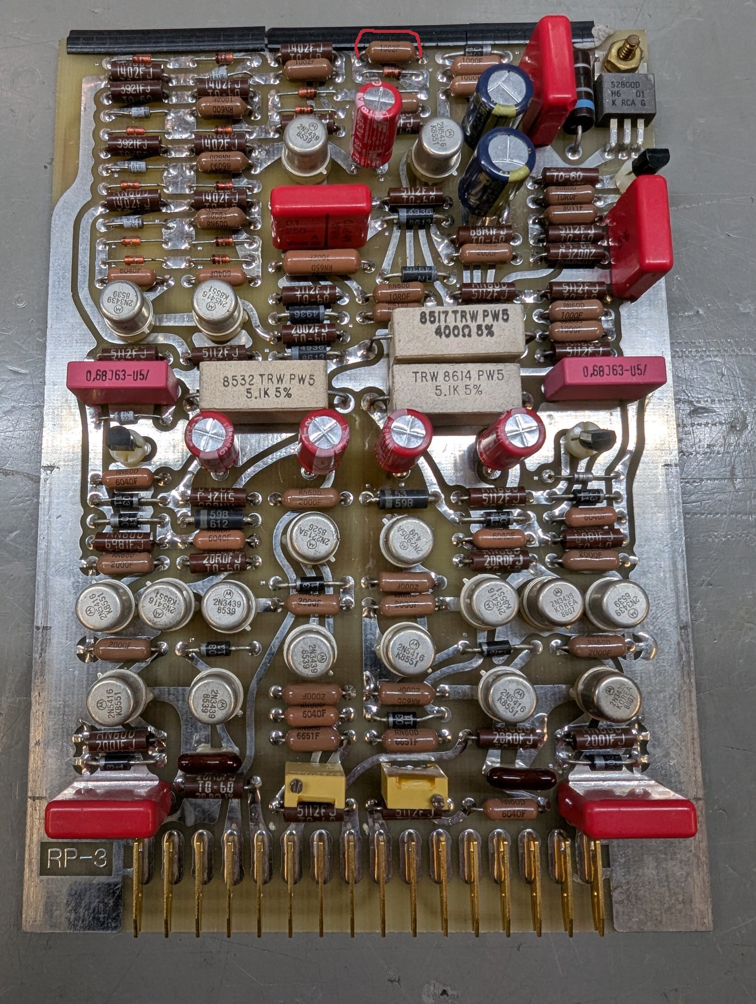

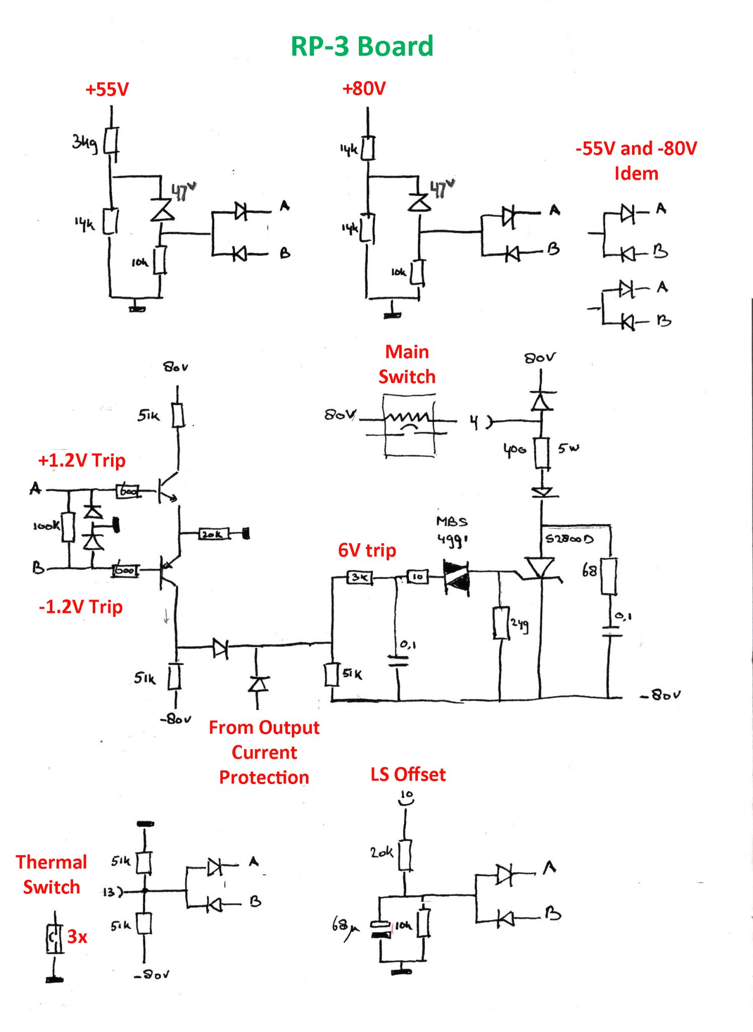

Now the RP-3 comes into action, where several voltages are monitored, the +/-80V, the +/-55V and also the offset voltage at the LS output.
And finally three thermal switches have to be closed and no overload at the LS output has to be the case.
In all those cases when something is not correct, a Thyristor will be triggered that will cause the Main switch on the Amp's front side to trip.
See the second and the third attachment for these protection circuits.
So in case of @kinesphere, the fact that after having disabled the soft start circuit the Amp trips, most likely means that the LS output exceeds it's allowed DC offset.
But to get the Offset pot in the right position, the DC offset sense function has to be temporarily disabled.
That can easily be done by shorting the 10K resistor on the right corner of the second attachment, see #133 for it's position on the RP-3 board.
After having adjusted the output offset voltage, the short on the 10K resistor has to be removed and hopefully the Amp is working now.
What still has to be done is adjust the Bias current to 2.5Amp which will give a 500watt load on the mains supply.
Last but nut least is finding out what's broken on the soft start circuit, but that's yet to come.

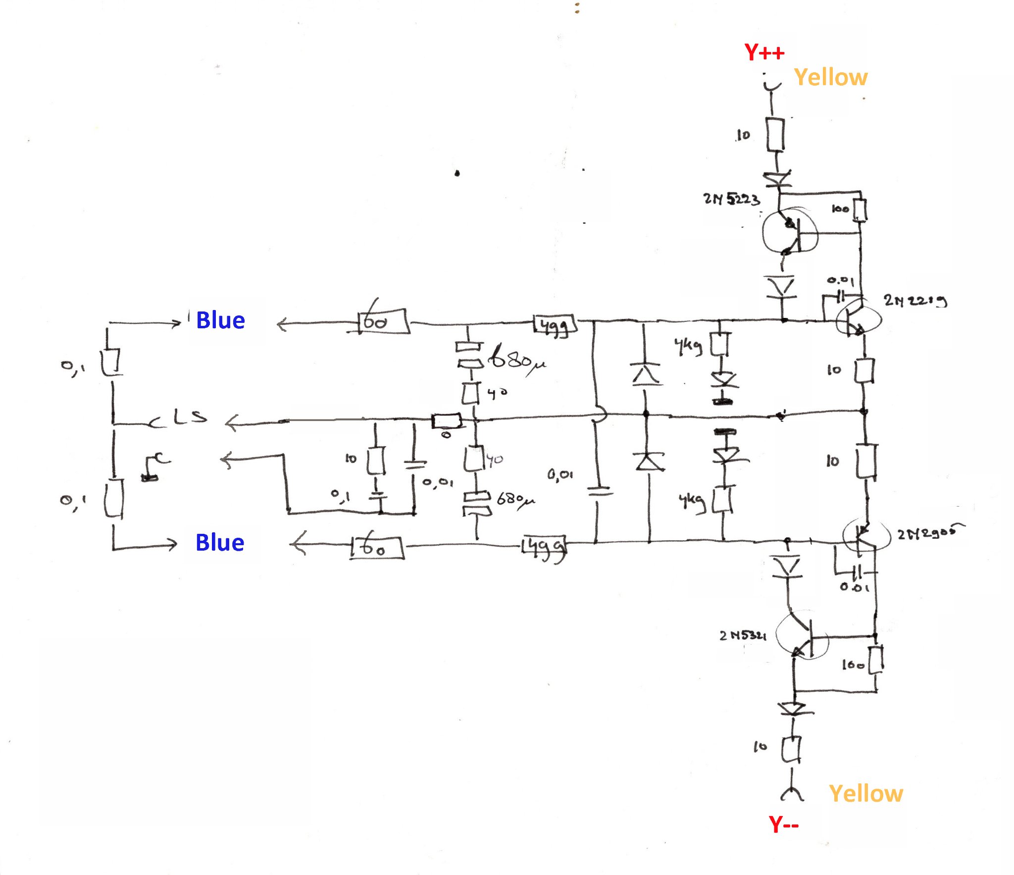

When you look at the first image below that was also in #136, you will notice that the upper part will just like the lower part force the transistor into conduction when overload is occurring, but this won’t lead in any way to tripping the amp.
Configured like this, the upper part could just as well have been discarded, a design flaw ?
That’s why I changed this circuit to let the amp trip not only on negative but also on positive overload.

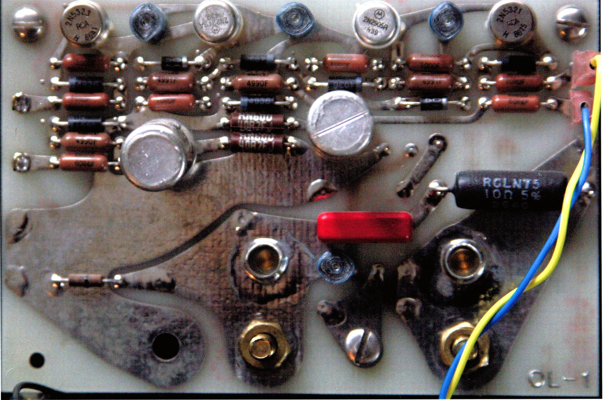

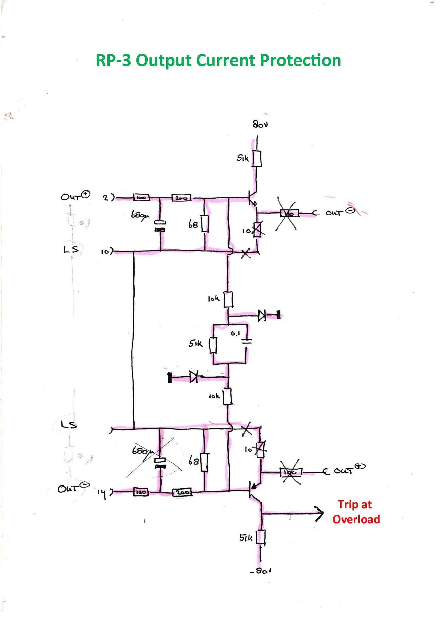

But ML also added a second current limit circuit on a separate Output Board that’s attached to the LS output sockets, see second and third attachment.
This Output Board circuit doesn't let the amp trip but should just limit the output current.
There are however a few issues to be mentioned that I disliked:
1) It's connection through yellow and blue wires via the Motherboard to the amplifier, could be regarded as radiating antennas.
2) but a more serious problem is that the two transistors pairs at top and bottom, are forming resp. PNPN and NPNP thyristors.
Once triggered by overload, they can only be reset by switching the amp off and on, but in the meantime they form a permanent current path between LS out and the driving voltages Y++ and Y-- thereby permanently reducing the Bias current in the output stage.
Point is that there is nothing to tell you that the "Thyristors" were forced into conduction but performance will be degraded.
For that reason I have simply pulled the yellow and blue wires from this output board and have the (modified) RP-3 board to switch off the amp when overload happens.
So the amp is still completely short circuit and overload protected, but in all those years this never happened because the combined output transistors SOA are far beyond normal use.
IMO, less is more.
Hans
