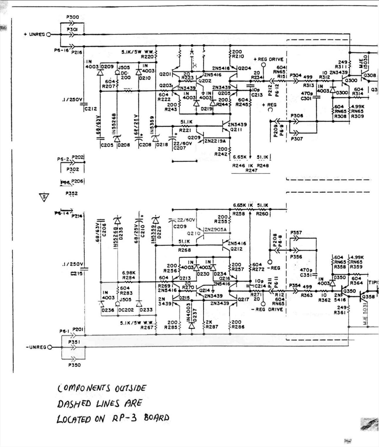

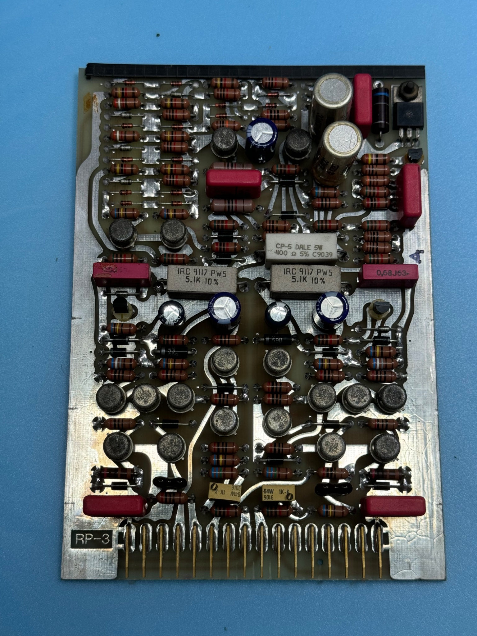

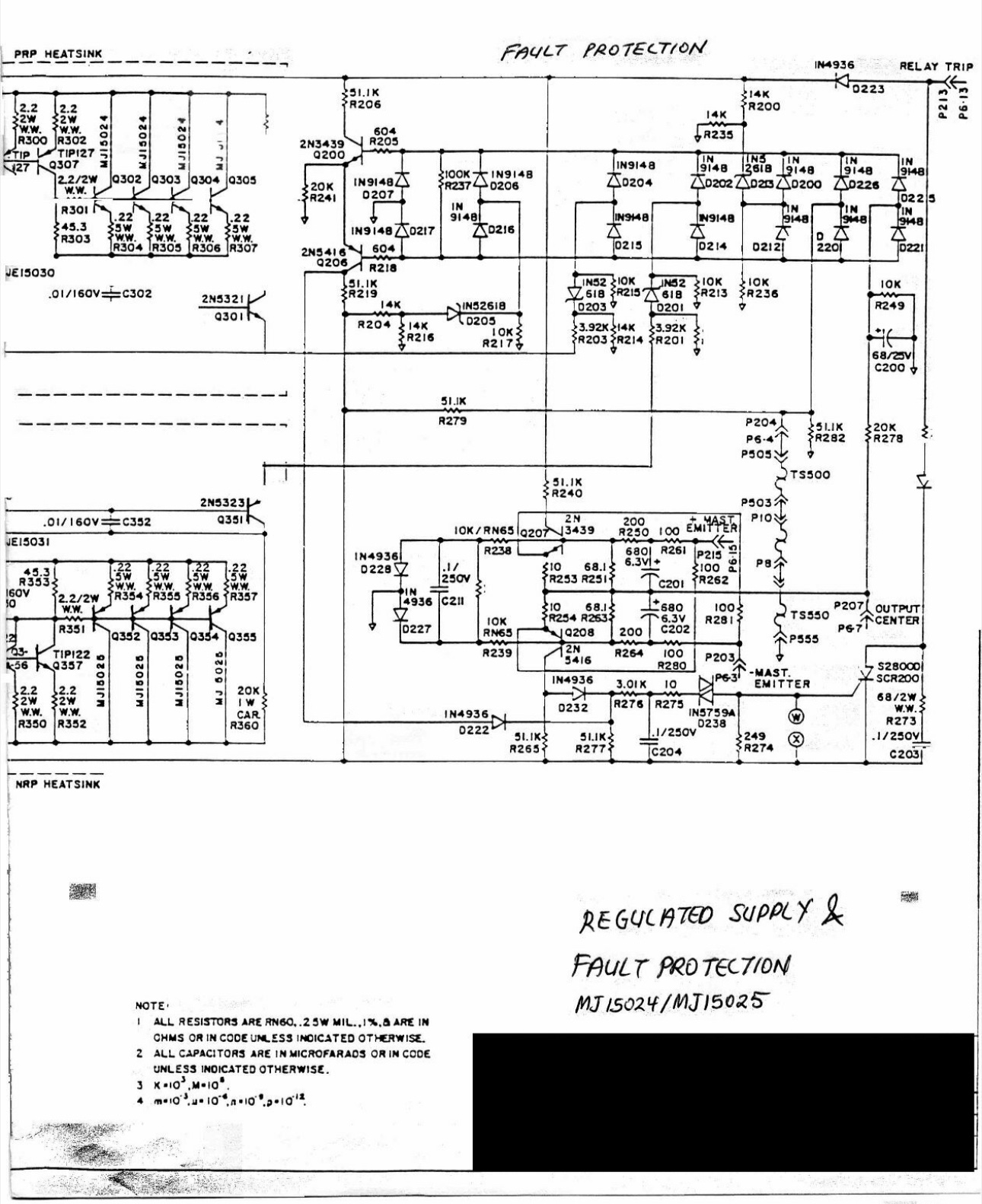

Proceeding now with the final details, I removed the RP-3 wire, and the unit powers up as it should. Next step is to put back the diodes and test I believe? How safe is to power up this amp without a load? After putting back the diodes, I should have a dummy load connected, right?
The amp is completely safe with load.
Just try to find out how disturbing the plop at switch on and switch off is.
When acceptable, then leave things as they are now, else we will have to repair the soft start circuit that is definitely broken.
Hans
Hans
Then leave things as they are now.
The soft start has no interaction at all when playing music.
Hans

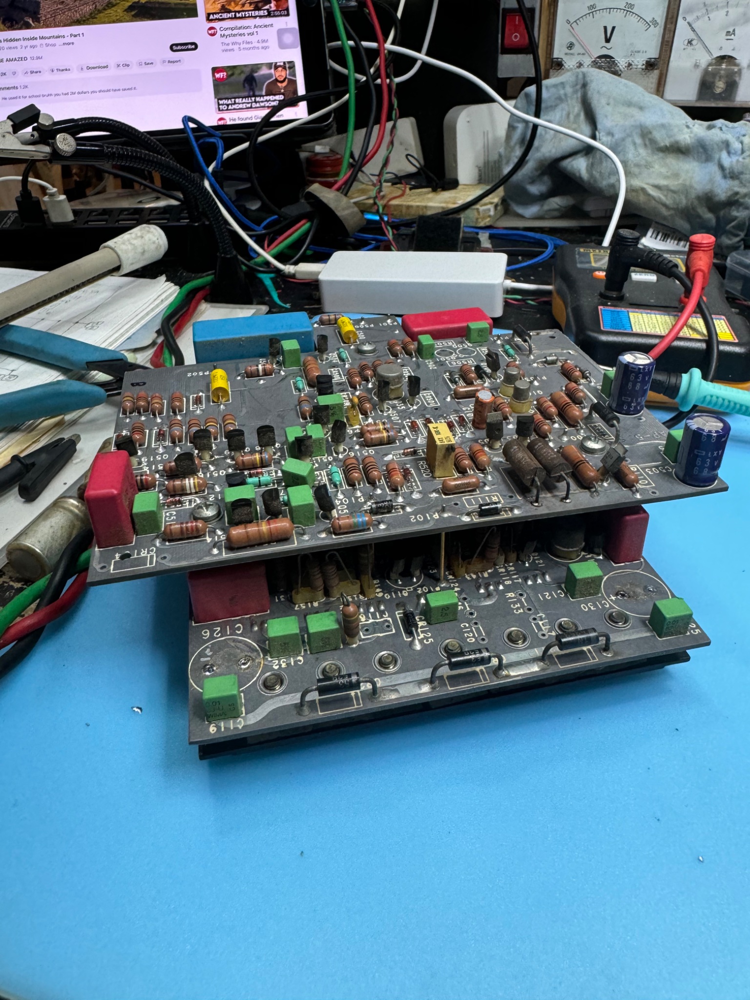

I could leave it like this I guess..but then the amps won't be fully repaired? You don't think it's worth trying to fix the soft start? And could by any chance the soft start work now the shorts have been removed and the DC offset has been adjusted?
Yes! All working well!!!! Thank you so much Hans and Song! Both amps are measuring similar levels:
At -6dBu input, output is 19.8dBu; THD+N is 0.030%; IMD: 0.007%
At 0dBu input, output is 25.8dBu; THD+N is 0.020%; IMD: 0.010%
Sounds beautiful. Only thing I noticed now is one amp's power red LED stopped working, and it was already intermittent as sometimes it would not work. I will investigate this further to see if I can fix it, it should be a simple thing I imagine. Apart from that, all good.
Lessons learned so far:

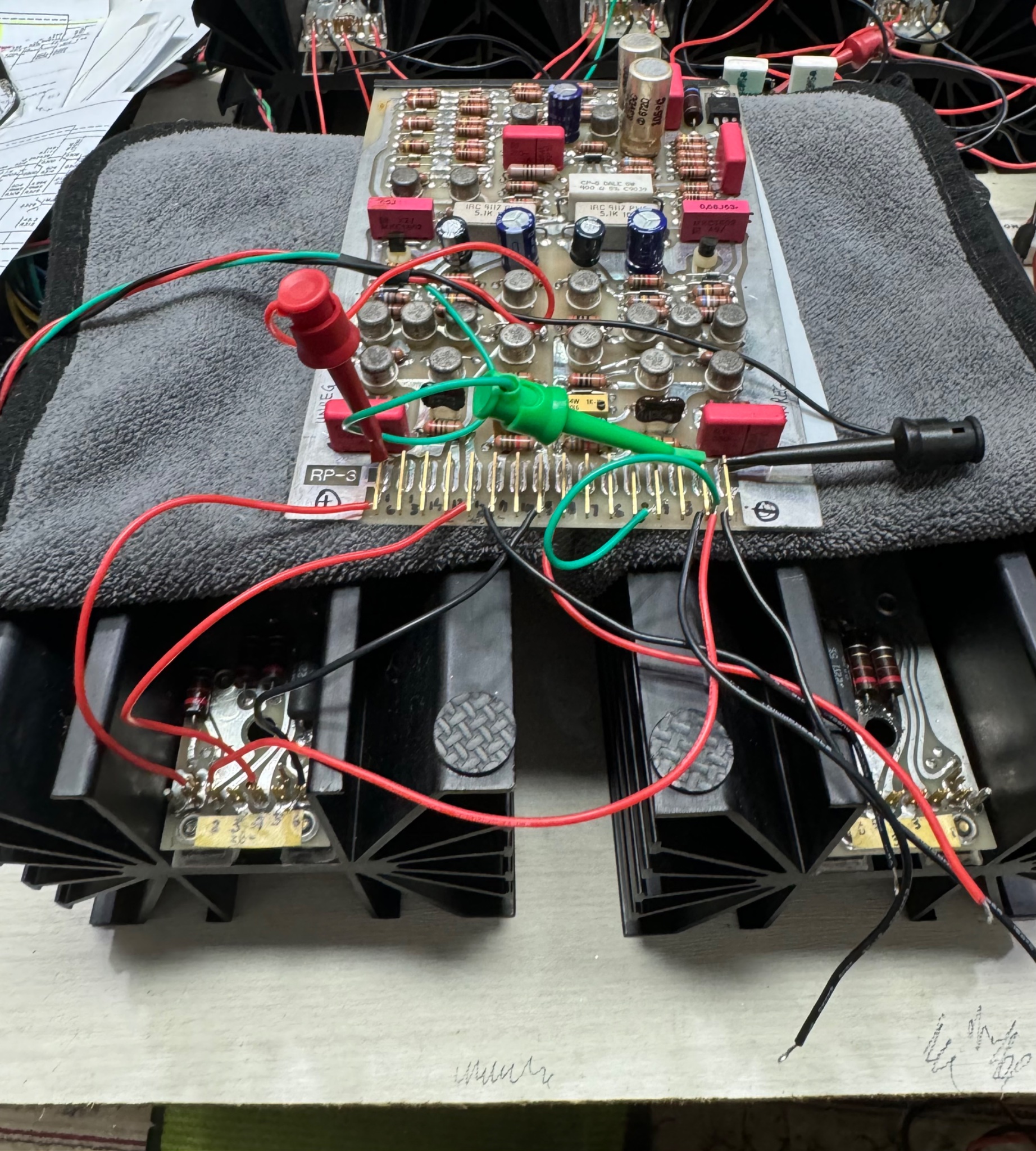

1) Soft start can be bypassed by cutting those diodes on AP-3.
2) DC-offset out-of-range/transistor safeguard, can be bypassed by shorting a resistor on RP-3.
3) Now we have voltage levels of multiple test points on AP-3 that can be useful for future reference.

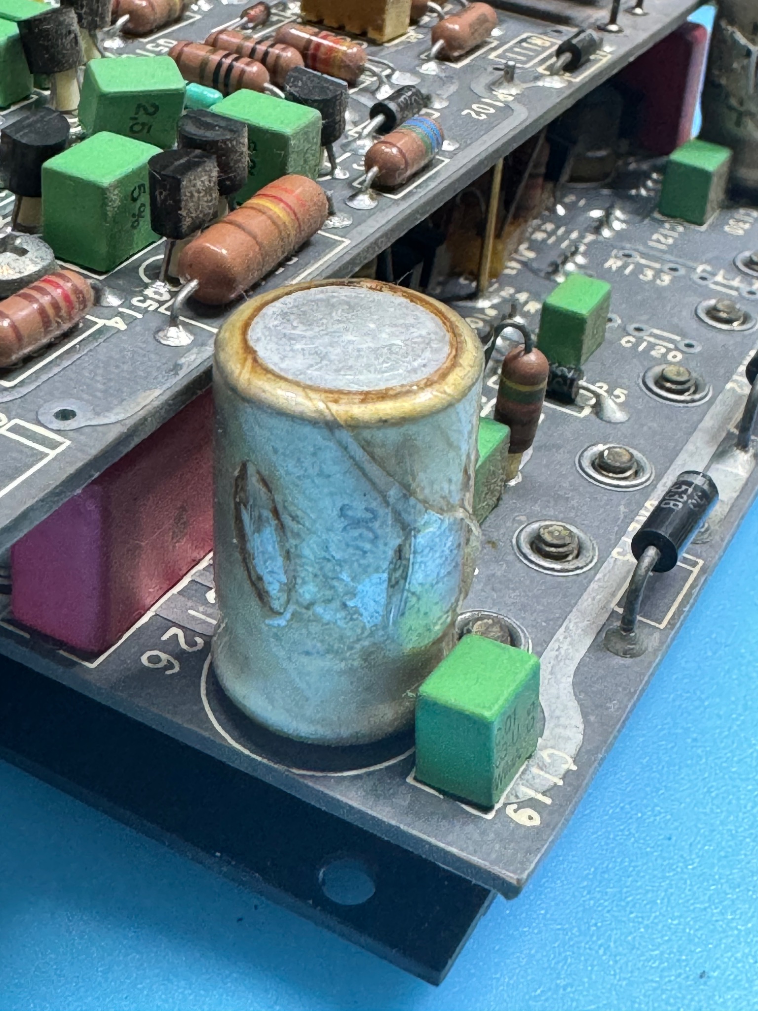

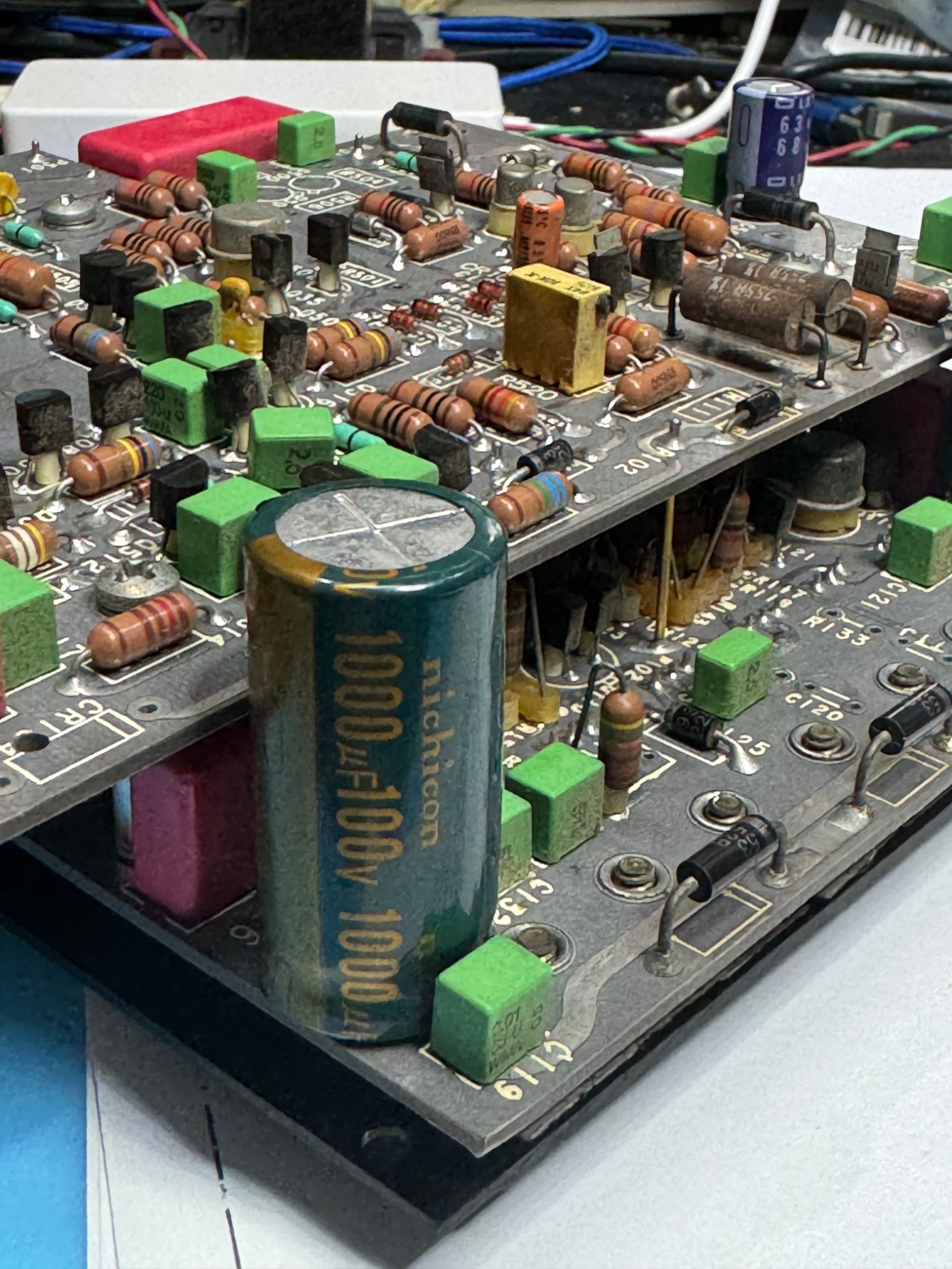

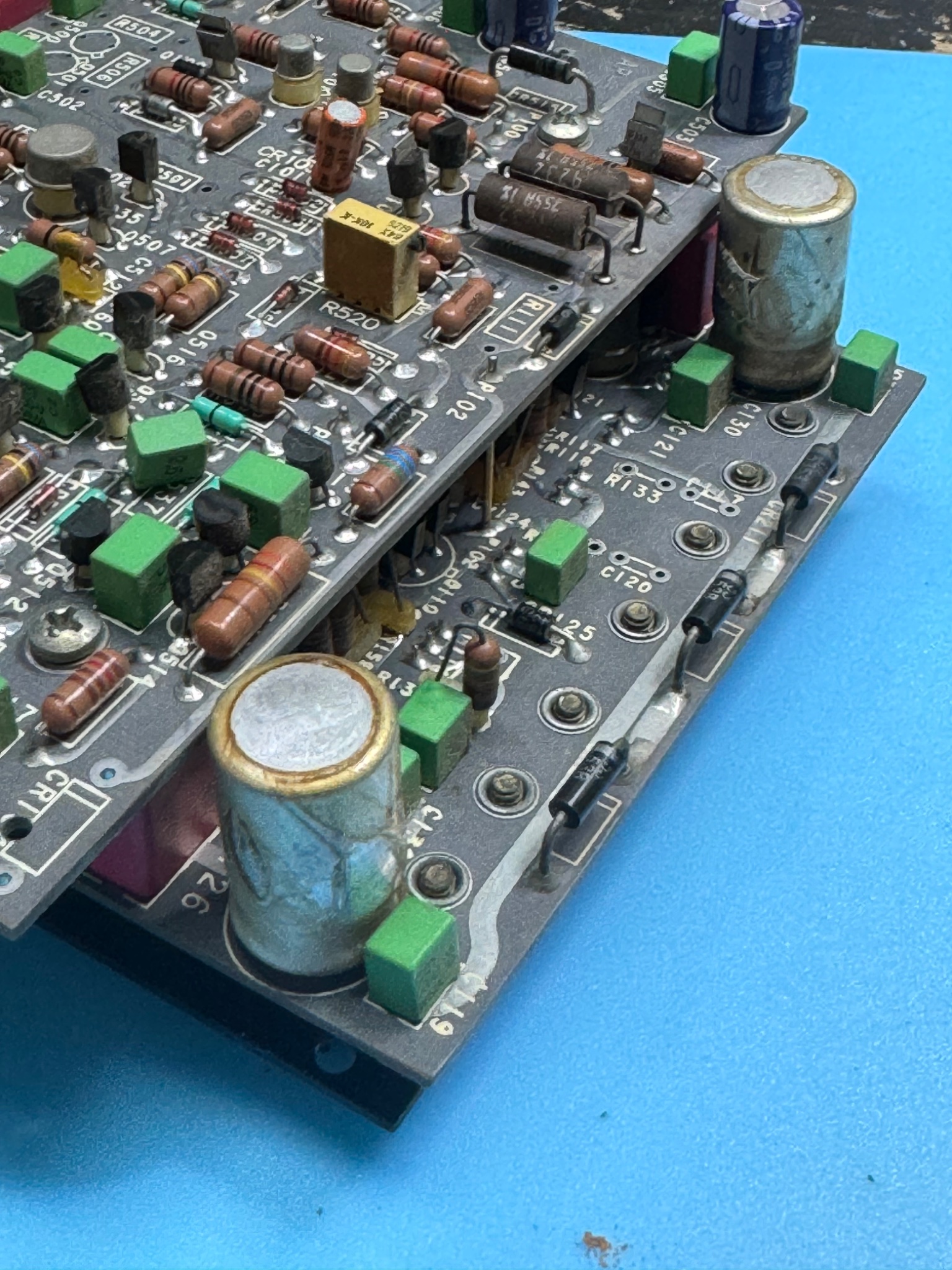

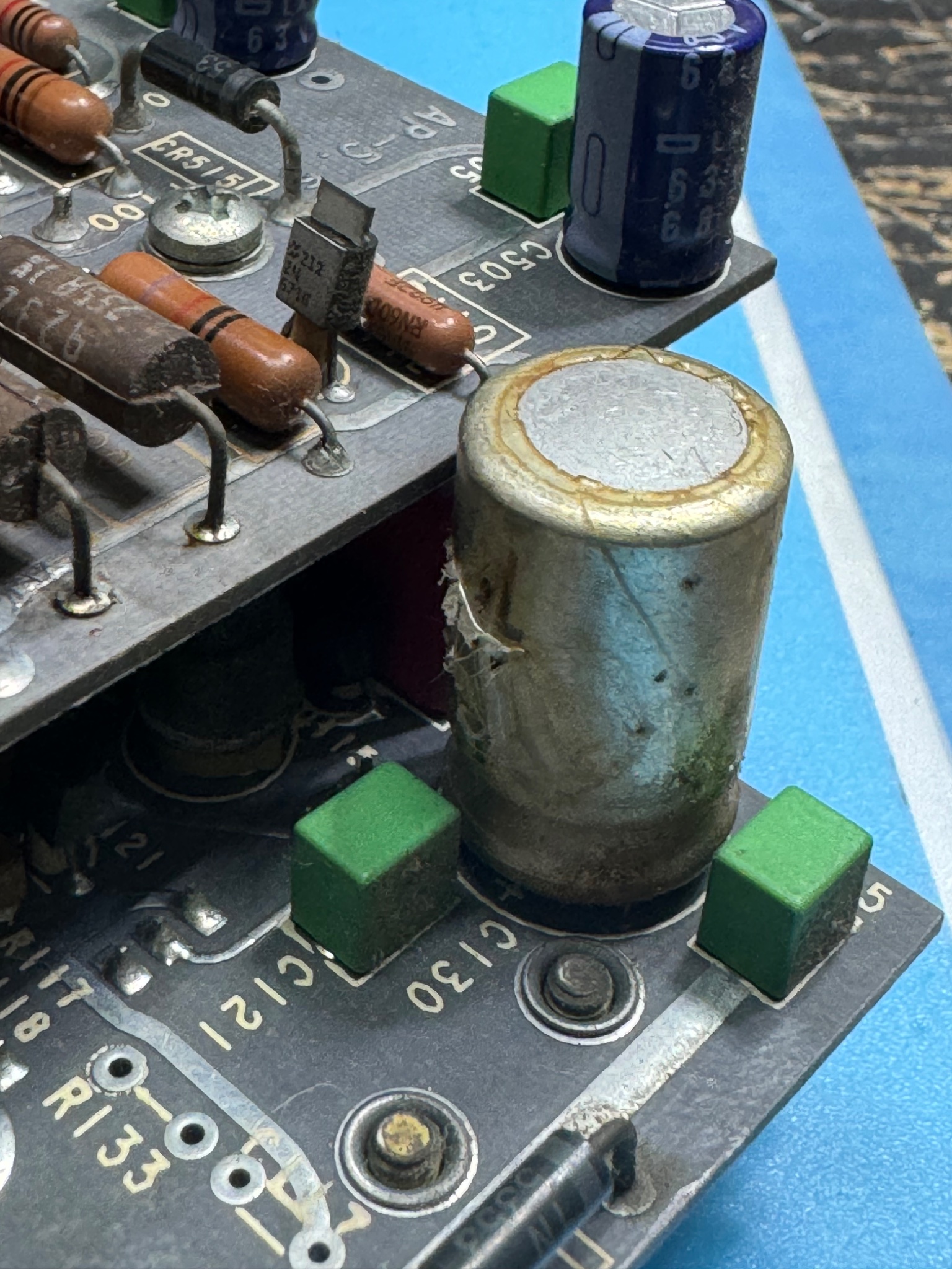

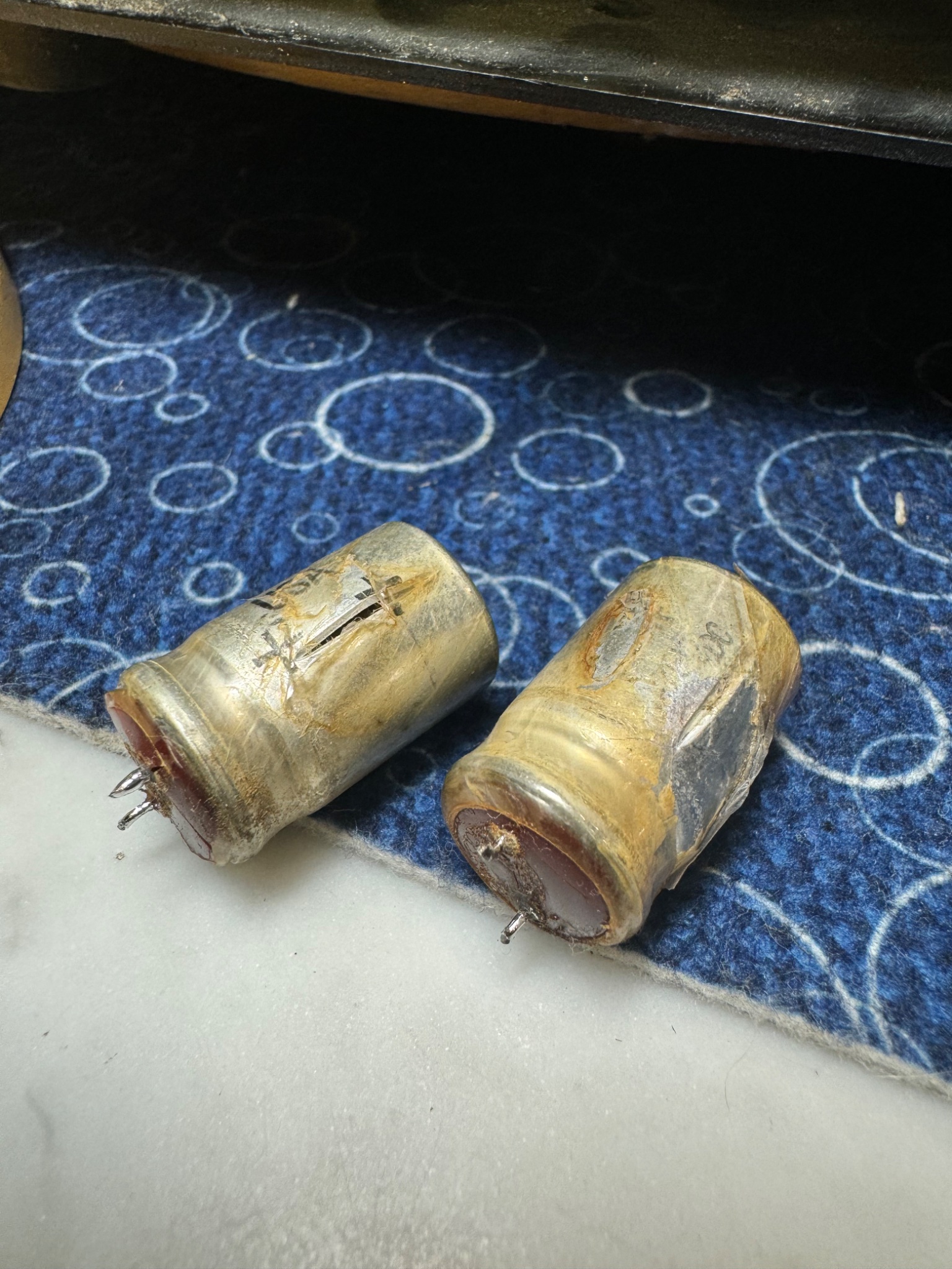

4) The 9000uF caps need replacing after a while (both I had were leaky).
5) Mr Lim's showed the impossible can be achieved with his custom jigs and impressive inspection skills, plus so many observations on the ML such as the protection circuit that monitors the following:
a. excessive DC offset at the amp output
b. Over temperature.
c. Over current / short circuit
d. Unregulated power rail over voltage
e. Regulated power rail over voltage
And we now also know the SCR can be the culprit if the amp is tripping. I'm trying to summarise this long thread but there are many more details.
Thank you all, all this is very much appreciated.

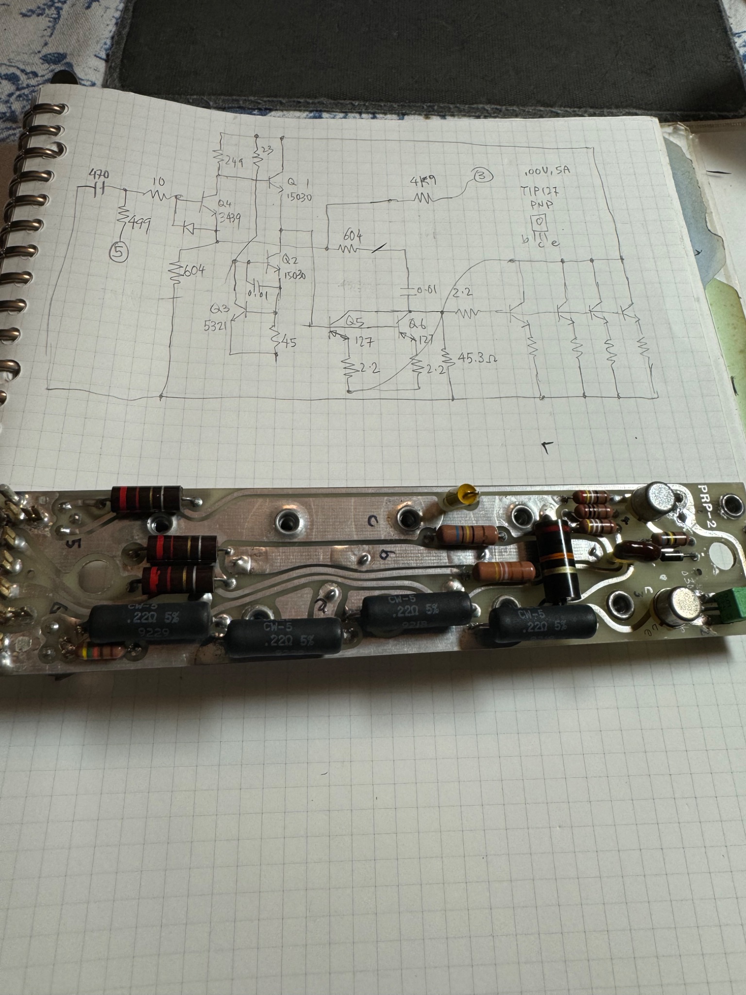

I have one practice I usually do as a first pass check after visual inspection of the board for any virtual evidence of burnt components or leaking or bulging capacitors. It is to do a multimeter check on all transistors and diodes. Setting multimeter to diode test mode and measure all PN or NP junctions of transistors and diodes. This gives a gross check if any PN,NP junctions are punctured short or open. Measure PN or NP junction for forward diode voltage of 0.5-0.6V.
In K case this will be helpful as we don’t have an extension board and probing is impossible and having to resort to soldering fly leads to measure nodes voltages.
Not sure if it would have caught the shorter collector pins for the two transistors. Haha.

Thanks to Hans and Mr. Lim!!Dear Hans,
Thank you for sharing and pointing out the circuit. Even if I had traced it out it would have stumped me. I probably clild understood the mosfet shunting out the base current to the output transistors but the function of The left side of the circuit would have puzzled me 🤔
Thanks again. 👍. Good job.
Good to know there is a guru out there I can rely on if I have to troubleshoot another ML amp in future.
Absolutely eye opening and lots to be learned!
