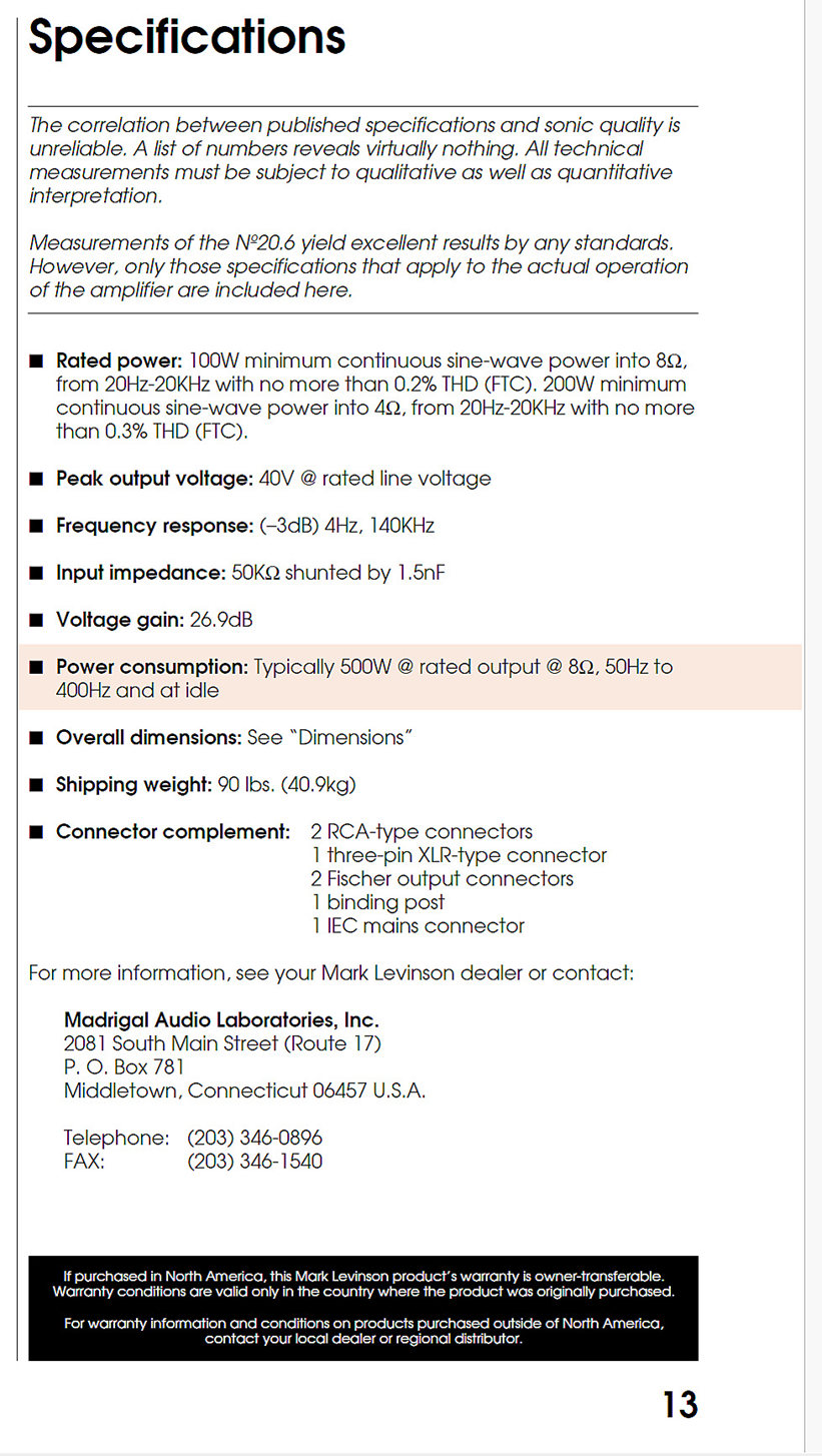

I was talking about 16Watt in a 8R speaker as maximum in Class A when bias is only 1A, above 16Watt it will be Class B.
This has nothing to do with the +/-55Volt supply voltage.
In fact a properly adjusted 20.6 consumes 500Watt and this power remains almost constant up to 100Watt in 8R.
Hans
Hans

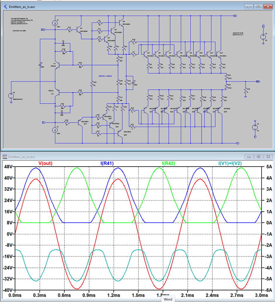

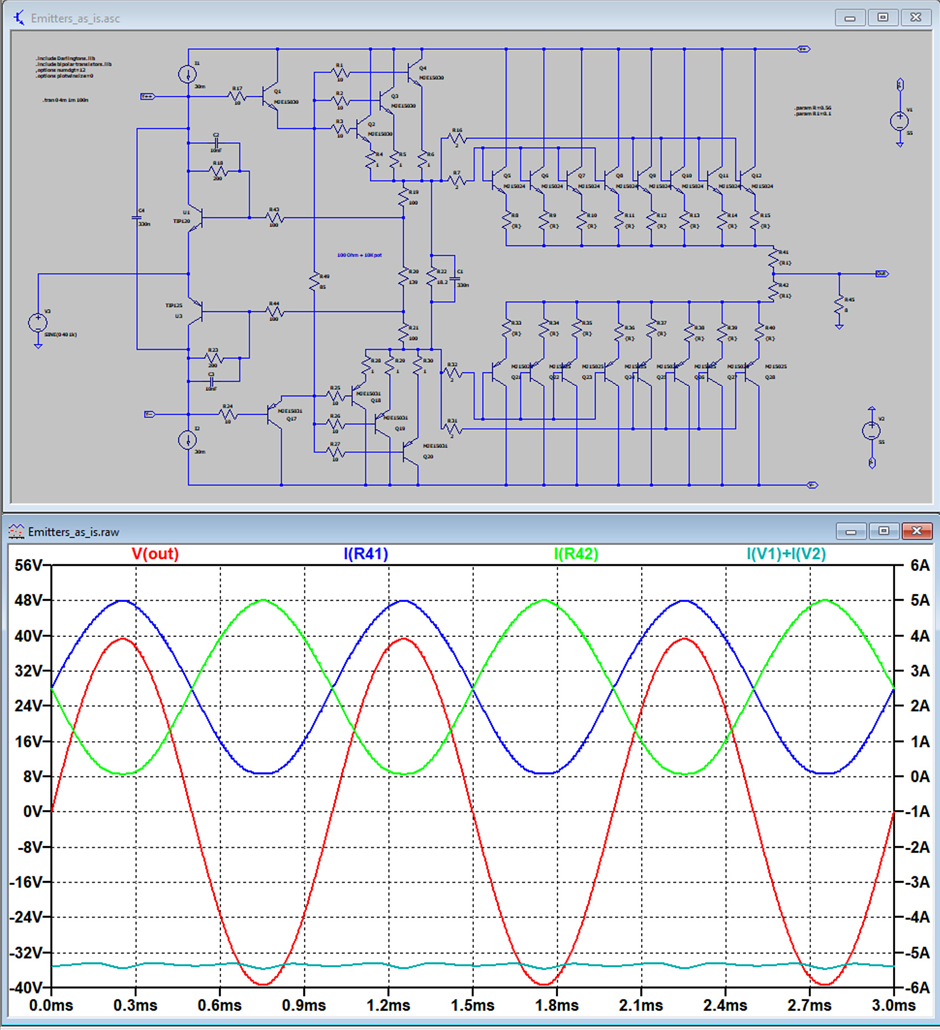

Here you see the difference between 1A Bias and 2.5A Bias.
In Red you see the 40Vpeak output voltage to 8R, needed to get 100Watt.
Blue and Red are the currents through the 0.1R resistors that accumulate all currents from the positive and the negative output transistors.
And in Teal you see the summed current from the positive and the negative supply.
In case of 2.5A bias, the current through the individual output transistors drops to a few mA, but they still remain conducting.
The summed supply currents remains almost constant.
When going to 1A bias, the output transistors are no longer conducting all time and are operating in Class AB, with up to 16Watt in class A.
Hans

Bias 2.5A
Bias 1A

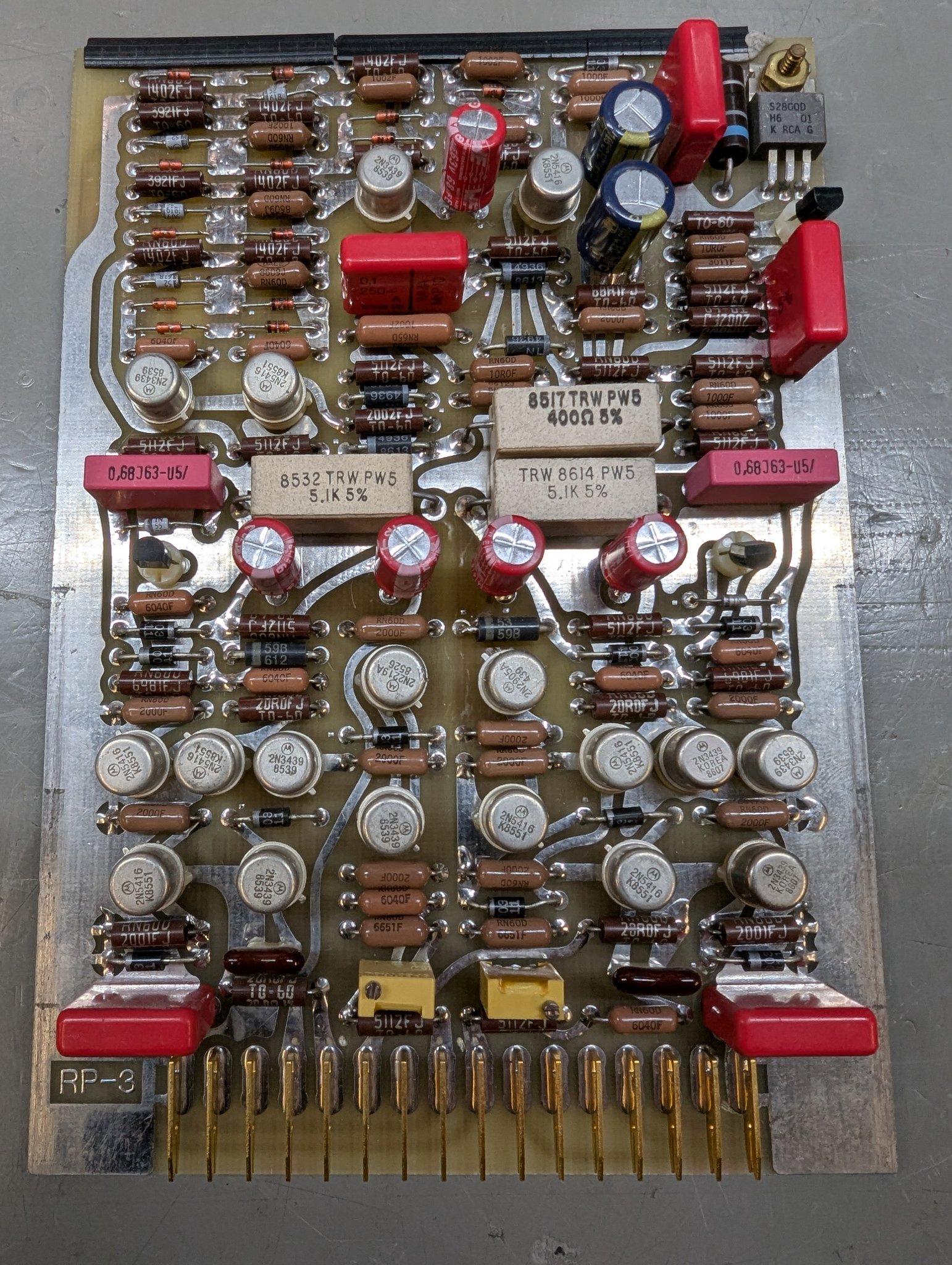

Hans mentioned where the pots are earlier, but this looks different in the RP-3 and AP-3 and I'm not sure where to start and what order to follow. In my units I have 1 pot in the motherboard, 1 pot in the AP-3 and 2 pots in the RP-3. See images attached.
I tested the pot on AP-3, and it seems that it needs a few turns counter-clock-wise to reduce the DC offset, and from 1.4V it went to 1.25V, but I'm unsure if this is the right procedure. Some guidance here would be very much appreciated! Thanks!

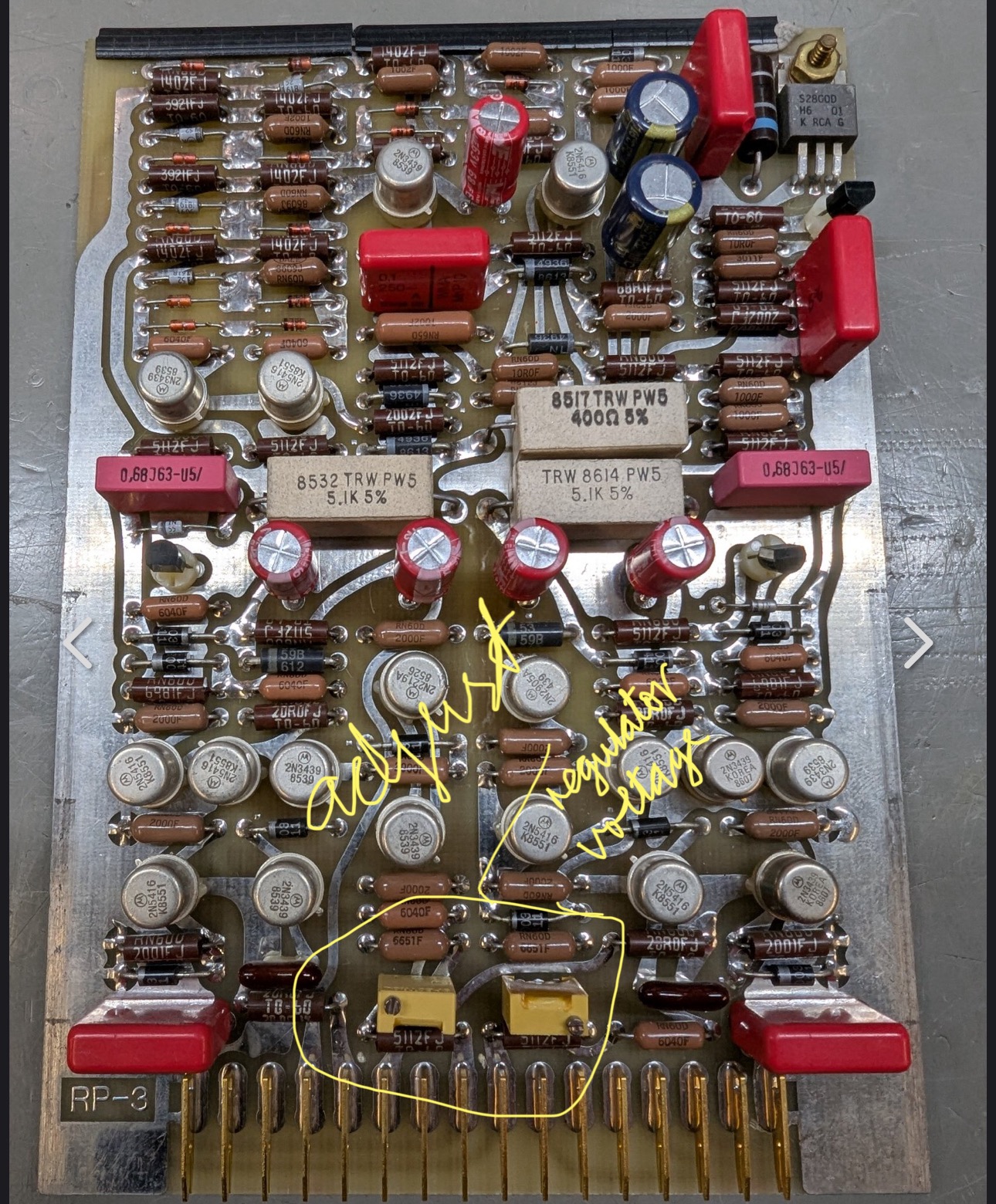

These two pots adjust the voltage regulator voltages.

All versions of the ML20.X should draw 500Watt at idle.The power drawn at idle is 46W (240V/0.3A)

The most likely cause is that the +/- supply voltages are not within 100mV, causing a soft start circuit to disable the output stage.
And yes, these two voltages are set with the two pots on the RP-3 board.

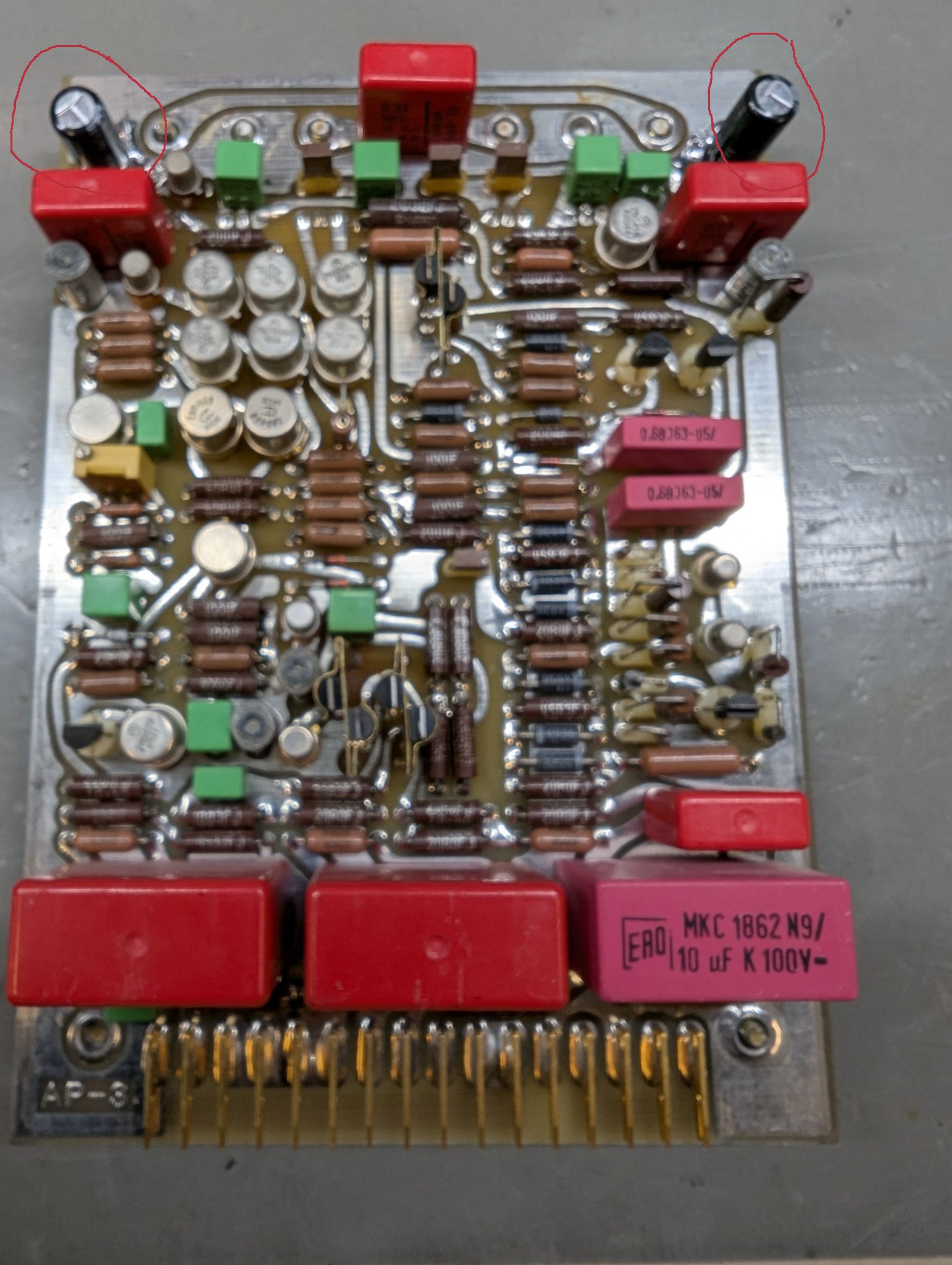

On the two corners at the top of your AP-3 board you have two large black electrolytics, encircled in the attachment.
Tell me what voltages you can measure here.
Hans
Yes, as mentioned they should be within 100mV.The rail voltages are 54.8V and -55.3V. Is this too far off?
So you you have to adjust by trial and error by taking out the RP-3 board and turn one if the two pots, say the left one, by half a turn.
Put the board back in and measure again.
Continue doing this until the two supplies are within 100mV.

P.s. are you measuring on the two black caps ?
Hi Hans, thanks for your help! Before I had measured from the bottom (motherboard), now I checked again from the black caps and similarly I have 54.4V and -55.2. I will keep going down with the pot then to see if I can reach 100mV on the DC offset, currently at 1.25V.
