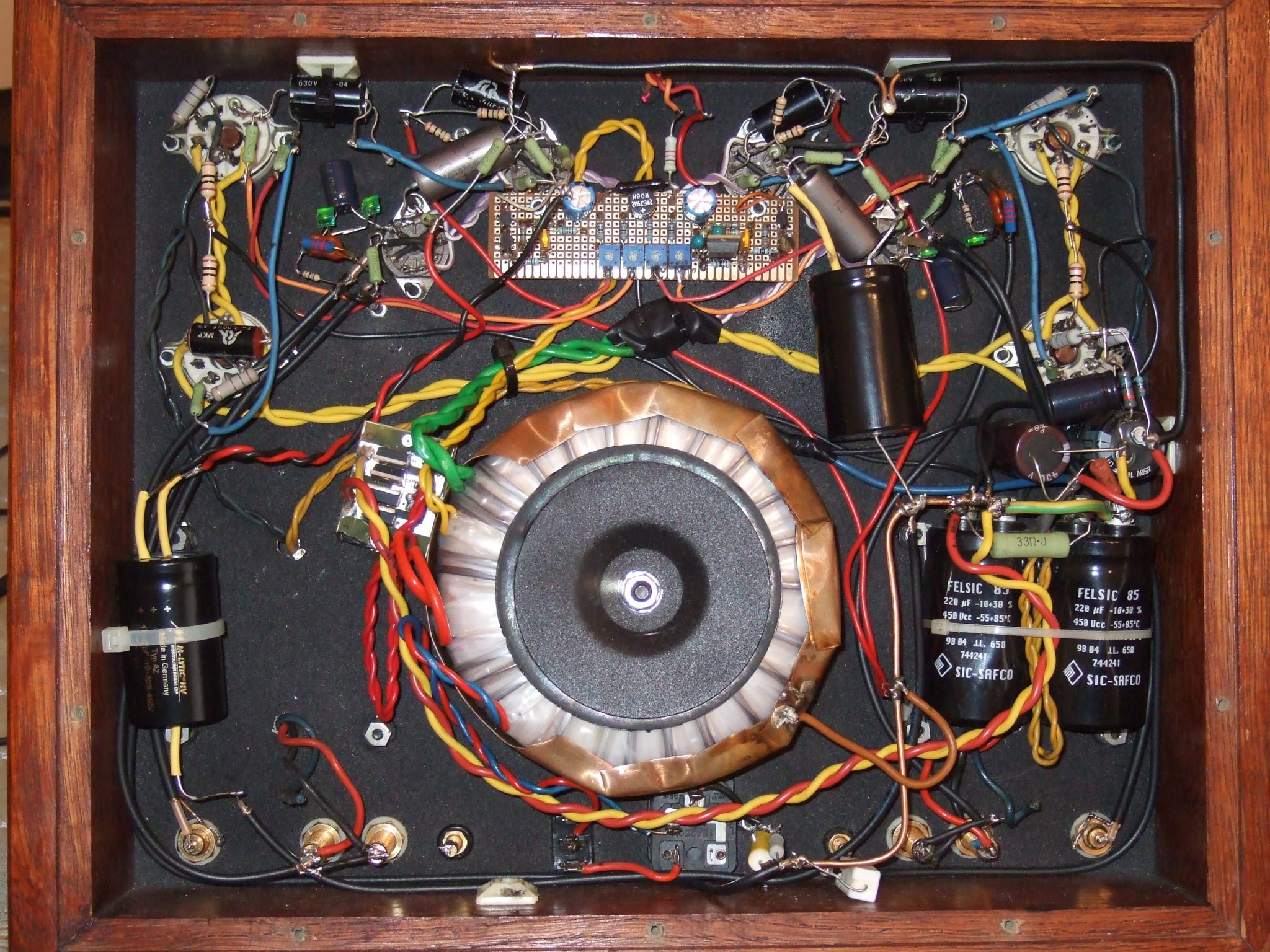

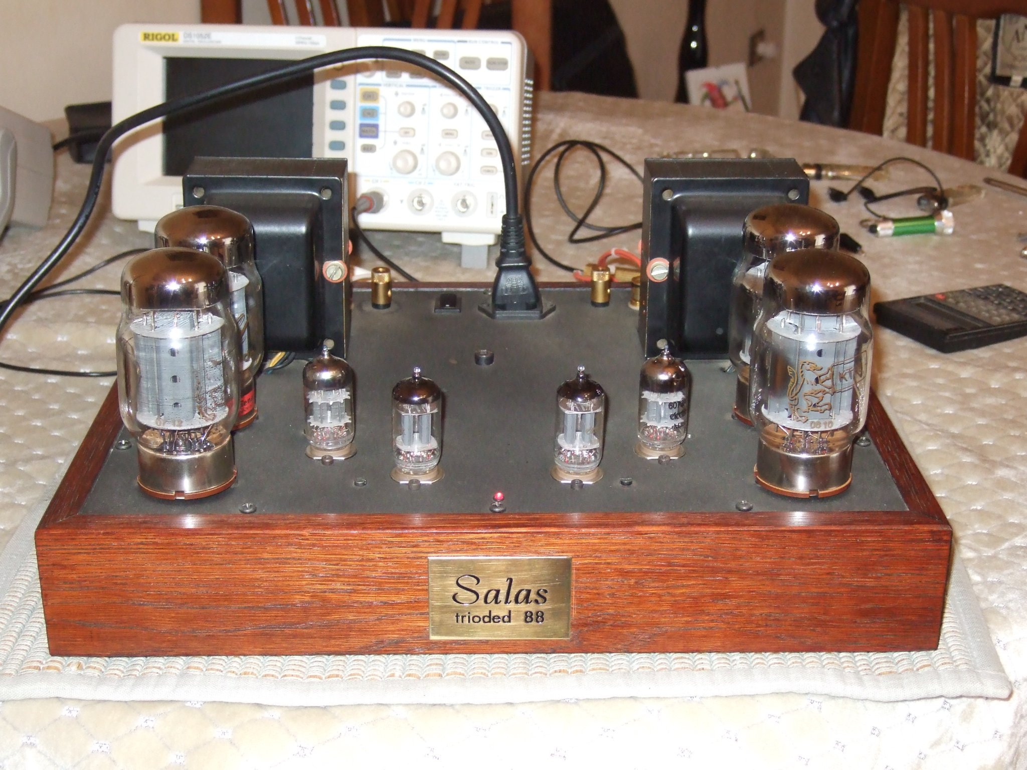

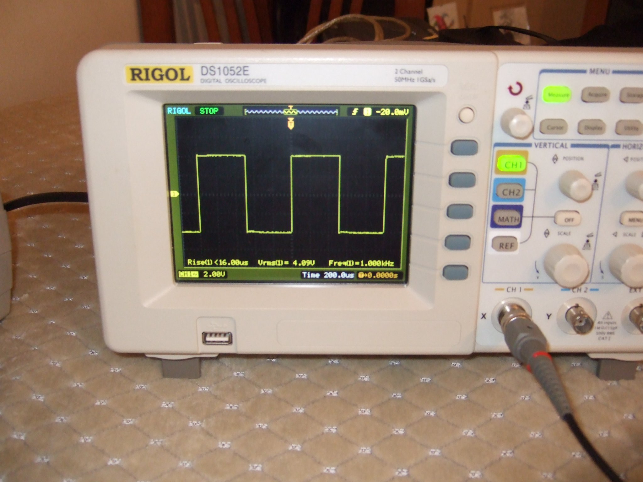

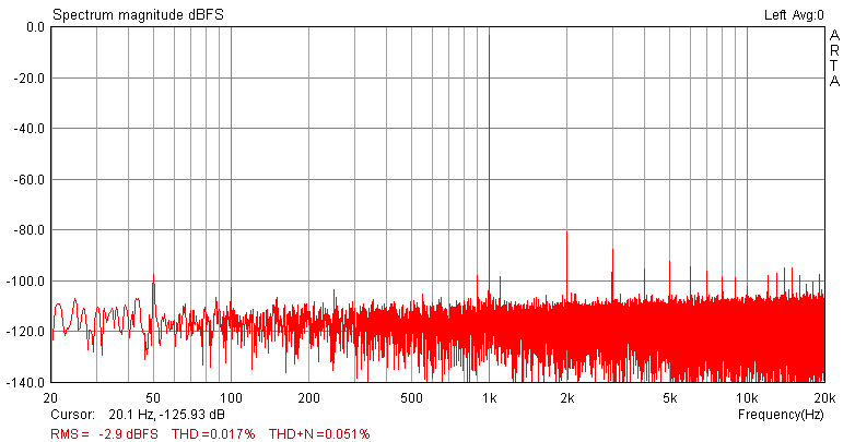

Yet another example... Once I put together this tube amp of my own design. A push pull KT-88 in triode mode it was. Free flow wired in spaghetti style. The chassis and Audio Note output transformers were provided from a Korato KVA-20 amp I gutted. The chassis was small. The 250VA mains toroid smack in the middle induced audible hum to it of course. After a circumferential copper wrap it did not have easily audible hum. For those ground return lines I couldn't avoid to come almost in touch with it I used one way grounded shielded coax. That brought the last touch on silence. I was chuffed to see its FFT so nice for harmonic noise. Tube amps generally suffer there. I listened to it for years. Very nice musicality. It ended up with a guy eventually using it on sensitive Altec A5 Voice Of The Theater horn speakers. Cause it was the most silent tube amp he ever tried on them he said.

Think I suggested the basic idea of a shorting turn interacting with leakage flux back in #43, #47, and #68. Maybe you'll have more luck than me convincing folks.
The thin copper band vs thicker band main difference is its more warming up due to Eddy me thinks. They both caught the hum field radiation sufficiently.
Looks like there are two radiating sources to consider in a toroid
1. Leakage flux. Very low in a toroid, but still a factor. Looks like this flux is trapped by the copper electrostatic shield, but I haven't worked out the exact mechanism.
2. 'circumferential' fields arising on the outside of the windings. This happens because the mag field around each wire on the outer side of the transformer has a small amount of the field that does not return couple through the core, but instead links up with the windings next to it so you have a circular field that kind of 'floats' around the outside windings. This is the main radiating mechanism in a toroid. When you wrap a GOSS band around it, it causes a current to flow in the GOSS band that generates a field that is opposite to the circumferential field and the two cancel quite effectively.
I see Salas used thick copper sheet, and given (2) above, that would account for the noise reduction. GOSS is used more regularly because it is cheaper I image.

That is an impressive FFT Salas. 👍

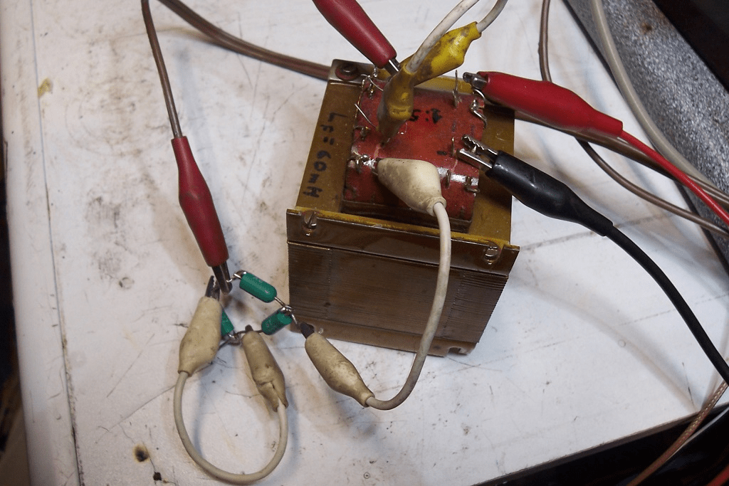

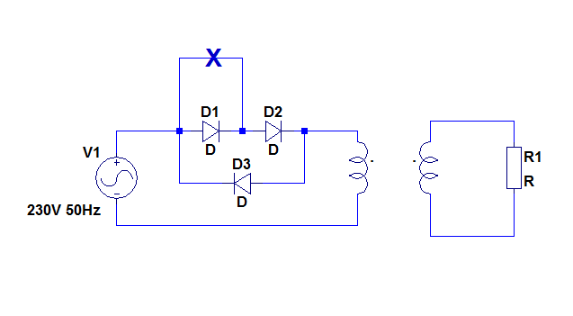

I have tested the DC hypothesis.
This is the test setup:
The transformer is a 40V/80VA, with a suitable dummy load.
The input is connected to the mains via back-to-back diodes, with the option of adding one more in series for one polarity:
In the vicinity, I placed the inductive probe of the humboy with its line out connected to an oscilloscope.
I used the FFT function of the scope to visualize the harmonics. The function is relatively crude, but perfectly sufficient.

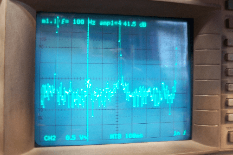

This is the spectrum when the extra diode is shorted:
The 100Hz amplitude is negligible, practically at the noise floor.

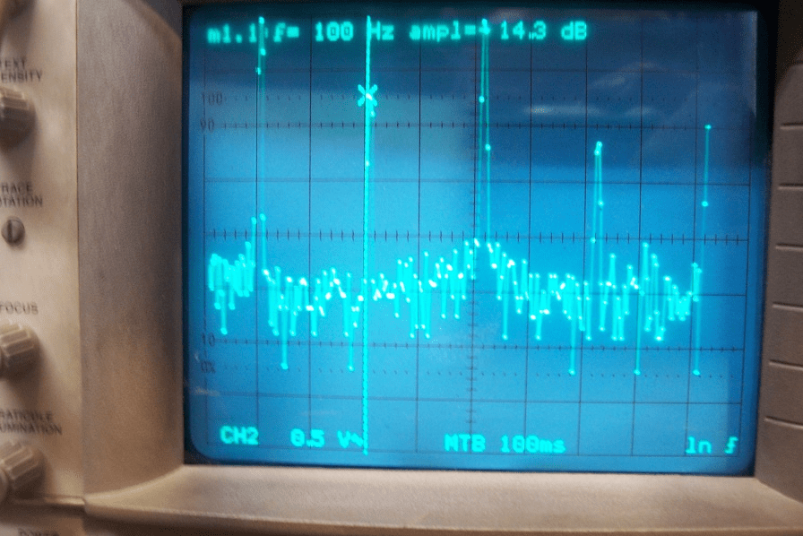

Now, here is the situation with the shorting link removed:
The amplitude jumps to -14.3dB: QED, DC bias affects the generation of even harmonics.
Interestingly, a magnet placed against the magnetic circuit has a similar effect, just much less pronounced
There is, because the bridge rectifier of the ubiquitous SMPS is not balanced to the mV.
Similarly, the rectifier behind a mains transformer isn't perfectly balanced either; of course, DC is blocked and cannot flow back into the mains, but the harmonics can
