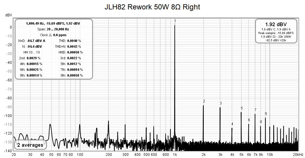

I have only ever used a GOSS band on power transformer. I guess the copper Gauss shield, or ‘enclosure’ would really be something that operates at HF?

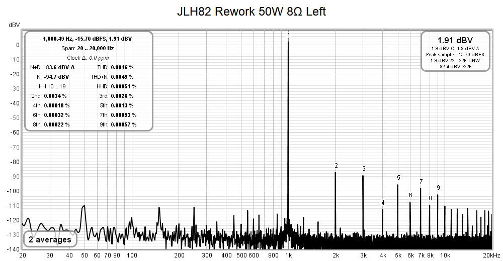

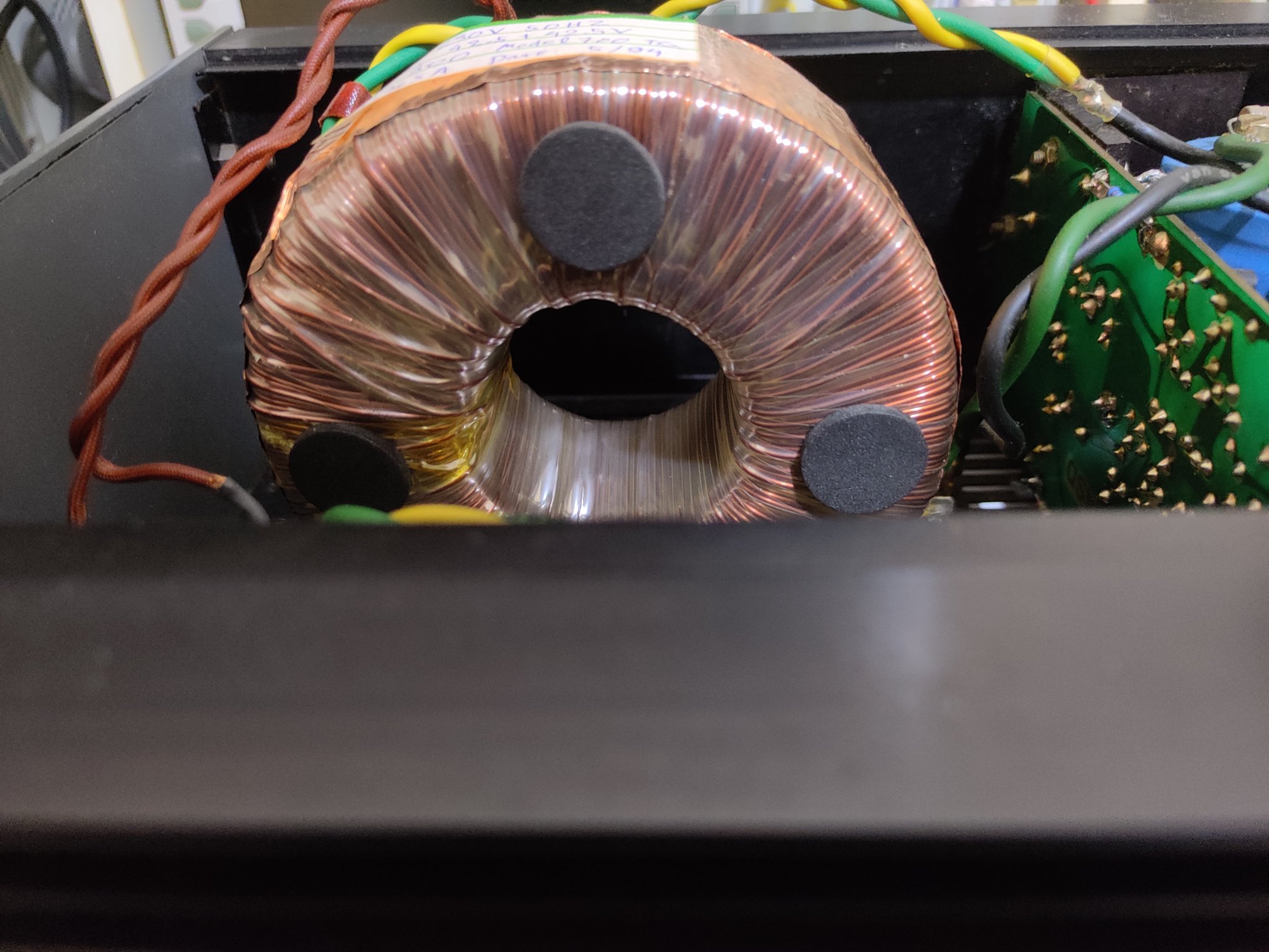

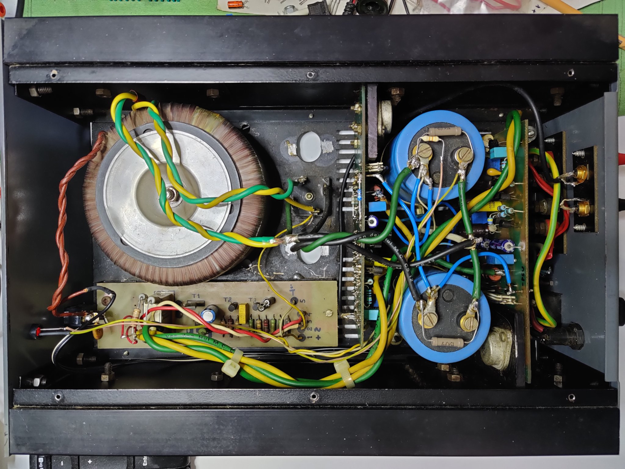

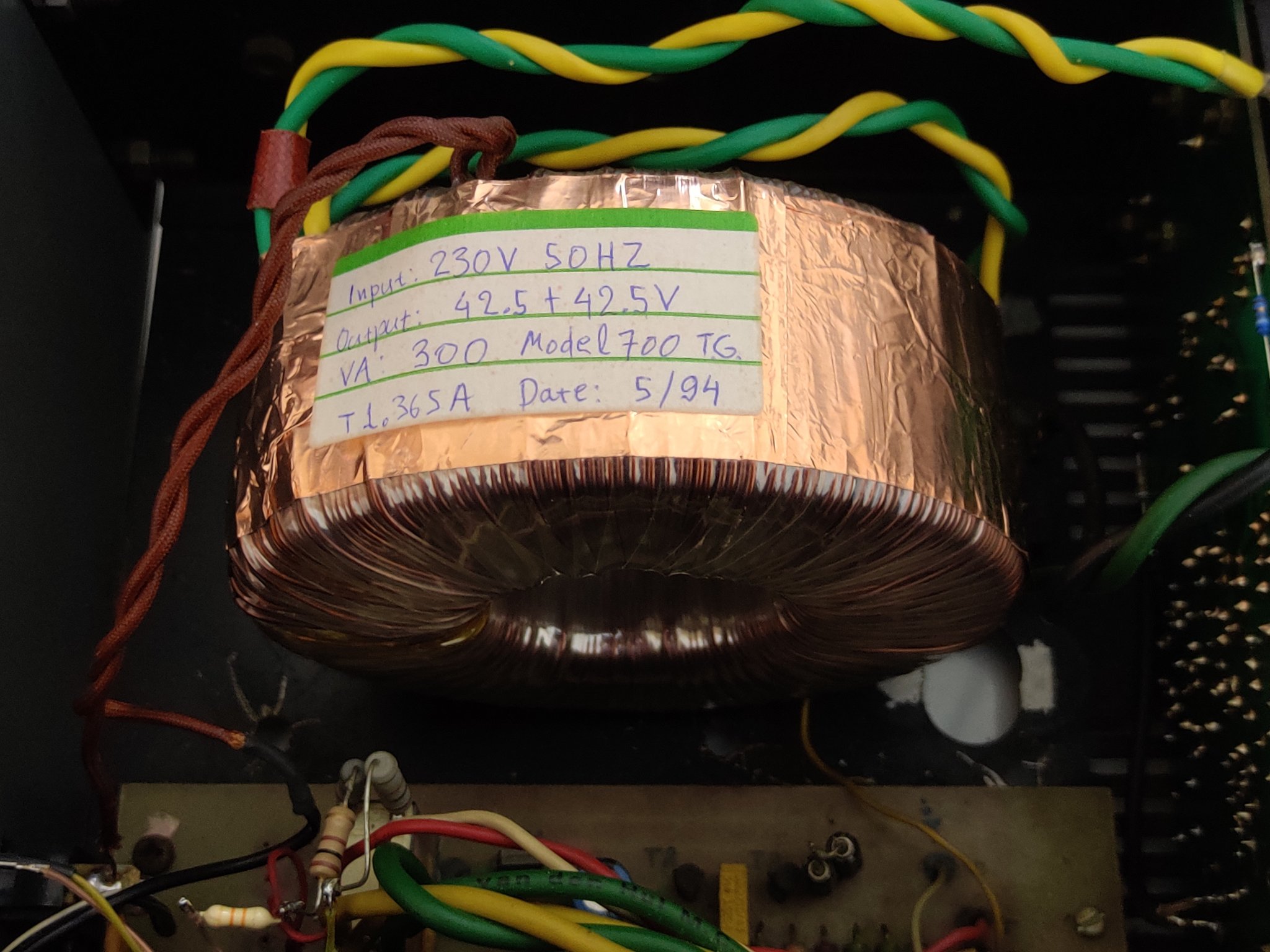

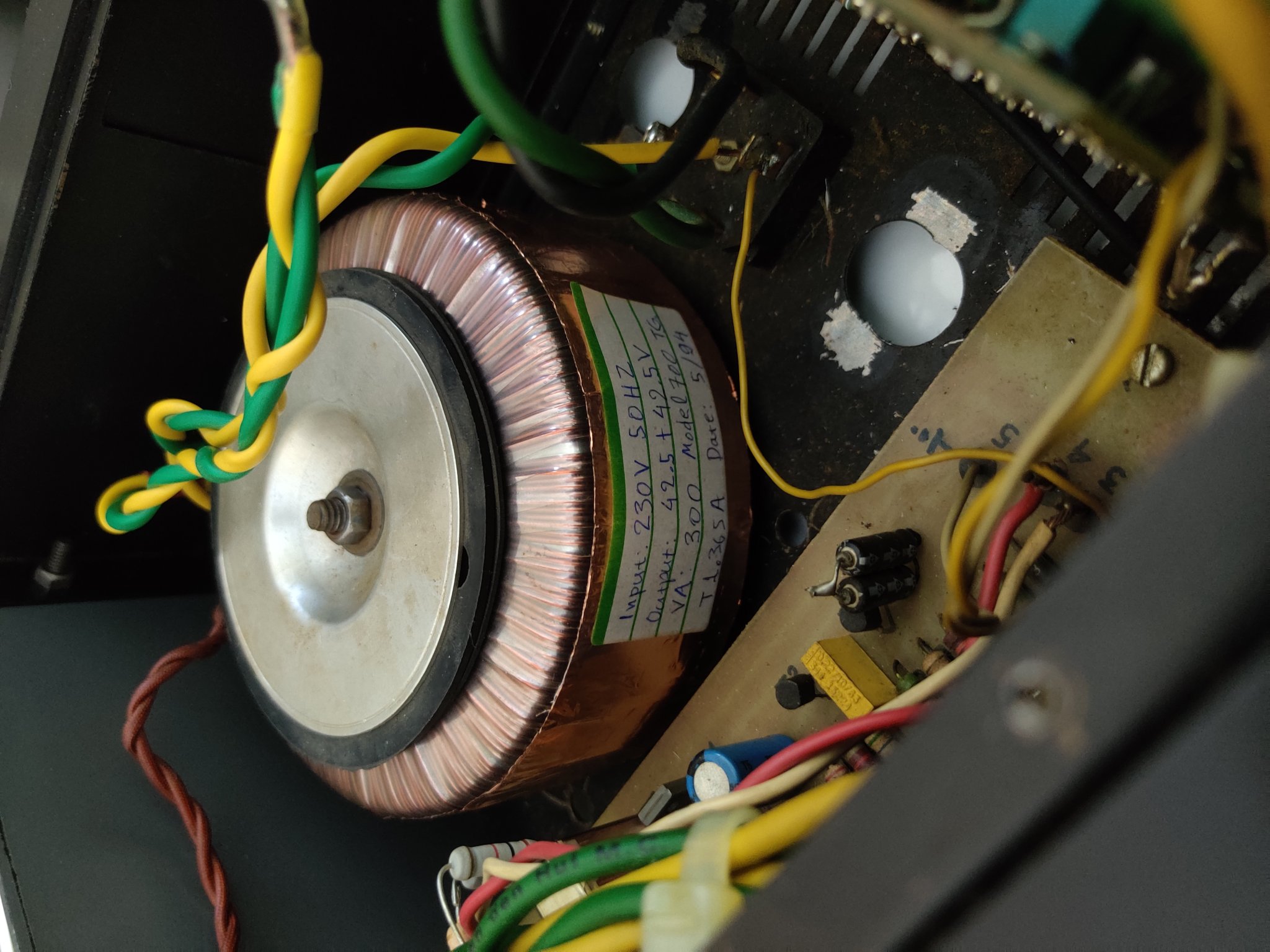

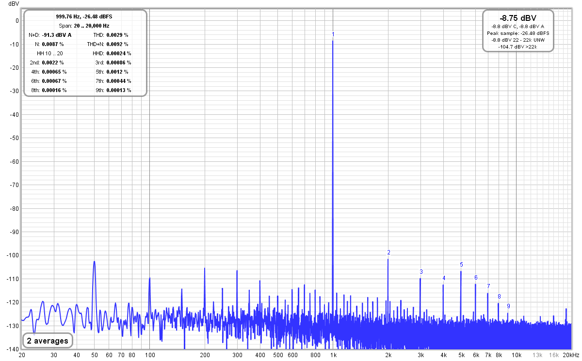

Even self adhesive copper tape as shield made a serious difference for harmonic noise interference in a 90s made shoe-box diy amp I reworked two years ago. Its 50Hz went down by 22dB or so. The thin copper film went warm but not hot.
Salas, thanks for posting this. Do you know how the radiated field was coupling into your circuit ie was it magnetic through cutting a wiring loop or was it via capacitive coupling into a hi-z part of the circuit? Elvee probably has a better view on this - the physics of the coupling mechanism with thin copper shields like this I find very interesting.
