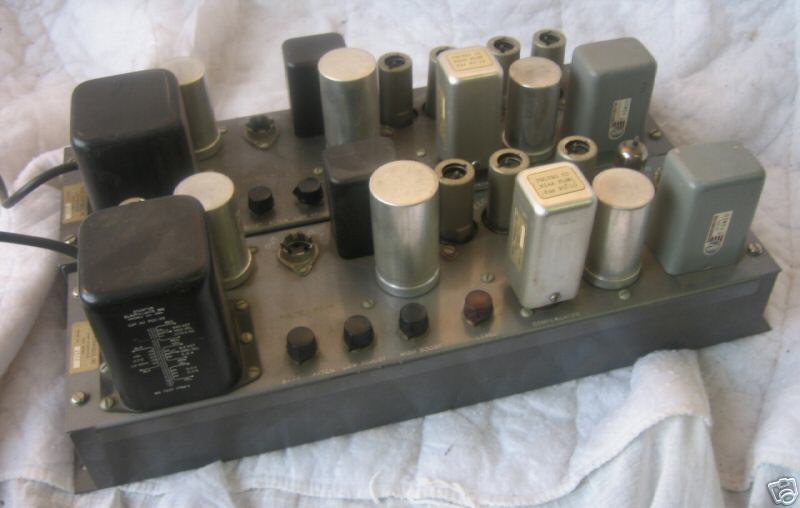

Hello,
This a pair of mono riaa LCR phonostages made by Pultec in the sixties. On one chassis there is the power transformer, the input transformer, the LCR network and the output transformer and no hum.
Most diy copies back then ended up with hum, usually coming from the power transformer.
Original one all heaters AC, no big caps but all 4 tubes had their own RC network.
SO it can be done.
Greetings, Eduard

Best is to put the turntable a fair distance away, like in the closet, and then orientate your thinking towards a dac and digital music files.Distance and orientation is the best strategy against induced hum.
