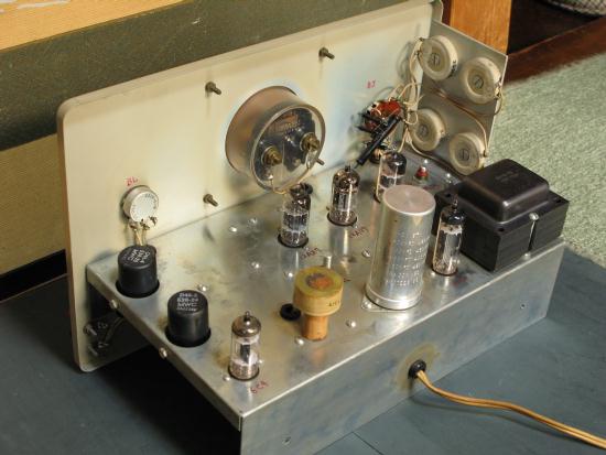

I have a Heath IM Analyzer that uses 2 LC filters, the 2 black thingies on the left.
Even though they have their own shields, possibly mu-metal, they still show extreme sensitivities to their orientations: simply rotating them changes the residual IMD by a sizable amount.

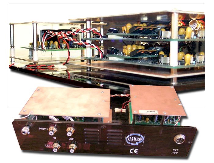

On a related question, a number of years ago Tom Evans sold a phono preamp that was praised for its lack of noise. It had a strange arrangement of copper boards on either side of the PCBs all inside an acrylic case. See photo.
Any idea how that worked?

Re the Tom Evans copper thing. In short it didn’t work one bit if we are talking about radiated mag fields. It could possibly help with electric field radiation ie capacitively coupled noise which would be at very high frequencies.
