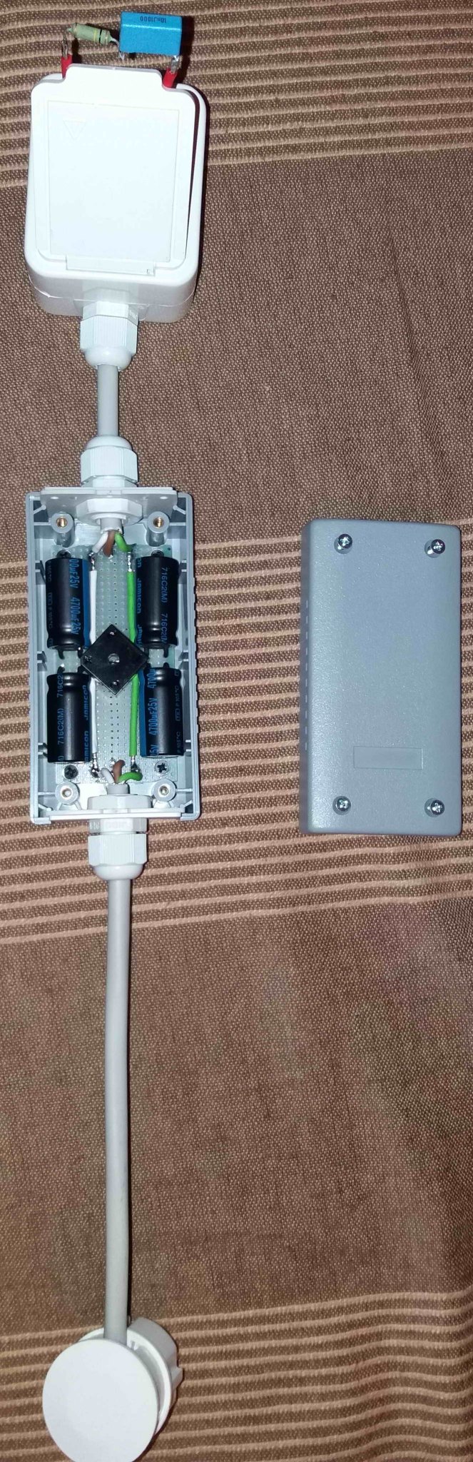

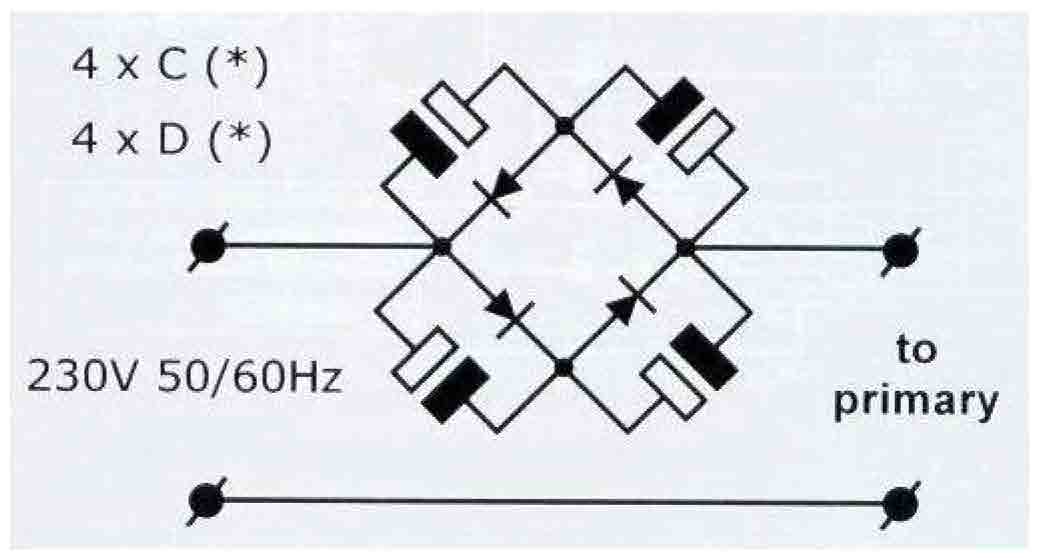

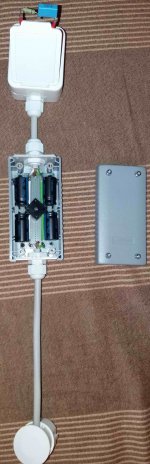

I made test sample DC blocker according to this schematic, obtained from the manufacturer of the toroidal transformer (650VA 40-0-40V AC wound on the core for 800VA). Unfortunately, it has a bad effect on the sound, a real shame. I solved the occasional increased mechanical hum by adding more #5mm rubber washers below and above the transformer, and just slightly tightening the retaining nut.You only need some diodes and two low voltage, high capacity electrolytics to make your own DC blocker. Not very expensive. Throw in a mains in and output and you can test any of your amps without DC.

Mark, with the very greatest respect this is just nonsense. If a DC blocker is affecting amplifier’ sound’ then either the DC blocker is at fault or there are serious questions about the amplifier.The problem with DC blockers is they can affect the sound of an amplifie

The transformer was made at 1T. Maybe I should have put bigger capacitors for the DC blocker. But this one, as it is made (4x4700uF 25V caps and 10A graetz bridge), has a negative effect on the amplifier sound. It's like taking something out of his life. The amp is vintage, LEACH LOW TIM. It is arranged properly and has served me well for a long time. Otherwise, it happens that there is 2-3V DC on the network, and the sine is not quite regular, it obviously contains harmonics.
My thoughts are going in the direction of building another DC blocker with some big capacitors (22000uF and above bypassed with a few hundred uF motor run PP caps. ) or getting some strong split transformer on EI core with a slot (1-1.5kW). A split transformer is quite an expensive option.

You have placed the capacitors in series across the diodes so the 4700uF is effective 2350uF. It is better as someone has said in an earlier post to just use 2 capacitors.I made test sample DC blocker according to this schematic, obtained from the manufacturer of the toroidal transformer (650VA 40-0-40V AC wound on the core for 800VA). Unfortunately, it has a bad effect on the sound, a real shame. I solved the occasional increased mechanical hum by adding more #5mm rubber washers below and above the transformer, and just slightly tightening the retaining nut.
