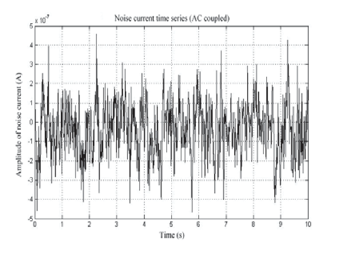

I don't think 1/f noise is a problem either. I just grabbed that to show that caps do produce noise. And IME they can exhibit current noise at higher than 1/f frequencies.
In the time domain it can look like this:
Again, IME it depends on the particular caps and how much current you run through them.
In addition to noise, electrolytic caps already have other well known properties such as ESR, and ESL which may be nonlinear with frequency. They may also be microphonic and or have other physical properties not usually considered, such as electrostriction, triboelectric effects, piezoelectric effects, etc. If they have an audible effect in a DC blocker, then one has only to look at known physical effects to find the cause. Nothing new is needed.
Nobody is publishing research to exactly explain why particular caps in particular AC power systems, in particular DC blockers, powering particular power amps can have audible effects. Just like pretty much nobody is publishing research on cable sound, where particular cables connect particular equipment in a particular system enviornment. And when they do its usually ignored. There is nothing new here. Its always people assume idealized components at first. Then when non-idealities are pointed out, there is denial they can do anything that matters. Eventually, sometimes people figure out such things do matter.
You first denied caps have current noise, now you are at the stage where it can't do anything that matters under any conditions. Nor can any of the other non-idealities in electrolytic caps.

Mark, current noise in caps might be important if you’re dealing with uV or very low mV signals. It is of zero consequence in a circuit where currents are 7 orders of magnitude higher which is precisely why I asked ‘what is current noise?’
