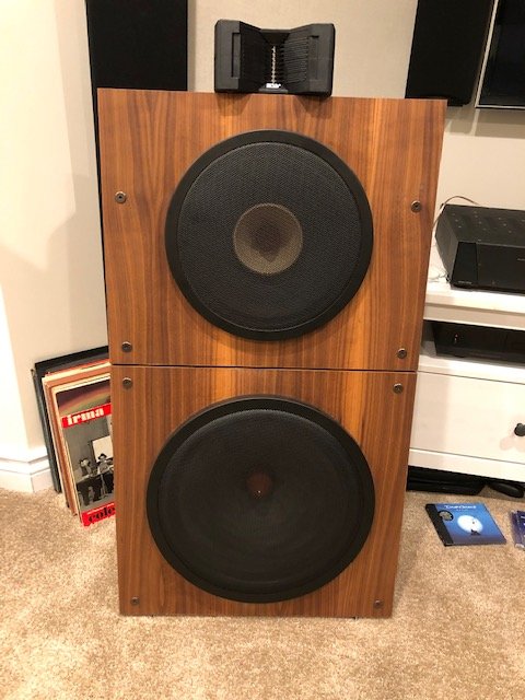

I have been enjoying the Lx-mini crossover for the last 8 months in a 2-way bi-amped relatively small OB which consists of 12" full range with 15" woofer crossed 300Hz 2nd order. Class D for bottom, Aleph J for full range or 2W Class A SET amp with good results. I Recently purchased a ESS Heil AMT tweeter to thinker with high frequencies above 10K Hz for that missing sparkle "magic" using a single capacitor for a "quasi" 3-way. I use a 4 ohms attenuator to maintain the impedance & level matching, I just find the 12" Full Range is beaming quite a bit and I not using the Heil tweeter to its full potential for mids/highs (some say one of the best tweeters ever made..)
My question is" if I ever wanted to go to full 3-way in an analog fashion (tri-amplified), what are possible upgrade paths that make sense? Could I just build another Lx-mini or 6-24 crossover for the mids/high in series ? I don't think there is such thing as 3/4-way DIY Lxmini version. Or should I simply add a passive cross-over ?
Yes, I have used mini dsp to play with EQ and XO. Possibly looking to cross the Heil around 2K. Trying to avoid the DA conversion thing all together if possible

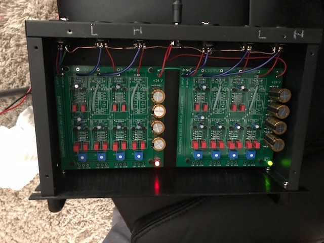

Another rather simple solution I was thinking of tonight is to split my existing balanced XLR ACN version into two single boards with RCA outputs to make it a 3-way crossover; the output of Board #1 high-pass "daisychaining" into board #2 for mid-tweeter output. I would have to model & replace the components values again after landing down on a XO frequency. I would also need to replace the rear panels from XLRs to RCA's and hopefully much can be salvaged.
The only drawback I see it the lack of adjustability of the ACN vs 6-24 board; I would be stuck with 12dB for everything unless I change the 2nd board to a 6-24 then the chassis is too small..
What do you guys think?

Dial it in using the miniDSP first, before making changes to your nice balanced setup that might not work out in the end -
e.g. if 4th order turns out being the better solution.

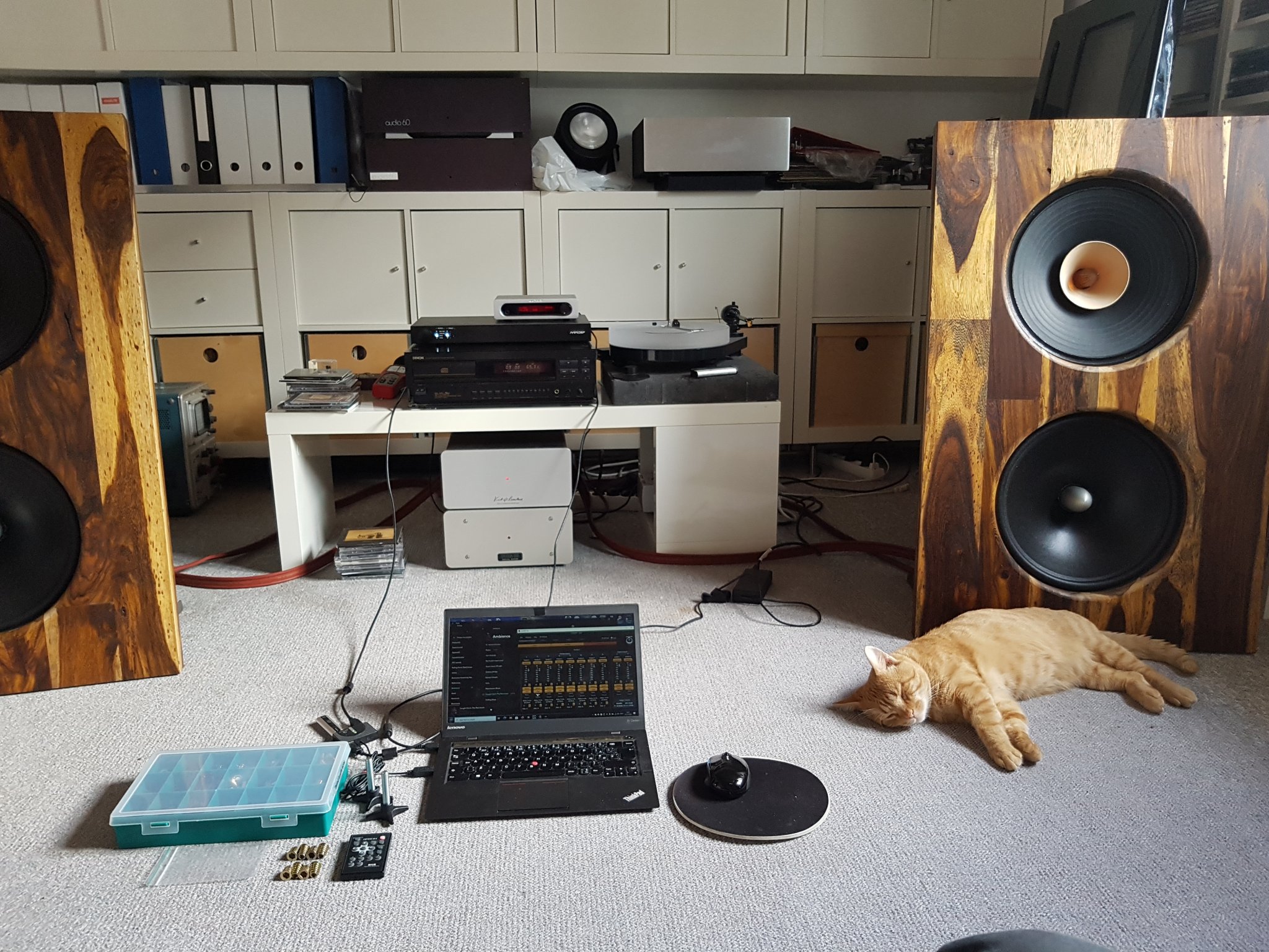

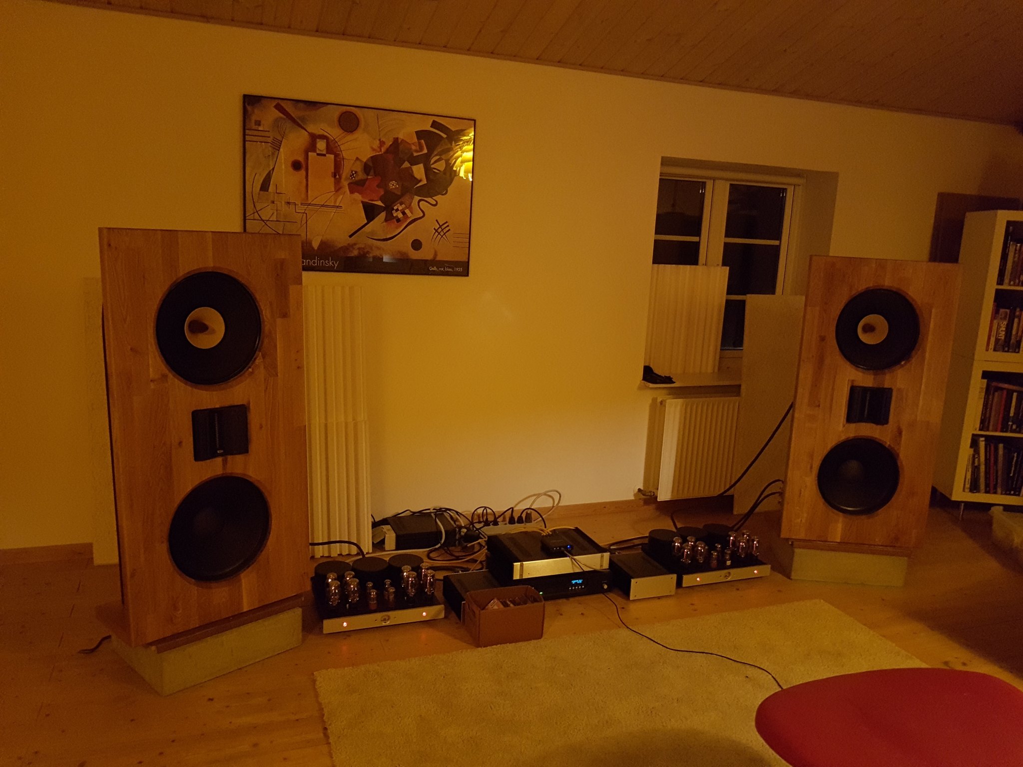

Added a picture from a setup that I totally forgot I tried out, Lii F15 on top, Great Heil center and Faital 15PR400 below.
But the plan for the F15's was something else - as can be seen in the other picture joined up with the AE Dipole 15", w.16ohm dual coils. - Fiddling with 4x10HD filter setup...
But I am yet to finalize the filter transform to 6-24 / LX-mini as planned..... eventually it will happen....surely :snail:

interesting
How did you cross the Heil in first set-up?
