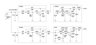

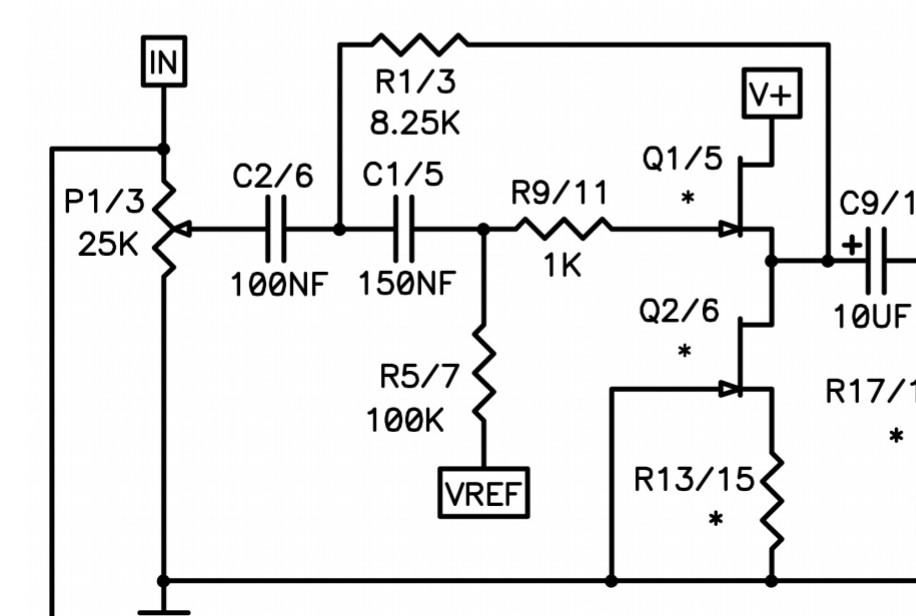

I have populated all components but ended using minidsp 2x4HD. however for my fullrange audionirvana classic 8 in bass reflex enjoy a nice 6dB 40-80Hz bass boost on my windows. i think that i want to implement bass boost too on my SIT.
i look at lxmini schematic on top low-output, am i correct that first part is the bass boost followed by lpf? so i would like to use attached schematic for SIT bass boost using K170 buffer then followed by amb a20 preamp with 15dB gain

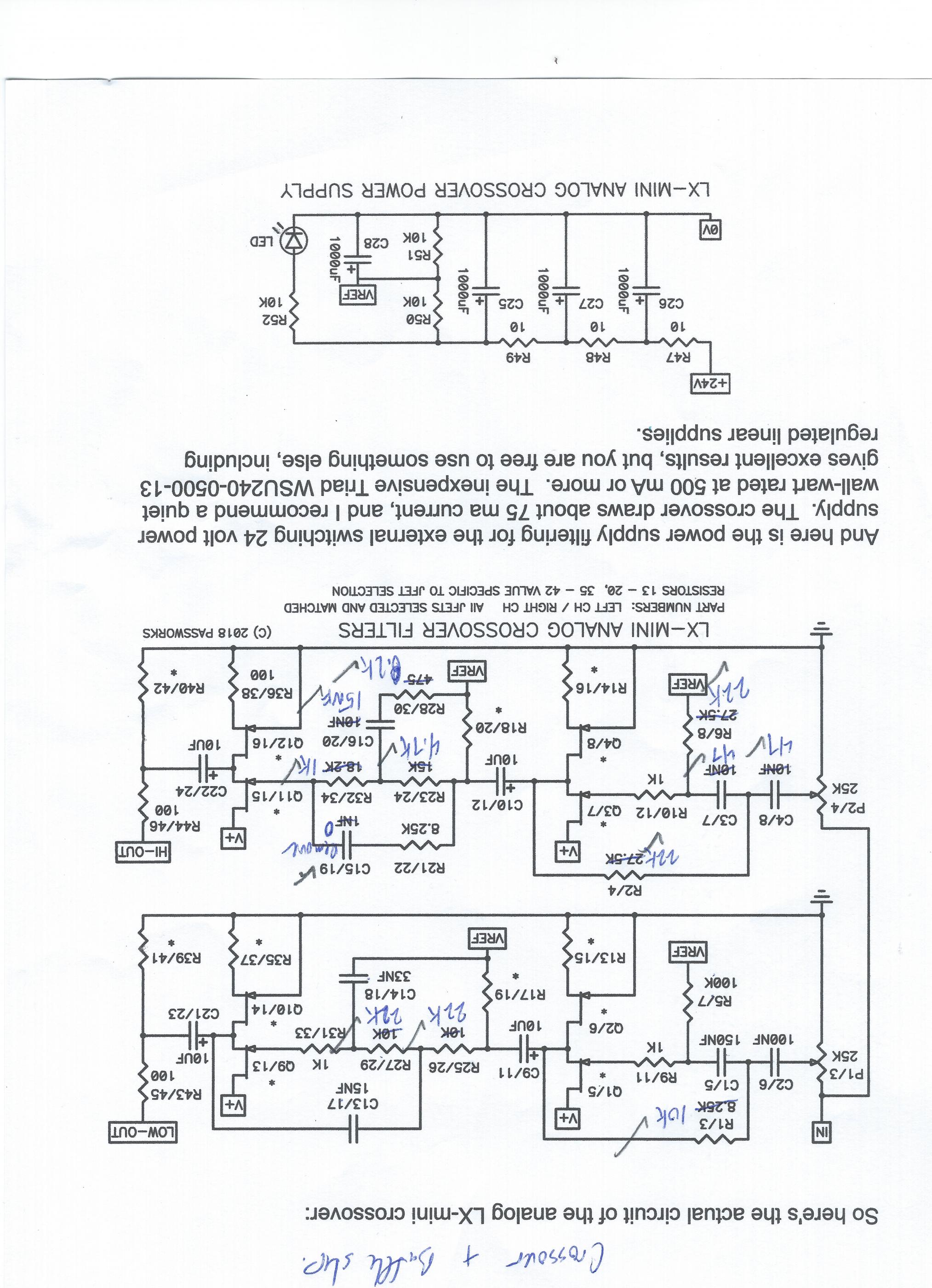

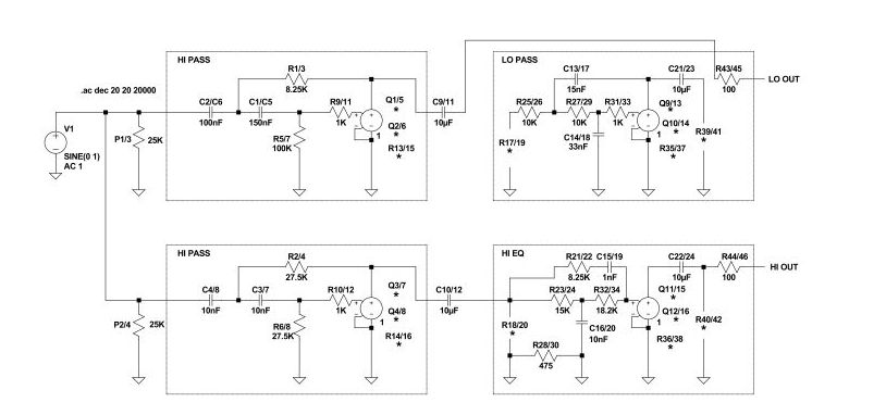

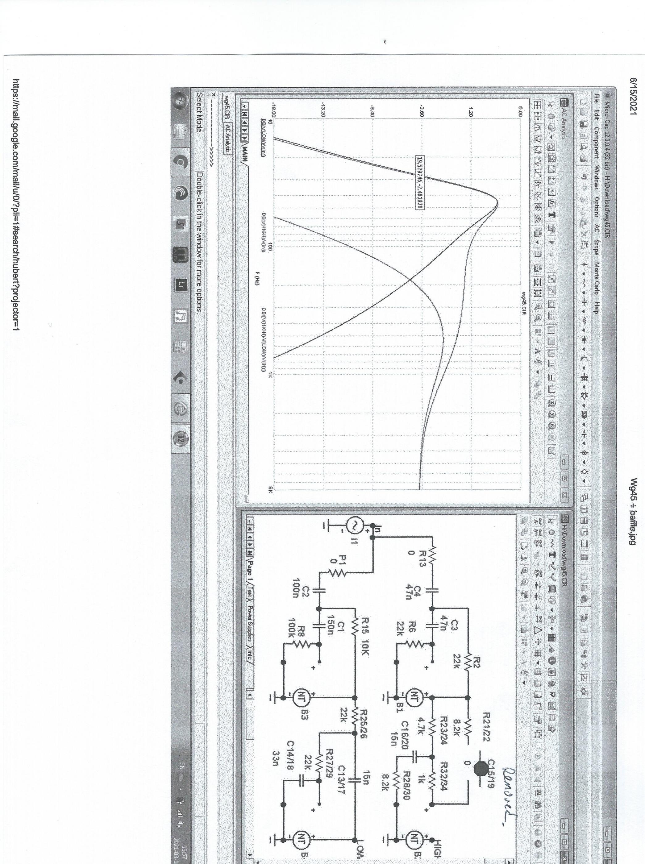

Hi all, I have a ACN basic kit (board + fets): could you help me to adjust the values for a pair of Papa's SLOB?
Here's the info on my ACN/LX Mini set up for Papa's SLOB.
I've attached two documents- (no idea why they are upside down- saved correctly.)
1. The ACN crossover schematic with updated values hand written.
2. The file of the crossover slope with updated values on the right, but it is not a complete schematic. Use the complete schematic with the hand written values.
Schematic changes from original values-
For the low pass-
R1/3 to 10K ohm
R25/26 to 22K ohm
R27/29 to 22K ohm
For the High Pass-
C4/8 to 47NF
C3/7 to 47NF
R2/4 to 22K ohm
R6/8 to 22K ohm
C15/19 removed/left open
C16/20 to 15NF
R23/24 to 4.7K ohm
R28/30 to 8.2K ohm
R32/34 to 1K ohm

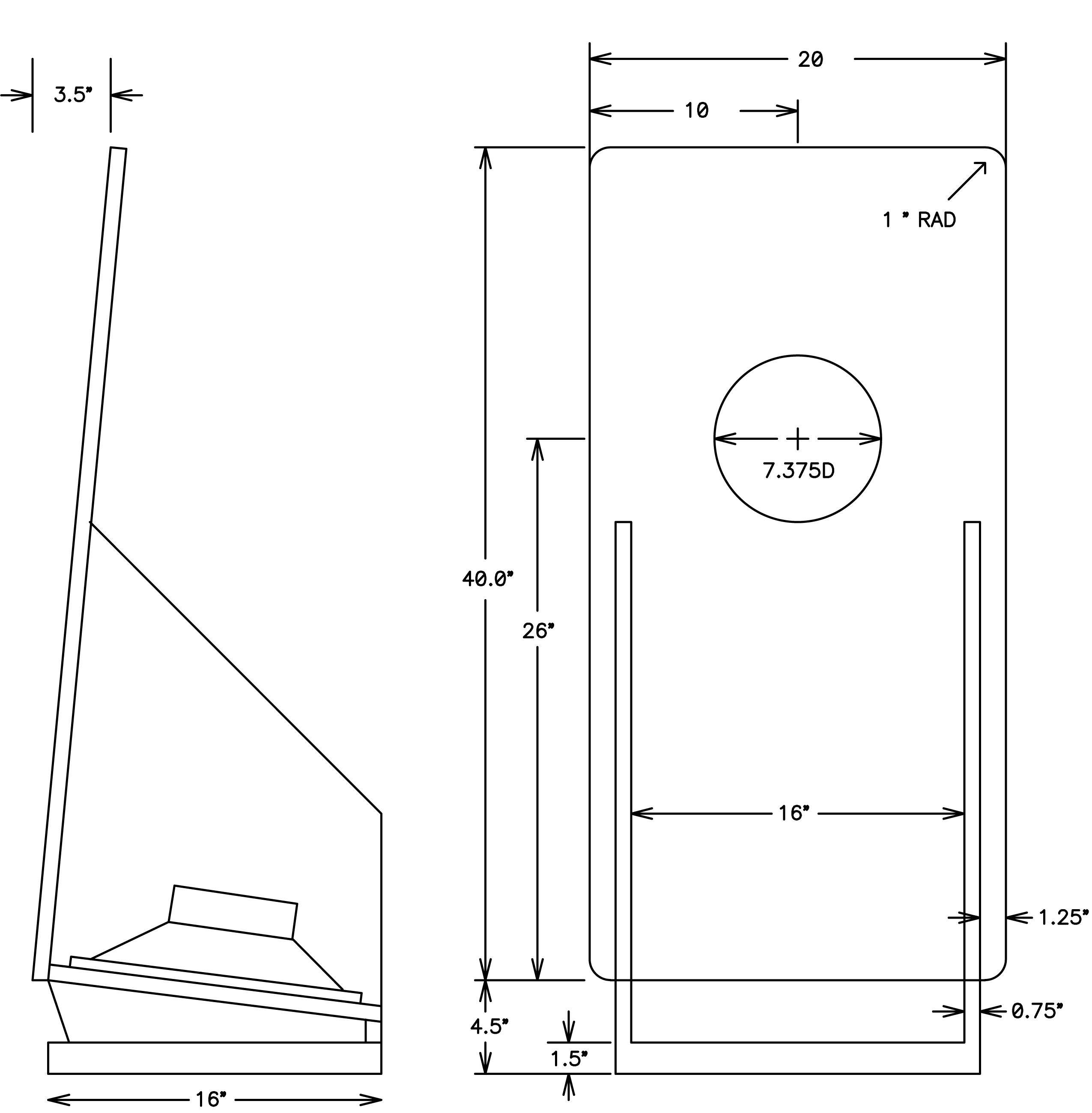

Are there additional details on the Fast 8 SLOB build somewhere? I actually have a pair of Fast 8s collecting dust. Maybe this would be a good build to utilize them. One reason they are collecting dust is I've never been impressed with their high end. If this is an OB project that includes a tweeter to help the highs, I'd be very interested. The 8 sounds great except for upper highs. And no... it isn't my hearing. My wife with bat ears commented on that the moment she first sat in front of them and my daughter (who inherited her ears from mom) had exactly the same reaction.
Try this thread-
Papa's slot loaded open baffle version#2
Attached is a rough build plan for the frame.
No reason why you could not add a tweeter. You could connect the tweeter to the FR with a capacitor.
That's the best part about the SLOB. It's a template for customization.
Yes, Papa's paper covers the much larger SLOB with 6 woofer drivers and lots of information on FR drivers. It's very informational, although some of the FR drivers tested are not available currently.
I built his smaller version, which is more of a "normal" sized speaker. I don't believe it is covered in his paper.
