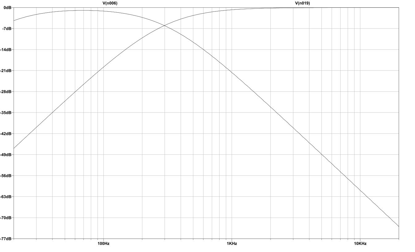

Here's the plot with 100K resistors
If 82K resistors are hard to find, 100K will work and extend the bass just a bit lower.

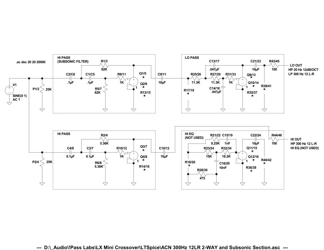

Actually I think you would be better off converting the Lo Eq section to a subsonic filter instead of bypassing it. For a 20Hz subsonic rolloff:
Change C1, C2, C5 and C6 to 0.1uF
Change R1, R3, R5, and R7 to 82K ohms
Thanks. I was able to source the 82K no issues.
Otherwise, do all the other components values remain the same as per sketch ?
