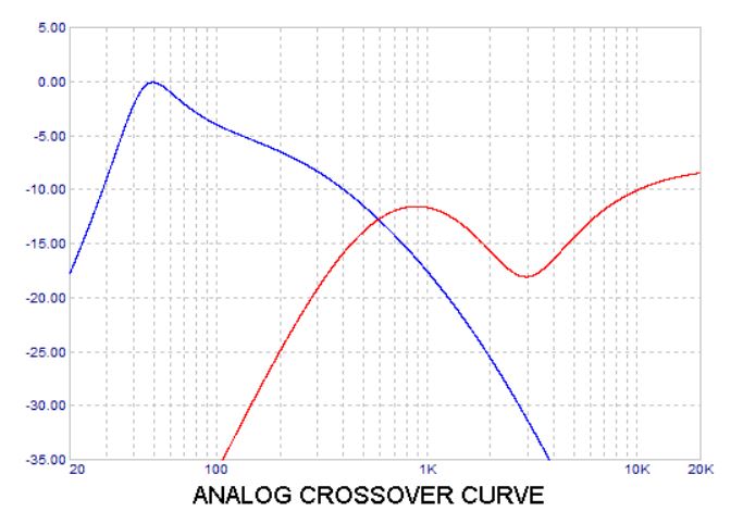

It's more complex than that. You need to get rid of the low bass bump and mid-hi dip if you want a normal crossover without the added eq. See attached. Since you say -3dB at 300Hz, are you looking for a two-way with 6dB per octave slopes and a Butterworth alignment? See the attached 260Hz at 12dB per octave. 6dB means removing even more components. It's a very simple circuit.

It's for an open baffle project bi-amp 12 " full range Lii F-12 drivers with 15" Eminence Alpha woofers. I was playing with mini-DSP 2x4 settings by ear all afternoon and settled with a 300 Hz crossover point @ 12dB/Octave Linkwitz curves with a 1200 Hz high-pass cut off frequency for the woofers - simple and sounds decent with good bass in my room acoustics.
I just want know what components values are needed to build the ACN without a lot of hours on software modelling/ EQ

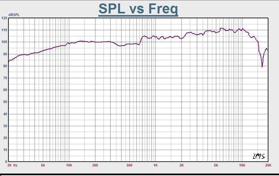

1- What is the High Pass cut-off frequency for this design? trying here to match the frequency of the F-15 full range around 60-80 Hz

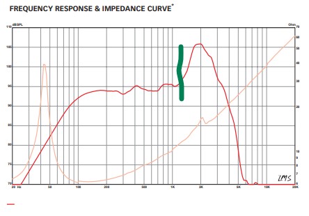

2- The frequency response of the Eminence A-15 shows a bump after 1,200 Hz and a sharp decline after 2,000 Hz - therefore selected Low Pass cut-off at 1,200 hz
3- Do these values eliminate the ACN low bass bump and mid-hi dip as per above graph? The digital DSP only shows smooth curves

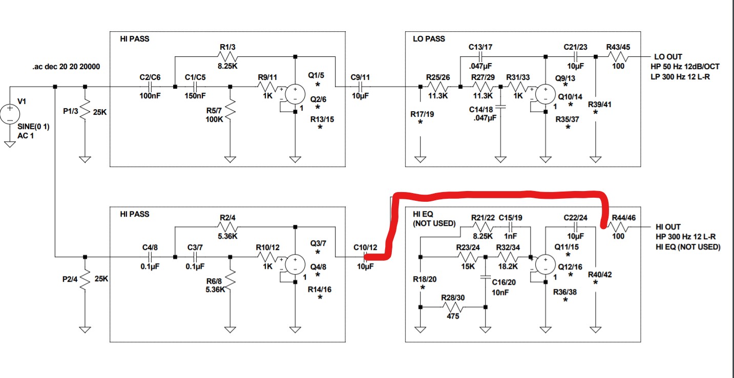

Thinking more about your OB setup, it seems keeping the LX Mini LO OUT Hi Pass section that includes a bump at 50Hz with rolloff below that point might be of benefit.
1200Hz rolloff for LO OUT feeding the 15" woofer is not needed as it is many dB down by the time you get to that frequency. Maybe the attached will clarify things. I have included a schematic and the output plot curves. You use the values shown and bypass only the HI OUT HI EQ section, which is not needed. You do not even need to stuff & solder parts in that section.
Yes.
One way to isolate the jumper from the rest of the circuit is to not install the parts in the EQ section (except for C10/12 and R44/46) and run the jumper from the input pad side of the R23/24 resistor location (which is connected by a trace to C10/12 negative) over to the output pad side of the C22/24 location (which is connected by a trace to the input side of R44/46).
Alternatively, you can leave the C10/12 capacitor negative lead uninstalled in the board and air wire the connection to the jumper wire. Leave the input lead of resistor R44/46 uninstalled in the board and air wire connect that end of the jumper wire.

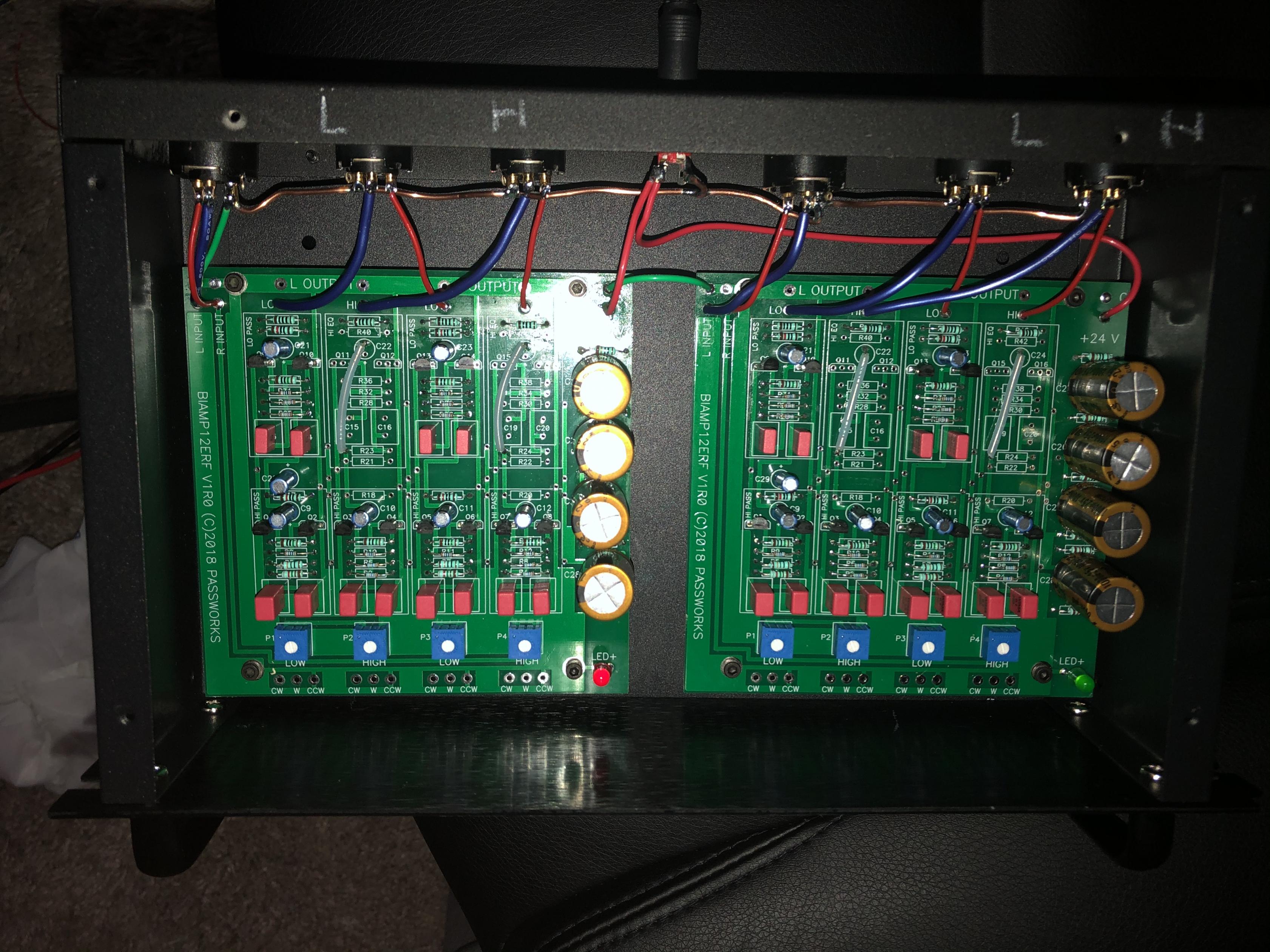

That appears to be a power supply bypass cap. It is shown in the PCB layout but not in either the main schematic or the power supply schematic. Probably added during board design but after the schematics were drawn. It is there to reduce potential noise and does not affect the filter frequency response.

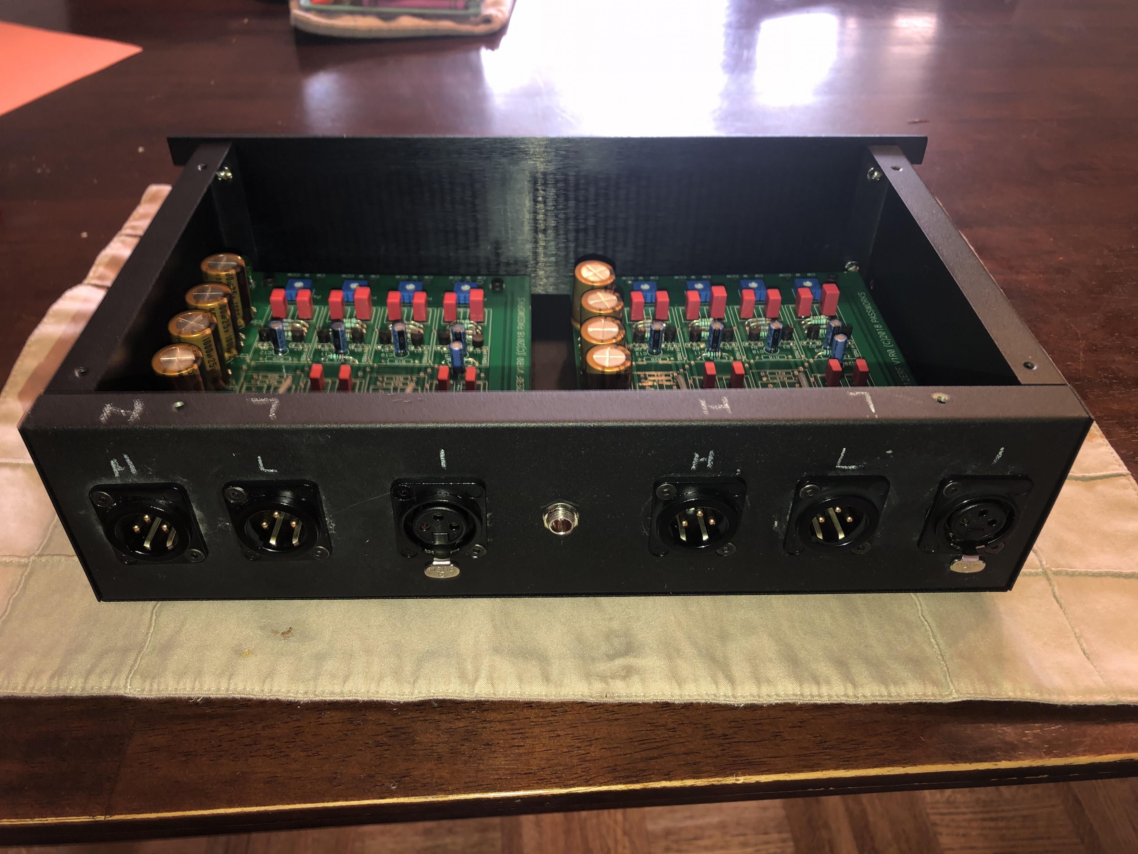

balanced crossover project completed!
All done and tested - more or leas 5% tolerance between boards, good enough as Papa said
Hardest part was the custom rear panel to fit 6 XLR mounts - a pita to drill all the large holes to size
**Special thanks to avdesignguru for his help with the custom crossover point and filters design
Do you know how to further attenuate the volume of low pass? The stock values for P1-4 trim potentiometers are 25K. The maximum I can dial is 12K and would need more to balance between the two amplifiers.
Should I change the Bourns trim pots to 50K units to get a larger attenuation range ?
sebtdi:
I'm not sure what your problem is. Your statement "The maximum I can dial is 12K" does not make any sense. Theoretically, if you turn both the positive and the negative signal input trim pots associated with one of your balanced low out channels all the way down (P1 and P3), both the pot wipers will be at ground and no signal should be passing through the low pass circuit to the output.
All I want to do is attenuate the input to the crossover for the low related to the high at 10K. My class D amp has a lot of gain compared with the Aleph J for the highs. It's too boomy. The maximum range of the Bourns wiper is 12K.
